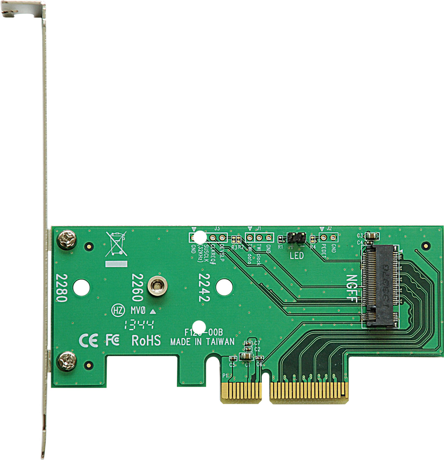

I'm using this M.2 carrier in slot 4. I put a cute green LED on it - nostalgic from my Amiga 4000T days.
My 960 EVO gets about 1360mb write & 1,400mb read on 4Gb test with this carrier.
It is sold by a Japanese company that produces cheap PC accessories.
http://www.kuroutoshikou.com/product/interface/converter_board/m_2-pcie/

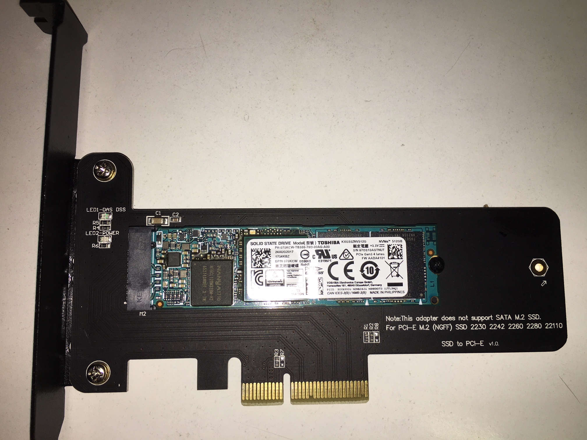

PS : here is a photo of the basic M.2 PCIe card I used on my two Mac Pros.
Both MacPros recognised at boot the XG5 drive (set to 4K blocs) with Sierra, one with a patched MP51_0084 BootRom the other one with the MP51_0087 BootRom.
