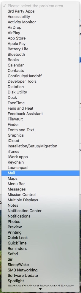

"40752222" that May or may not be the number of the bug report I submitted on this whole Microcode thing after I figured out how to bug-report...
glad Apple engineering are looking at the bug reports we filed (well I hope so and that its not just an automated thing...)

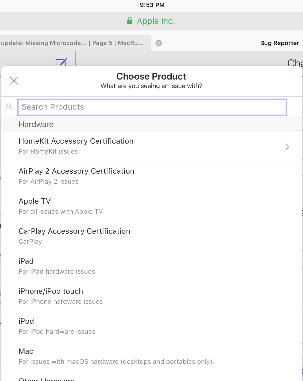

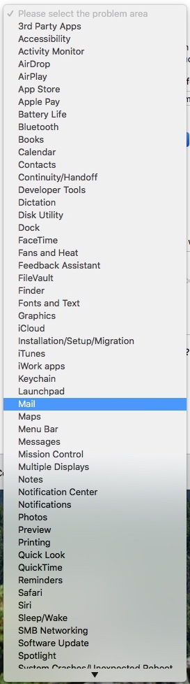

What did you file it under? I filed one under "other", but I'm not sure if that's correct. Hopefully the engineers are looking at these reports.
I filed mine under Mac (hardware IIRC tho it just says Mac in the sub title bit) as well its is a pretty serious bug to do with the Mac Pro 5,1 it self and its Firmware rather then any specific OS X or iOS software release (they dont exactly have a section for EFI/Firmware bugs it seems sadly)
Reactions: crjackson2134
There is no Mac or general hardware sub section.

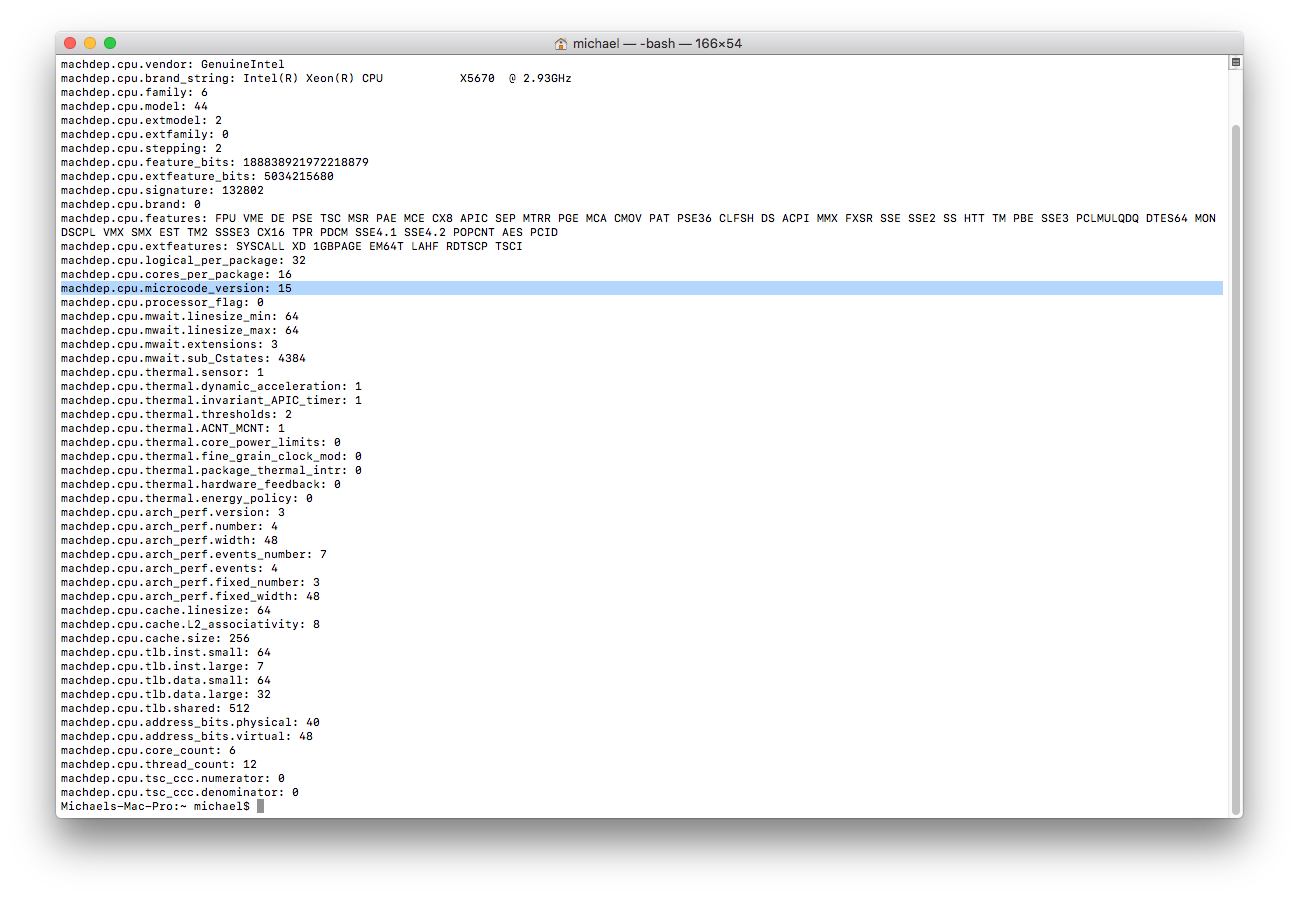

I had installed the full version of 10.13.5 and got the new firmware update w/ no microcode ( showing ver. 0). So my take aways from this thread:
1) The firmware is probably intended to address several security vulnerabilities. Without that microcode my Mac is not safe from malicious attacks. YIKES!

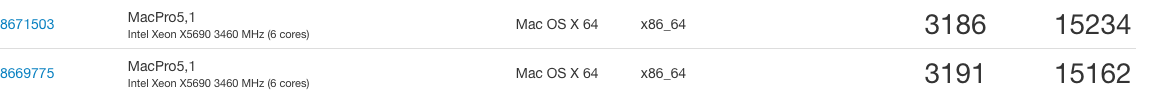

Having just yesterday applied thermal paste on a shiny X5960 in the single Cpu one, With 10.13.5 & 0087 Rom, I'm getting a high Geekbench 64 score:
I guess 30 versions of microcode patches will lower that score. Once I'll figure how to add microcode i'lll post the new score.

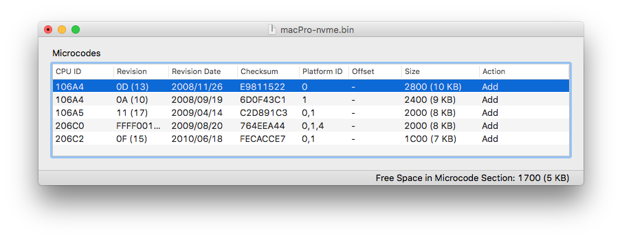

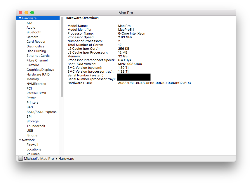

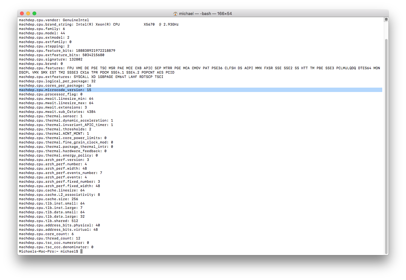

Hello everyone,

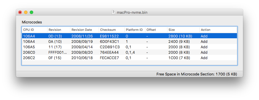

Well @dosdude1 has done it again. Using his tool here https://forums.macrumors.com/thread...ode-update-guide.2122246/page-2#post-26151850 and extracting my microcode from my other 5,1 with firmware 084 Mac Pro, I was able to restore v15 microcode to my 087 Mac Pro. I cannot be thankful enough for this tool existing, I was hesitant using this Mac Pro with no microcode.
View attachment 766259 View attachment 766256 View attachment 766257
Got the V30 code working on my 087 firmware mac pro. The fancy GUI patching program was unexpectedly quitting on me, so I followed the manual copy and paste in hexedit method.
Did you download the microcode from Dosdude’s web page?
You can’t inject the microcode file provided by LightBulbFun. That’s not the “correct” microcode to use for that patcher. It’s because that file also contain some “header” for search and locate purpose, not just the pure microcode.
Yeah, you need to use a microcode file found here. As mentioned, the dump @LightBulbFun provided contains more than *just* the microcode, and the program is not designed to handle that.
