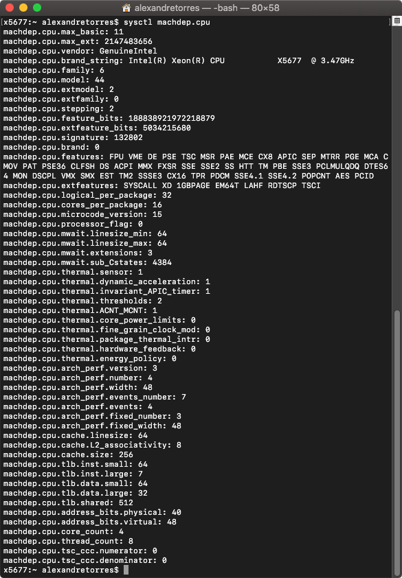

Can you post a screenshot of your OS microcode confirmation with OS version and BootROM version please?

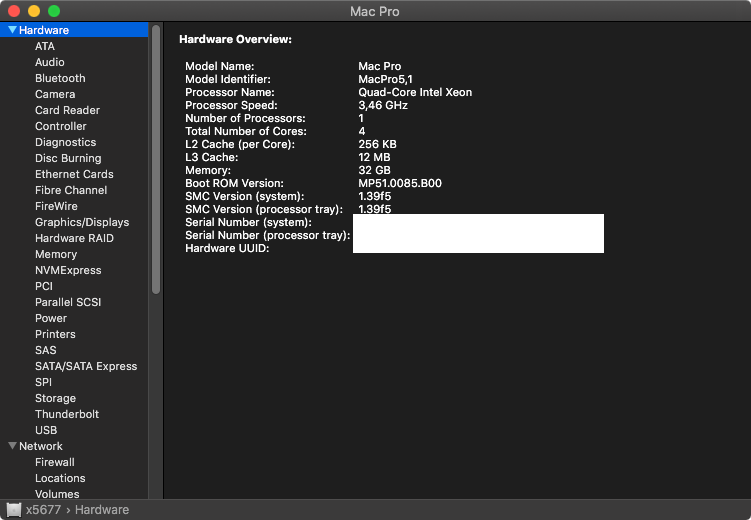

The firmware still 0085.B00 in the latest PB (I downloaded that just 5min ago), and microcode version still 15.

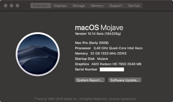

10.14 beta (public) 18A314k but as I said, this was the already the previously installed Mojave OS with 0085.B00. I downloaded the full installer for 110.13.5 created a USB installer and ONLY ran the install to the point of flashing the firmware.
Thanks, so it seems the microcode is injected at the OS level, and only available in the latest 10.14 PB. I will test that later, thanks for your info.

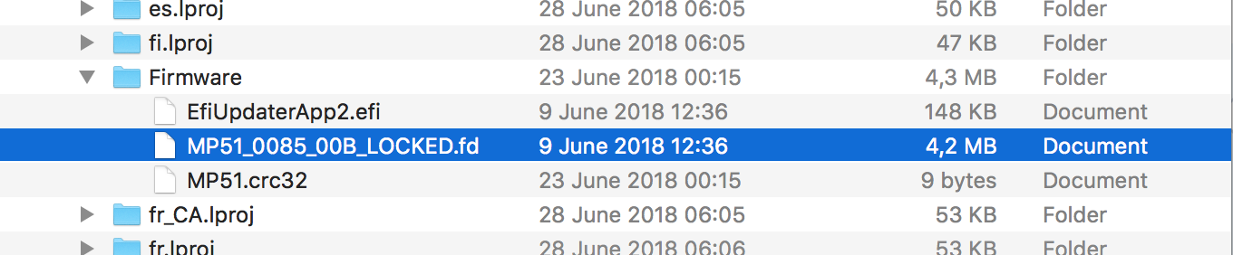

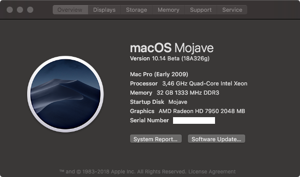

Today's Mojave DP3 still has MP51_0085_00B_LOCKED.fd from June 9.

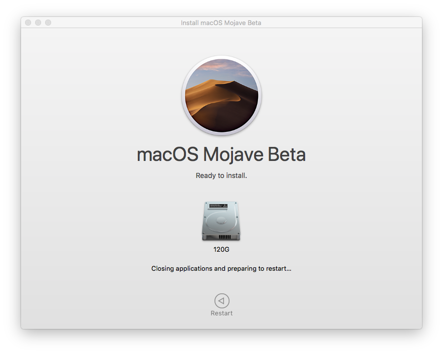

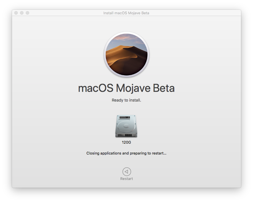

Mojave DP3 now installs without resorting to startosinstall on HD7870. According to the DP3 release notes, that was a bug.
Resolved -> When attempting to install macOS Mojave on Mac Pro mid 2010 and mid 2012 models you might see an error message ‘This version of macOS 10.14 cannot be installed on this computer.
