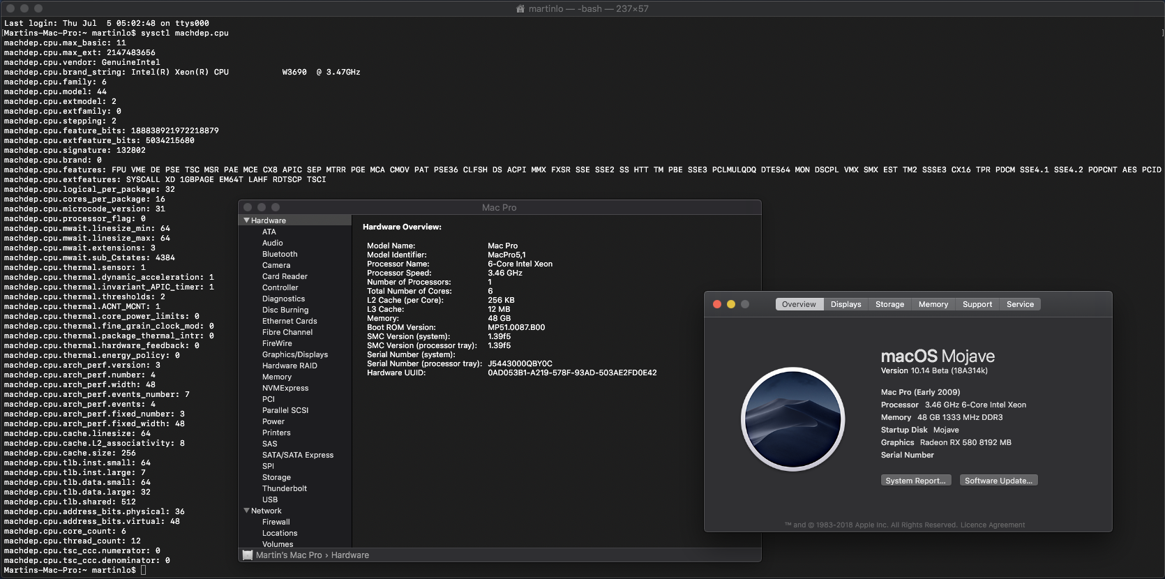

Confirmed microcode version 31 is builded inside macOS Mojave. I keep the firmware at stock 0087.B00 (no microcode at all). Then make a clean installation of the latest Mojave public beta, and I got microcode version 31 straight away.

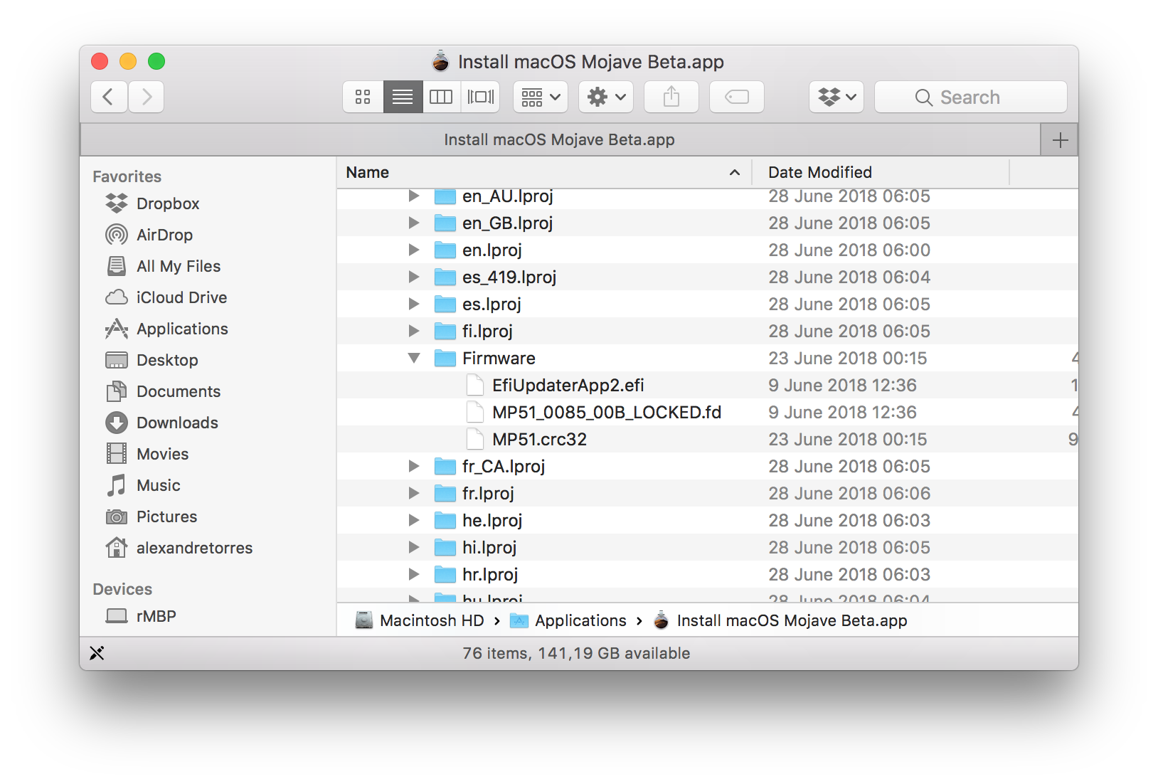

What firmware version (0085 I’m guessing) is included in the installer, for those machines that haven’t fw upgraded yet?

1) Mojave DP3 has 0085 version to update any previous BootROM.

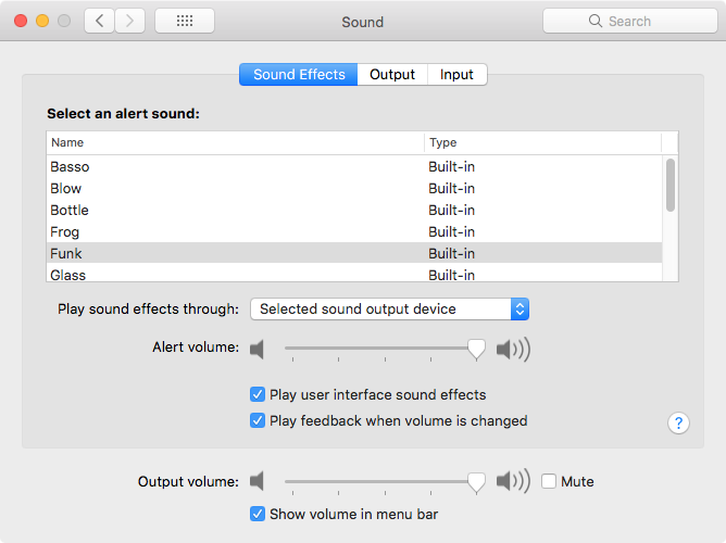

I've also lost my boot chime. I can do a PRAM reset and get it back, but it only last ONE boot, then it's gone again.
I think that may have something to do with my ACHI/PCIe Apple Blade SSD. I'm going to test this tomorrow.
That boot chime is suppressed by High Sierra. It seems if once you boot to High Sierra, that boot chime will gone until next PRAM reset.

I lost mine in the 10.13.4 update. I've done 50-60 PRAM/SMC resets. Fixes it every time... FOR ONE BOOT ONLY.
Issuing the terminal command does the same here. IDK what the fudge is going on. I just know that when I don't hear the chime, it worries me that something is amiss. If HS isn't suppressing it, then IDK what to think.![]()
