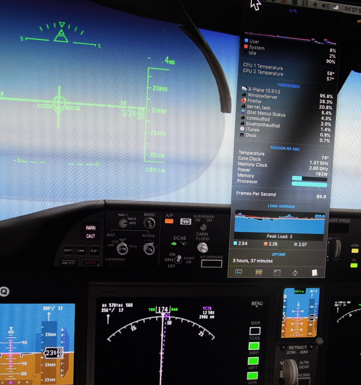

I upgraded to iStats Menus 6.31 ( 1110 )which now shows GPU power consumption.
Having read your comments re: IOreg in post #221.
I've been running X-Plane 10 at high graphics settings and I must admit that knowing the published TDP for RX 580 8gb GPUs . . . this version of iStats Menus seem to be pretty accurate.
My idle wattage shows between 50 ~ 74 w depending on what is running eg: lo-rez vids, browser etc.
But as you can see from the included pic. . while X-Plane is running it gets up to 192w
I'm powering my MSI Armor RX 580 : 2 X Mini 6 pin to 8 pin to EVGa Powerlink but I have also added an extra 2 X SATA to 6 in to the PowerLink as well just to be safe. I've seen many PC websites claiming that the RX 580's real TDP is higher than officially published by AMD.
Perhaps iStats Menus creator has included maths to compensate for IOReg's inaccuracies in this new version.
My intuition feels that the wattage use I'm seeing is pretty close to real consumption.

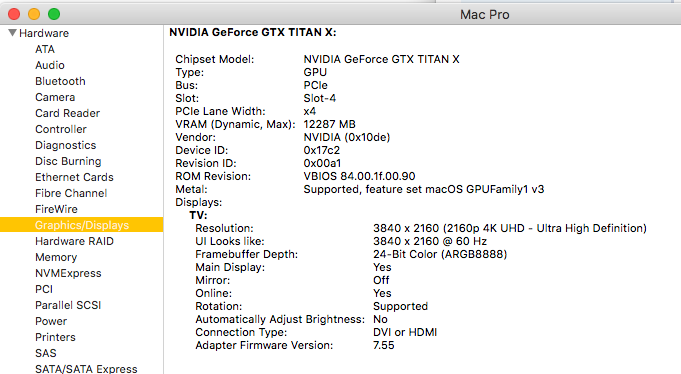

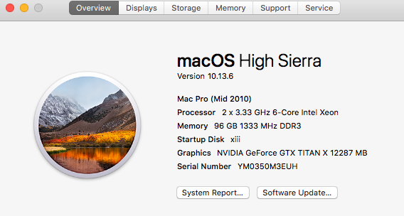

Maybe the low result is related to it only showing as 256mb compared to the 8192mb....?
Does macOS not properly recognise a titan?
It's a good observation. The Titan X has 12GB VRAM - perhaps @h9826790 could shed some light on this anomaly.
I have NVIDIA Drivers [ NVIDIA WebDriver-387.10.10.15.15.108 ] installed and matching CUDA drivers BUT I'm not a GPU config expert so maybe I've not activated some kind of GPU acceleration feature..?

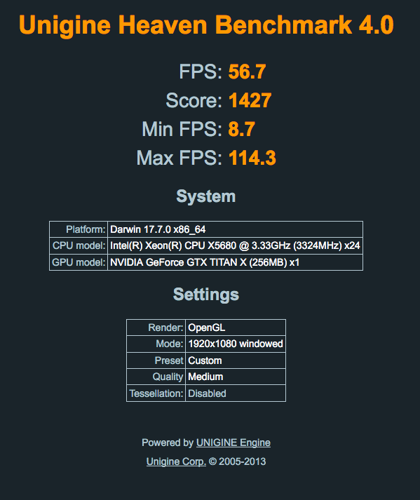

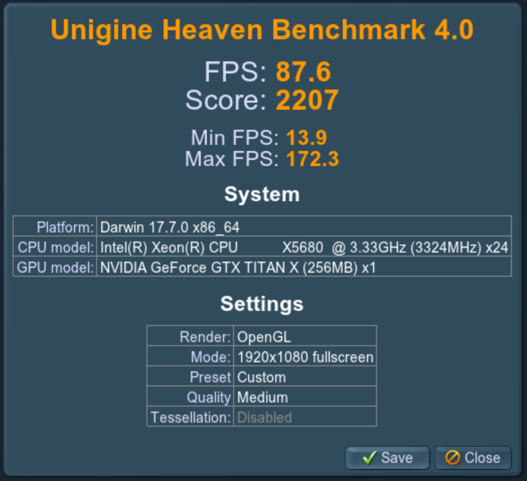

UPDATE..
I have re-run the test to 'perfectly match' the parameters used by @macguru9999
I'm very surprised to see that in changing the one 'non-matching' parameter -- which upon closer inspection shows that the test run by macguru9999 was run in fullscreen whereas my 1920x1080 test was run in a true 1080P discrete window..
As you can see, by making this adjustment the score has changed quite dramatically
It seems unlikely that running the test in 'fullscreen' versus running it in 'window mode' explains the big boost in the test score
I know that when I ran the test the first time around I had Google Chrome Open with a YouTube video running in the background – maybe this undermined the true value of the original test score.
[ still no explanation for why the benchmark utility doesn't accurately report the video RAM available on Nvidia Graphics cards ]
Reactions: macguru9999
That’s nothing special. The VRAM capacity often can’t be correctly reported in MacOS benchmarks. Won’t affect the result.
That “TitanX isn’t faster than RX580” result is because your setting is CPU limiting. You guys should set tessellation to max, and use higher resolution if possible.
Anyway, using Window mode (vs full screen) often cause big hit in 3D performance, that’s normal.
