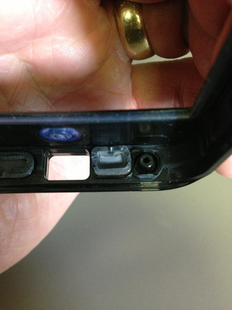

Here is a tip for anyone having issues with other people hearing you on calls or them hearing themselves echo back while you're using the nuud. Take the case off and check all the seals inside the case - especially those around the mic and speakers. I was having problems with people hearing themselves echo back when I was using speaker phone. When I took the case off, I discovered that two black seals on the inside of the front of the case near the charging port were not lined up correctly and were blocking off the opening. Once I re-alligned them and put the case back on, I have had no issues since. Hope this helps.

This is likely the case with mine...but I can't see how to "re-allign" it. It seems to be stuck down really well. i'm afaid I will tear something.

Mine was smashed down so bad that the top of the seal was on the bottom causing a complete blockage of the port. I used tweezers to very carefully move it back into place. Then I placed the phone in the front part of the case - bottom first to be sure that the phone sat on top of the seals and didn't move around. Then I snapped the back on.

There appears to be a membrane which is glued to the case. Then, there is another layer and then the black gasket...I'm referring to the microphone side which was in the photo from my previous post. When you re-positioned yours did the black gasket separate from the middle layer, or did they move together? Mine came out with the black gasket stuck to the middle layer. I repositioned it and it does seem to sound better, but I'm concerned I messed something up.

Mine never seperated or came out and mine was also the mic side. It was like it was smashed down and it was either that way out of the package or I caused it when putting it on because I realized it within a couple of hours of the case being on. When I realligned it, the membrane/glue slid with it into place. I held it there for a bit with the tweezers to be sure it was going to stay and it did. So, I placed my phone back in the case and am hoping that the phone is now holding it where it should be. I haven't taken the case off again to be sure though. If you are in doubt, I would exchange it. I'm feeling pretty confident with my repair and I just happen to have a case with a straight home button so I'm scared I may not be that lucky with an exchange. I'll check mine once I get home and I may exchange it later in the week once my BB gets more stock in now that I know what to look for as a potential issue.
