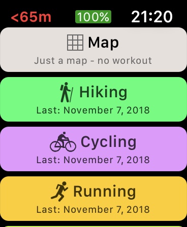

- Somehow I managed to set "hiking" as the first activity type on the watch, don't know how. I can't change it back. On the phone, running is still first ... help. See pics below.

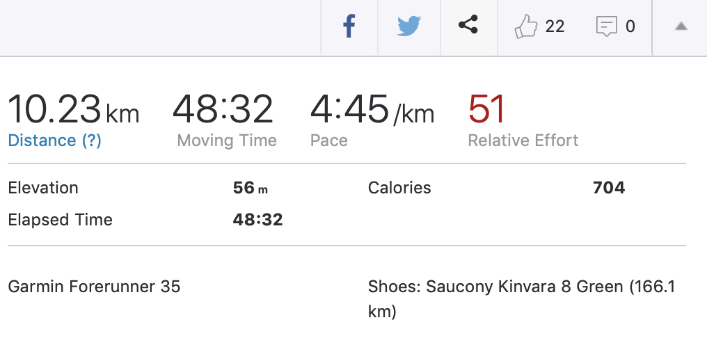

- Exported file. In Strava, there is a field on the activity page that will show which device was used to record the activity. (see pic below). Is it something you can do ?

- The activities are ordered by last used time, so just start a running workout and that will go to the top next time. The hiking workout was probably so short that it was ignored and didn't make it to the phone to affect the order there.

- I will see if I can add the device to the Strava upload. Strava say that they extract it from the "creator" tag in the GPX file (which currently says "WorkOutDoors") by looking for a set of known devices, so I will have a play and see what works.
