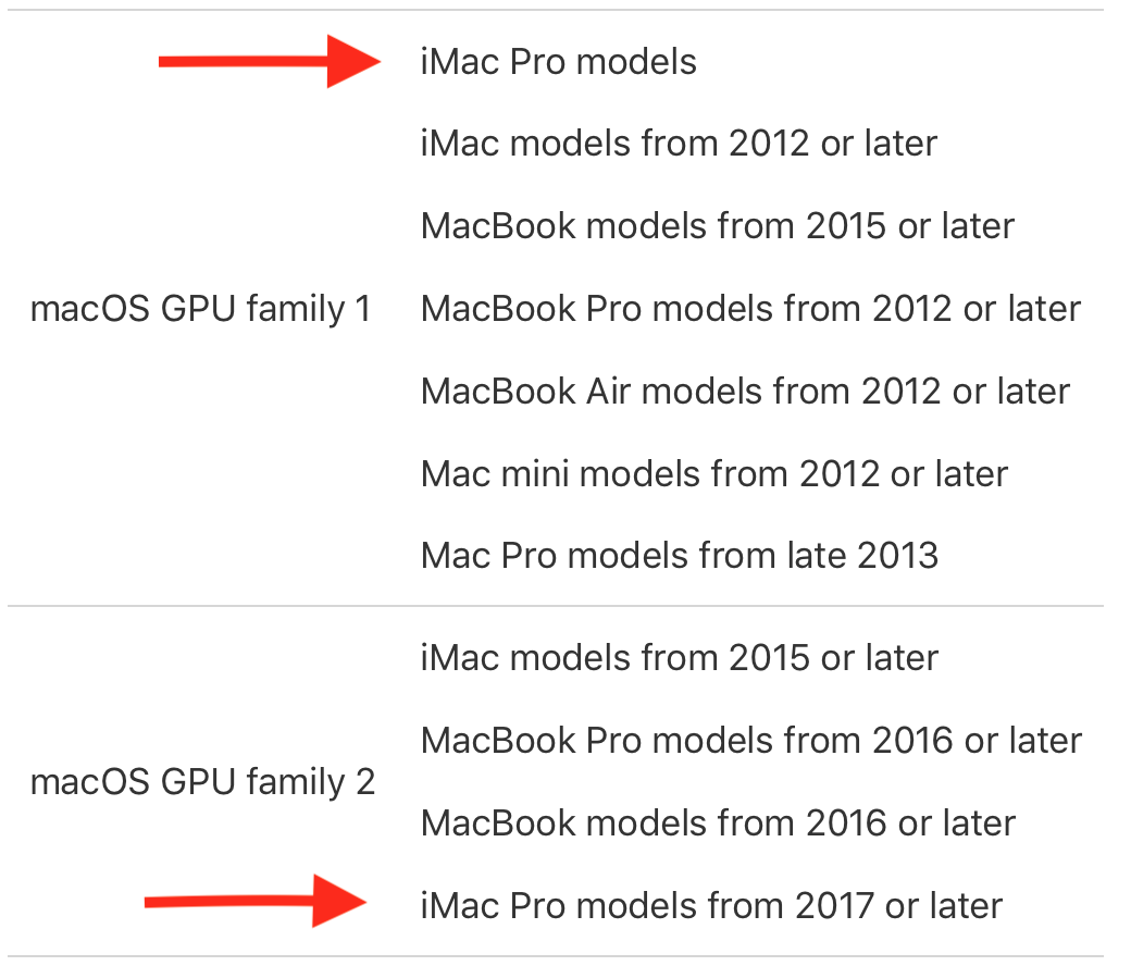

[doublepost=1532498851][/doublepost]Here's something interesting about the Metal GPUs for Mojave. Apple now lists which Macs have GPUs that are family 1 and family 2 here: https://developer.apple.com/documentation/metal/mtlfeatureset. Family 2 GPUs listed here: https://developer.apple.com/documentation/metal/mtlfeatureset/macos_gpufamily2_v1.

[doublepost=1532498851][/doublepost]Here's something interesting about the Metal GPUs for Mojave. Apple now lists which Macs have GPUs that are family 1 and family 2 here: https://developer.apple.com/documentation/metal/mtlfeatureset. However, it doesn't match what they have listed here: https://developer.apple.com/documentation/metal/mtlfeatureset/macos_gpufamily2_v1. It shows the Tahiti GPUs in the 2013 Mac Pro to be family 2, but I don't think they are. If they are, then that would mean the HD 7950 should be family 2 as well. I don't think the GPUs in the 2015 iMacs are family 2 either since they are based on the Pitcairn chip. Has anyone with a Tahiti or Pitcairn GPU been able to verify which family your GPU is under Mojave? There's a script you can run in High Sierra that tells you the supported Metal feature sets for your GPU, but I haven't been able to get it working for Mojave.
Did you see this? What's the sense in this table?
