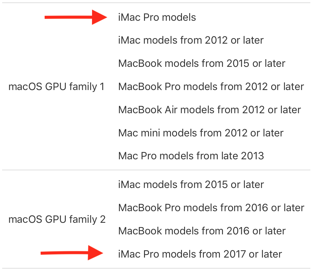

Did you see this? What's the sense in this table?
It looks like that just means that family 2 GPUs also support the feature sets of family 1 (so family 2 is family 1 + 2).
Doubtful, but does this accidentally reference the early iMac Pro's models that were extensively being used for testing for several months before the late 2017 launch? Unsure what GPUs were included in those models and it is nearly impossible to nail down their exact specs.
Agreed. Family 2 is a superset of Family 1. Not sure why they didn't write iMac Pro exactly the same way under both headings but if you just ignore that detail then the table makes sense.

Has anyone with a Tahiti or Pitcairn GPU been able to determine if it’s family 1 or 2?
My failing Tahiti card came up as Family 2v1 in System Profiler. It has an R9 280XOC Gigabyte board with a factory overclocked HD7950 BIOS on it. I believe all Tahiti cards show up as 2v1. OpenGL Extension viewer said the same.
