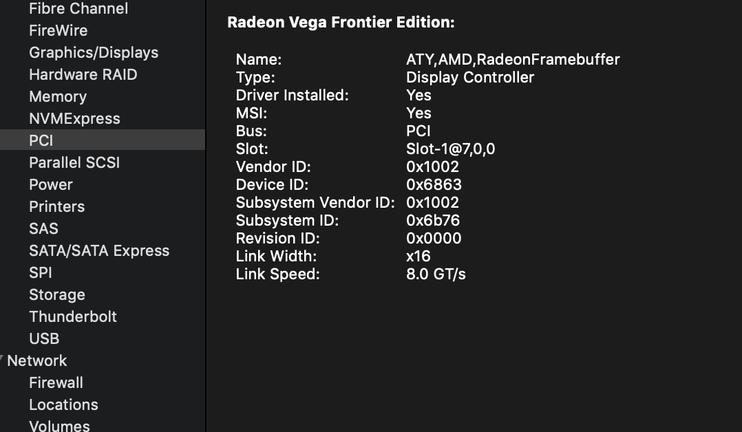

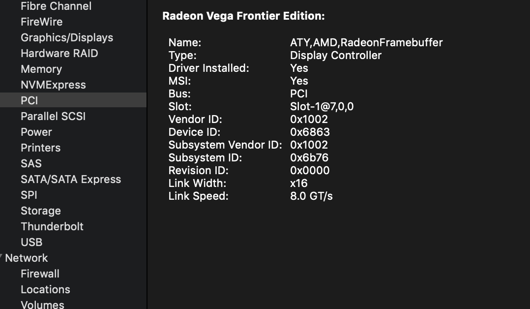

I updated to Mojave PB7. Vega FE now shows link speed of 8.0 GT/s. It was 5.0 GT/s. Doesn't seem to have any noticeable effect. So this means what, a better GPU driver coming?
