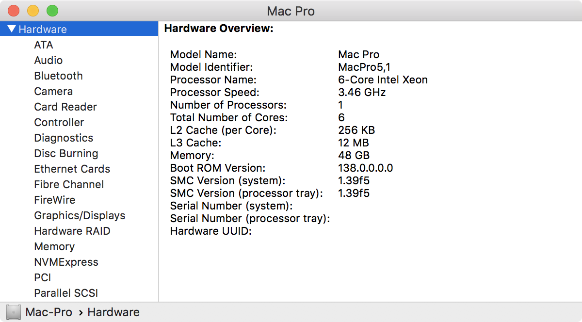

My Vega 56 is showing as 8.0 GT/s on my Mac Pro using this latest firmware. But I assume even if it's being seen that way, that it is still operating at PCIe 2.0 speeds?
Which "latest" do you mean (latest official or latest beta), this one?

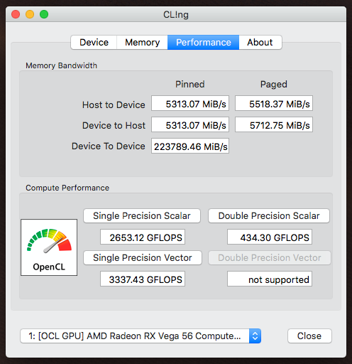

This is a good tool to test if your card is running at PCIe 2.0

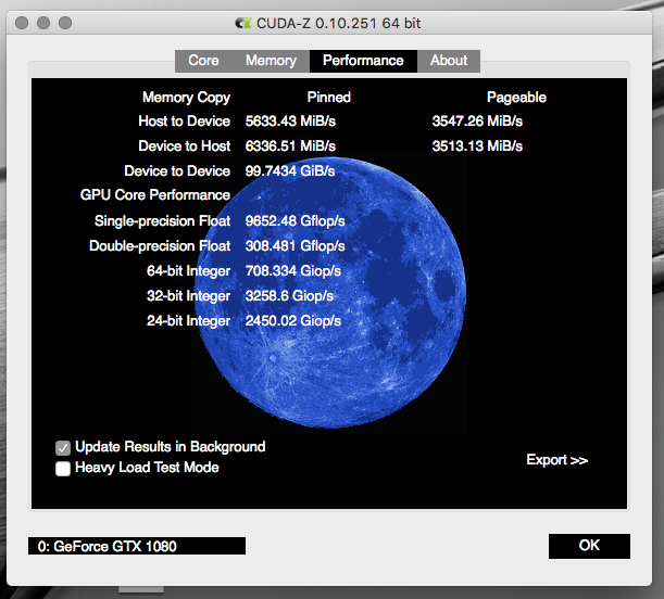

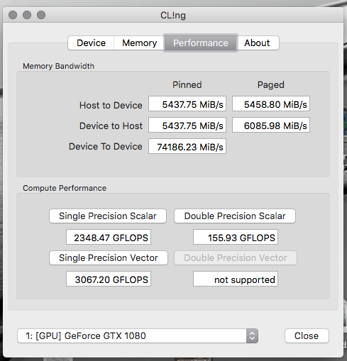

I've never heard of CL!ng before, I've always used CudaZ for such a purpose. Seems like the results are different. But, in any case, even though PCIe shows me running at 2.5 GT/s, both of these say different, as CudaZ always has.
Lou
Lou
IMO, CL!ng is a better tool to just confirm the 5GT's capability. It's direct from Apple store, and work for any GPU.
As long as the Host <-> Device reading is at the 5000MB/s range, the card is negotiating at PCIe 2.0 speed.
I won't care too much about the performance figure difference. Those are OpenCL figures, and specifically for that coding only. Can't be compared to the CUDA figures.
Reactions: skeptech
Yes, I'm running the latest 138.0.0.0.0 firmware. Just ran this and it's negotiating at PCIe 2.0.
My Device to Device is showcasing a much higher number than yours though... any reason for that?
