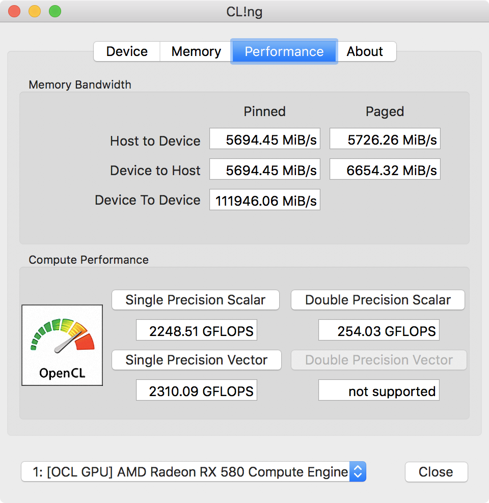

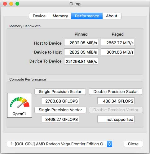

My Device to Device is showcasing a much higher number than yours though... any reason for that?
Not sure, may be driver efficiency difference. Even my RX580 shows a better reading then my 1080Ti.

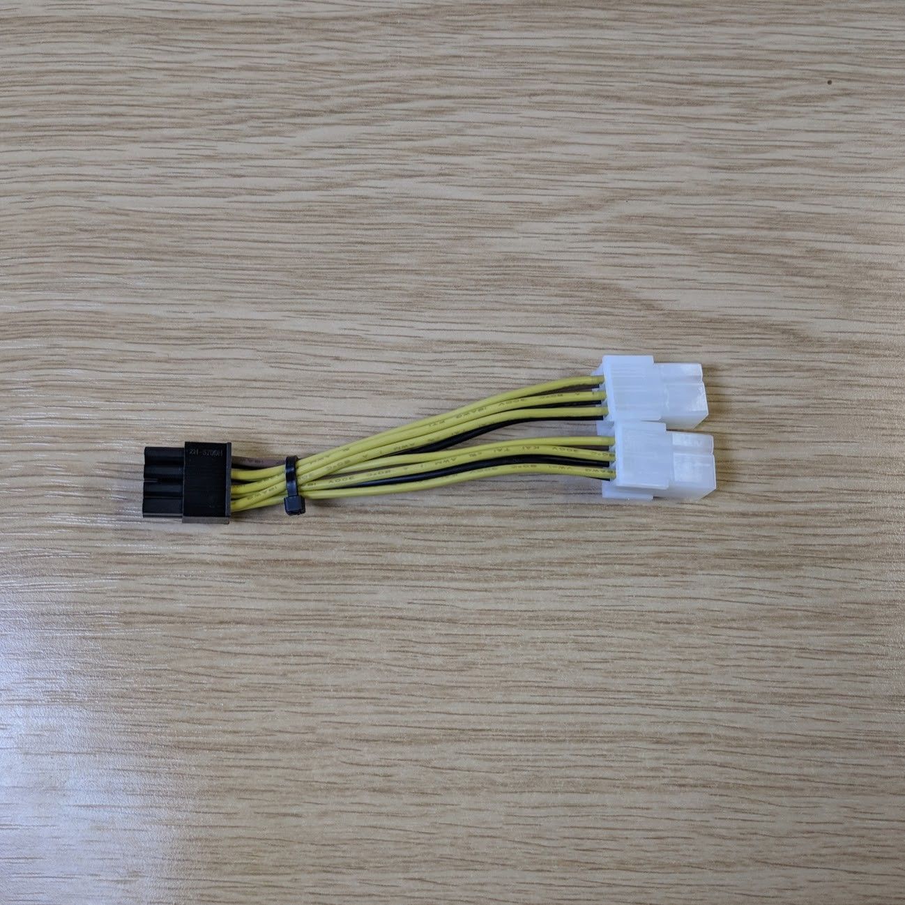

Just realised I didn't check if I need power cables for this card to work?
Will it run without power cables?
I had a look around at other installations and they used an 8 pin to dual mini 6pin cable. Is this the right one?
If you mean RX580, this card require the 8pin plugin to work, NEVER boot the card without all pins connected unless the manual says you can do so.
Does anyone know where to get a dual 6 pin mini to 8 pin connector in the UK? I've tried Amazon and eBay and they're all from China arriving in mid October.
I bought it from amazon.com, guts parker iirc, but then I read a lot of people advising against that manufacturer in this forum.Does anyone know where to get a dual 6 pin mini to 8 pin connector in the UK? I've tried Amazon and eBay and they're all from China arriving in mid October.
This question keeps arising.....order from ebay (china) you should have it in about 7 days (despite the estimate)....Does anyone know where to get a dual 6 pin mini to 8 pin connector in the UK? I've tried Amazon and eBay and they're all from China arriving in mid October.
I realised that I already have 2 cables which go from mini 6 pin pic-e to standard 6 pin to power my 5770s. I found this other cable which should arrive much quicker which does dual 6-pin female to 8 pin male. If this looks like the right one for the job then I'll buy it and order the slow chinese one. When the chinese one arrives I can replace these and I'll be able to sell my 5770s with the cables.
So does this look right?
https://www.ebay.co.uk/itm/Dual-6-P...phics-Power-Cable-20cm-Free-P-P-/283073106469
I found another one which offers 1 day delivery:
https://web-systems.co.uk/shop/cables/dual-6-pin-to-8-pin-pcie-power-cable/

ps dose this cable look ok? dual 6 pin to 8 pin male
thanks for the bios link weckart
thanks TC!! for confirming that i ordered the correct cable
o and any one in the UK who wants an amazon one i found this
https://www.amazon.co.uk/16AWG-GTX1...37170552&sr=8-13&keywords=dual+6+pin+to+8+pin
just dont want to wait so ill be using my two min 6 pin to 6 pin -> dual 6 pin to 8 pin -> gpu
if i feel fancy ill get one of the dedicated cables
