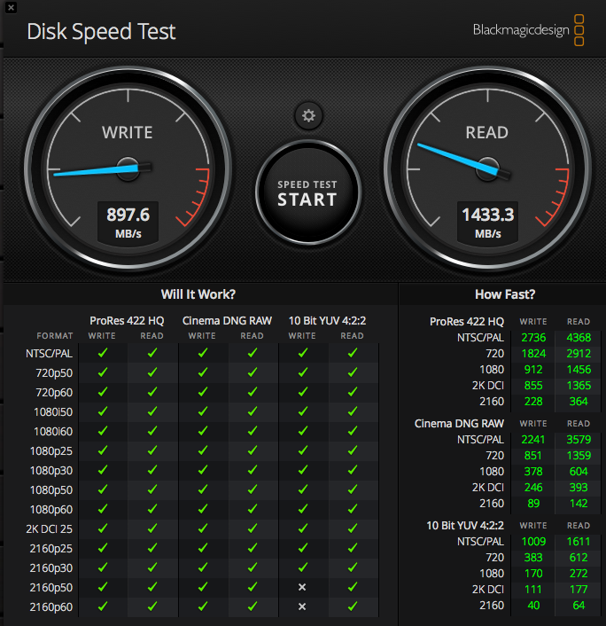

That sounds perfectly normal to me.
nMP gives PCIe 2.0 x4 lane to the SSD slot. So, the bandwidth is 2000MB/s.
With 20% overhead, that real world max should be ~1600MB/s.
And 12xx / 14xx MB/s seems very normal for a x4 5GT/s connection.

Thanks for the input. tried as "a matter of some sort of test" , without the Samsung Evo 500 GB SSD, the Samsung EVO Plus NVMe SSD on write and read speed and did get exactly what you said it would be, so I dismissed considering bying another controller.
Thanks again h9826790

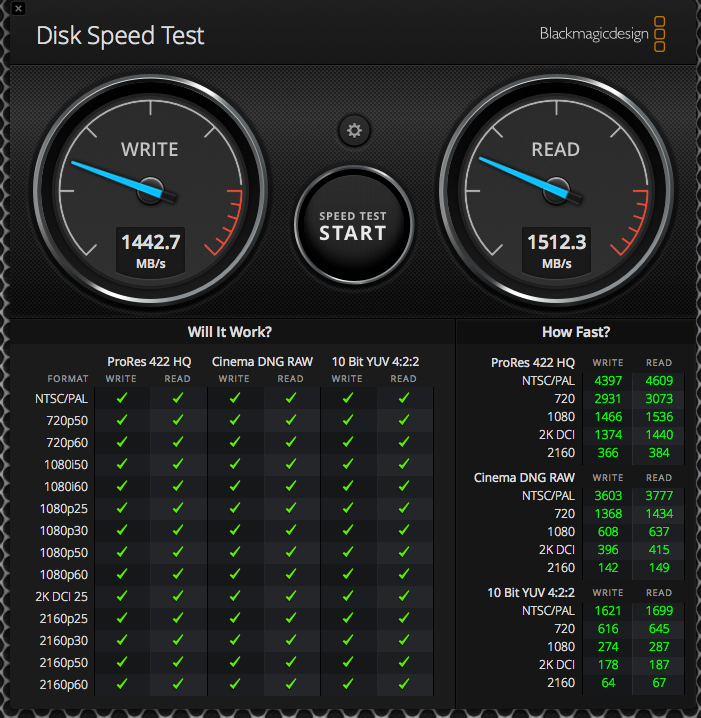

After updating the firmware on the 970EVO Plus there was a significant improvement and is able to be used as a boot device. Obviously its restricted by the PCIe 2.0 slot, but never the less .... much ... much better!!970EVO Plus.png
You need to upgrade to 1xx.0.0.0.0 firmwares, 138.0.0.0.0 will make Slot-2 work at 5GT/s for everything and not only Mac Edition GPUs and 140.0.0.0.0 will make your Mac Pro boot from NVMe M.2 blades natively.
After you do all firmware upgrades, all Mac Pro slots will work as 5GT/s. Read the first post of this thread to upgrade your Mac Pro firmware: MP5,1: What you have to do to upgrade to Mojave
