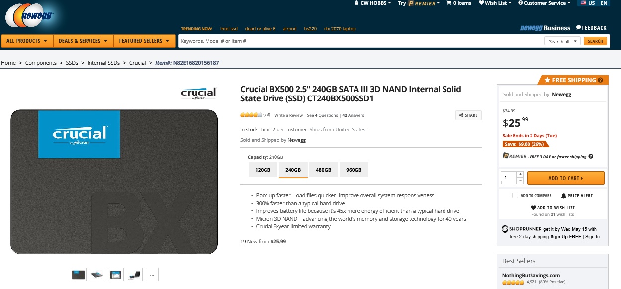

Are you seriously saying you could get a 256gb ssd for $25 by the end of the year.....................:eek:
Doesn't look like it will be a long wait - $24.49 at Newegg today ($1.50 coupon code)

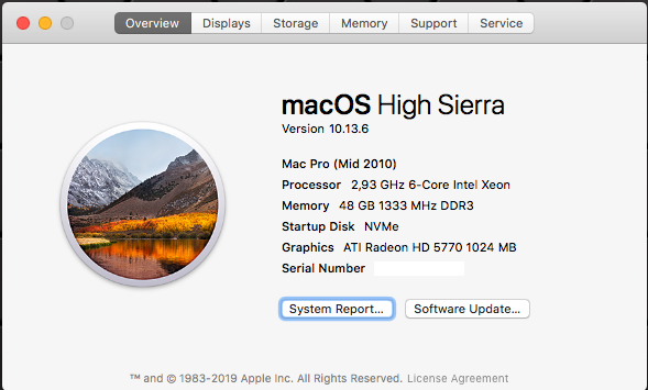

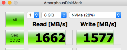

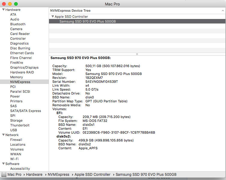

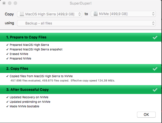

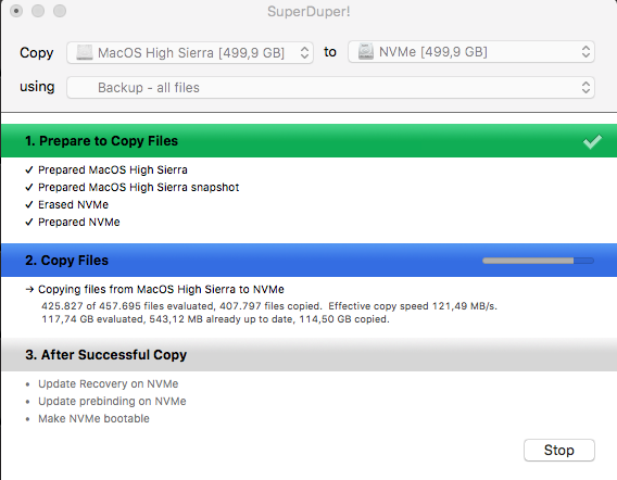

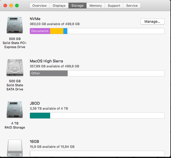

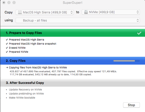

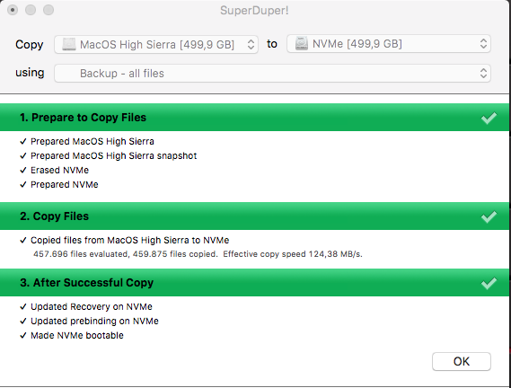

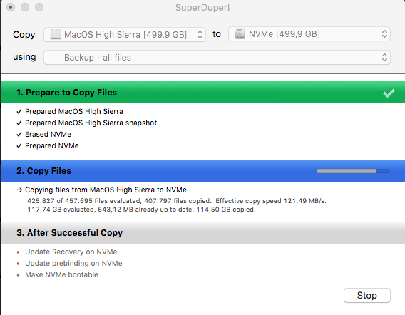

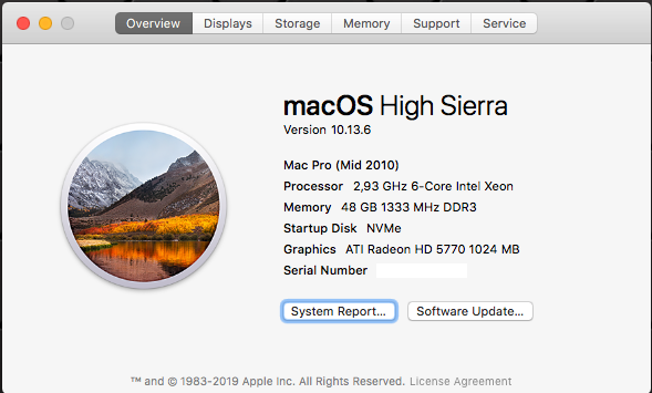

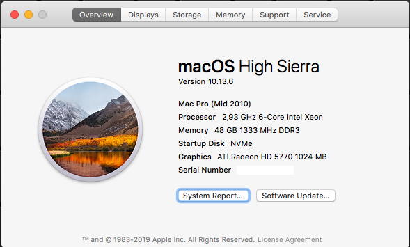

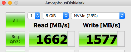

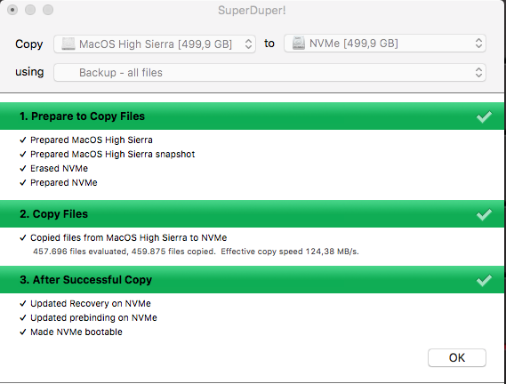

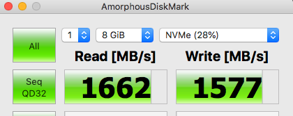

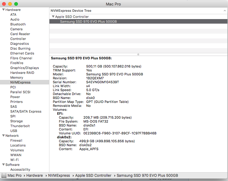

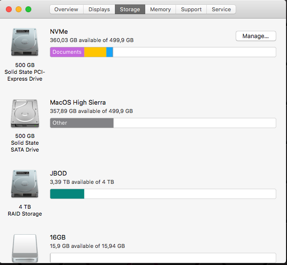

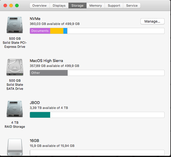

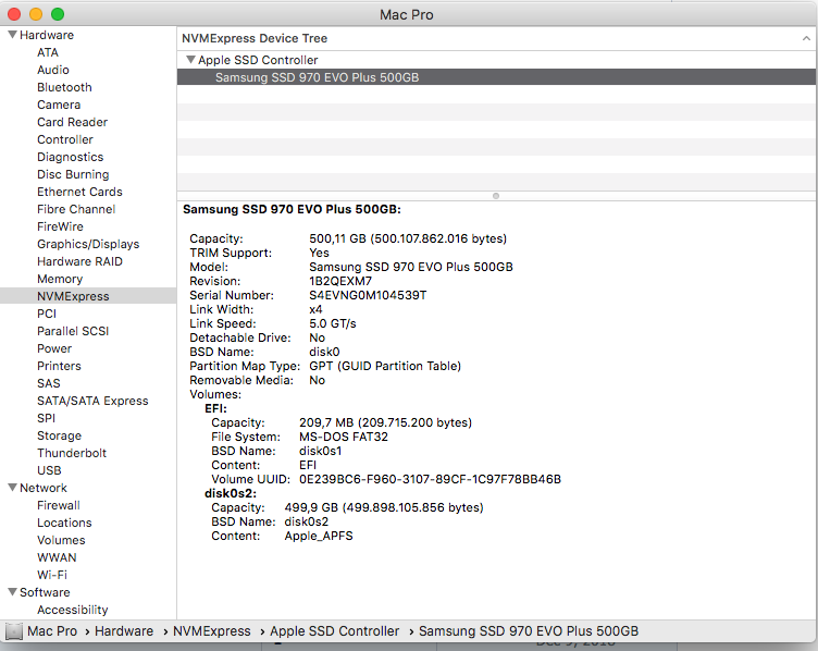

First of all the Evo 970 Plus SSD doesn't work all the time flawlessly.
The adapter I'm using is a x4 PCI Express to M.2 PCIe from Startech; I guess, due to the restrictions of PCI slot the SSD has its limitations (I use PCI slot 4) Based upon my bootrom (140.0.0.0.0) I can get the NVME bootable.
To be quiet honest I would have expected more, but then again the speed is at least 3x the speed of my Samsung 860 SSD
In general I'm quiet satisfied with the performance, but it could be better. :)
I got some screenshots to give you an idea
View attachment 832445 View attachment 832446 View attachment 832447 View attachment 832448 View attachment 832449 View attachment 832450
So you can boot from the Startech unit as well. Im interested in this one as they are easy to get and cheap in Canada
