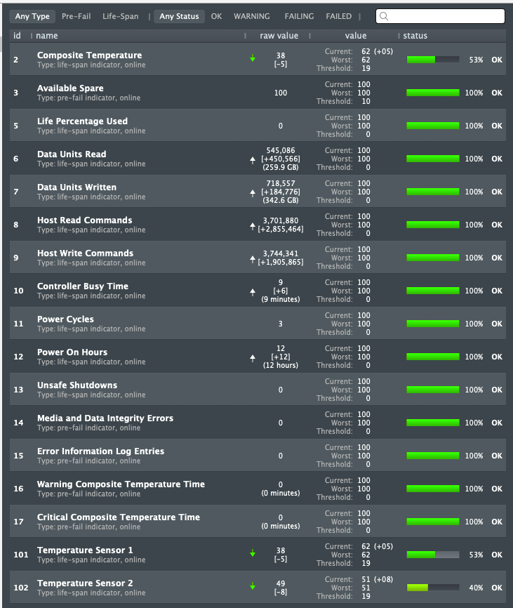

I don't know about yours, but I overheated a 970Pro five minutes after power-up, while Spotlight was indexing. Some AHCI PCIe drives start thermal throttling very easily too, like SM951-AHCI.
Since most of the year we are over 30ºC down here with some summer days near 40ºC, I personally wouldn't use any PCIe drives without a heatsink, not even for testing. You should use DriveDX and check your temps, warm drives have less endurance and fail sooner.
FWIW... That's probably a pic of a dual M.2-SATA controller. It's highly unlikely that those M.2 ssd's would ever get too hot to throttle. ;)

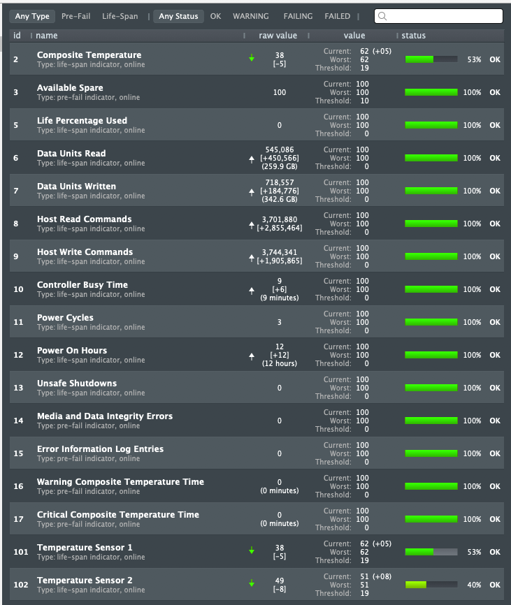

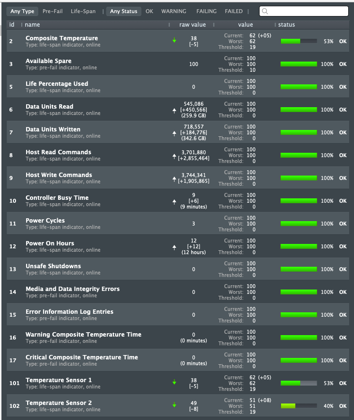

UPDATE: Installed the 970 PRO (good looking blade in its package :) and getting > 1.5k seq read and write speeds.
DriveDx is telling me all OK, except...
Are the temperatures unsustainably high?
ID 2, Composite Temperature: 53% OK
ID 101, Temp Sensor 1 also 53% OK
ID 102, Temp Sensor 2, 40% OK
Attaching a screenshot
mike
tsialex
Contributor
Jun 13, 2016
13,461
13,611
mike
It's normal, DriveDX temperature sensors give a erroneous impression here, it shows the temperature % relative to the maximum recommended operating temperature.
uimike
macrumors member
Oct 31, 2018
34
4
California
And DriveDx is now saying current temperature 37 Celsius (was largely idele) - Yay!!!!!!
