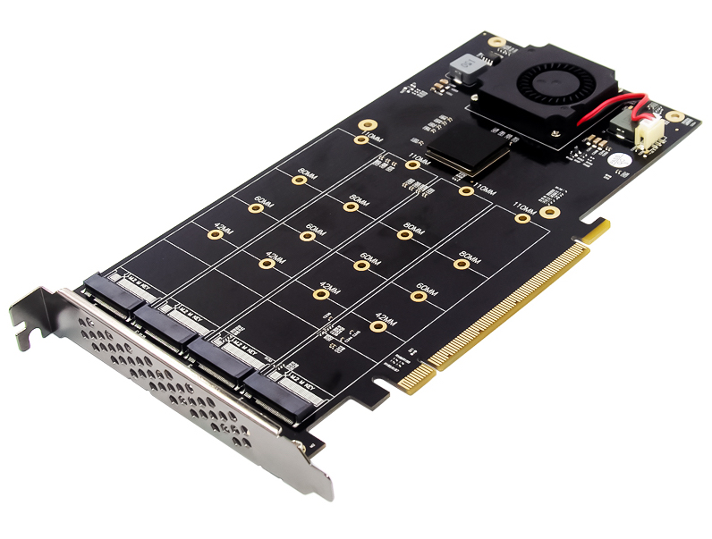

Just as a matter of interest, what is the card you have?
It's some kind of HighPoint 7101a . At least it has identical PCB-layout and the same PLX8747 chipset.
They were on Aliexpress for 190 Euros tax included some two years ago. Actually there are similary parts around even cheaper and eqipped with the successor 8748.
