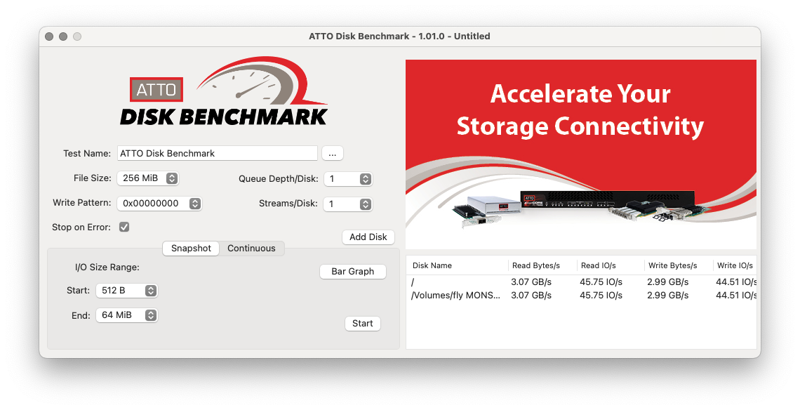

So here are the results:
The Raid-volume of two 1 TB 970 EVO plus...
...and the multi-disk-test with two 2 TB 980 PRO...
...which should add up to 6.14 GB/s read and 5.98 GB/s write.
So right: multiple disks seem to be able to reach a higher total throughput as a Raid-configuration

I didn't even know ATTO Disk Benchmark offering a multi-disk test. Just checked my version, which is 1.01.0 (2), and still can not find such an option. Is this a feature of a later version? Would really like to test this and compare to the Raid-results.
Edit: Just found out! "show results for all disks" has to be selected in the Graphs-window. Right?
Just click the "Add Disk" button to add more disks to test simultaneously.
The Bar Graph will add up all the disks for you. I wish it would show the bargraph info in a table like the Windows version does so you don't have to mouse over each graph to see which is the greatest.
The Windows version doesn't seem to have the multiple disks option though.
Yes, i have seen this. But the difference is so marginal that, without at least horizontal helper lines, it is just not noticeable. I did not know about the mouse over option (and did not find out "by accient" 😉 ).
