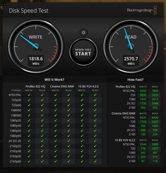

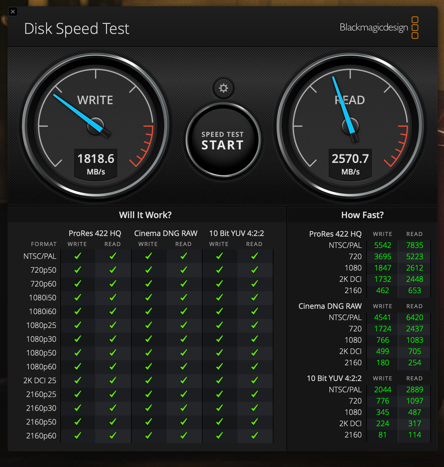

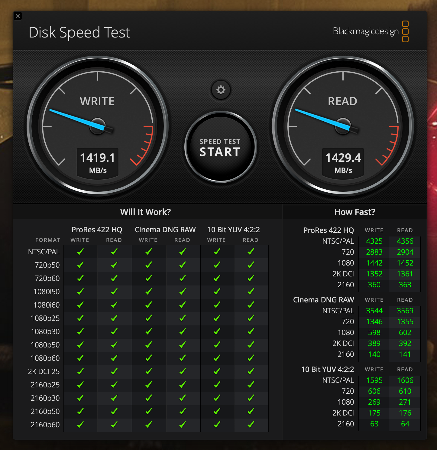

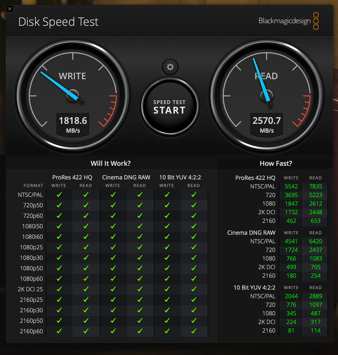

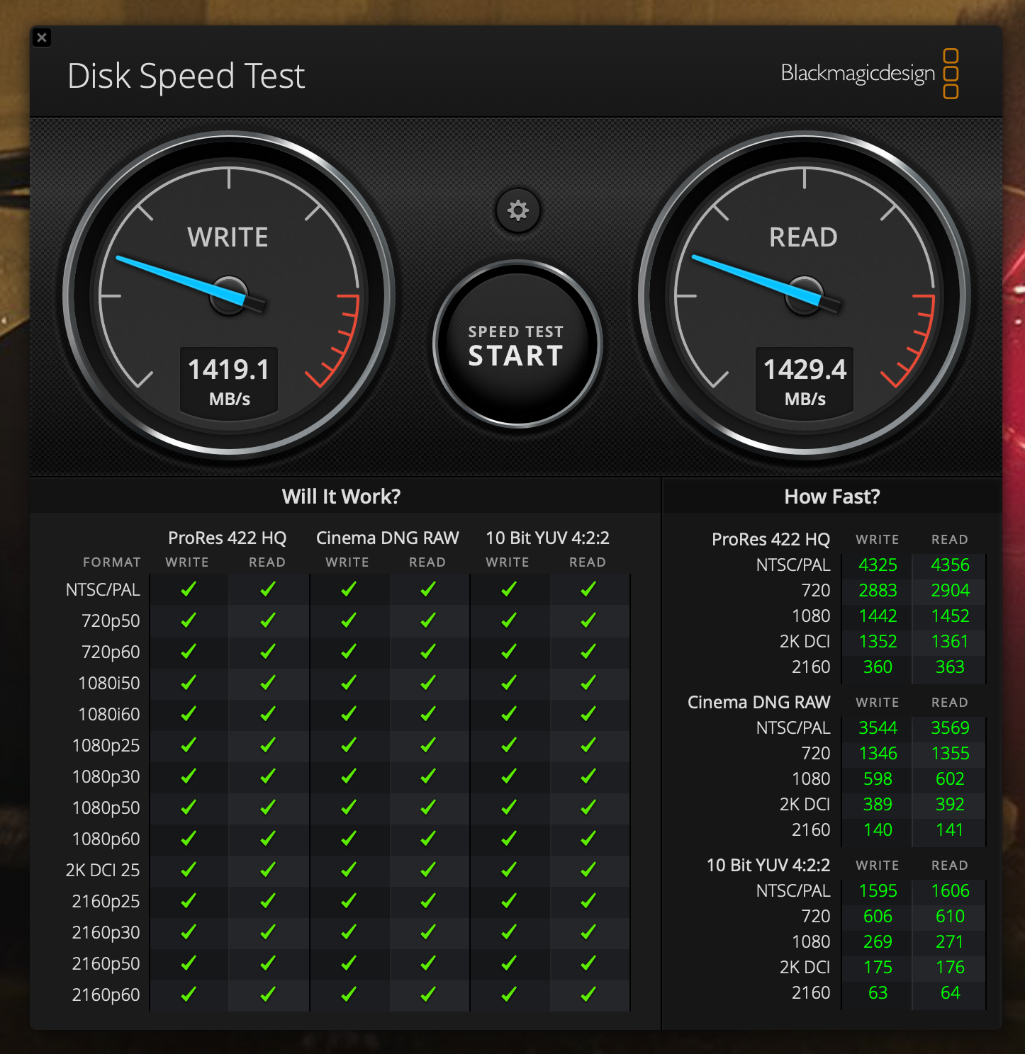

Hey guys! First time post but I've been following this thread for awhile. I just purchased and installed the Syba I/O Crest SI-PEX40129 in my mid 2010 Mac Pro. Before with the regular adapter I was getting around 1,400 read and write but now I'm only getting an increase of 1,800 write and around 2,500 read for some reason. I've tried both 16x slots as well. Any ideas?? This was an expensive purchase and I'd really like to get this resolved.
Also, speeds seem to be very inconsistent. For examples it can go from 1,800 write and go as low as 800-900. This happened with the old adapter too.

Hey guys! First time post but I've been following this thread for awhile. I just purchased and installed the Syba I/O Crest SI-PEX40129 in my mid 2010 Mac Pro. Before with the regular adapter I was getting around 1,400 read and write but now I'm only getting an increase of 1,800 read and around 2,500 write for some reason. I've tried both 16x slots as well. Any ideas?? This was an expensive purchase and I'd really like to get this resolved.
Also, speeds seem to be very inconsistent. For examples it can go from 1,800 read and go as low as 800-900. This happened with the old adapter too.
First, when asking help please post all pertinent facts, you didn't post about your blade at all.
Probably a tired PCIe SSD. Very common with Samsung AHCI models like XP941/SM951-AHCI, SM951-NVMe and EVO models.

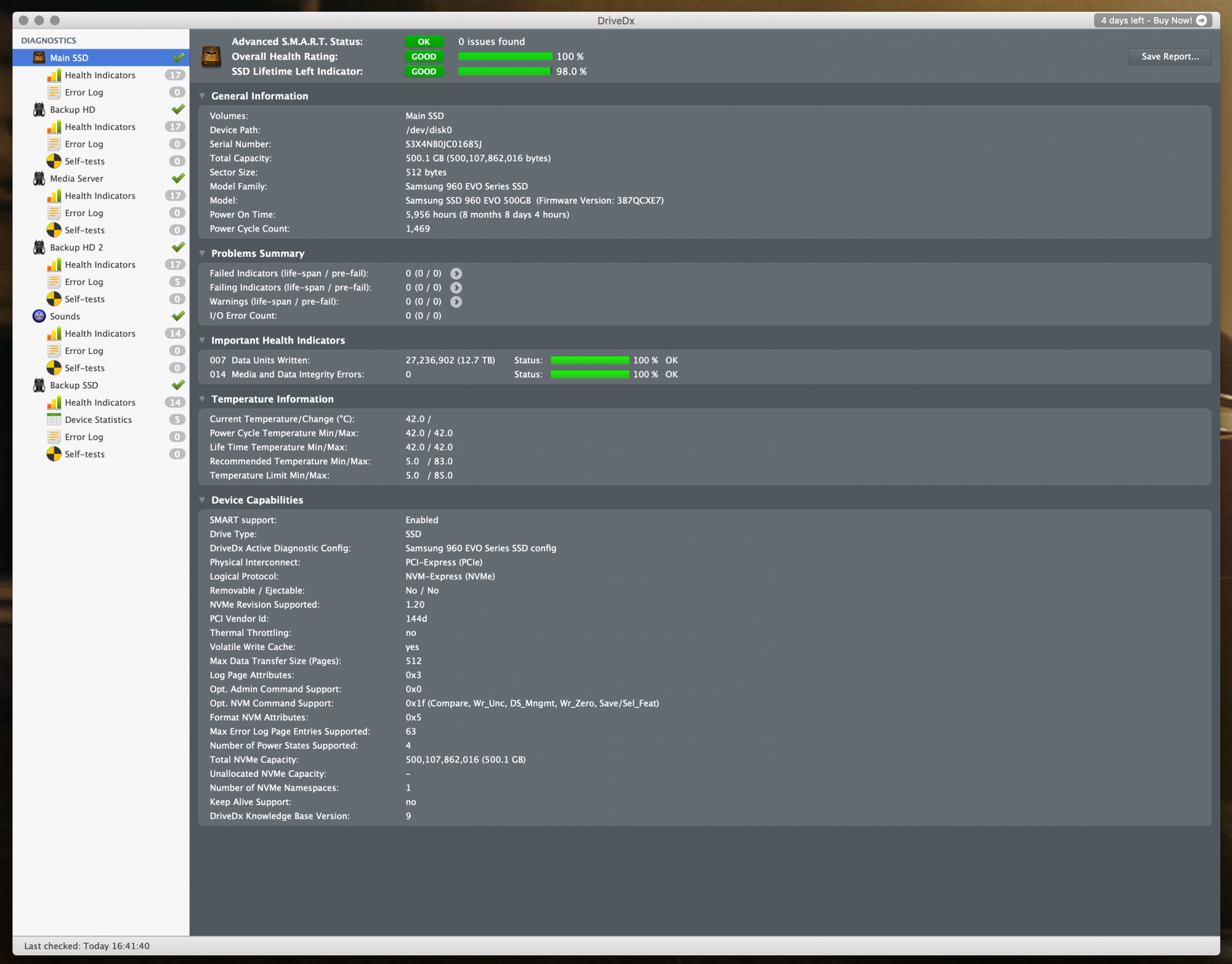

My bad. It's a Samsung 960 EVO 500gb. It's only about 2 years old but I'll definitely try DriveDX.
PCIe SSDs made from TLC/QLC NAND show very high throughput while the data is on the SLC cache, when the cache is full the write speed drops vertiginously to the real throughput of the TLC/QLC NAND memory.
Only blades that have SLC and/or MLC NAND, like 970 PRO, don't suffer from cache problems, since the throughput of the real NAND is high enough.

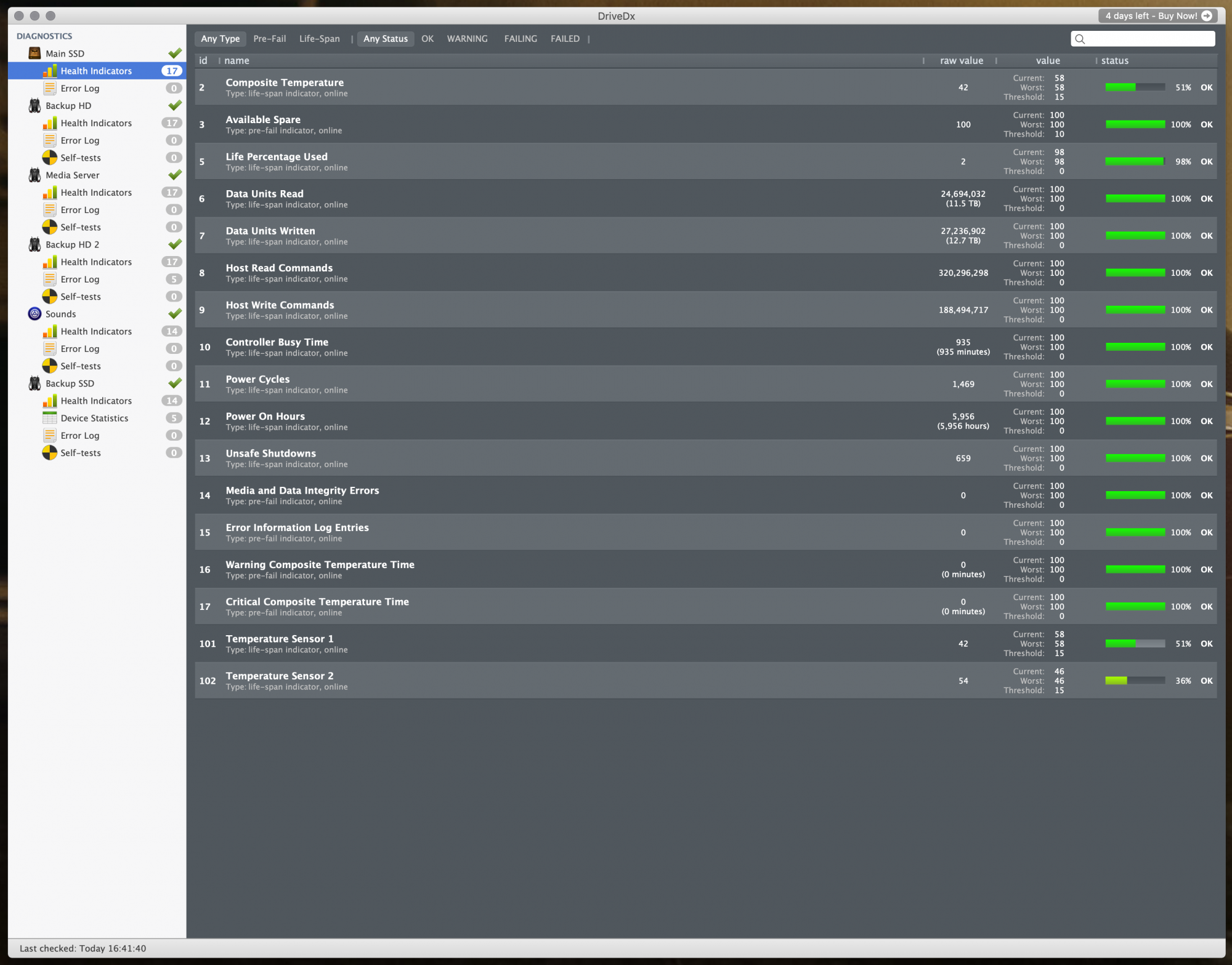

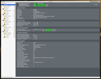

Here's what my drive looks like in DriveDx. I didn't see any errors or signs of a bad drive.

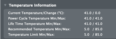

PCIe SSDs have multiple temperature sensors, most apps like iStat Menus and TGPro don't read all the sensors.
Install DriveDX, 14-day trial, and pay attention to spikes of temperature. It's not the median temperature that is the problem, but the sudden spikes.

Lifetime as in the SSD lifetime, maximum temperature ever achieved. An user can’t reset it, it’s written inside the SMART log in the part of the SSD NAND that stores non user accessible data.

If you have a spike of 90ºC, you cooked your SSD and you already lost your warranty.
For continuous monitoring you will need smartmontools.
