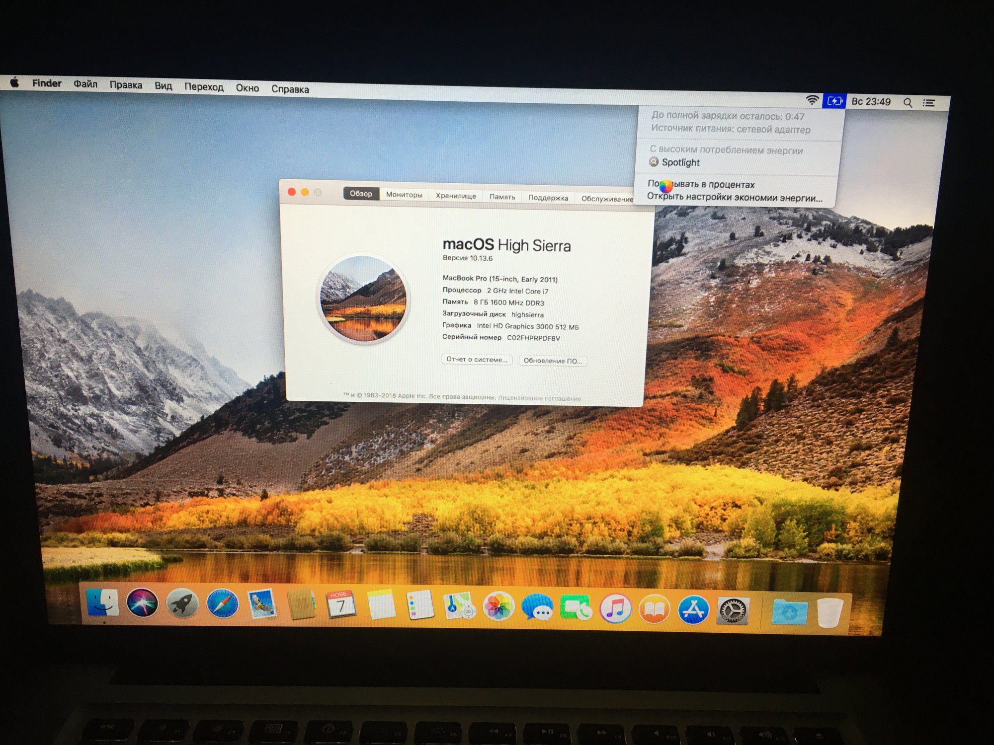

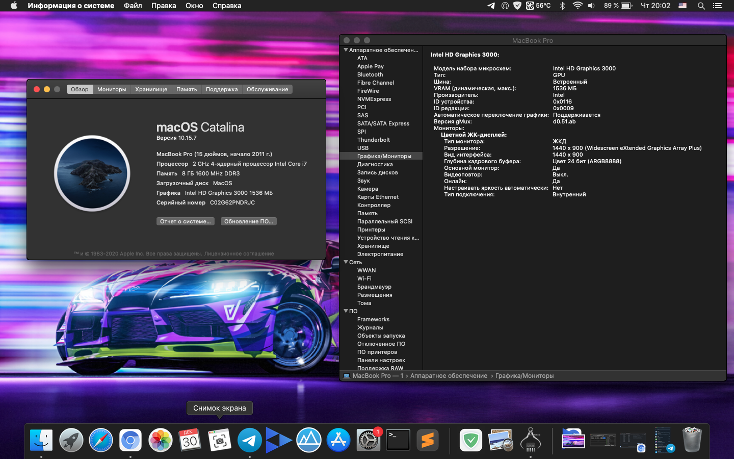

hello everyone, another mac15 fixed , thanks
have you heard anything about bigsur yet?

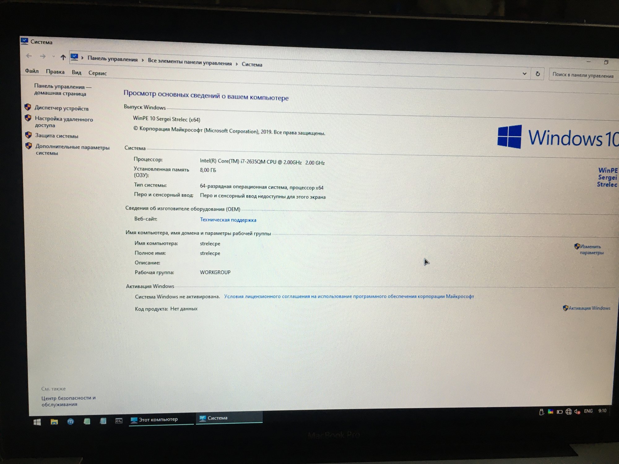

windows pe 10, working, without video driver on gpu and sound do not working, but working fast. win pe do not install drivers when you connect to internet
Where is connected the USB32HDPRO?
