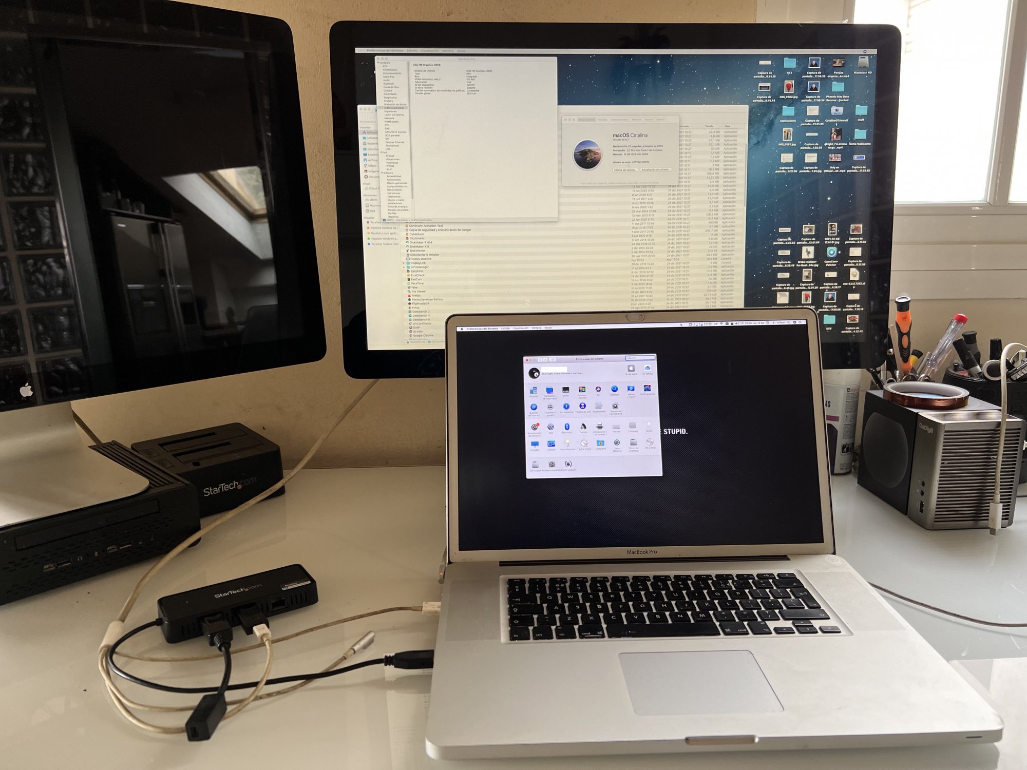

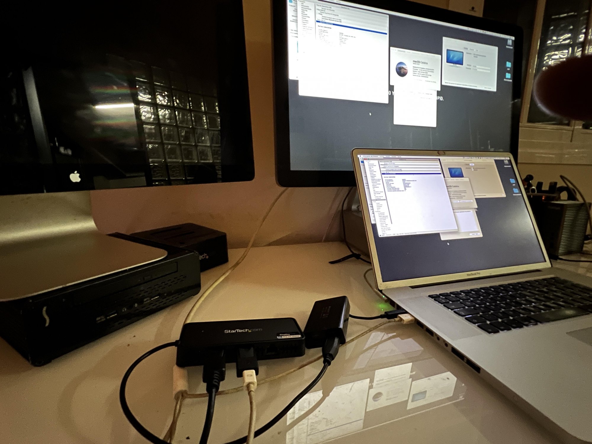

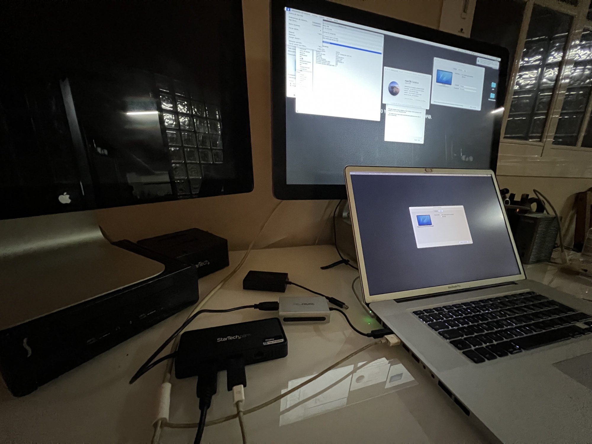

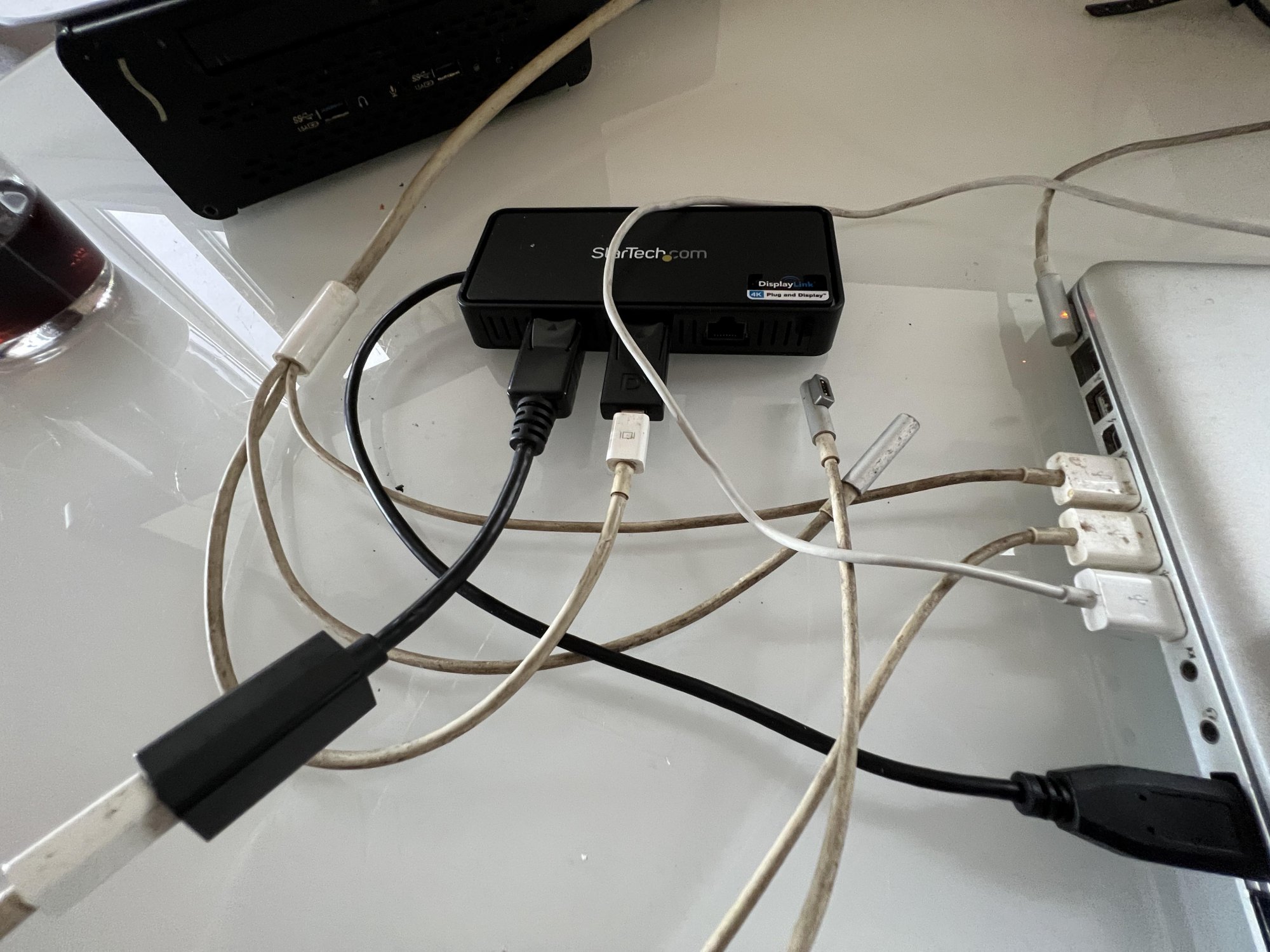

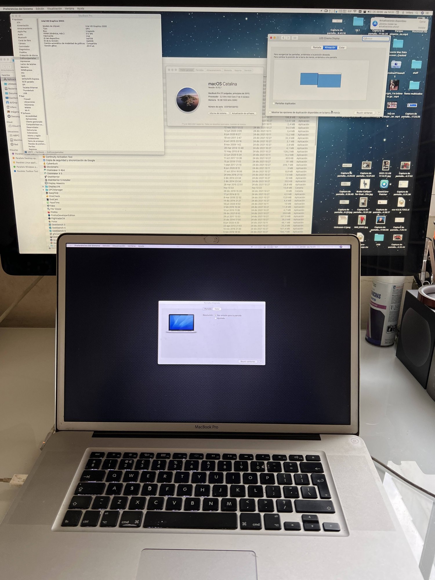

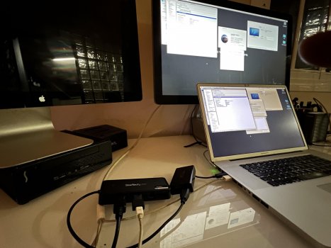

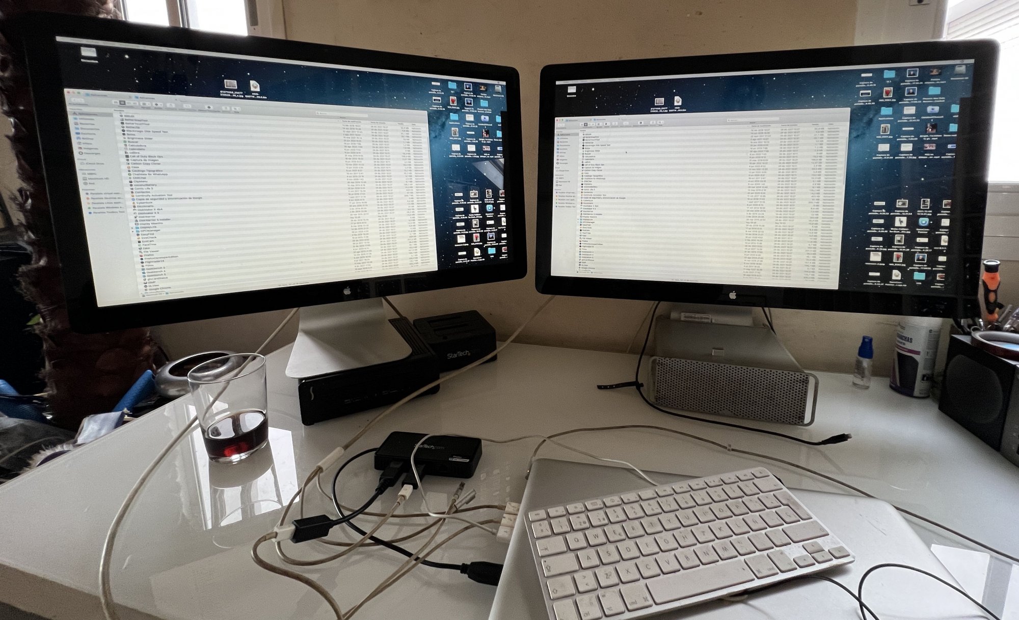

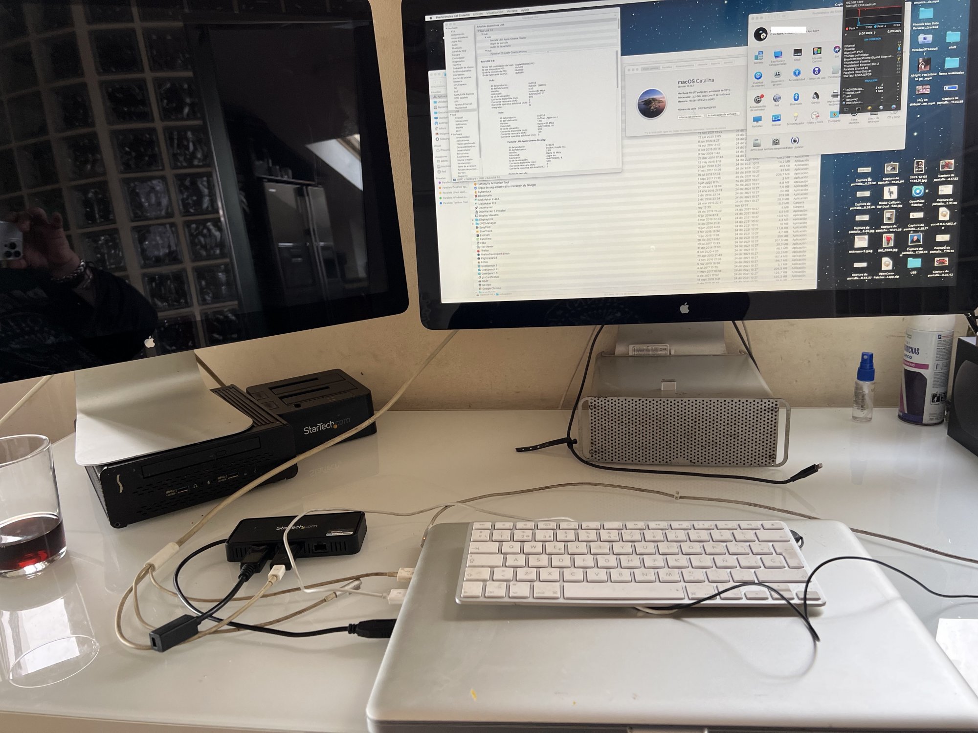

Firstable, apologize for the delay in answering. It is some moths that I gave the Macbook pro 17" to my brother, demuxed with the great soft of @dosdude1 . So I have asked him to borrow me, as I want to include some pictures.
As I have always said, you can look for my posts, I have been using the demuxed Macbook Pro with an external monitor, Apple Led Cinema Display 27", connected to my Startech adapter. Well, that is not exact. Sometimes I have been working connected to 2 Apple Led Cinema Display 27", in clamshell mode. I dont recommend use the two monitors together the display of the Macbook. It´s very laggy ans unresponsive. You don´t need the Thunderbolt adapter, a Expresscard is just fine, and much cheaper. You just need an USB 3.0 port, as I said so many times.
I include picures of my adapter, and the setup in clamshell and normal. Hope it helps. Also made a little video where can be seen how nice it works. Send me a private message if you want me to send it to you. As I have always said, if I can help in any more, just tell me.

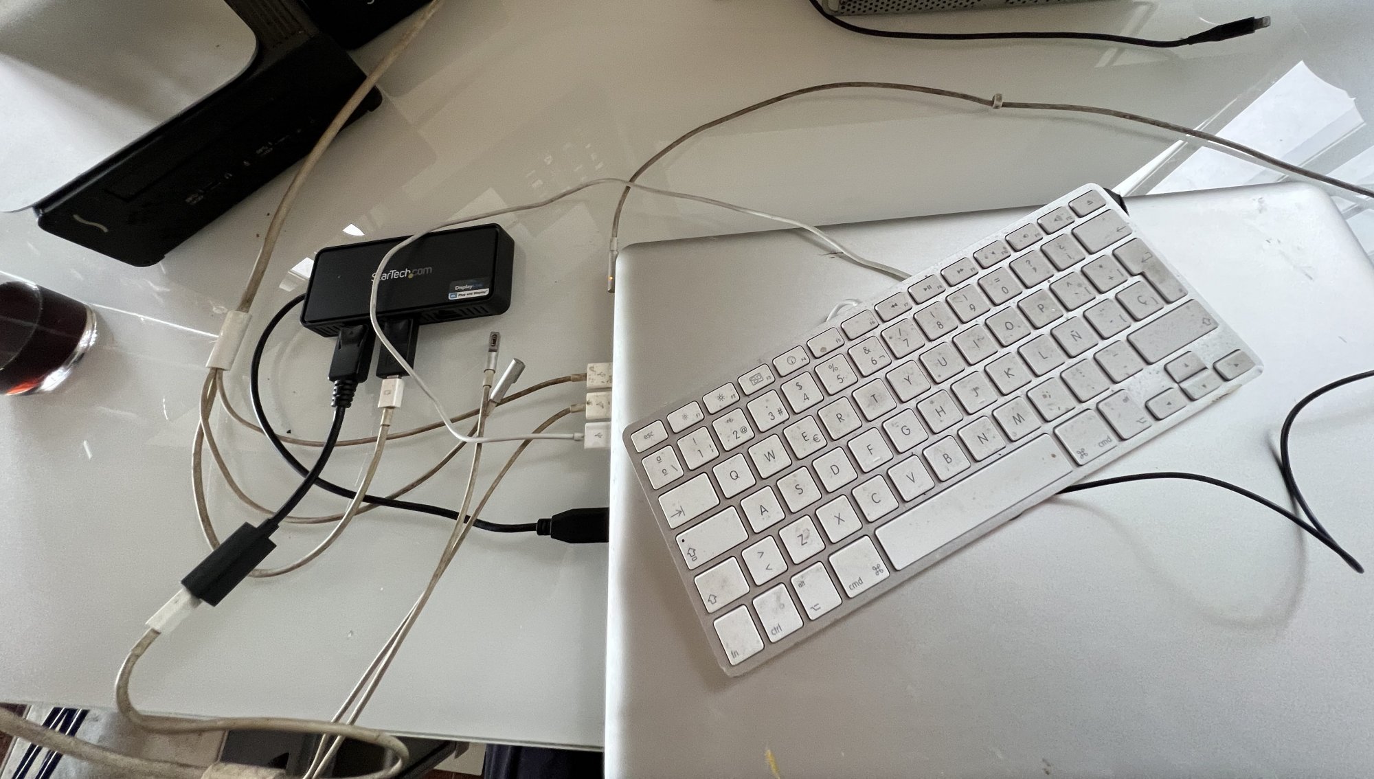

Same setup, connected to a Kanex KTU10, and an Startech TB2USB3ES.

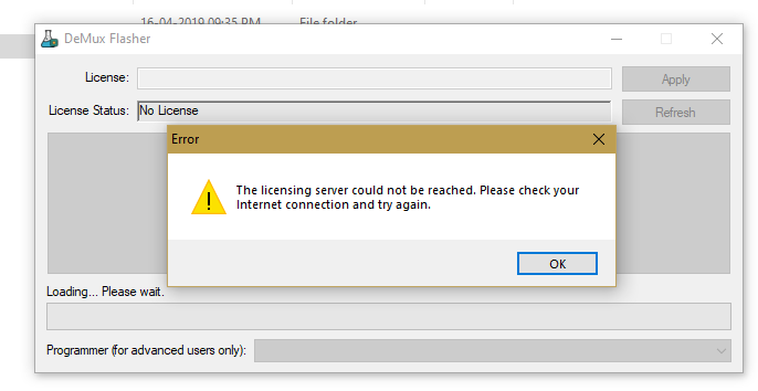

Does anybody receive an error regarding licensing server? I have purchased demux key but whenever I open demux.exe it shows "the licensing server could not be reached. Please check your internet connection and try again."

Nop here. Three macbooks demuxed without any problem. The date on Windows is right?

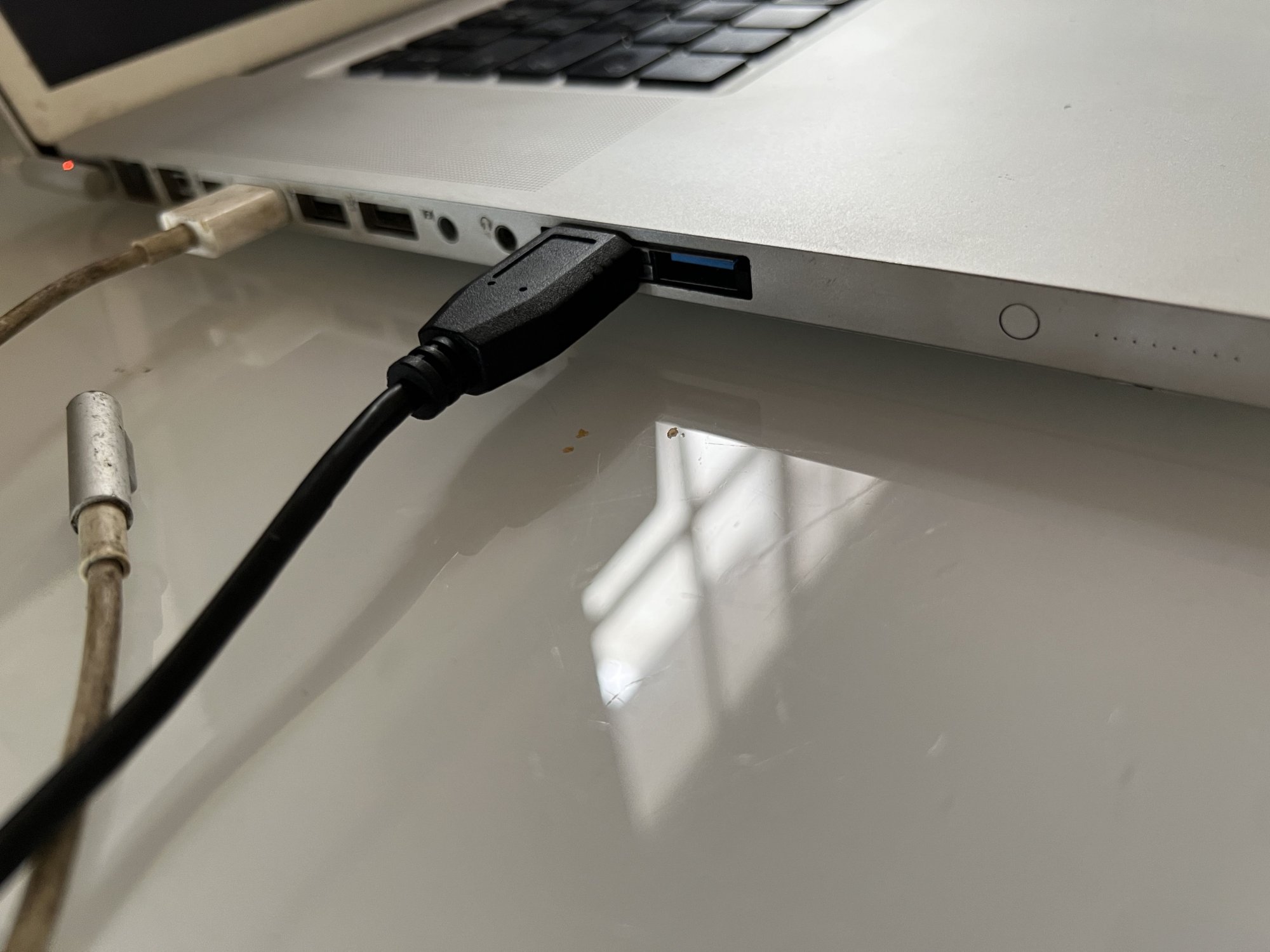

If you look at the images this character provided after trolling me, you'll see what appears to be a blue usb 3.0 port on the side of whatever model MB is being used in the image. (Correct me if I'm wrong anyone, I've read that just the blue color alone doesn't necessarily mean it's a usb 3.0). I'd like to know, just out of curiosity though, what exact model this apple genius is showing in this image.

I looks like he is using the ExpressCard (PCMCIA) slot to get USB 3.0 port. If that could be sourced today in 2022, then I suppose that could work as alternative to Thunderbolt -> USB 3.0...
Reactions: Aguymac
If you look close enough to this pic, i'm sure you can see 4USB ports. And like you said, you cheked the specs, there is no macbook pro with 4 usb ports.
It is a pcmcia/expresscard with 2 usb ports.
And these are only available for 17inch books.
Next time spend some money for glasses!
Now you can spend some money for usb3 cards...

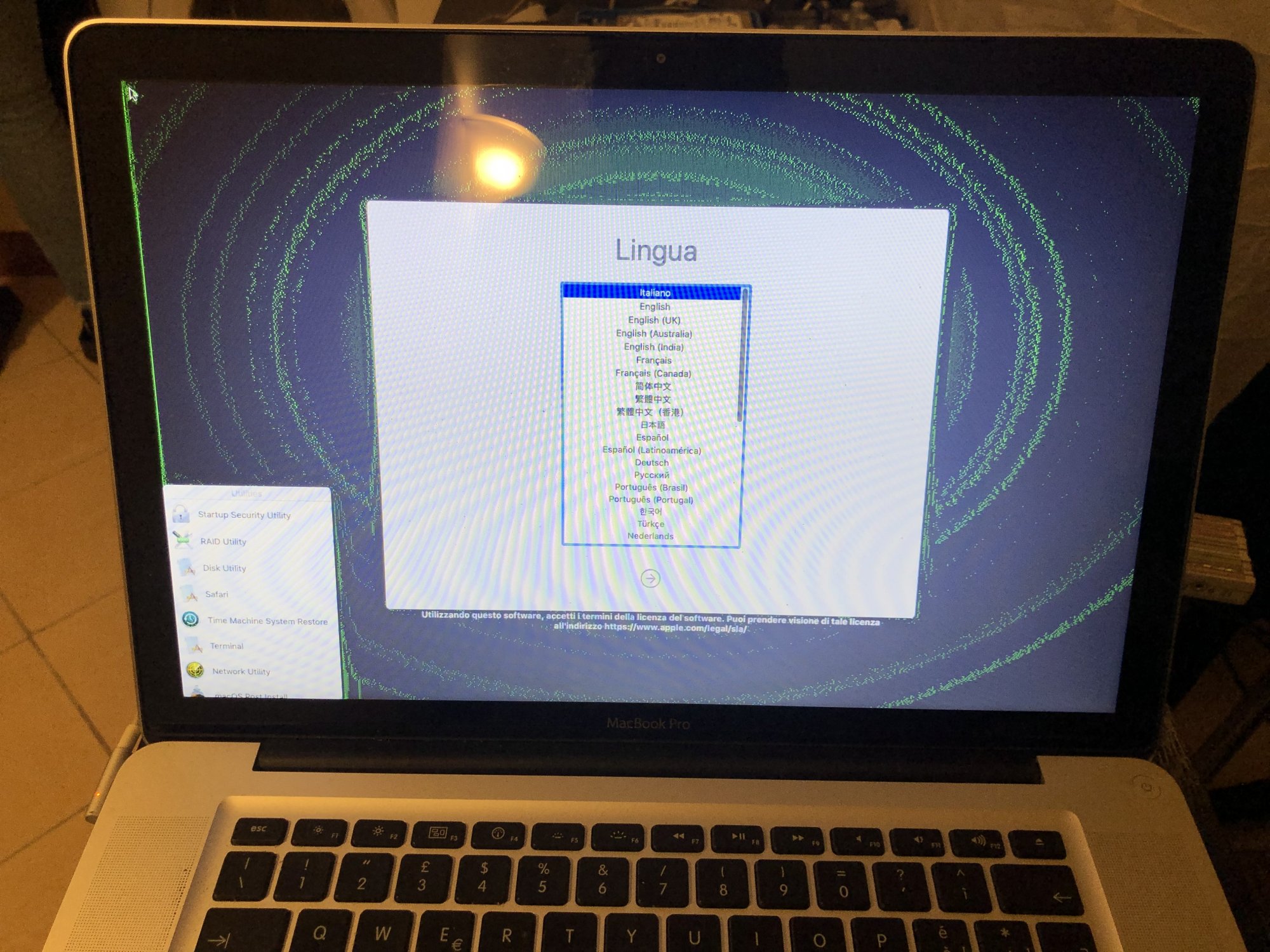

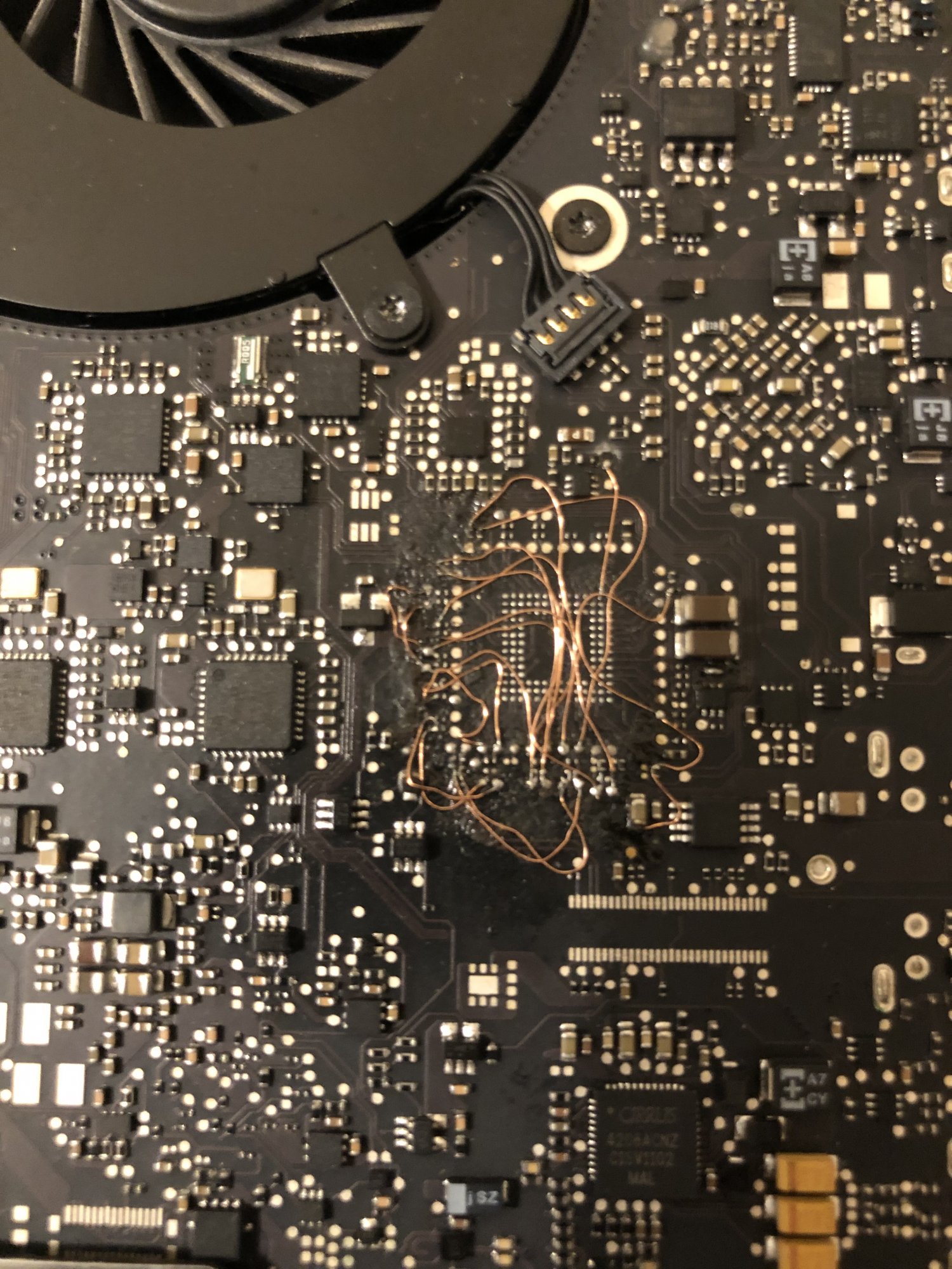

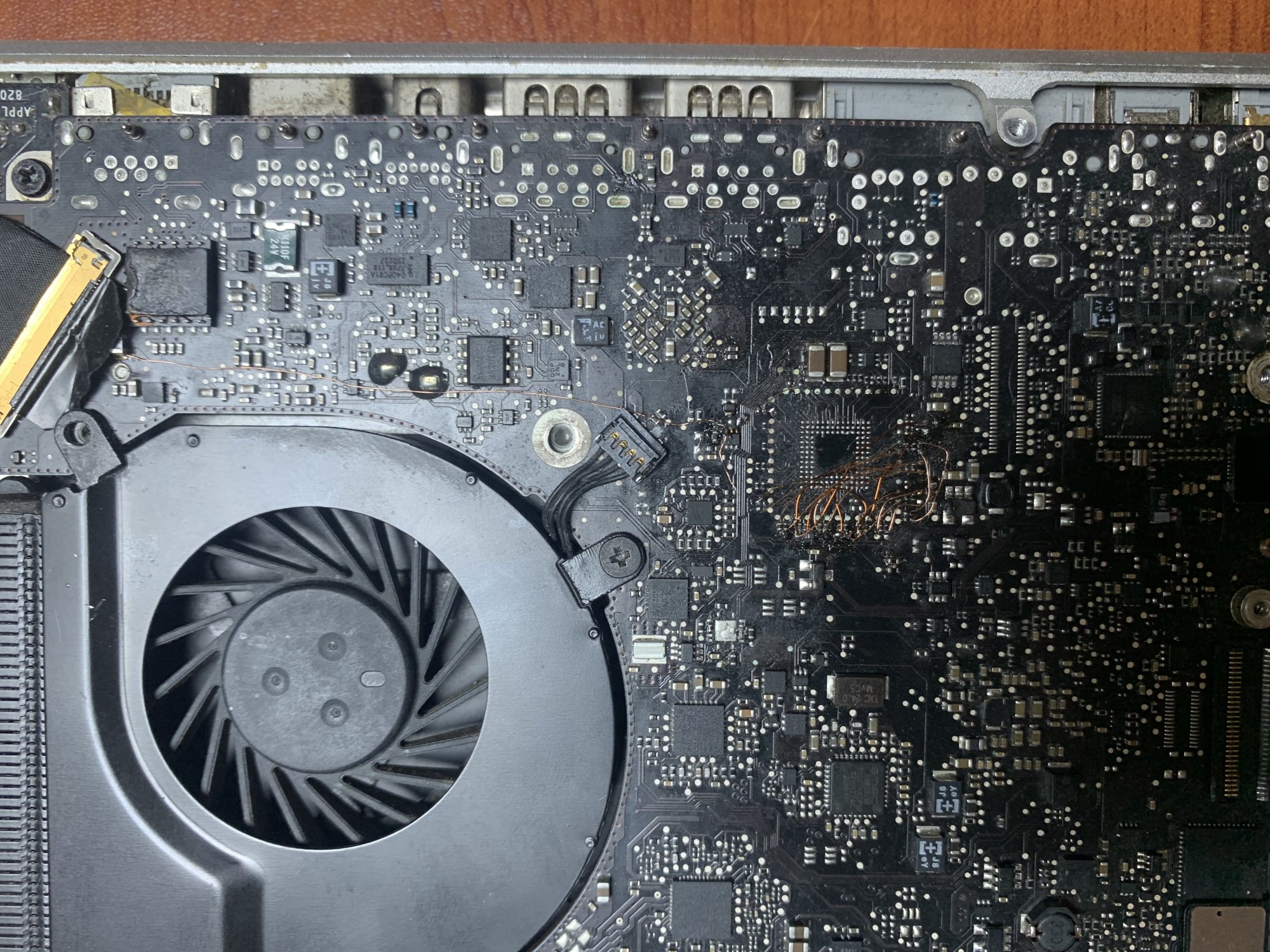

Hello @dosdude1! I purchased this "as is" MBP 15'' early 2011, and it looks like someone tried your gMux IC Bypass, isn't that? Anyway as show in the pics, there are still video artifacts just after turn on the mac, that would persist even apply the code to bypass the AMD graphics. That could be bad CPU graphics? It's al very slow and somehow not reactive sometimes. Any suggestion how to proceed fixing this machine? Tanks!
Looks like whoever did it removed the gMux IC completely, so there's really nothing you can do software-wise. My best recommendation would be to just get another really cheap MBP logic board with dead GPU and swap it in, then flash my DeMux firmware on it. Of course you could also just install a 2012 board since it's a 15". Or, if you have the capability, you can solder on another Lattice LFXP2-5E FPGA, remove all the wires, then flash DeMux on that.
Thank you very much for the quick reply. Not a problem to solder a new Lattice LFXP2-5E FPGA and flash it. But this will really worth it? There is any way to exclude that is CPU problem related?
Yeah, I had that exact issue with the wire mod on some systems, back when I used to do that. It has to do with the particular model LCD panel in it and direct routing to LVDS output of iGPU. That issue will not occur with my DeMux firmware applied.

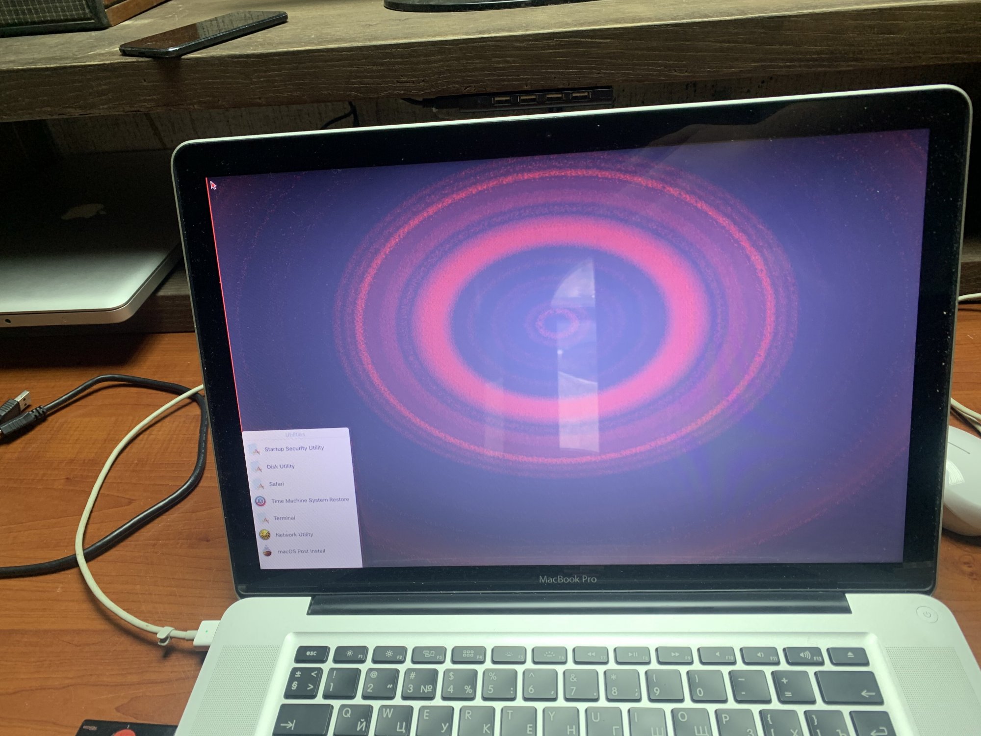

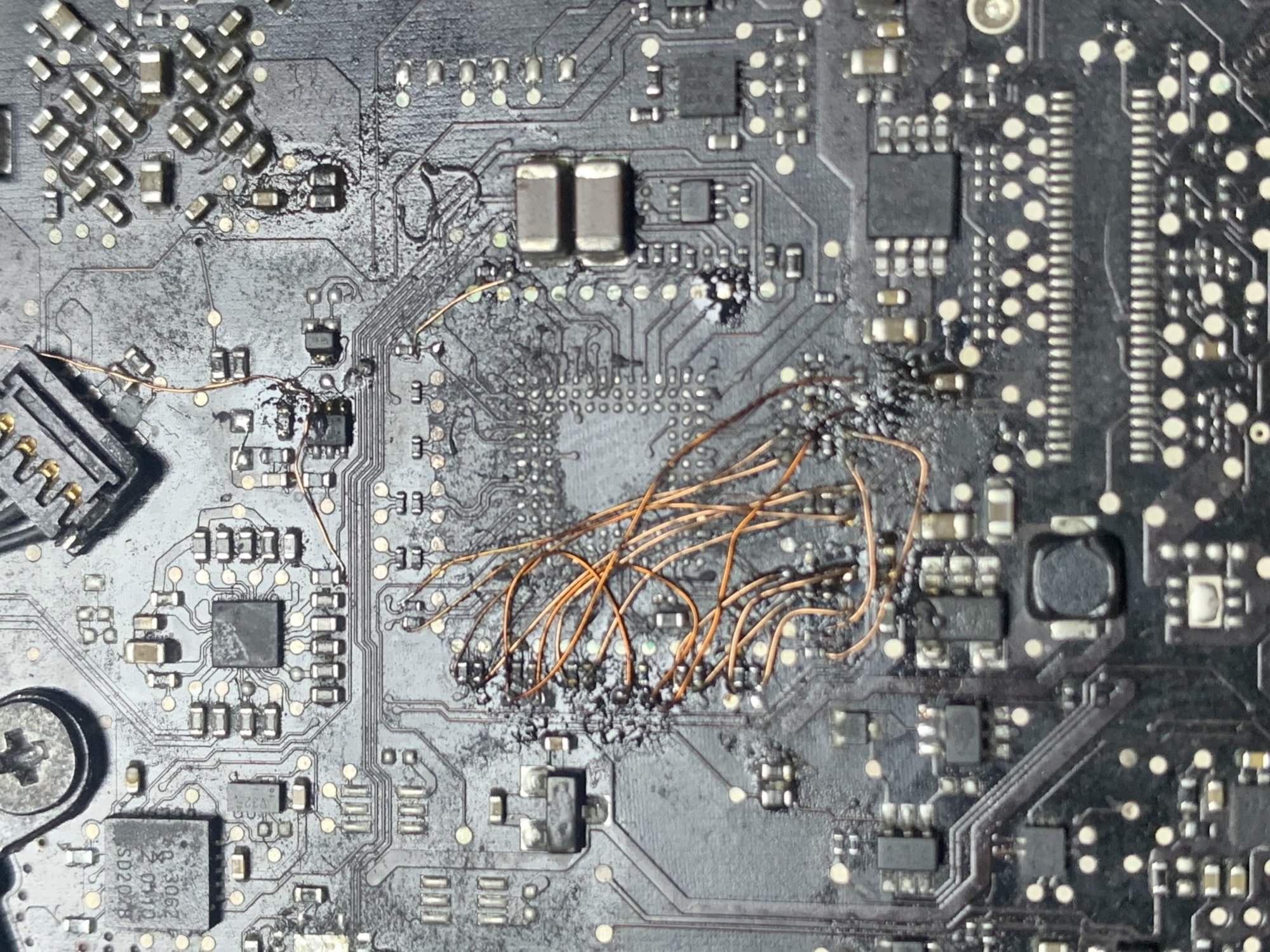

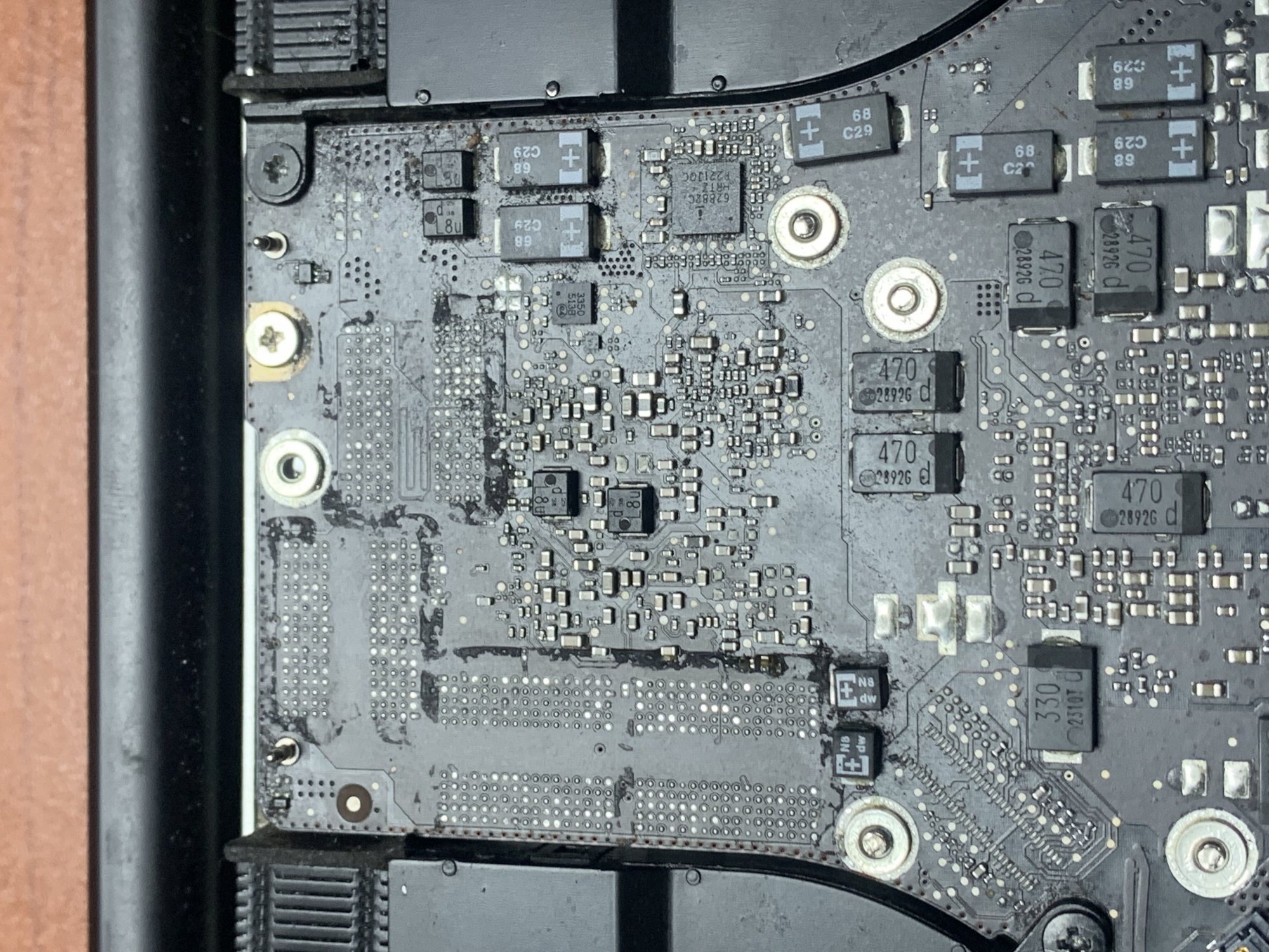

Hello @dosdude1
I recently picked up this 2012 15 inch MCP for it's display as I ripped the webcam cable on my 2010. The pawn shop selling it said that the motherboard was dead, however, after opening it up I saw that somebody performed a gMux bypass and desoldered the vRam chips. I managed to solder back the damaged wires and add those that were completely missing. Not sure if I missed a wire but here's the results I got.
Also after reading the post above I tried to see what would happen on a different display and all I got was a black screen.
Any advise will be much appreciated.

Hello @dosdude1
It's the same issue as @slimmy18222 has. Soldering a new gMux IC (Lattice LFXP2-5E), removing all wires, and flashing DeMux firmware will fix it.
Thank you for replying. Is there anything I can do to make the wire mod work?
I don't want to put money into it as it just doesn't make sense for me right now
Somebody really messed with this board and even desoldered the GPU chip
If I can make it work by fiddling around with it a bit more I'd be happy and if not then it is what it is
