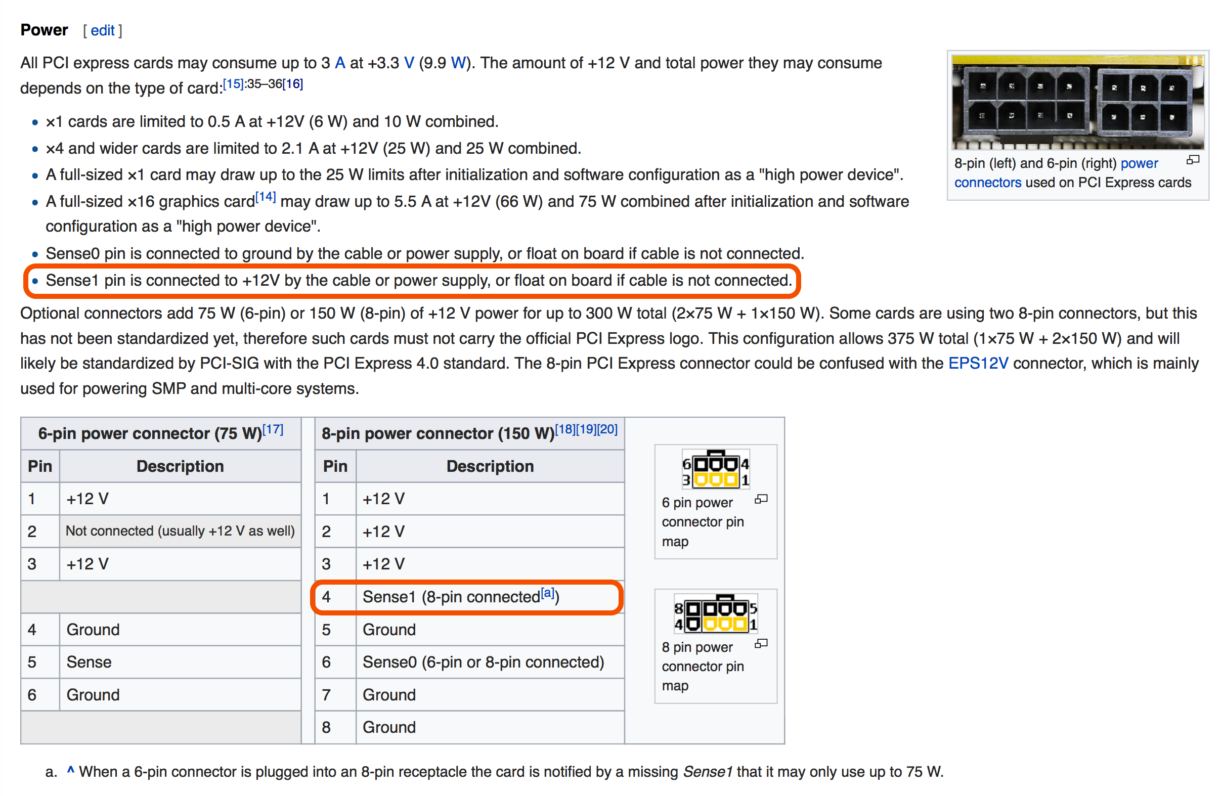

However, when I study the 8 pin spec. I found this.
According to this, pin 4 should be connected to a 12V line. But the tutorial stated that he connected this pin to the GND line.
For me, That doesn't really matter. Because I plan to connect a 6pin cable only. I want to keep the connectors as little as possible. Either 6 or 8pin has three 12V line anyway, then I will further use my 6pin female to dual 6+2 pin to feed the card.
But I wonder how you guys connected this sense pin 1?

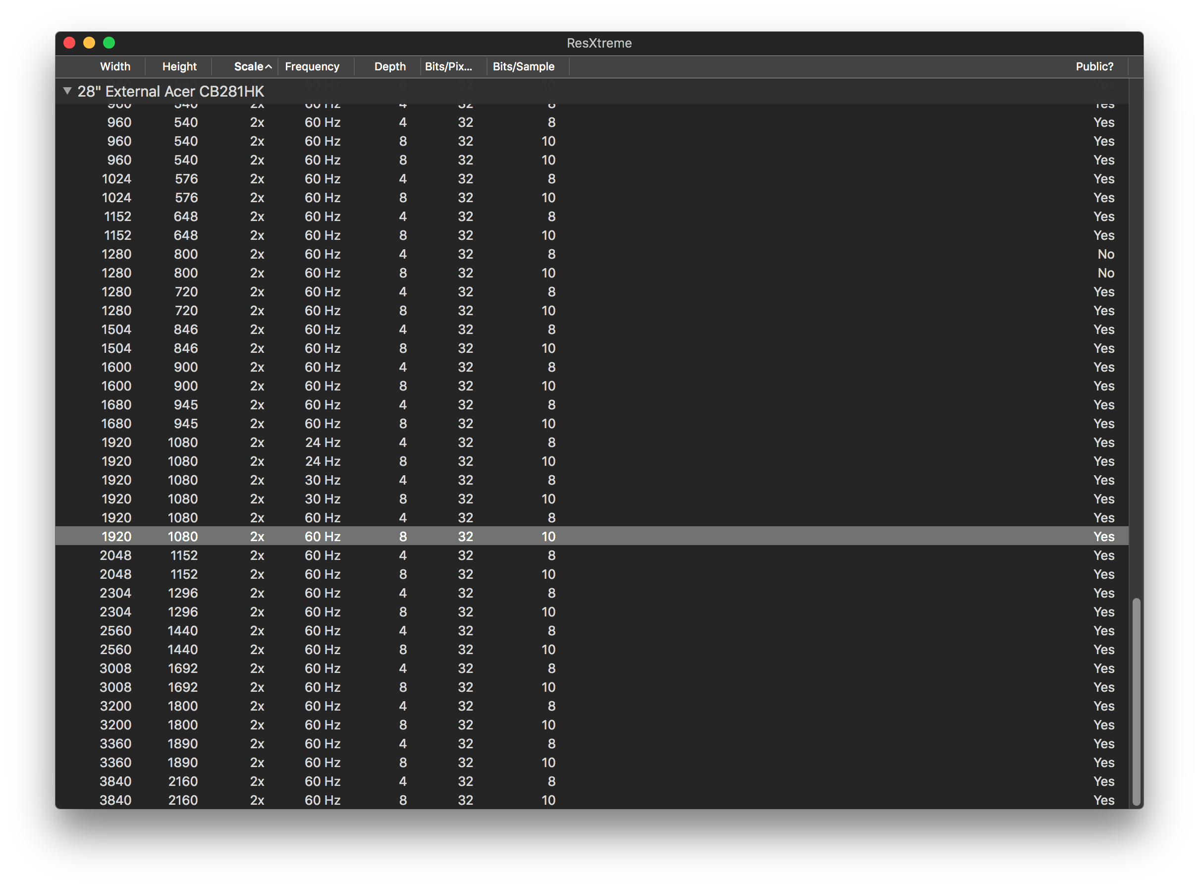

Hi!
Just to tell you i have finished this mod and tried it with a AMD RX VEGA 64. it works.
Now here are things that doesn't work right now (10.13.4 Mac Pro 5.1 2010 2 x5690 64Gb RAM)
HiDPI is not recognized (gpu hooked to display ACER CB281K with DP)
early boot not displaying (does it work on vega frontier? maybe a problem of support maturity?)
the thing is noisy even idling on desktop (i am interested in how the VEGA FRONTIER cope with this.
thanks :)
The fan noise bug is a hot topic now. I won't say that's normal, but definitely very common for Vega.

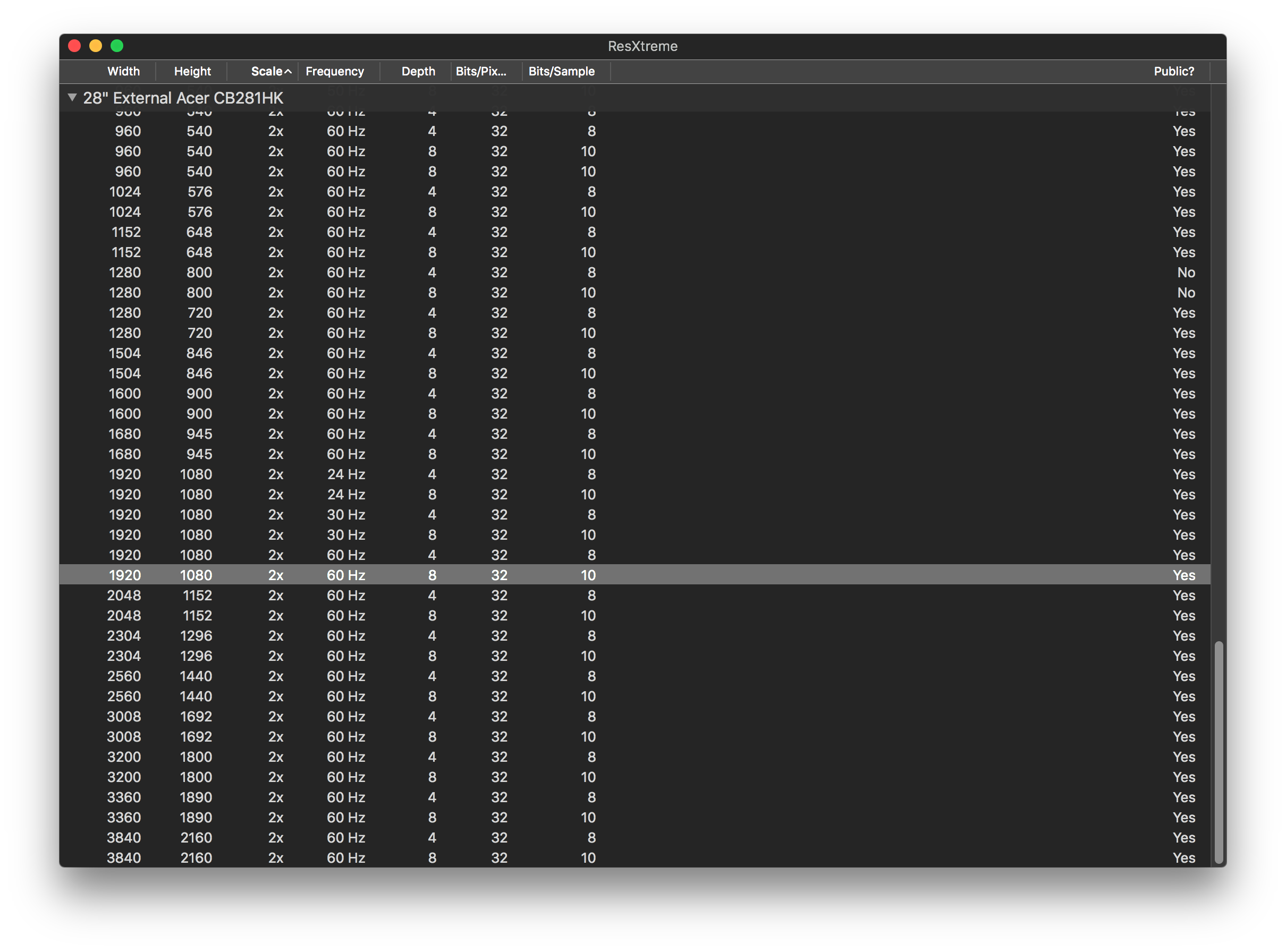

And can you elaborate more about the HiDPI issue?

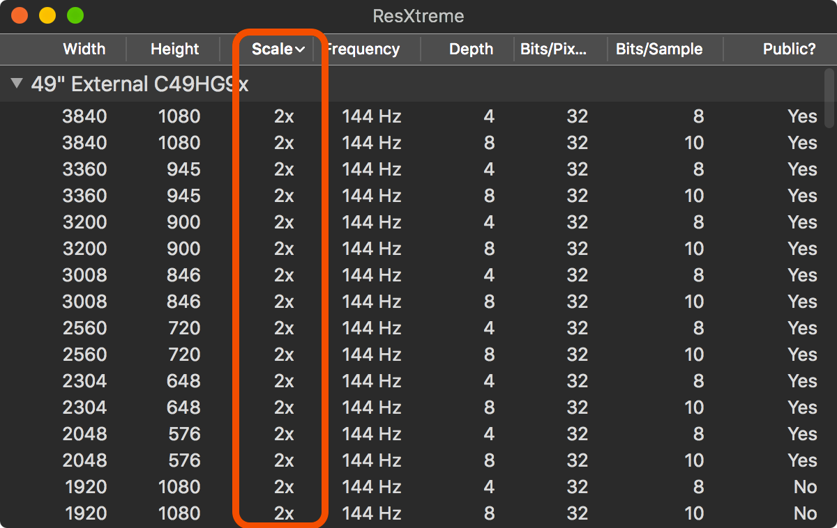

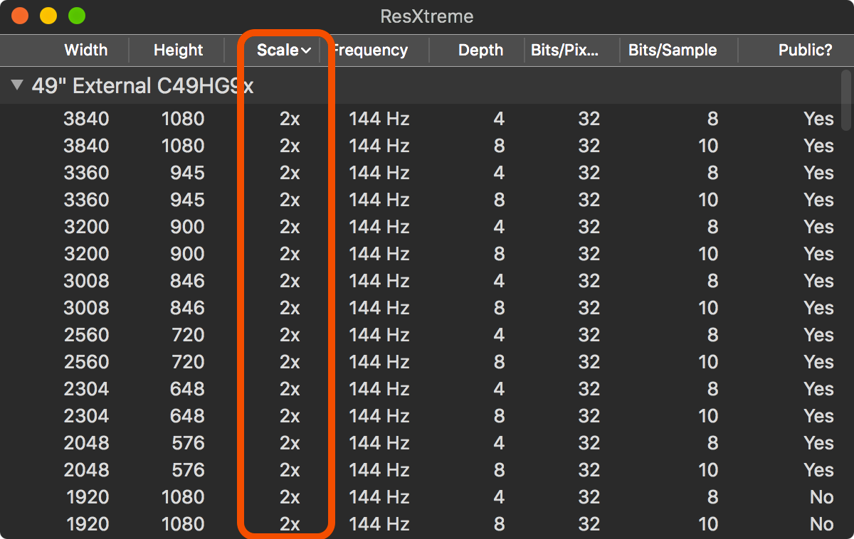

This little app can help to set HiDPI resolution. You may try.
http://resxtreme.com
All the "2x" resolutions are HiDPI.

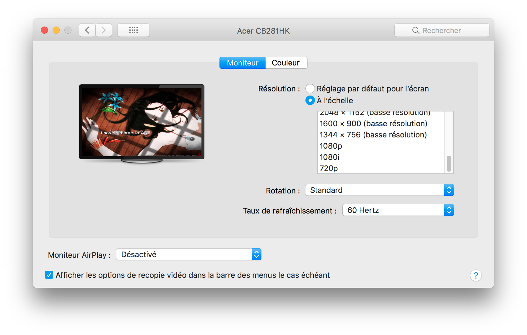

thx for all this. i’ll try tomorrow. when i say hires issue i mean no hires. display is 4k but i’d love to have 1920x1080 x2 but it does not shows up in display prefs
Usually, hold "option" key before you click "scale" in display preference should help. But I think set the resolution via this app is easier.
Anyway, I couldn't figure out Apple's standard. I've seen "HiDPI" in system preference before, but now, it's the other way around. Nothing follow means HiDPI, otherwise, will be follow by "low resolution".
But Apple did improve the system info page, now if in doubt, you can go to check what's the rendering resolution, and the "UI looks like" resolution.

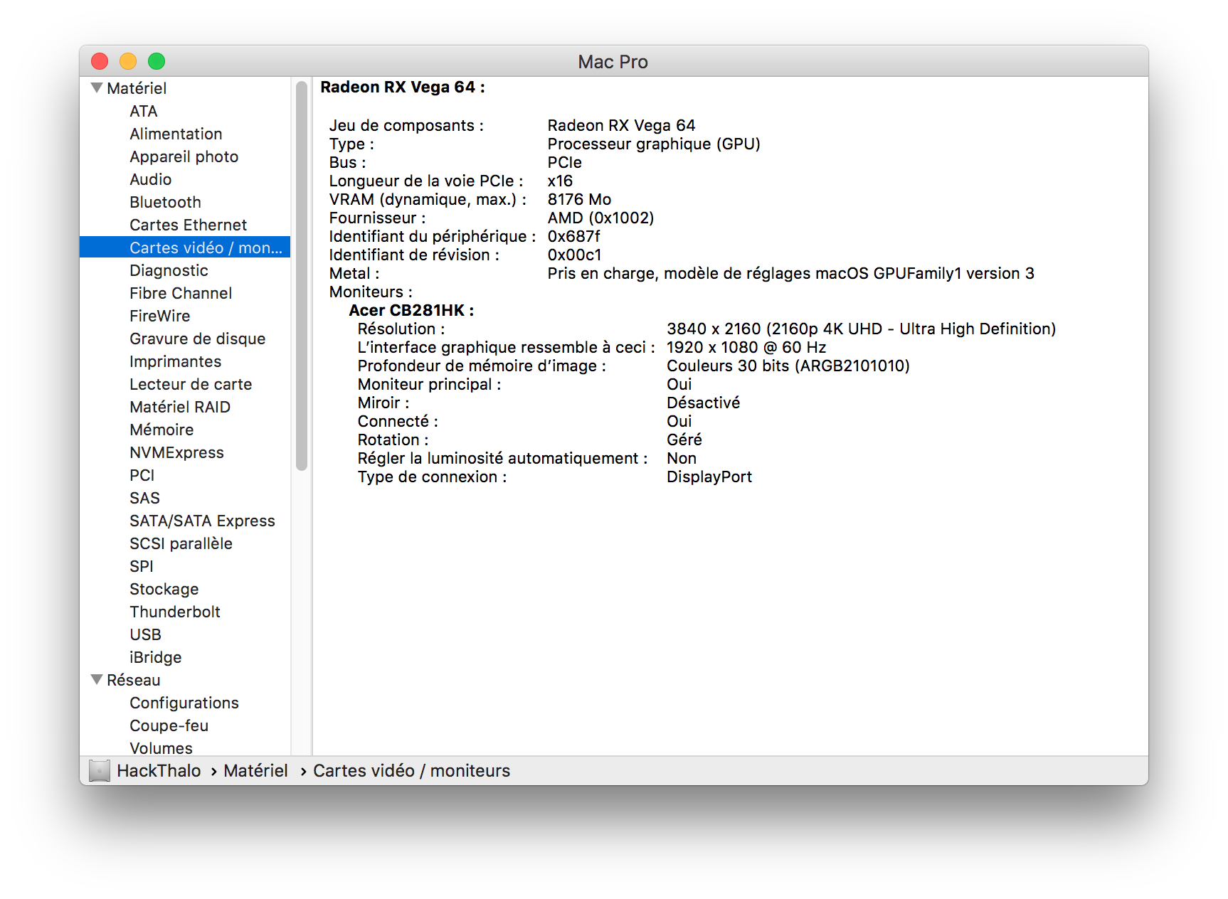

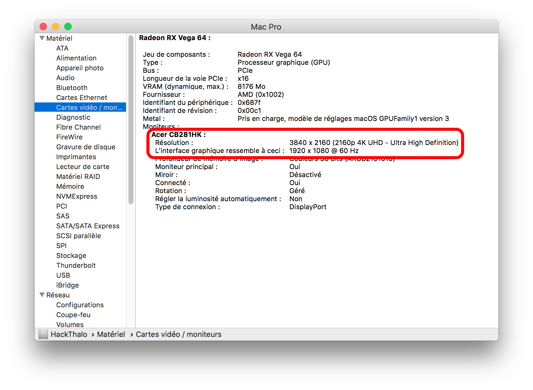

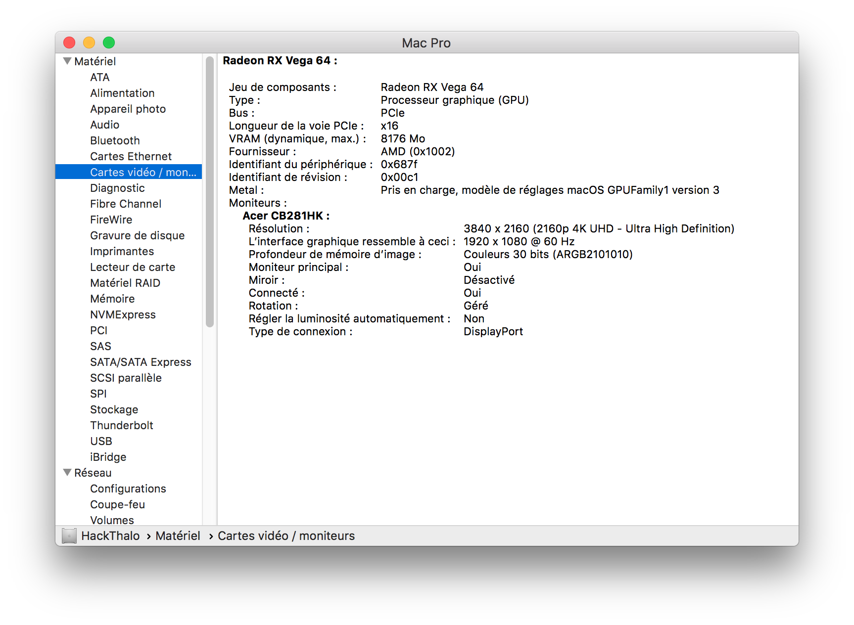

@h9826790 thanks like resolutiontab, resextreme can enable me hidpi, issue is there is no such resolution directly visible in display prefs: even if i select 1080p with no (low resolution) beside it's just plain non retina 1080p:
View attachment 759686 View attachment 759687 View attachment 759688
The info shows that you are running 1080P HiDPI now.
You can try non HiDPI 1080P, you should able to see the difference straight away

like i said it works and thanks, just it doesn't shows up in the monitor prefs. thanks :)

You screenshot clearly slows that the screen is rendering at 3840 x 2160. But UI looks like 1920 x 1080 (which means HiDPI).

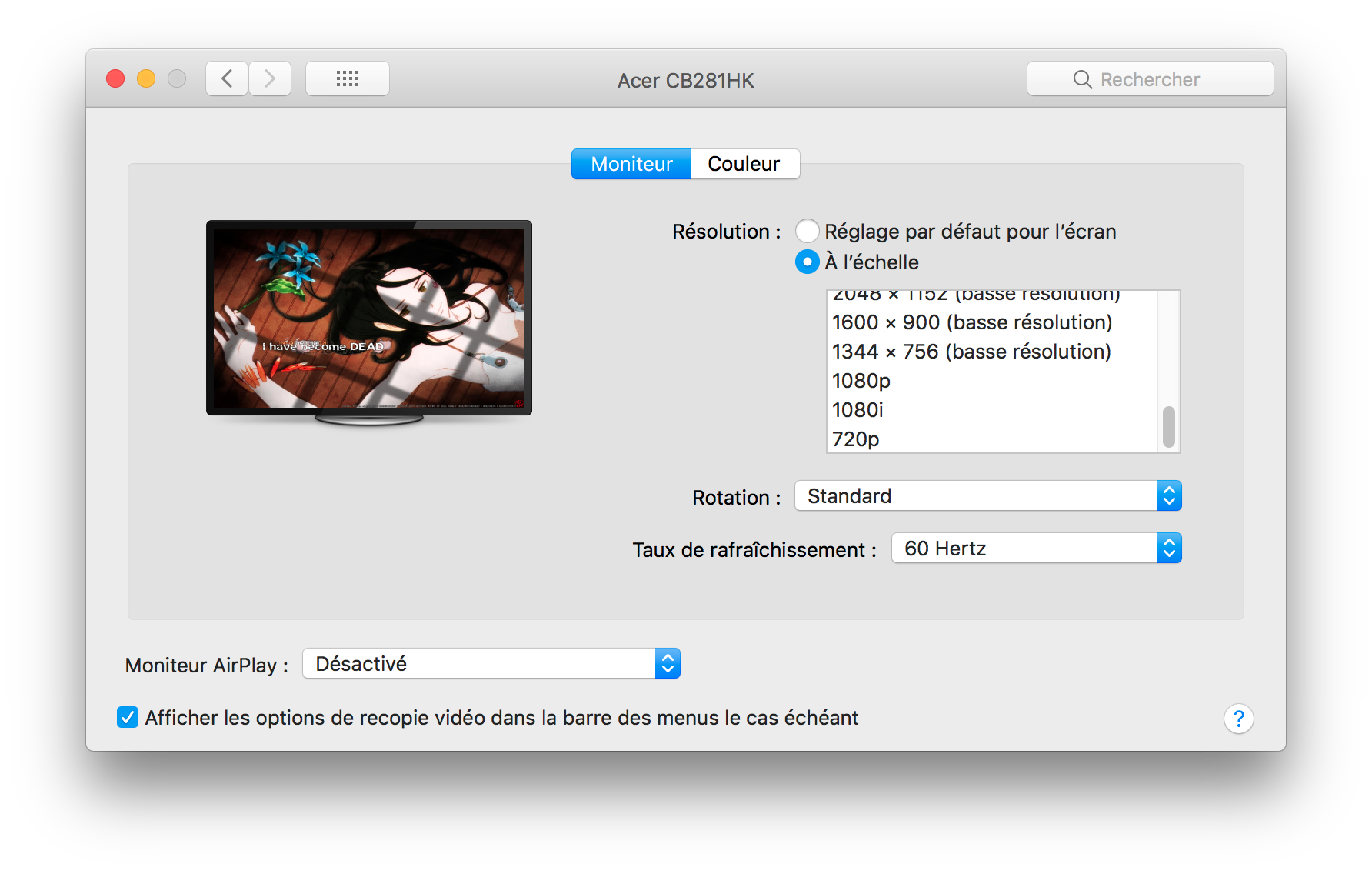

When you see options for 1080p, 1080i,720p in the system preferences it means Mac OS is recognising the screen as a TV rather than a monitor.
To make Mac os recognise it as a proper monitor and show all available resolutions you might try the Force RGB script here: http://www.mathewinkson.com/2013/03...ix-the-picture-quality-of-an-external-monitor
