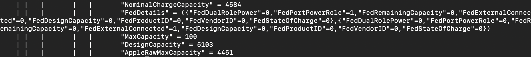

Also worth to check:
ioreg -l -w0 | grep Capacity
How interesting!
That has to be exactly where CoconutBattery is pulling the data from. Look at that.

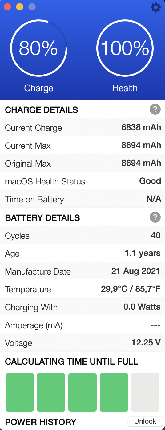

I use AlDente pro and I love it. 40 cycles after almost a year.

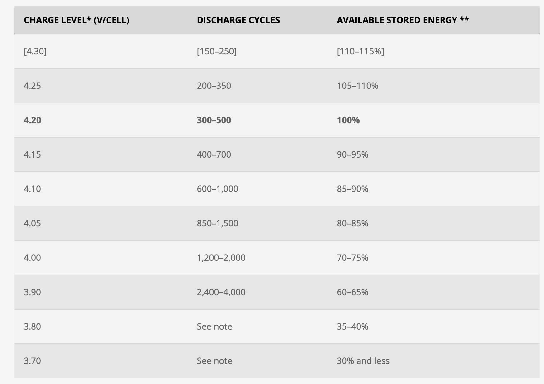

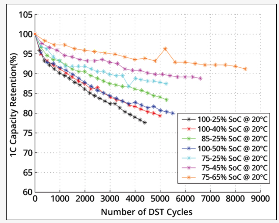

BatteryUniversity offers a great webpage on how to prolong the life of one's batteries. https://batteryuniversity.com/article/bu-808-how-to-prolong-lithium-based-batteries
Most manufacturers will state that storing a Lithium Ion battery at around 40% can significantly increase the longevity of a battery if it is not being used versus leaving it at 100% charge. But specifically in reference to the above article, however, (see below)
Using Al-Dente allows users to utilize a 60-80% state of charge level usage. A MacBook will run completely off of wall power when plugged in and not charging, whereas an iPhone constantly runs off of the battery despite being plugged in. Capping the laptop's state of charge results in significantly less wear/tear on a battery. See how using 100% of available energy results in discharge cycles of 300-500 vs 1,200 - 2000 for 70-75% state of charge.
Leaving one's battery at a high state of charge will result in capacity depletion more rapidly than leaving a battery at a lower state of charge.
AlDente allows capping charge at a lower % of state of charge thus significantly lessening the capacity loss.

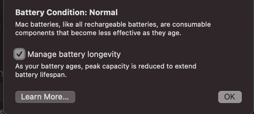

Apple has acknowledged this capacity loss and they themselves have now offered an 80% max state of charge for those of us who are plugged in all the time. The problem is, one needs to have a near perfect charging habit for this automated feature to kick in (and it can take weeks for this to happen).

Those of us who have observed batteries for awhile have noticed that maintaining a high state of charge for long periods of time is far more detrimental to the longevity of a battery than charge cycles.

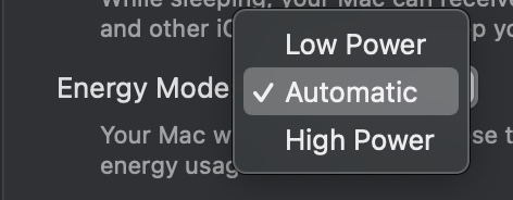

Apple laptops work the same regardless of if they're plugged in or not. (Although with M1 Max MBPs, you can set the Energy Mode. https://support.apple.com/en-gb/HT212852)

One thing I really enjoy about my M1 laptop is that when I unplug I can set the battery power's "energy mode"
I can disconnect from the mains and read for hours and not even use more than a few % of battery, lol. Absolutely amazing.

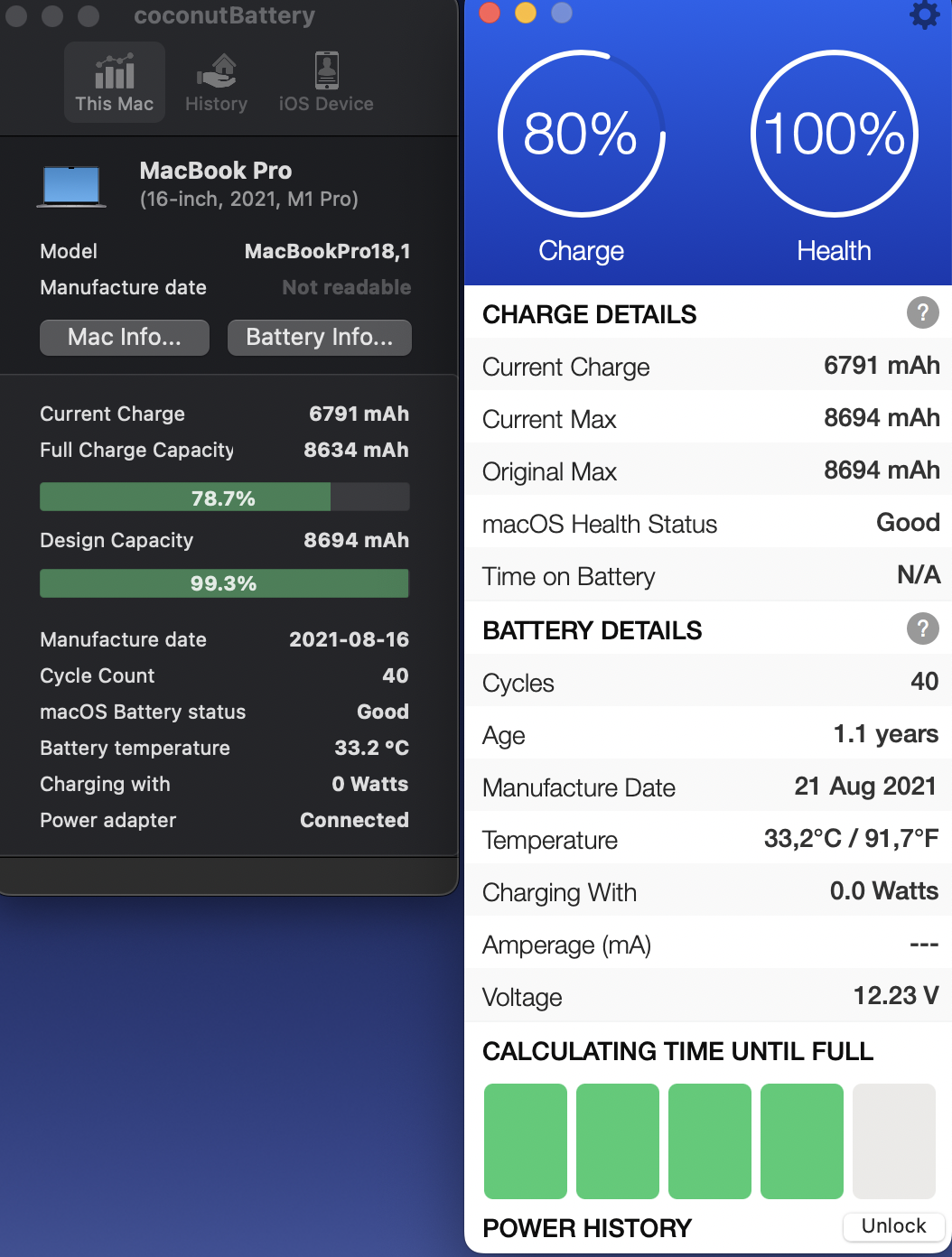

you've kept it plugged in all the time?
Most of the times. I run calibration once in every month. My last MBP had around 1200 (Health 65%) cycles in 6 years and After replacing battery in 2020, it had around 500 (Health 86%) cycles within 16 months. So, let's see how it goes this time.
I don't understand why Coconut battery and Battery Health 2 shows different values.

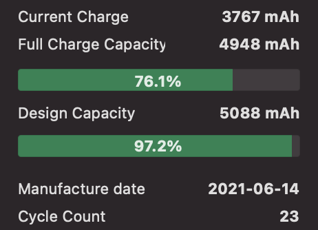

I use my 16in M1 Max during the day solely on the battery and plug in at night with the 140w supplied charger. I received mine at the end of Oct 2021 (one of the first ones delivered) so it's been almost one year of ownership. Mac battery health is at 98%.

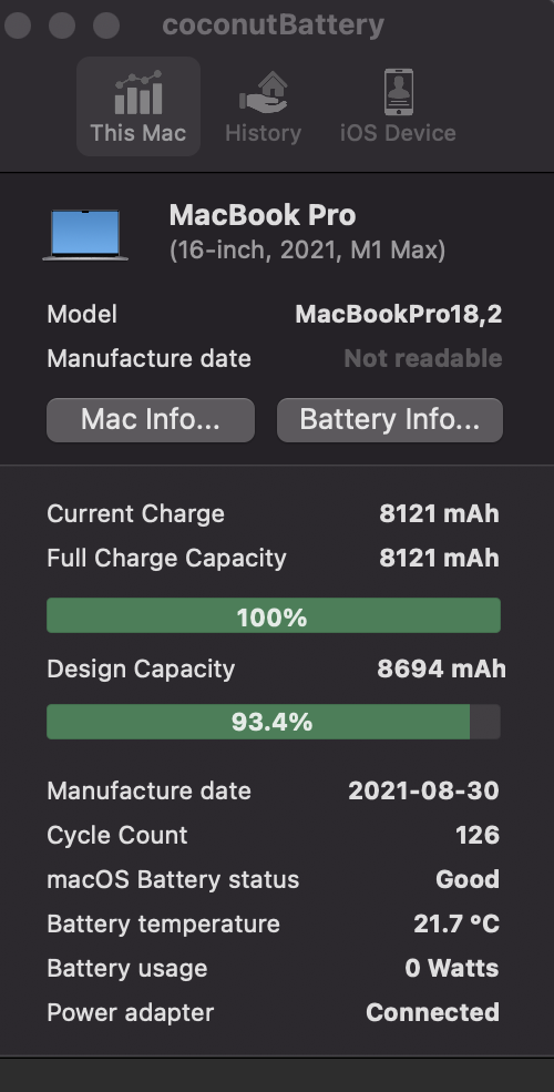

When you say 98%, is that what System Preferences > Battery > Battery Health reports? Because obviously Coconut Battery is reporting something 93.4% there. As mentioned, Coconut Battery reads straight from the hardware.

Yes that's correct, System preferences battery health is at 98%. This has dropped a bit faster than my past MacBook Pro's but everyday usage still feels about the same as when it was new.
Thanks for this. From this we can see that there's a 4-5% difference between what Apple officially reports and what's actually the case for battery health.
This aligns with the battery life indicator in the menu bar. It's typically around 5% behind what the hardware reading is (e.g. on my MBP right now the menu bar says 89% left, but Coconut Battery says 80.5%). This is why the menu bar continues to report 100% battery life for maybe an hour after being taken off charge... Pretty deceptive practices, if you ask me.
I also noticed the difference between the battery life indicator and CoconutBattery is around 5-6% but it's usually when it's above 50%. They start to even out and eventually match each other when they both drop to around 30-40%.

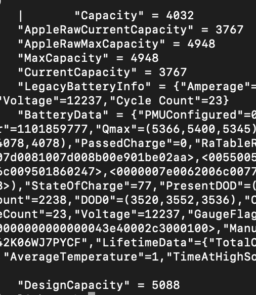

16" M1 Max (almost a year now)
17 cycles
Terminal shows:
"MaxCapacity" = 100
"DesignCapacity" = 8694
"AppleRawMaxCapacity" = 8692
My use case is about 95% of the time plugged in using an external monitor, sitting at 80% battery charge.
