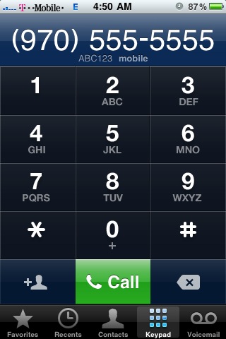

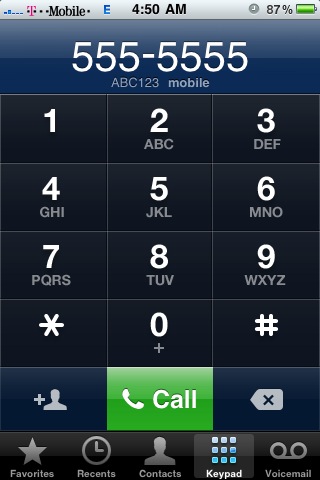

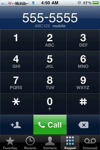

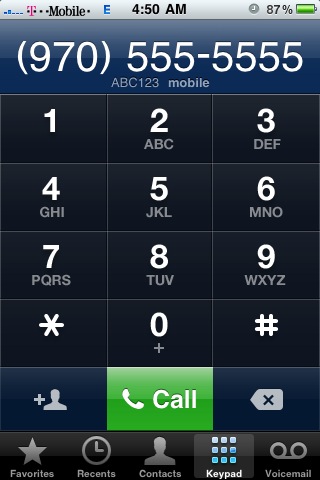

Phone no longer recognizes phone numbers by name without an area code (i.e., if you type in a number of a friend in your area without an area code, phone doesn't realize that it's a number already in your address book; wasn't like this in prior OS's):
With area code:
Without area code:
That last bug is really annoying. It NEVER used to be like that...you could ALWAYS dial a phone number (at least a phone number within your area/area code) WITHOUT an area code and the phone would recognize if it was someone already in your address book. Now it doesn't...BUT, when you dial a number of someone in your address book without an area code, under your history it still shows up under that person's name. At least that's how it is with mine. Kinda confusing.
