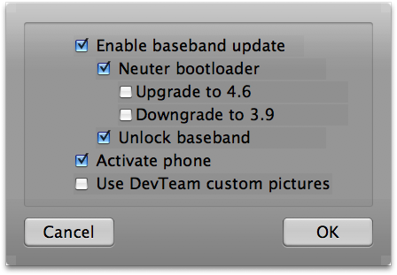

Can someone describe, in detail, what each of these are and mean?
I've had my iPhone for a while now. All I want is to be able to install 3rd party apps on it. I have AT&T, so I don't need to unlock anything that would allow me to use it on a different network.
Enable baseband update - Determines if the baseband update should be enabled in the custom ipsw. Only check this button if you wish to update the baseband modem portion of your iPhone.
WARNING: This may remove previous baseband unlocks or other modifications that have been made previously. If in doubt leave it unchecked.
Neuter bootloader - This will enable "Bootneutering" to the baseband firmware allowing custom firmware onto the iPhone baseband by convincing the iPhine that it is secure.
Upgrade to 4.6
- upgrades 3.9 and 3.9FB to 4.6
Downgrade to 3.9 - downgrades 4.6 and 4.6FB to 3.9
Unless you understand the above option you should avoid it
The only reason right now to change bootloader is because ZiPhone/iPlus etc downgraded a 1.1.2 OTB and newer phone from stock 4.6 to unlock it thus voiding the warranty. Returning it to 4.6 will mean that Apple will not know you ever changed it and you can still get that warranty (if your on an official contract).
Unlock Baseband
- This will enable the unlocking of the baseband to all networks using a custom "software unlock" process. Use this if you wish to use your iPhone with a SIM from a carrier other than the one provided with your iPhone.
Activate Phone - This will activate the phone so that it can be used with iTunes. This will bypass the Apple activation process and set the iPhone to be in an Activated state allowing access to the device's functions.
Unless your unlocked phone is activated using this then it will not work with any other SIM card (other than an official SIM activated in that particular iPhone).
Use Custom Pictures
- This options enables the DevTeam's funky pineapple and Steve Jobs graphics. If you wish to keep the original iPhone graphics then DO NOT select it.
Your iPhone will be jailbreaked with installer even if you DO NOT select any of the above options!
