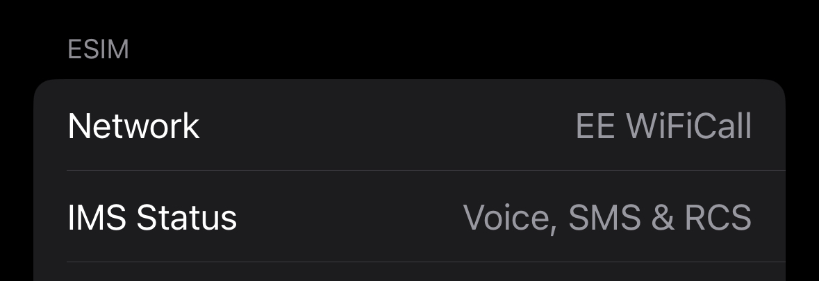

EE has registered properly onto RCS now.

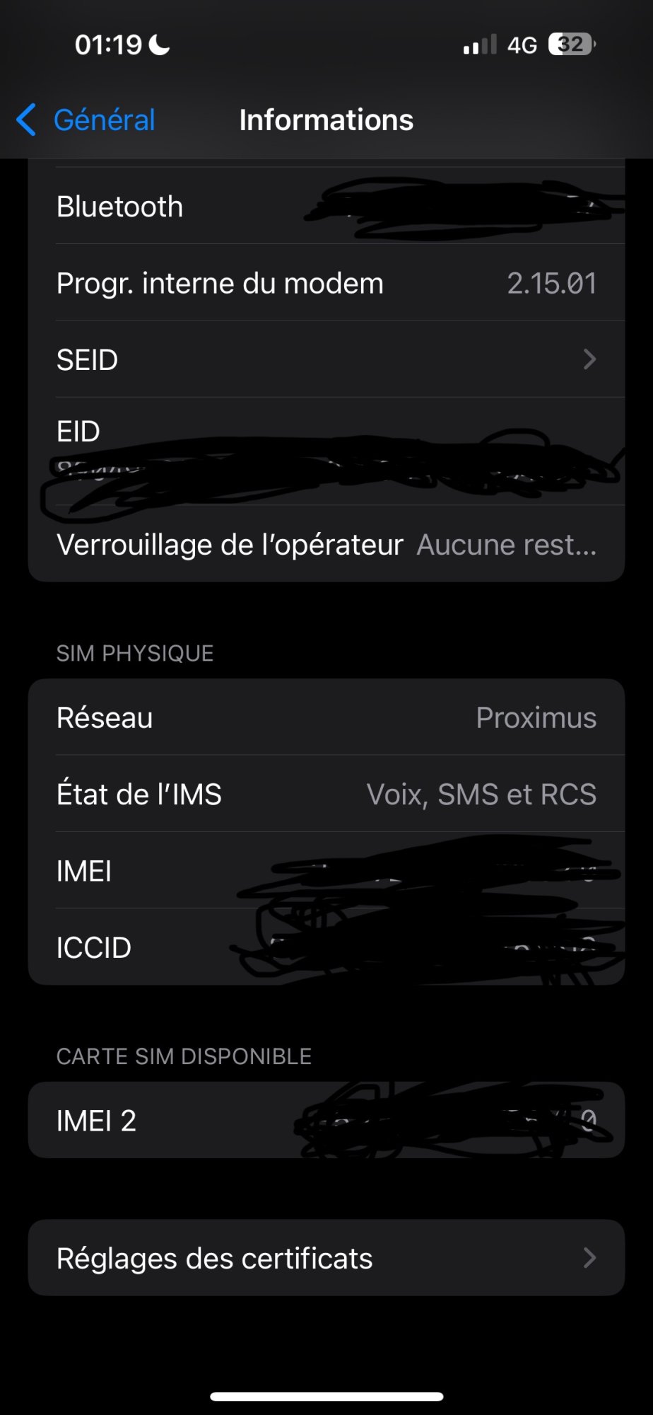

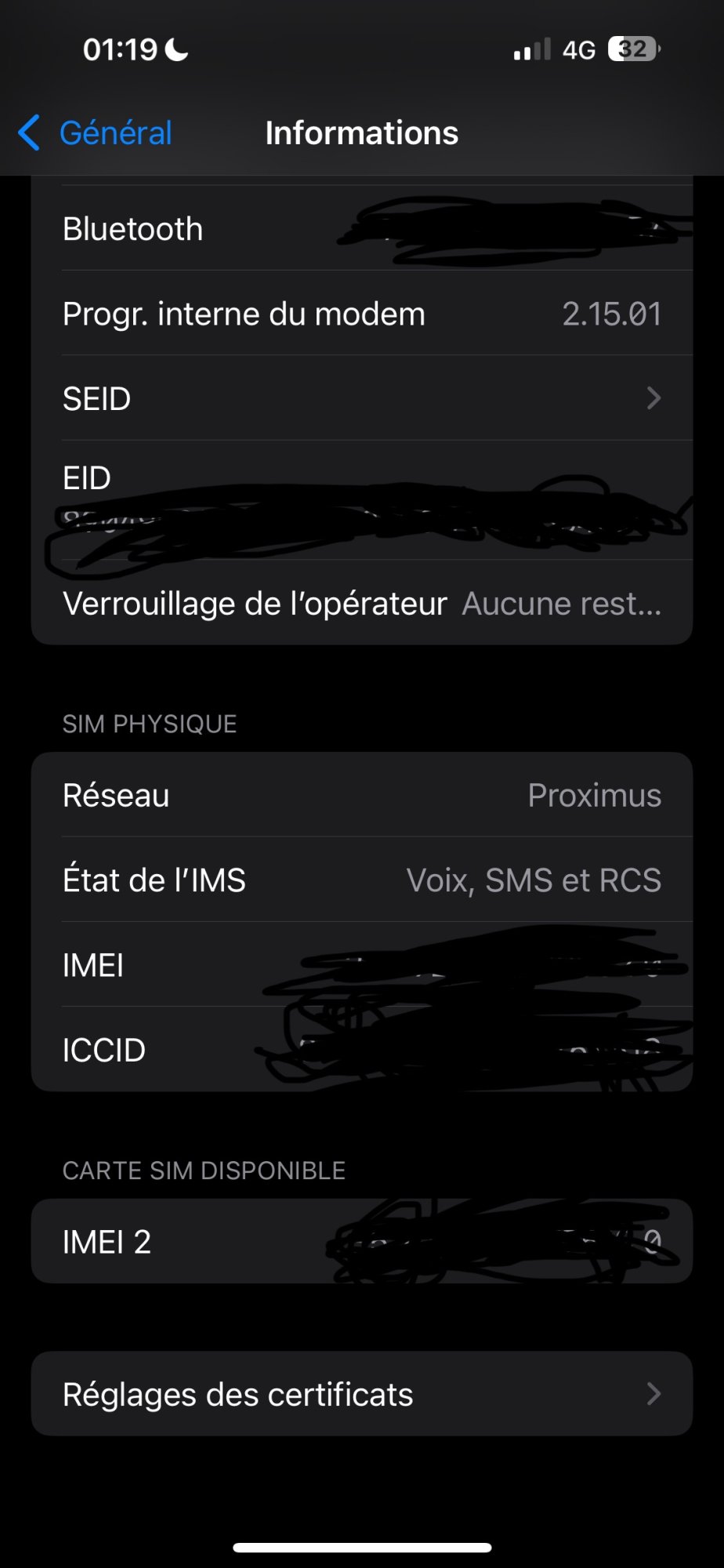

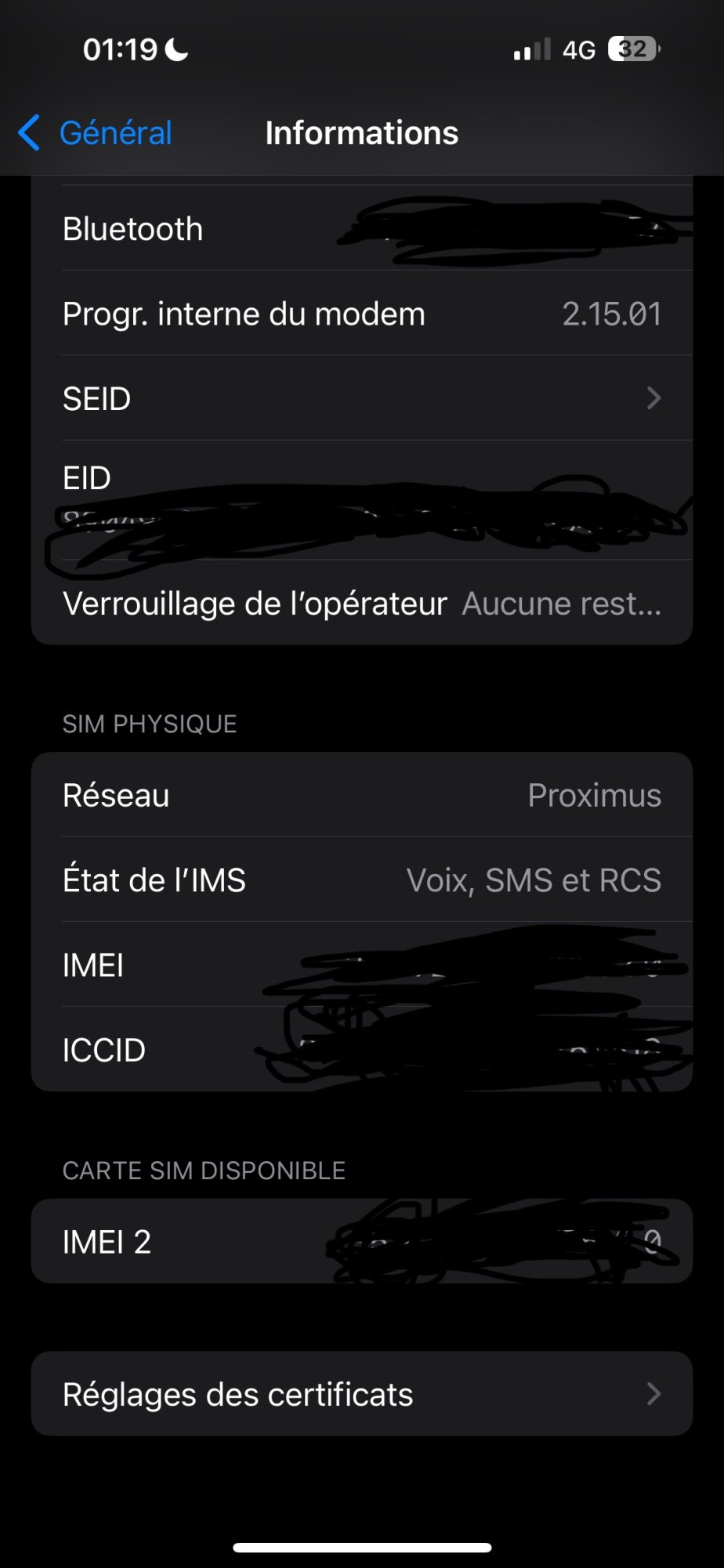

RCS ok in belgium with proximus,test ok with android phone 😉

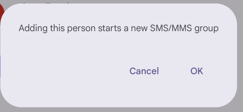

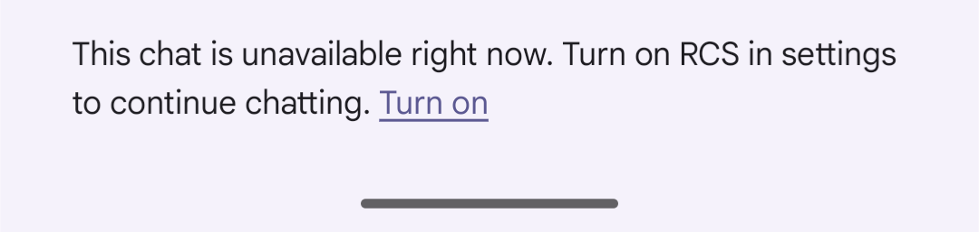

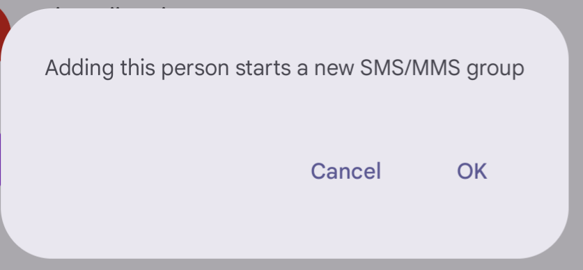

There is what happen if you try to add a person who does not have RCS:
1) iOS will add the person, and kick out the person as soon as you click okay.
2) Google Message will give this error

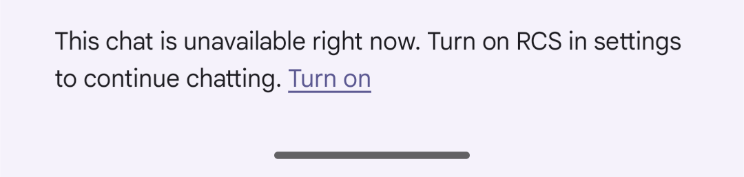

I turned of my RCS function on Google Message to minic if someone loses RCS, this is what happen with Google Message:
The group chat will still have RCS, it just the one who loss RCS will not able to see messages until RCS is enabled again.
To summary:
If you have established RCS group chat, you will NOT able to add a person without RCS (i.e. anyone who don't use Google Messages or iOS 18 below). If you try to add someone without RCS into the RCS group chat on iOS, the person will be added and kicked out immediately.
If someone within group message losses RCS, he/she will not able to send and receive messages until RCS is restored.

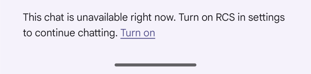

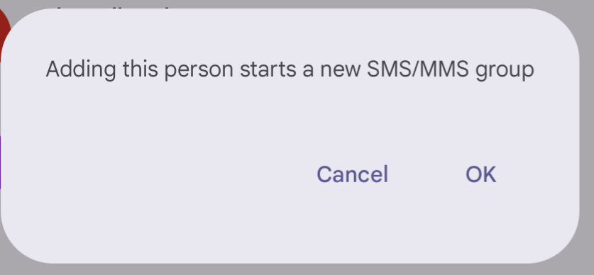

To summary:

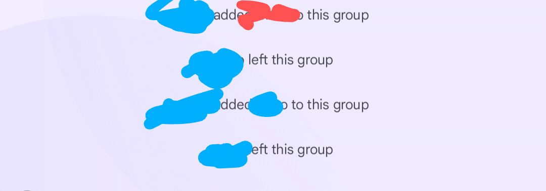

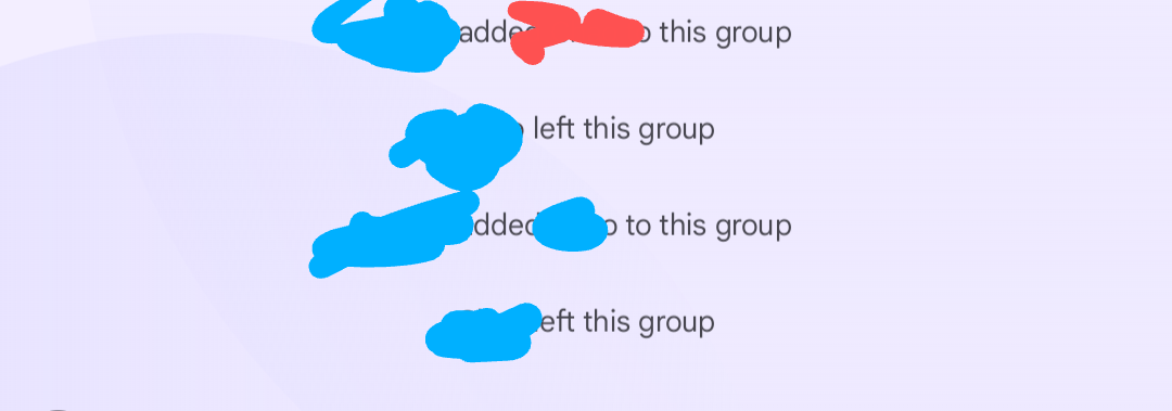

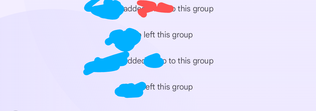

Here are additional findings:
When you change the name of a group chat on iOS, the update is not reflected in Google Messages. However, if someone changes the group chat name using Google Messages, both iPhone and Android users will see the update.
If iOS devices cannot send RCS messages, they will default to SMS. On the iOS side, this switch is visible as it changes to SMS, while on Google Messages, a duplicate group chat appears with only the SMS messages.
Additionally, iOS devices cannot remove group members from the chat, but Google Messages can.
