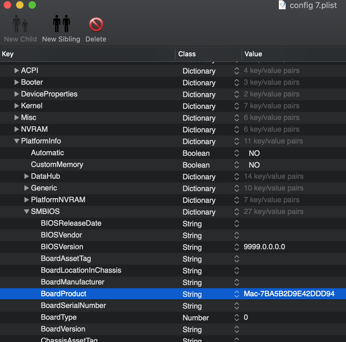

Here is my config file
The key to getting h/w acceleration is spoofing the BoardID of either iMacPro1,1 or MacPro7,1.
Your config file does not contain that spoof.
You need BoardProduct = Mac-7BA5B2D9E42DDD94 (for iMacPro1,1):
Reactions: kirreip

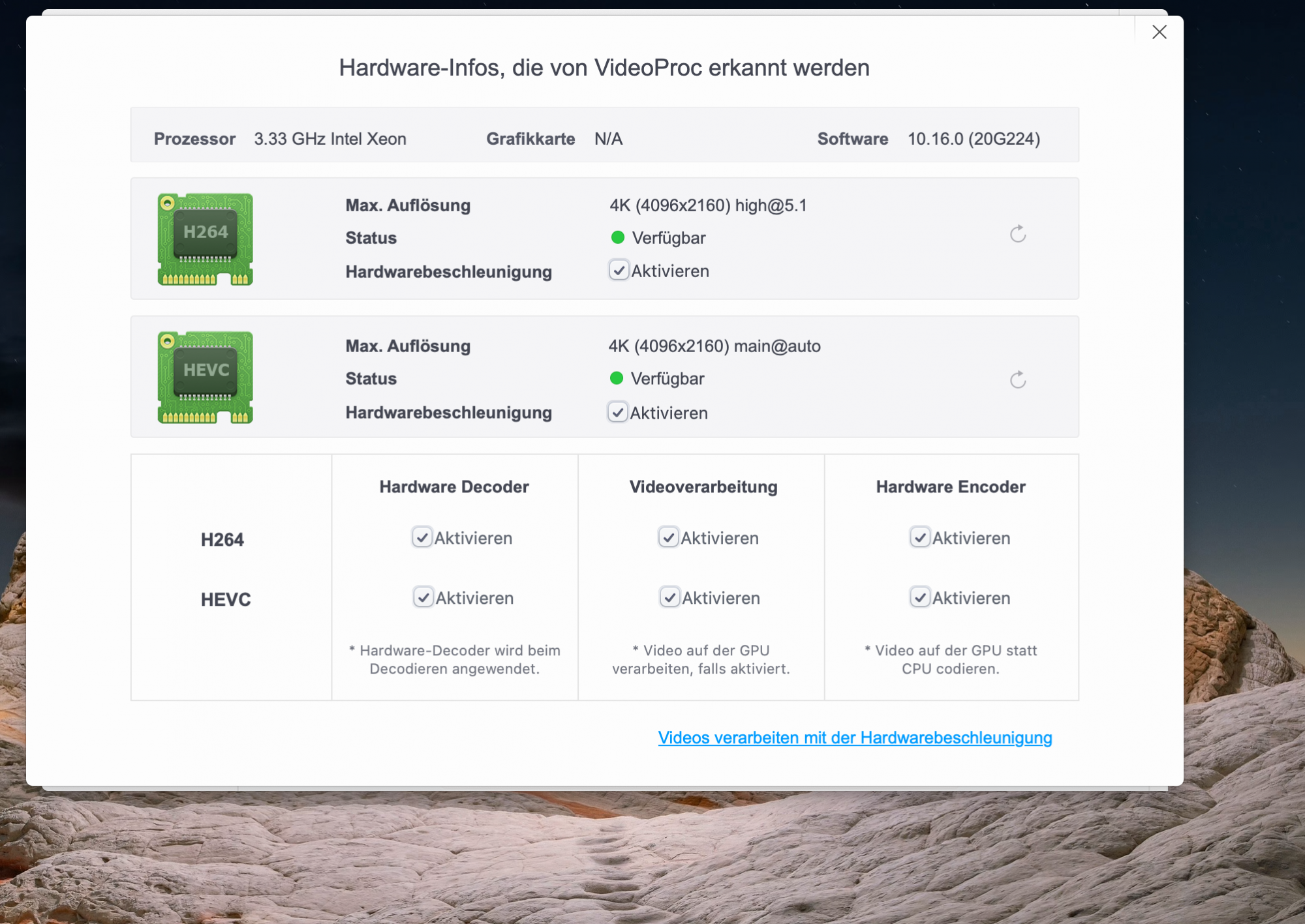

It is working now. I had that line on the wrong place in my config file... 🙈
But thanks for helping. Everything is now up and running.

I have finally managed to upgrade with MyBootMgr 0.7.5b, but it meant I had to do quite a bit of reading up in order to identify and understand why – with versions of RefindPlus MyBootMgr upwards of 0.7.3a on my cMP – the logon screen would not show on Mojave and it lost GPU support (as per my sig, I have a Sapphire Pulse RX590), and why Big Sur would crash and stall. But alas I was able to work it out (and learned much more about OpenCore in the process - which I fear I'll forget too quickly), and now have a well behaving Mojave (NVMe) and Big Sur (SSD in SATA bay) using the OC instance of OpenCore created by ConfigFactory MyBootMgr. I was also able to upgrade Big Sur 11.5.2 to 11.6.1 using the OC_ALT instance of OpenCore (but use OC for everyday usage).
I realise this post might be specific to OpenCore, however I share it here for others who might also be having issues using the OC instance of OpenCore that is created by ConfigFactory MyBootMgr. If anyone knows how to achieve the changes below with choices I should be making in ConfigFactory then please let me know (I'd far prefer to use the stock output from ConfigFactory without having to go and make manual changes afterwards).
Changes I've made from the OC version of OpenCore created with RefindPlus MyBootMgr0.7.5b:
Under the Misc > Security section:
<key>SecureBootModel</key> <string>Default</string>
changed to:
<key>SecureBootModel</key> <string>Disabled</string>
Under the NVRAM > boot-args section:
<string>debug=0x144 keepsyms=1 -no_compat_check</string>
changed to:
<string>agdpmod=pikera shikigva=80 wegtree=1 unfairgva=1 debug=0x144 keepsyms=1 -no_compat_check</string>
Under the PlatformInfo > SMBIOS section:
<key>BoardProduct</key> <string>Mac-27AD2F918AE68F61</string>
changed to:
<key>BoardProduct</key> <string>Mac-7BA5B2D9E42DDD94</string>
These three things allow me to enjoy the best of my cMP - boot screens on 4K monitor, HWAccel, internal PCIe drives etc.
I have not had to make any changes to the OC_ALT instance - it seems to work fine for it's single purpose for me of updating macOS versions.
Updated: erroneous nomenclature corrected ;)
