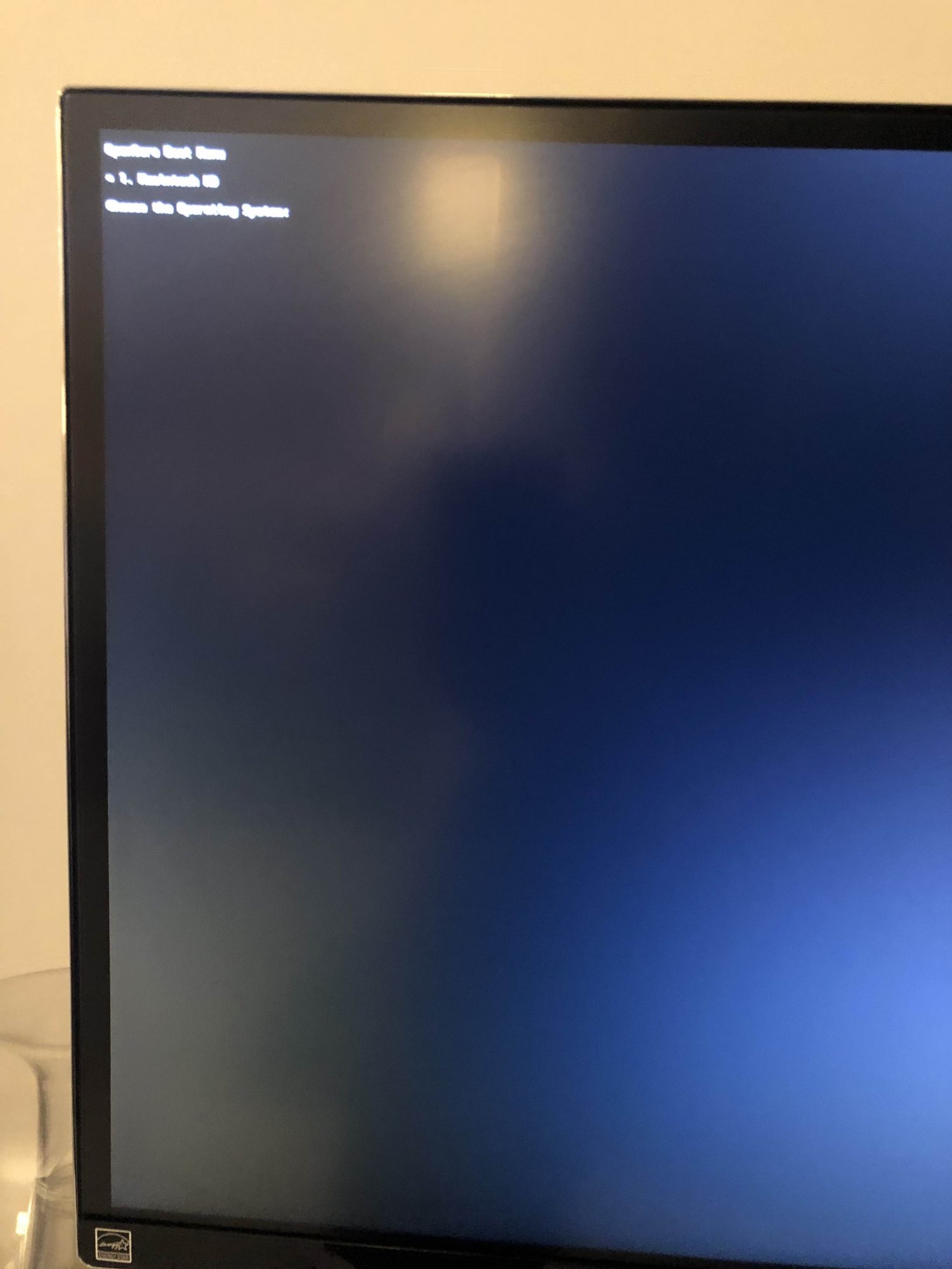

When i start the computer and even restart no matter how many times, I get this :
Opencore Boot Screen
* 1. Macintosh HD
Choose the Operating System

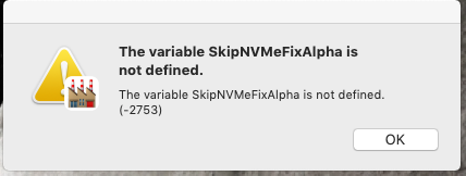

@Dayo v076d results in the following when presented with Innie choices and selecting 'YES':
Going back and selecting 'NO' will permit ConfigFactory to continue without error. That said, only some internal PCIe drives are showing as external and the rest are internal, internal PCIe drives still show as external. Going back to AHCI method should resolve.
Hi ... will look at the error for the next release due next week.
Might have been left as an oversight as Innie is now an absolute last resort option (development appears to have ceased).
FWIW, up until v070c, I never used Innie. There was always a problem with it and recognizing PCIe drives under Big Sur. Instead, I always used the alternate AHCI solution which no longer appears to be an option in ConfigFactory. Is there a possibility to bring that back?

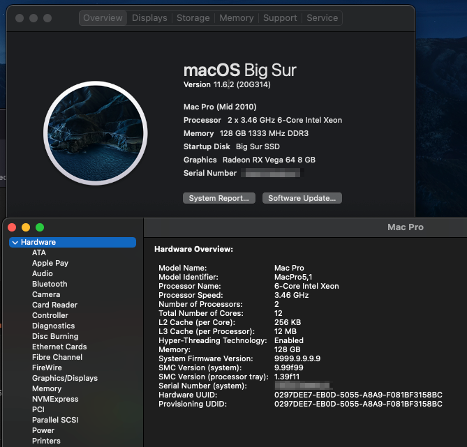

Welp, color me impressed. Didn't have to do too much going from v070c to v076d to get Big Sur updated to 11.6.2. So far, Wifi works along with all other peripherals. Internal PCIe drives are still being reported as external drives, but I chalk that up to AHCI not being configured correctly. @Dayo, let me know once you get ConfigFactory fixed to allow AHCI and I'll retest. Thank you.

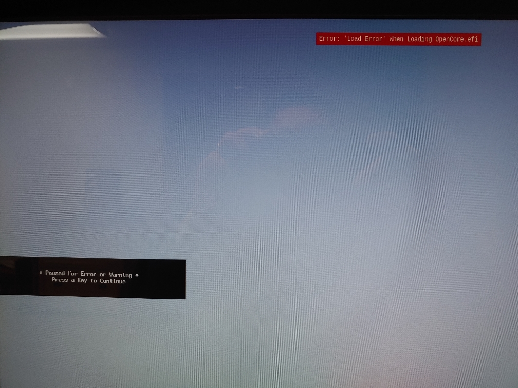

Ok, so discovered a few more issues.

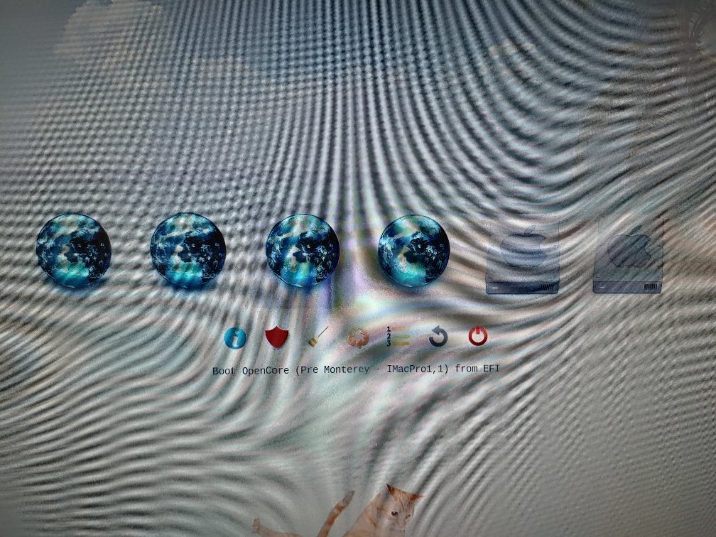

1. Boot OC (default - post Mojave): will not actually boot Mojave. Selecting that option results in a system reboot and return back to boot picker;
2. Boot OC (alternate - Pre Monterey): selecting this will force a reboot into recovery mode.
3. Boot OC (Pre Monterey): error 'load error when loading OpenCore.efi
4. Boot OC (Post Mojave): same error message as above
I can only boot native Mojave by selecting the vanilla option in boot picker.
Selecting option one and choosing BS will load Big Sur 11.2.6. Choosing Mojave will result in a reboot back to the picker screen.
NVRAM cleared 3x and result is the same as described above.
Bear in mind that "Post Mojave" means "After Mojave" and therefore excludes Mojave.
That is, it is to be used for Big Sur Catalina and later.
I suppose many might get muddled up on that and will consider a rename.
Not clear on what you mean. Do you get the reboot on selecting the option in RP as stated or on selecting something in OpenCore? If the later, what was selected?
Hopefully not Monterey since "Pre" means "Before"
Ditto
As Item 1
Do you actually have Monterey installed? If not, do not say so in ConfigFactory.
System would reboot the moment that option was selected in RP. I did not get the usual OC selection of operating systems.
I do not have Monterey although cannot remember if I selected yes in ConfigFactory in the last build (I believe I said no). I will go through the process again and revert.
In previous iterations, would use the default OC to also boot Mojave in order to take advantage of certain OC functionality such as extended GPU support as well as showing PCIe drives as internal. If the default can no longer be used to boot the native OS, what option would?
Edit: Clear NVRAM from RP doesn't seem to function. Selecting that option does nothing.
Edit 2: my fault. Ran ConfigFactory again and problem solved as far as default OC and Mojave. I guess I had inadvertently selected Monterey as a build choice last night. FWIW, clear NVRAM still doesn't seem to do anything from RP.
