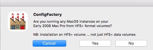

Meanwhile, I have another question. For the query:
I can read this in two ways. Which do you intend: HFS+ boot volumes (non-efi) or HFS+ boot volumes with EFI folders? (or both, or something else completely?) I have OSX Extended volumes, which I think are technically also HFS+, but they are EFI booting ones.
Any HFS+ Boot Volumes.
