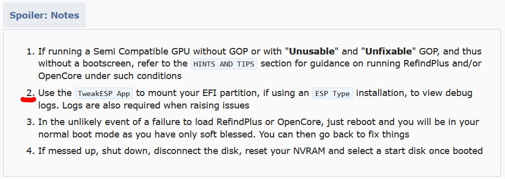

Post 1:

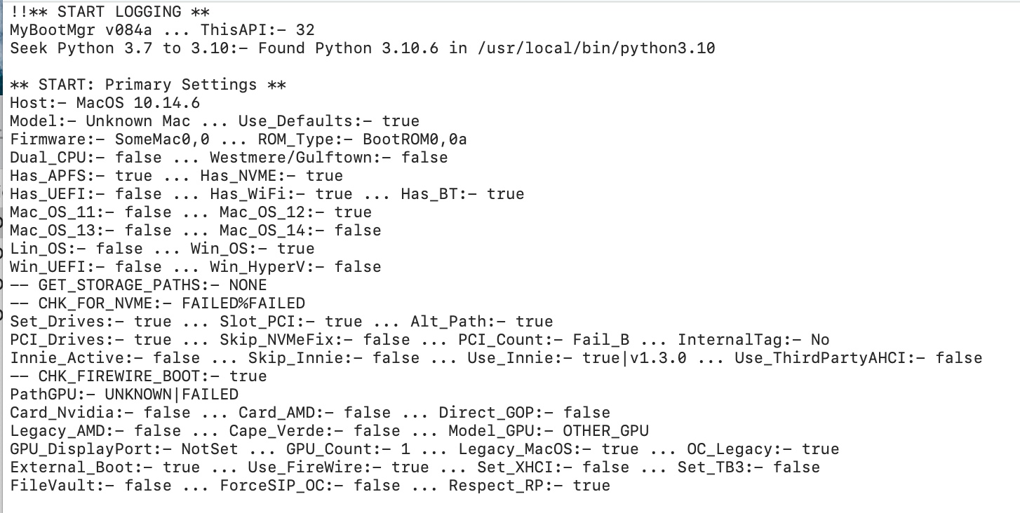

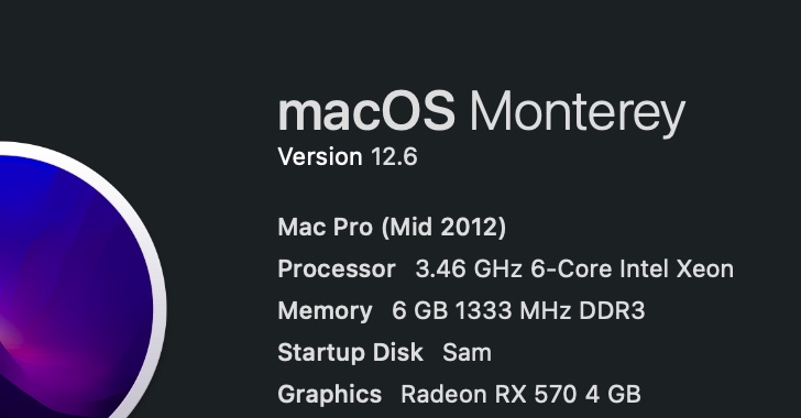

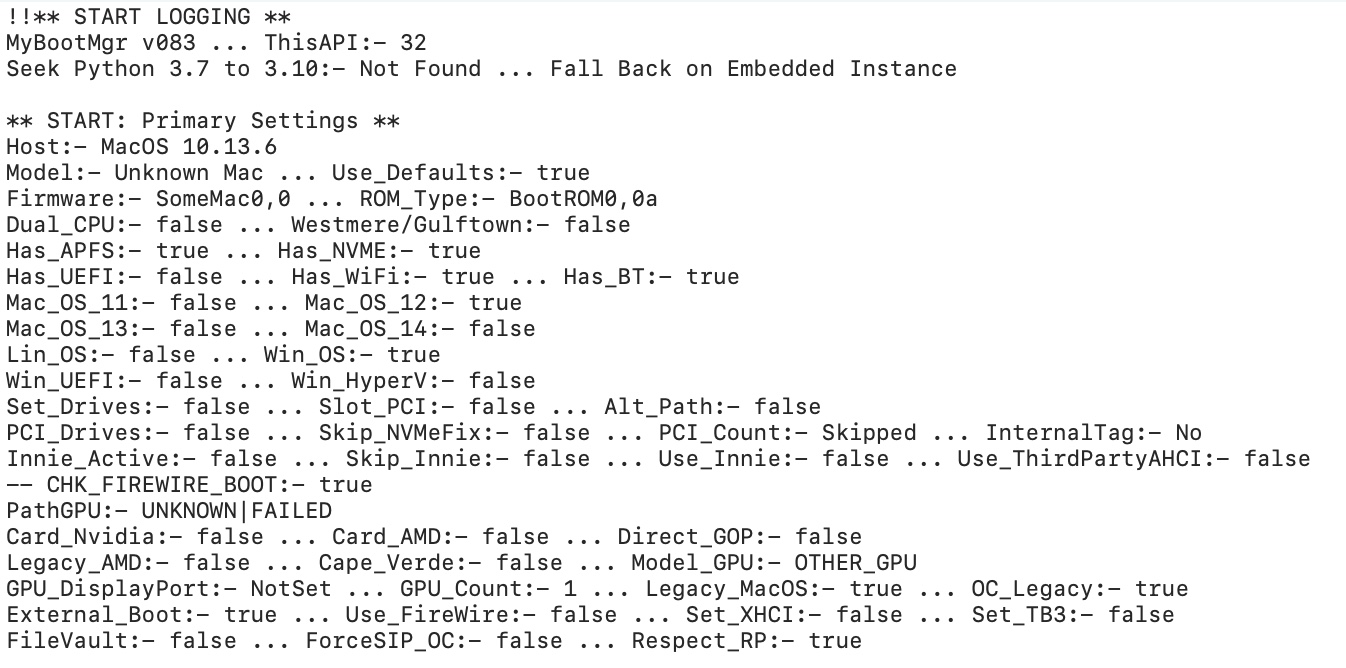

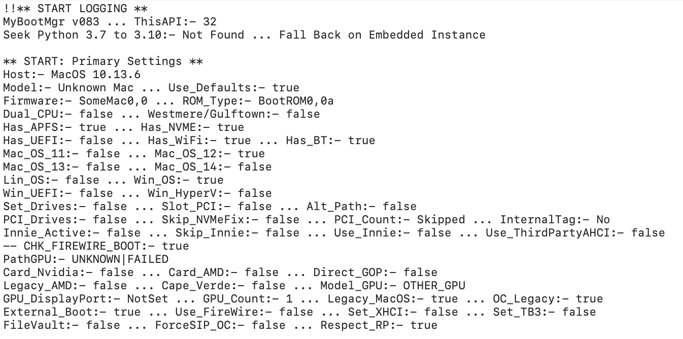

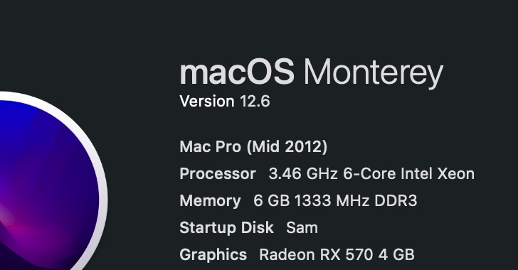

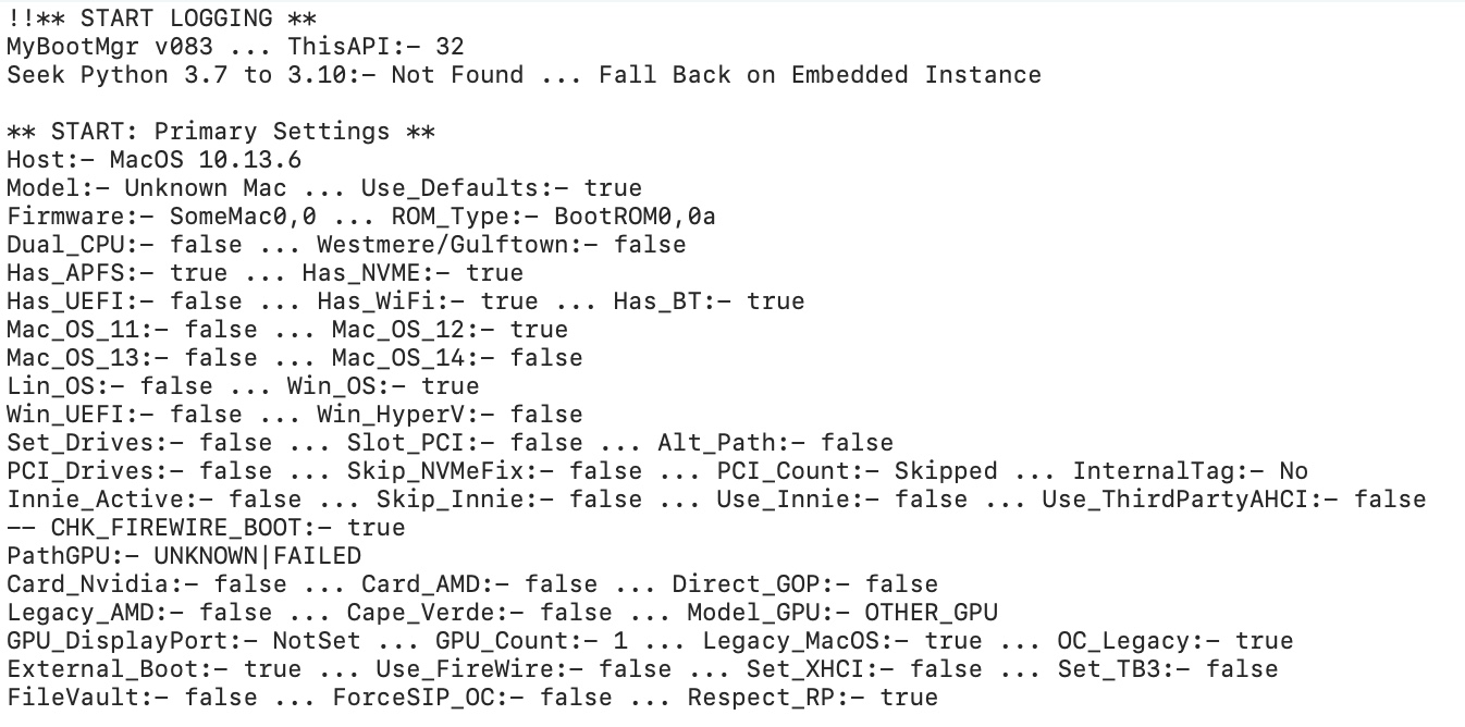

hi Dayo, I've been configuring a MP 5,1 as per my 3,1 and find ConfigFactory doesn't recognise the model or GPU so I'm wondering where it looks for that info, coincidentally 'about this mac' is missing '(Mid-2012)'
On 3,1 ConfigFactory recognises the same GPU. I don't see what causes ConfigFactory to sometimes display a GPU selection list, it's reassuring.
ConfigFactory does not do much in respect of getting GPU information once it concludes, as it did for you, that it is not being run on a cMP or Xserve. That the unit itself does not quite self identify is probably not coincidental. Please share the output of running system_profiler SPDisplaysDataType | grep 'Chipset Model:' in Terminal.
On the model, please share the first 3 and last 4 digits of your serial number. This contains generic information that identify the model without the other parts that are specific to your unit. Additionally, share the output of running system_profiler SPHardwareDataType | grep 'Boot ROM Version' in Terminal while booted into a natively supported MacOS without using OpenCore.

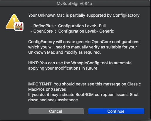

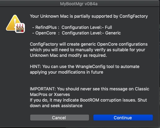

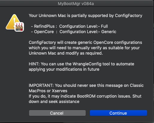

hi Dayo, I just read ConfigFactory dialog important BootRom corruption message for the first time last night 😵
It seems my BootRom and about this mac issues were unrelated and ConfigFactory still doesn't recognise this hardware with reconstructed BootROM.
system_profiler SPDisplaysDataType | grep 'Chipset Model:' Chipset Model: Radeon RX 570
system_profiler SPHardwareDataType | grep 'Boot ROM Version' Boot ROM Version- 144.0.0.0.
Serial #: CO7-F4MC

There is nothing wrong with your unit or the BootROM and there was an issue in ConfigFactory that meant the model id code would not recognise your unit. This also resulted in a failure to identify your GPU as the GPU id code is skipped when the model is not identified.
Just stick with the setup you have in place until the next update as the cut off for updating MyBootMgr for non-critical issues has passed and it will only be looked at again just before the next version.

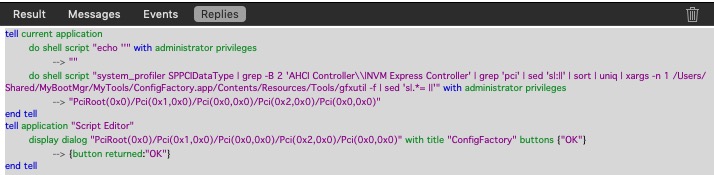

On a different item, can you please run the attached test file and share the output?
Just download, unzip and run from anywhere. It should create a dialogue box.
Thanks.
Thanks, the script returns 'blank output' Monterey. I'll try Mojave,

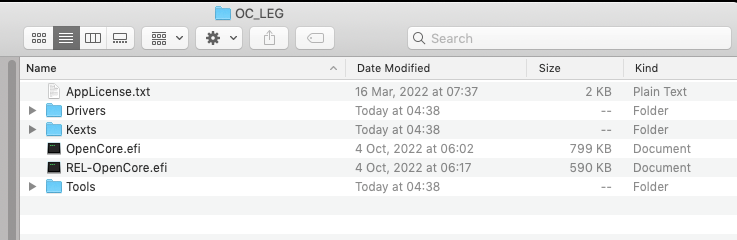

EDIT: I think I figured out why OC_LEG doesn't initialize. Seems ConfigFactory did not generate a config plist file. This is everything in the OC_LEG folder on the EFI partition:
EDIT_2: I do confirm that config plist exists in OC, OC_ALT, and OC_UPD only.
EDIT_3: Checking EFI folder in the MyBootMgr folder, I do see a Config.plist file there for OC_LEG. Let me run DeployConfig again and see what happens.
EDIT_4: I deleted everything from EFI and redeployed (last time I noticed there was zero KB remaining space, so perhaps not everything was copied. I can now boot Mojave from OC_LEG. Will revert on attempting to boot Mojave from OC default.
