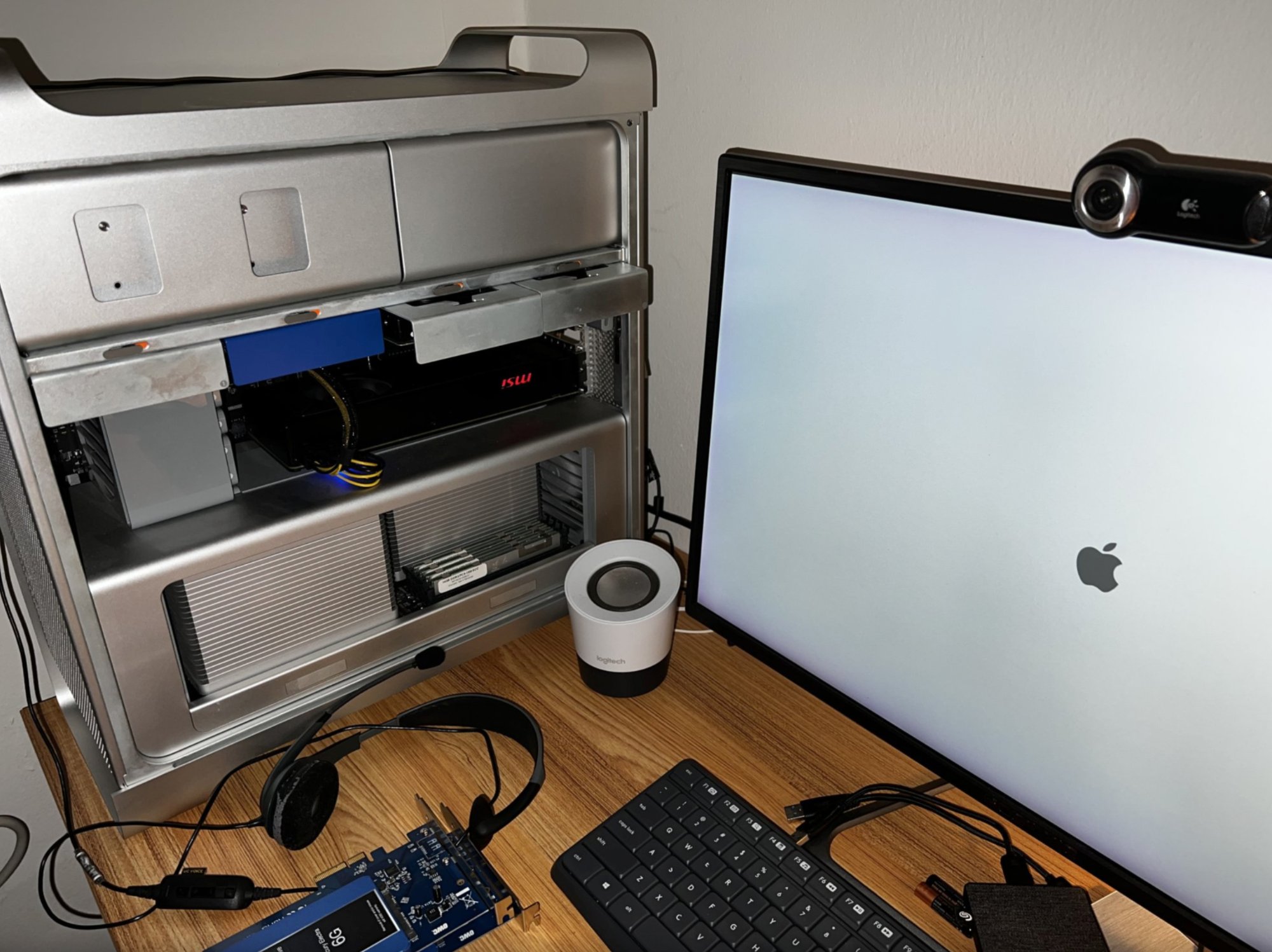

After leaving for work and letting the Mac sit at the Apple logo hoping it was just taking it's sweet time, I come home 8 hours later to find it still sitting at the same screen.
Hard reboot, tried it again, and the situation remains the same. According to @JedNZ , his upgrade worked just fine using the same methodology I employed. The only difference is he upgraded using v084a, and I'm on v085.
I posted my question over in the OC thread, hoping someone may be able to point me in the right direction. Perhaps it's an issue with a flag being incorrectly set. It seems once the updater package is selected, it's not being initialized. Unfortunately, I haven't messed with this cMP in some time, so everything I knew about OC has mostly been forgotten and I just don't know where to look.
