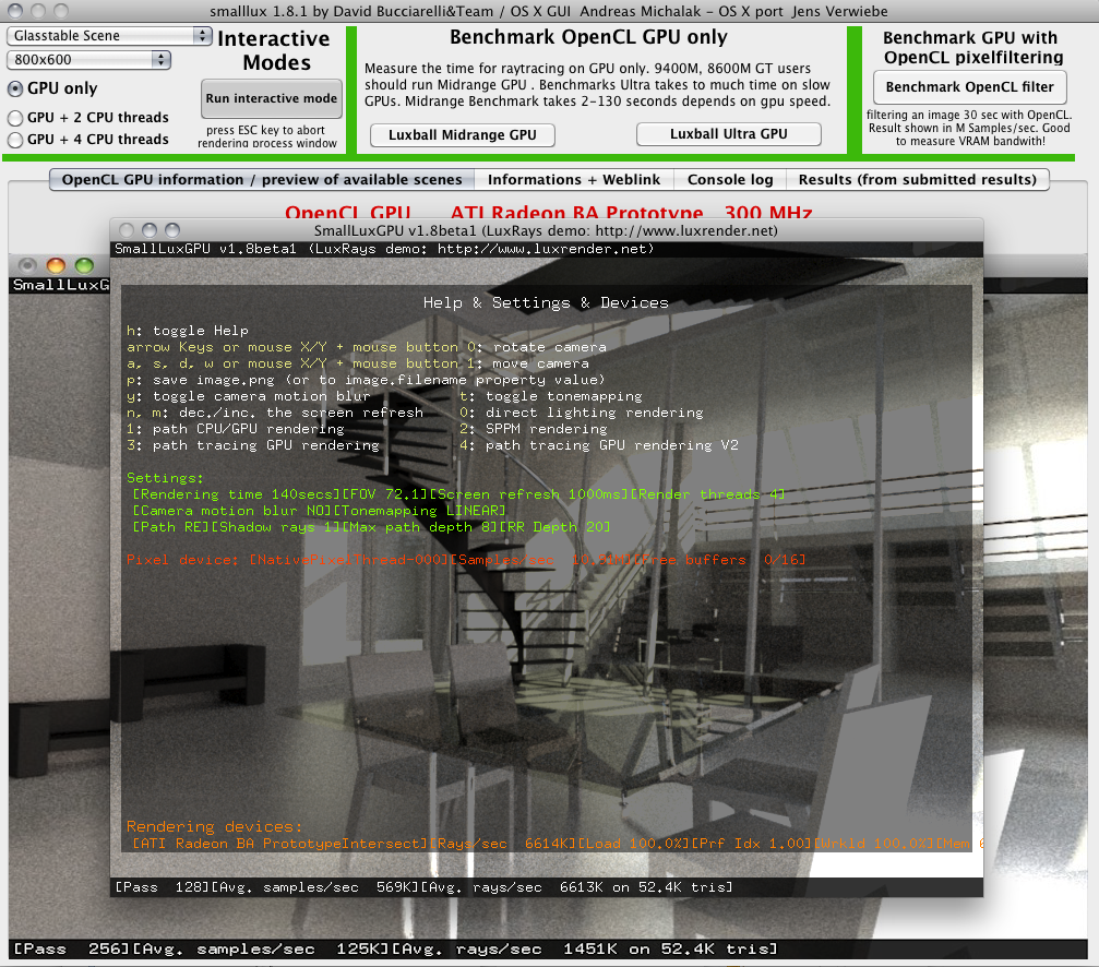

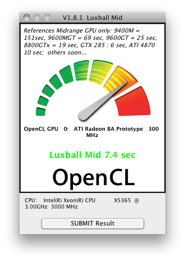

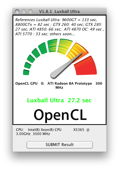

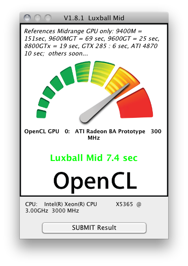

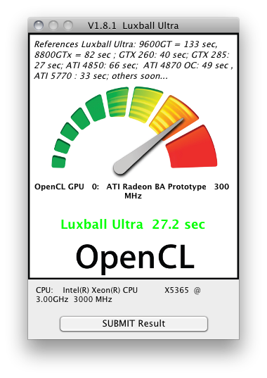

Mac Pro 2,1 (10.6.8) HD 6870 (687A-ZDFC)
Hi!
I'm Using
1. Mac Pro 2,1 ( 8-core OS X 10.6.8) HD 6870 1 GB (687A-ZDFC). No modifications OS and card.
Xbanch and SmallLuxGPU working fine. Apple DVD player crashed.
* all video port operate.
2. Zeus 2.8 (6000series.app)
I do so:
1. boot Windows XP > GPU-z > save ROM to hdd
2. boot OS > Zeus > Firmware > Select Card: HD6870 1G > Browse file rom > Add EFI > save new rom file to hdd
3. Boot windows XP > ati_winflash_2.0.1.14> Program ROM > successful
4. reset Mac Pro. reset SMC. Reset PRAM
5. Nothing change.
No apple bootscreen. In profile system still name ATI Radeon HD NI40
6. ???
