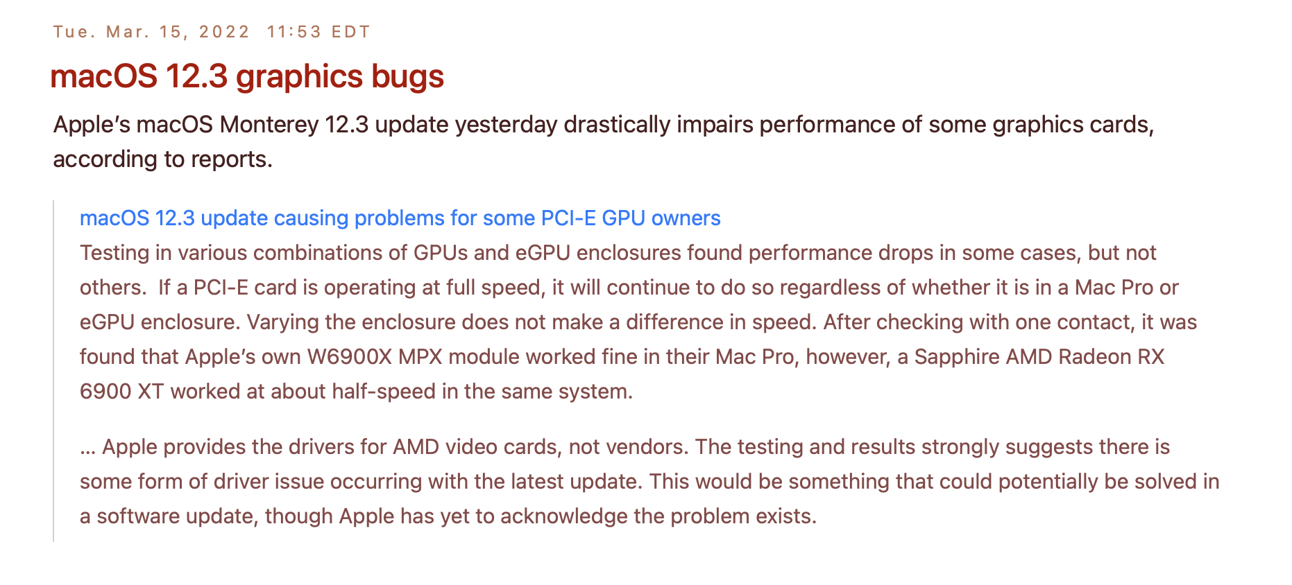

Well, it's finally out in the press - FINALLY🤔
Lou
