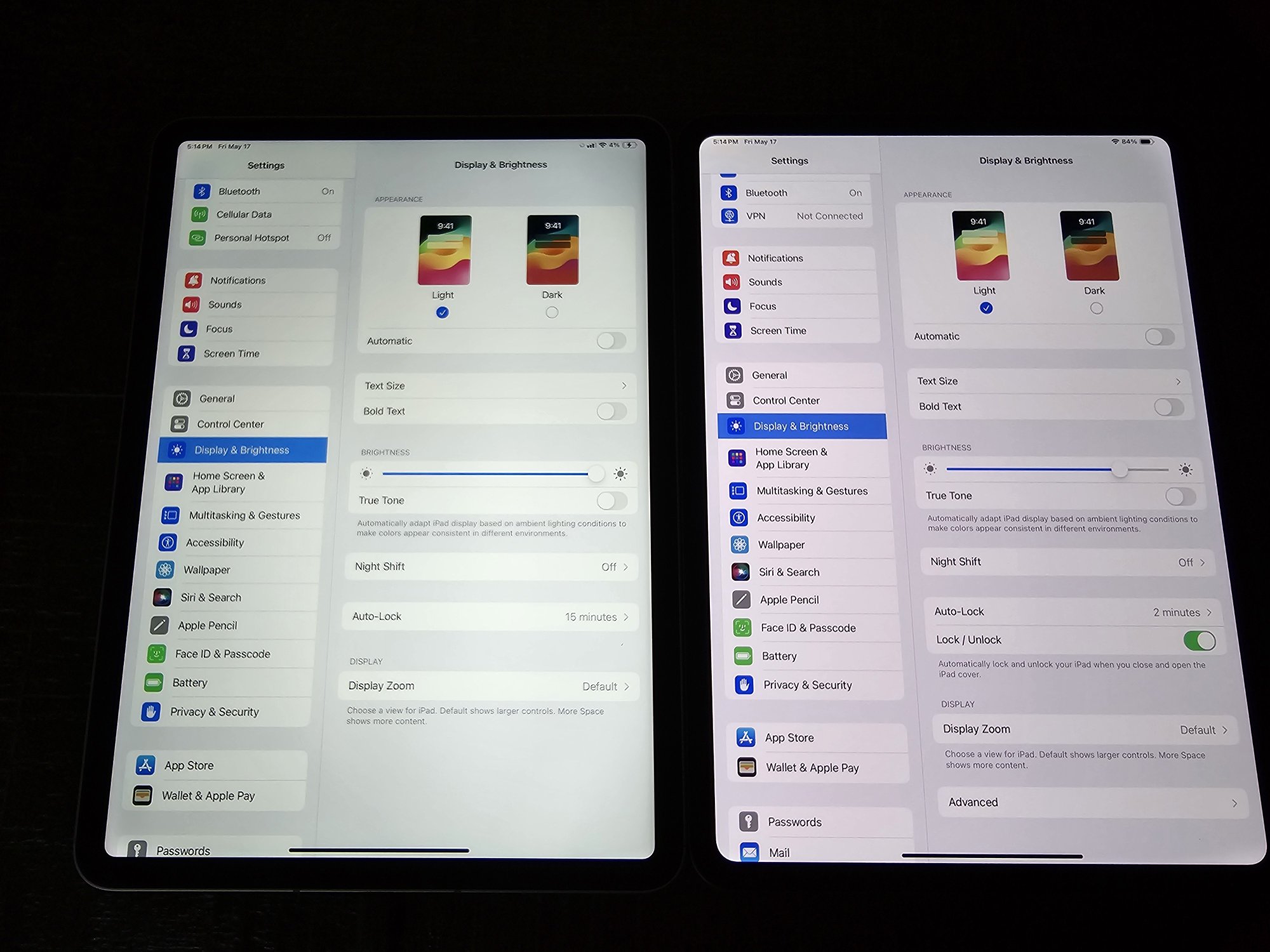

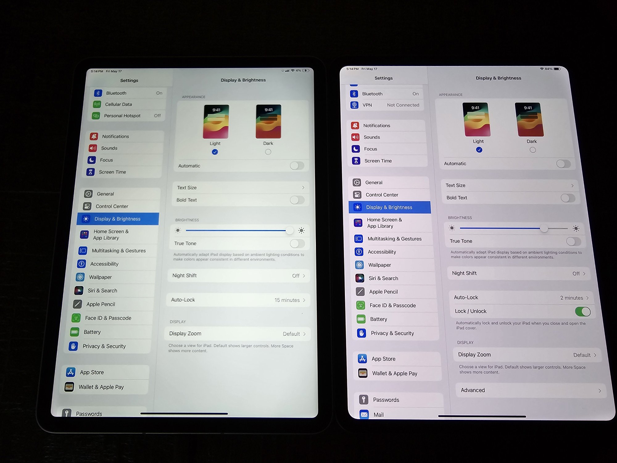

M1 on left and M4 on the right. I don’t feel like mine looks nearly as bad as others.
True Tone and dark mode definitely makes it more pronounced. Thoughts?
It still looks yellowish.
But if you have no problems with how the screen is, especially, when you aren’t comparing then it is fine.

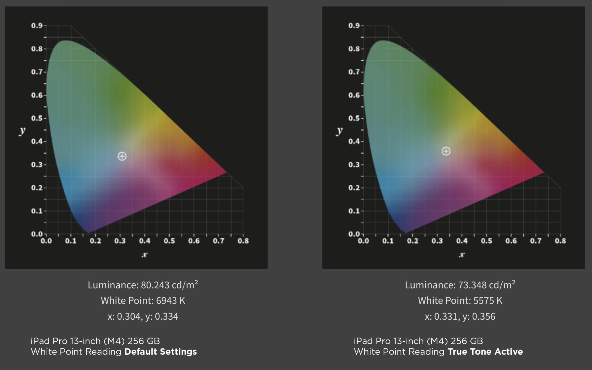

i got my iPad Pro 13 inch on Friday and was really looking forward to it. As I usually do compared it to my M1 12.9 inch Pro and to me the screen was just too yellow, it was almost like True Tone was on even when it was off. Then if i did turn True Tone on it looked like I had a weak night shift enabled, real shame. I even compared it to my 15 pro max thinking it was just an OLED thing but no the iPhones screen was pretty similar to the 12.9 iPad Pro. Even an 11 inch M1 iPad Pro had a better screen imo. I’ve returned it and going to wait a few months until I try it again.

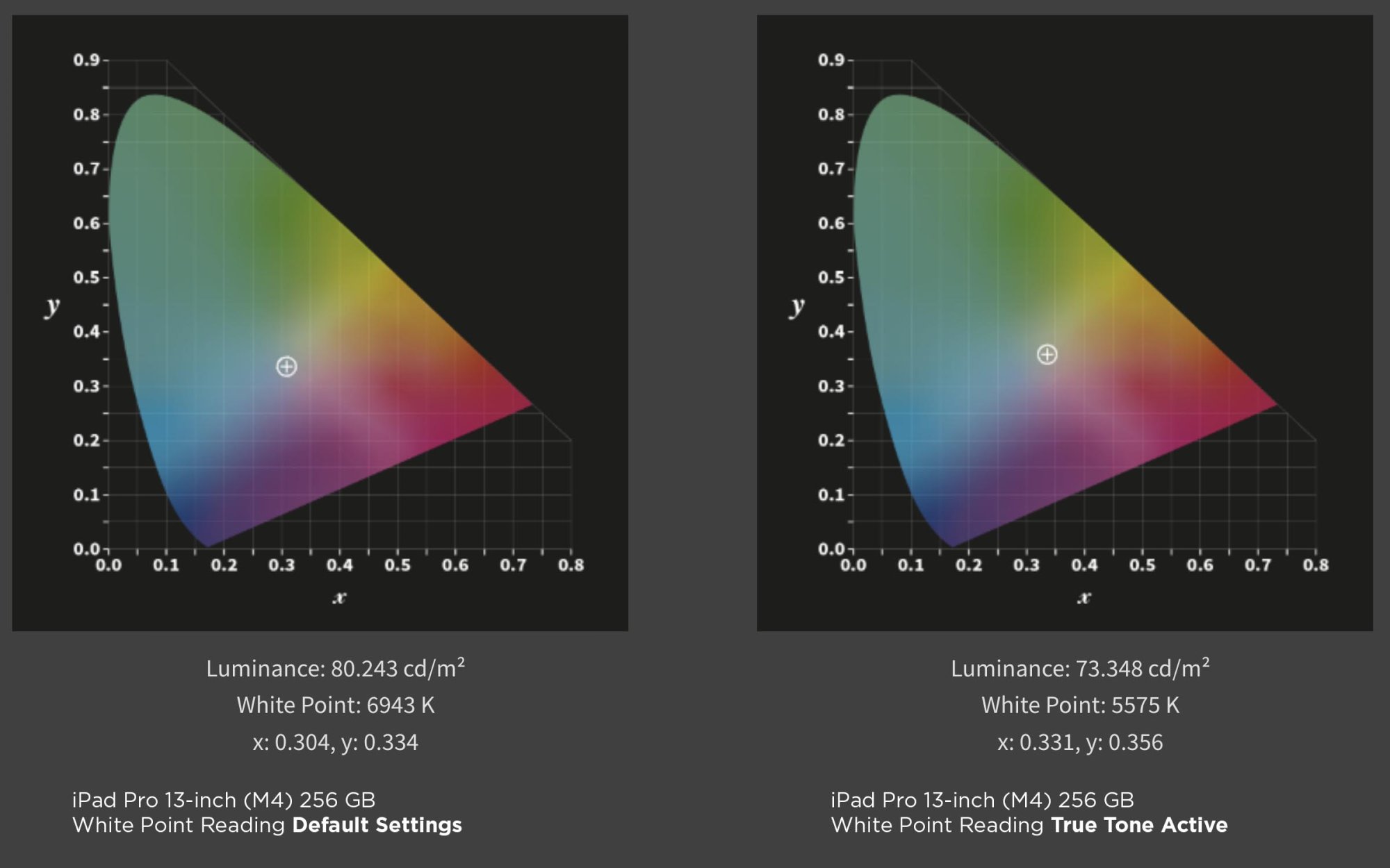

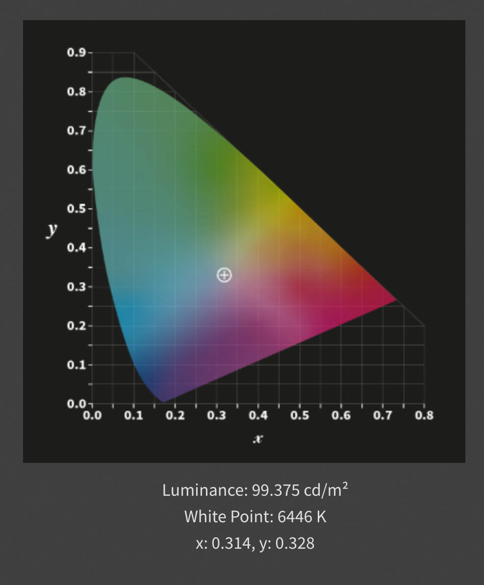

It's becoming clear that Apple is shipping some MacBook Pro M4 displays which have a warm white balance. Mine was not but I measured it with with and without True Tone enabled and this was the result.
Reactions: klasma and mtngal

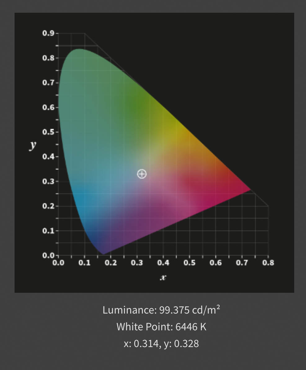

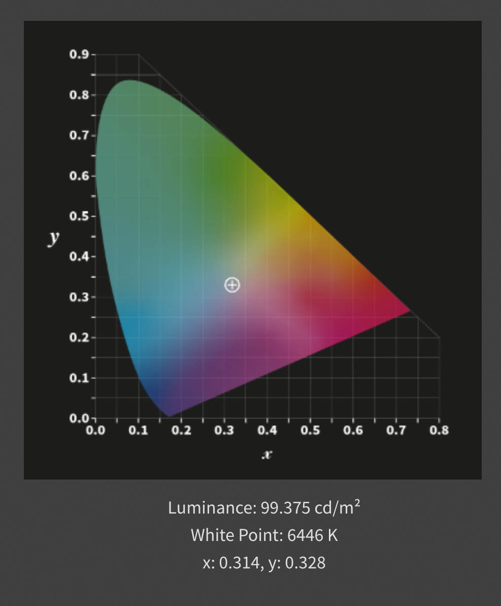

Interesting to compare readings. I didn’t do one with True Tone active, only with the default settings. True tone looked lousy and I was interested in setting the white point.
I had the display brighter than yours. White point is different, warmer than yours. I measured it at two different times and the figures were slightly different - do OLED screens sort-of shift as they are on, or something?
Interesting - Your reading with a Luminance near 100 and White Point near 6500 seems ideal. How frustrating that all the new displays aren't shipping with this white point. Would be nice if Apple would comment on this.
