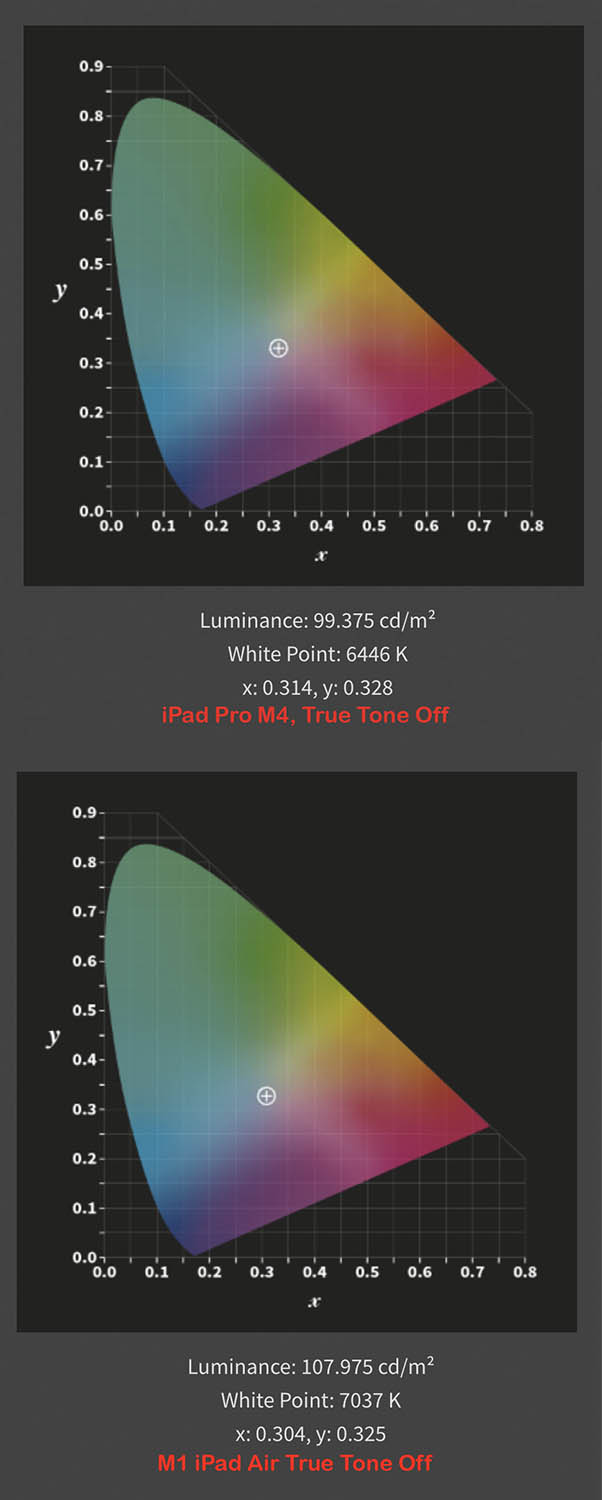

You say that, but has anyone actually proven the M4 is "more neutral" than the M1? Which is actually closer to what they both should be?
I'm not used to uploading anything to this forum, not sure of formatting etc. But here's a comparison between an M1 iPad Air and my M4 iPad Pro (13"). True Tone is turned off with both.
D65 (6500K) is considered an industry standard for viewing and editing photos. There are other standards for other reasons. Since I only do still photography, I use the D65 standard.
So in the case of my M4 iPad, it is set very close to the 6500K standard (white point 6446K) while the iPad Air is cooler by a fair amount (7037K). Higher numbers are cooler, lower numbers are warmer.
So in the case of these two iPads, the M4 is closer to the standard than the M1 Air. Not proof overall, but certainly proof in my case.
