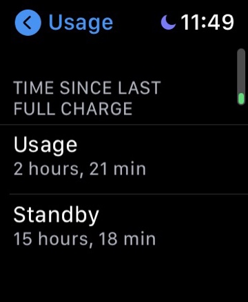

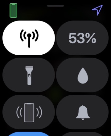

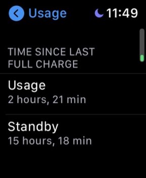

See my earlier post - Saturday from 7:30am to 11:48pm, with an hour non-GPS "workout", I still had 53% battery left. Then Sunday, from ~8:30am to nearly 11pm, with a 45 minute non-gps "workout" and a 50 minute gps-on outdoor walk, I had 44%.
These are with no features disabled. AOD on. Infograph watchface. One third-party complication (MyNetDiary).
I'm finding battery on my S6 is slightly better than I was getting with my Series5, and also on par with what I used to get with my Series4.
