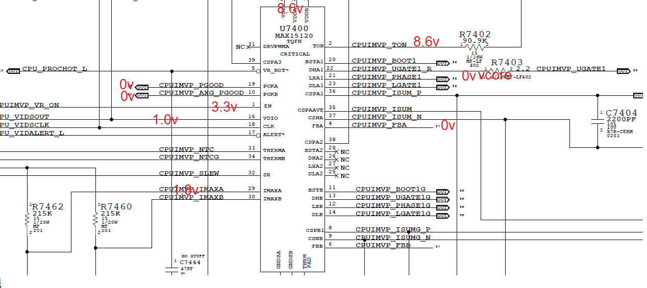

hi,

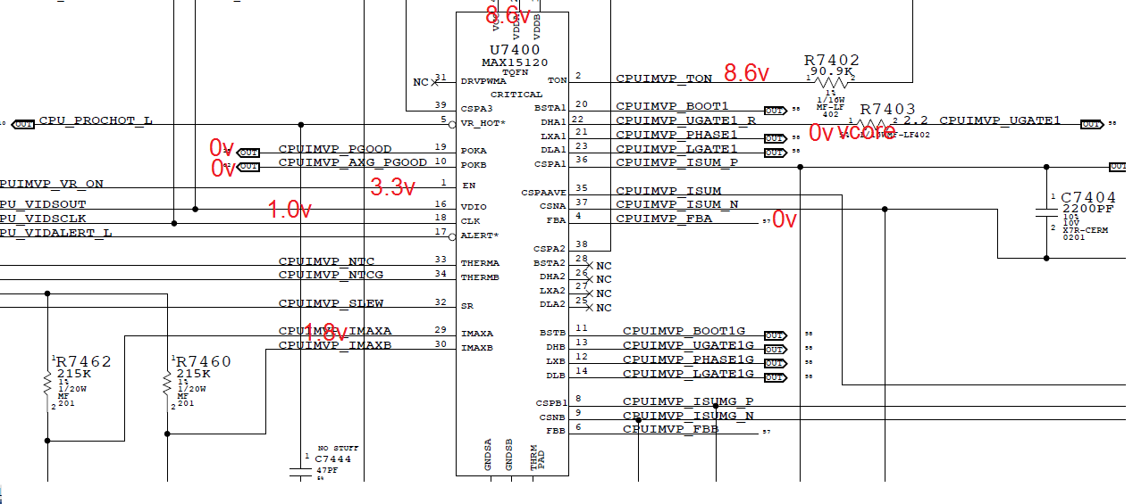

i hav mackbook air with same problem as you mention above, i hav attach the MAX15120 voltages levels,
Note :-
P5V_S0_CPUIMVP_VDD=5v
CPUIMVP_VR_ON=3.3v
CPUIMVP_PGOOD =0v
CPUIMVP_AXG_PGOOD =0v
PPVCORE_S0_CPU=0v
CPU_VCCSENSE_P=0v
CPUIMVP_FBA=0v
Regards,
GL0gic
My signal CPUIMVP_FBA which traces back to CPU_VCCSENSE_P comes directly from CPU chipset. It is reading 0V which should be 1.1V, but if you look at my picture attached CPU_VCCSENSE is just a sense line which reads the voltage from PPVCORE_S0_CPU --this is my main issue. I should get 1.1V instead of 0V.
Now, if you look at my other picture the signal PPVCORE_S0_CPU comes from U7400....so going in circles we are back at square one.
Note: I already checked R7412 which has 8.4k as well as R7422 (8.6k)

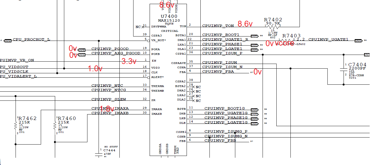

hi,
Note :-
CPUIMVP_VR_ON=3.3v
CPUIMVP_PGOOD =0v
PPVCORE_S0_CPU=0v
CPU_VCCSENSE_P=0v
CPUIMVP_FBA=0v
Regards,
GL0gic

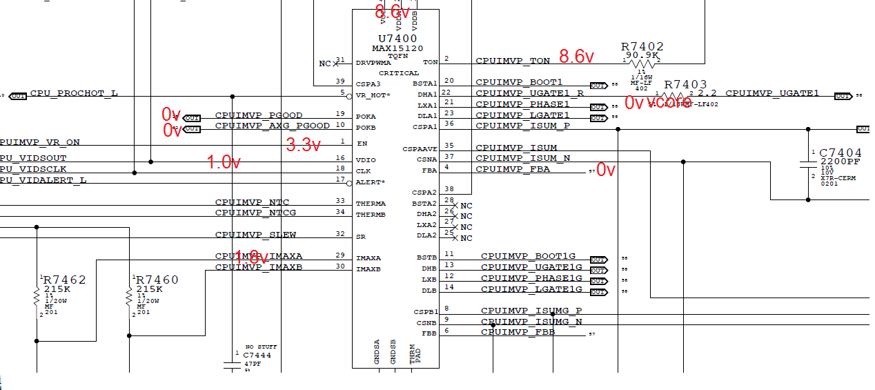

hi,
Note :-
CPUIMVP_VR_ON=3.3v
CPUIMVP_PGOOD =0v
PPVCORE_S0_CPU=0v
CPU_VCCSENSE_P=0v
CPUIMVP_FBA=0v
Regards,
GL0gic
Hi pin 2 should be 12v both sides R7402 if not change U7400.
Regards south 657
Regards south 657
fraid not south.
Macbook airs run on 8v.
read the battery.

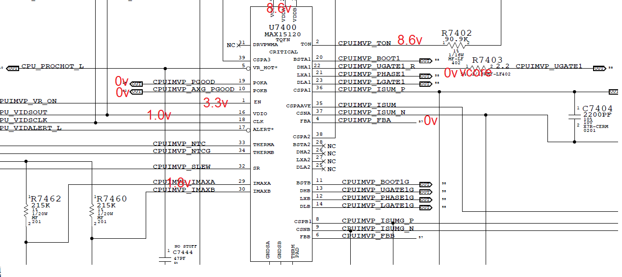

hi,
Note :-
CPUIMVP_VR_ON=3.3v
CPUIMVP_PGOOD =0v
PPVCORE_S0_CPU=0v
CPU_VCCSENSE_P=0v
CPUIMVP_FBA=0v
Regards,
GL0gic

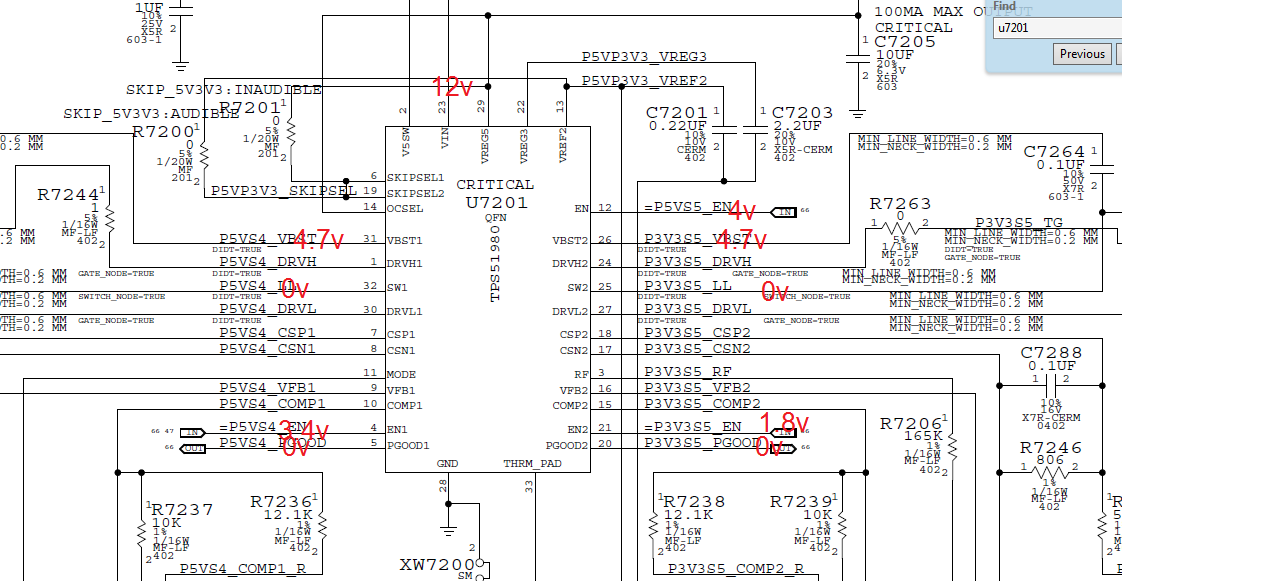

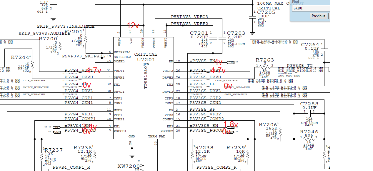

hi,
i hav 820-3462-a,
a) the problem is, without battery if i plug the megasafe, the green light turn into amber light in few seconds without battery connect, fan not run, no voltages in the board except 12v, G3hot.
b) tps51980. 5v gone short, later the short caps removed, but still the problem remains same. & there is no other short component in the board.
c) In S5 states the PP3V3_S5_REG line should available even without power on. i suspect tps51980 gone bad might be internal short-circuit inside chip.
do u hav any idea how tps51980 works?
thanks & regards,
GL0gic

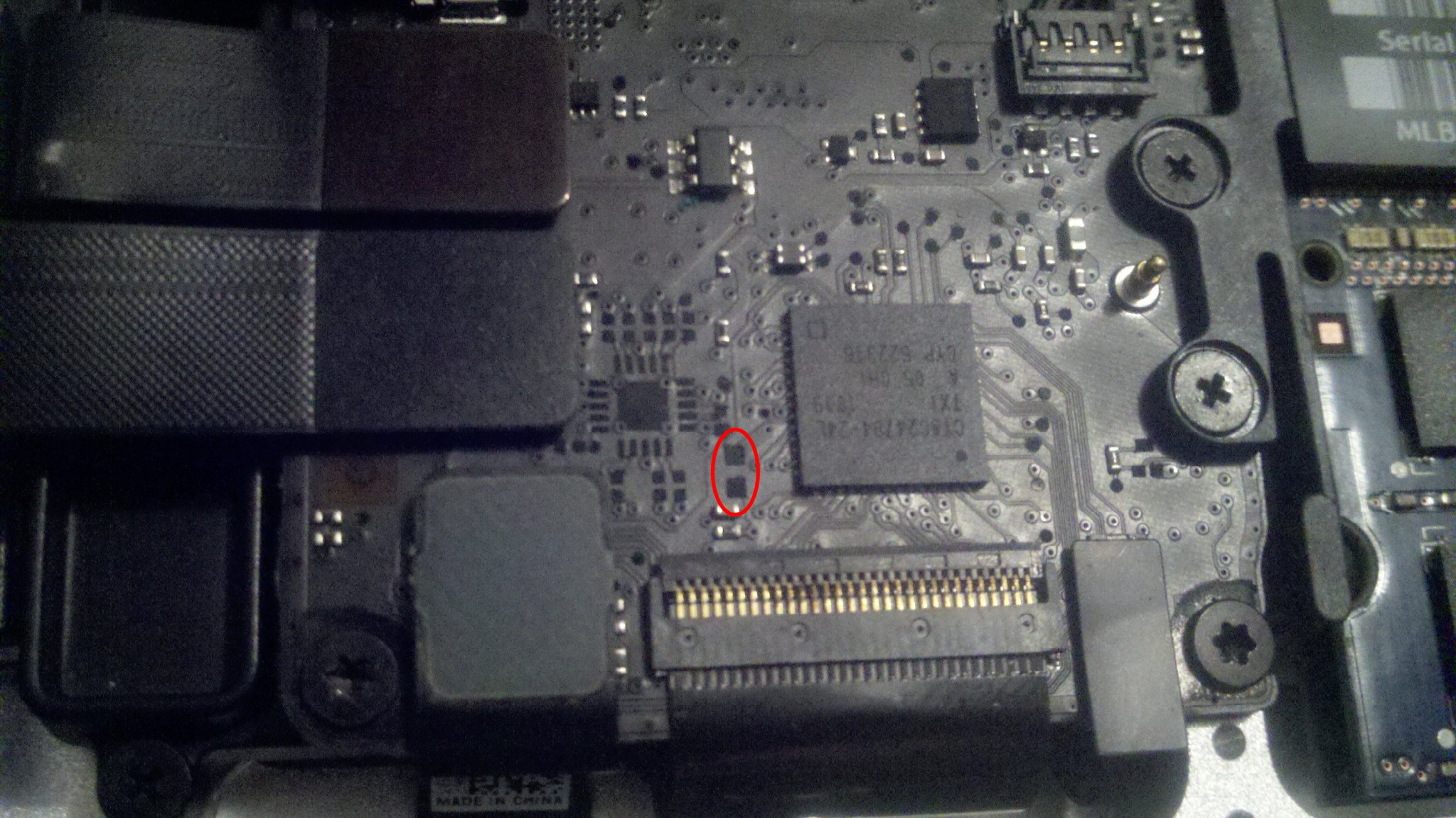

Boot problems on MBP 13" 7,1 A1278, EMC 2351, SMC 1.62f7
Sorry for the long post, just trying to be complete. Looking for schematics and a solution to this (apparently common) problem on my mid 2010 unibody Macbook Pro.
My problems started after I upgraded the RAM from 4GB to 8GB. I had to put the 4GB sticks back in when I discovered faster RAM won't run in my machine. It was PNY PC3 10666 not PC3 8500. Never heard of RAM being too fast! Anyway, after I put the 4BG back in and rebooted the system I noticed the clock was reset. Then I noticed the fans running all the time. Then it would just shut itself off. Each time I was able to reboot the system and seemed to be OK generally. Each reboot seemed to surface more issues. Finally it refused to boot at all.
I thought the disk might have gotten corrupted so I removed it, put it in a portable FW case and took it to my friends place and I used his system to run diskutil. It didn't find any issues.
I then found this thread and was able to boot the system with the "bypass" or debug procedure. I would check the G3Hot line but the pic on the 6th post by Dadioh doesn't look like my MB (no large pads like the photo shows). The system is my main workhorse and aside from the 1TB disk is all original. I have no idea hown many cycles are on the battery, but it charges to 100% most of the time, occasionally only to 96%. I try to hover around the 50% mark. Running Parallels, iTunes and lots of tabs in firefox I generally get around 2.5 to 3 hours of run time.
This thread is so big it's hard to find info in it, like the correct schematic or board layout. The control key is bad on the keyboard so unless the apple bios will work with a USB keybd I can't reset SMC with any key sequence that uses control (it's a pain for terminal work!).
I am a software engineer but my degree is in hardware. Not too long ago I could handle the scale of smc components in use but the technology has surpassed my eyesight and toolset in many cases. The large pads shown in Dadioh's pic would be nice, but I don't have them on my board. I have attached a pic of that area on my system and circled what I think might be the pads in question, tho not like Dadioh's pic. It looks like there's solder mask on them too. If one of these is G3Hot which one?
If anyone could point me to where in this thread I can find a layout & schematic I would be most grateful.I've spent some time searching but 119 pages with a keyword like schematic doesn't help much.
Any clues, advice or things to check would be great too.

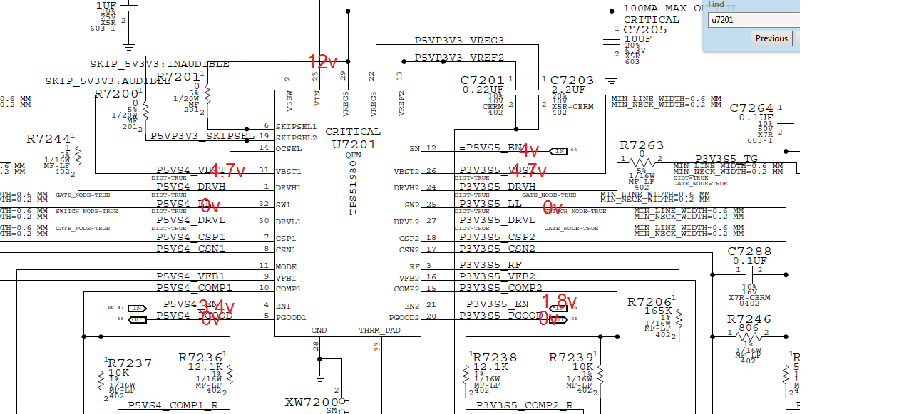

hi,
i hav 820-3462-a,
thanks & regards,
GL0gic
Hi G Logic,
You can get info on the chip just Google tps51980. If both pads of the caps go to earth just change tps51980 it is a common failure. You should have the 3v and then 5v after you push the button.
regards
south657

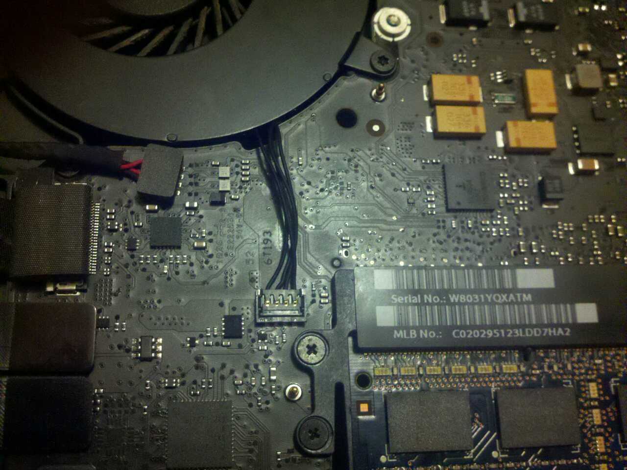

Hi motechman,
First you will need the Logic board No. starts 820- located on the board around the fan area.
It would be a good idea to change your key board look on you tube on how to do this. Can get key board on ebay.
Regards
south657
Reply to South657
Could you be more specific? I looked with a magnifier around the fan and could see no bd numbers as you described. Of course if you're talking about the back of the board I don't have xray vision so they're not visible.
Removing the logic bd is a pain. I did actually TOTALLY disassemble the entire unit to see if I could find the control key malfunction but could not. Those are the tiniest little screws, all 79 of them (I have no idea how many there were, but it was a bunch!)
I checked on ebay and found a replacement keybd without the top case for cheap, so I may order that and fix it, but this SMC or other problem is more serious and will get my attention first.
I'm really bummed that issue appears to be rather common and manifests such a broad range of problems. I'm hopeful I'll see the solution to that here. The "bypass" / debug workaround has at least allowed me to boot the system again. It ran all night in sleep without shutting down, and I just woke it up and it seems fine (except the fan runs all the time. I moved the ?PlatformPlugin?.kext file so that makes sense).
Is there any way to tell which 820xxx bd I have from the photo I posted? If I have to remove the logic bd again I will but not just to read bd #. Alternatives to that would be nice to know, since I would need to reassemble after getting the bd # to do further troubleshooting. I have no bench system or jig to run it live outside the unibody frame.
BTW, how likely are these symptoms the cause of a failing battery? It is 4 years old now, and has seen pretty heavy use. I don't know how many charge / discharge cycles are on it, and I get nowhere near 8 or 10 hrs of life on a charge with the way I use it (see my original post), but 2 - 3 hrs seems far from "near death". For the first year or two the system was barely used at all as I had my 17" mbp. But the display went south and I was rather cramped in that 3GB of memory space so I moved the disk to the 13" and carried on.

Hi motechman;
The number is on the side you are looking at, they move it around from year to year it will be on the left hand side from the middle just up
from the ram and as far over to the fan connector and up around the edge of the board by the fan wires. It will be on it for sure.

Hi ZZZac,
Just starting my first 3115-B board are the pads just left of the chip left of SMC?
Its a beer spill have changed U7000 i now have g3hot 12v green and orange with battery 3 & 5 v at the chip will not start LOL
Regards
south657
I have found the pads in a pic on this thread just up from keyboard con.

Hi motechman;
You need to replace the keyboard so you can do a pram reset you can not do it without that key then that should sort out the fan and
other things that might be rong.
Also changing the battery would be a good idea they are not much. And if you want to speed things up go for SSD drive.
Regards
south657
Are you pulling my leg? I mean I have looked ALL OVER that board with a high power magnifier and the ONLY numbers I see are the 6T193 to the left of the fan wires. That number in particular came out clear & sharp in the photo attached but the other shots I took of the board don't have that level of clarity on those numbers.
If you could post a pic of 1 or two examples I may be able to spot it, but man I have spent 20 minutes looking and the 6T193 are the only numbers I see, NONE with 800 in them. None.
As for batteries not being much, well, the best price I could find on one was over 60 bucks. There was a time when I didn't think that was much but that time is not not now.
I use a 1TB drive, and as yest there are no SSDs that big. I could go for that hybird 1TB drive, it is a good price, but I'm not that much of a performance hound now. Just don't have the $ for it. I haven't looked into the reliability specs on the hybrids either, so unless their much greater than std drives I don't think I'd go for one. Although $100 for a 1TB hybrid sounds like a fantastic price!
