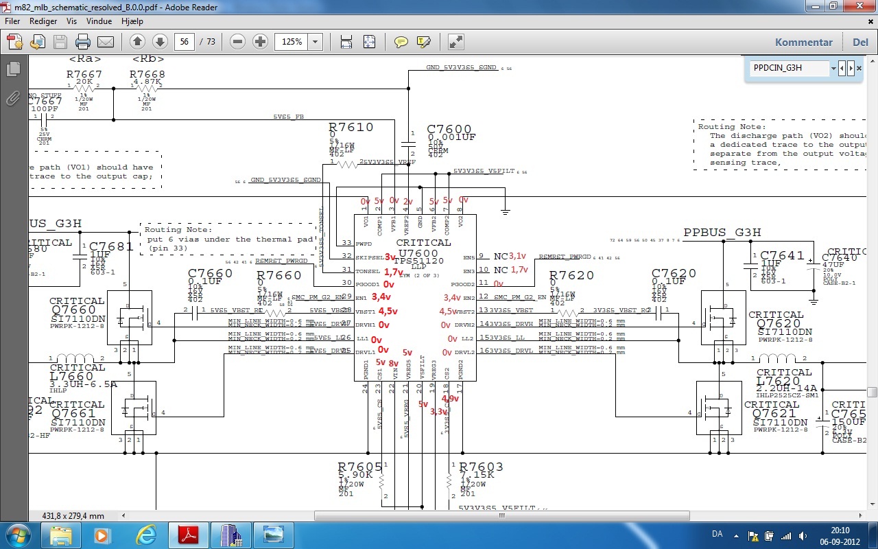

I have a mba A1370 that wont turn on. I believe the problem is U7600. It doesn't output 5V (PP5V_S5) and 3V (PP3V_S5). As far as I understand DRVH1and DRVH2 should activate Q7660 and Q7620 but both pins are 0V. I can't find out why.
I will attach measurements on U7600, schematic and board view file if somene want to help.
View attachment A1370 - M82 DVT3 820-2179-C.zip
How is your G3H supply voltage? Need to start there on page 57 of your schematic.
Thanks for replay.
G3H (PP3V42_G3H) is ok. DC Jack interface (on page 50) is ok too. That's why it is tricky. Normally, if fan wont start it is either Sys_onewire circuit, battery charher circuit or G3H.
I don't have a good LB to compare voltages. Something is causing U7600 not to open Mosfets for 3&5V.

Thanks for replay.

Hi,
I think I found out why there is no 5v/3,3v from U7600. Both PP5V_S5 and PP3V3_S5 are shorted to ground. It is almost impossible to find out what is causing it. It is maybe U7600 itself.
It seems unlikely that short should come from to different sources at the same time.
I have observed the first time I checked the board for corrosion and fluid (didn't find any) that the GPU, I believe (the bigger chip) was miscolored.
So after I found out about short I tried to reflow the GPU with my IR machine as last resort. But the short was still there.
It would be nice if you could measure impendance and voltage at pins 1 and 8 on U7600 on both boards and post the results.

Hi,
with kind regards

I'm looking at your schema pg3, are you getting 12V on your F6905?
If yes, I would check the voltage on the two FETS Q7080 and 7085.
My newer LB has a diode but yours it appears has two FETS.
I would try to trace it and see if it is 'before' or 'after' a certain component.
Fuse is good so are the FETS
I have the complete G3Hot circuit working.
Mine was liquid damage.
Ok, my layout is different then yours so my pin 7 is your pin 8 and measures 3.3v
My pin 24 is your pin 1= 0v
I do not have the equipment to measure the impedance.
Also note: My MBP that does not power on has the same values pin 7 and 24
Sorry I meant resistance. No impedance.I don't write in english so often.
