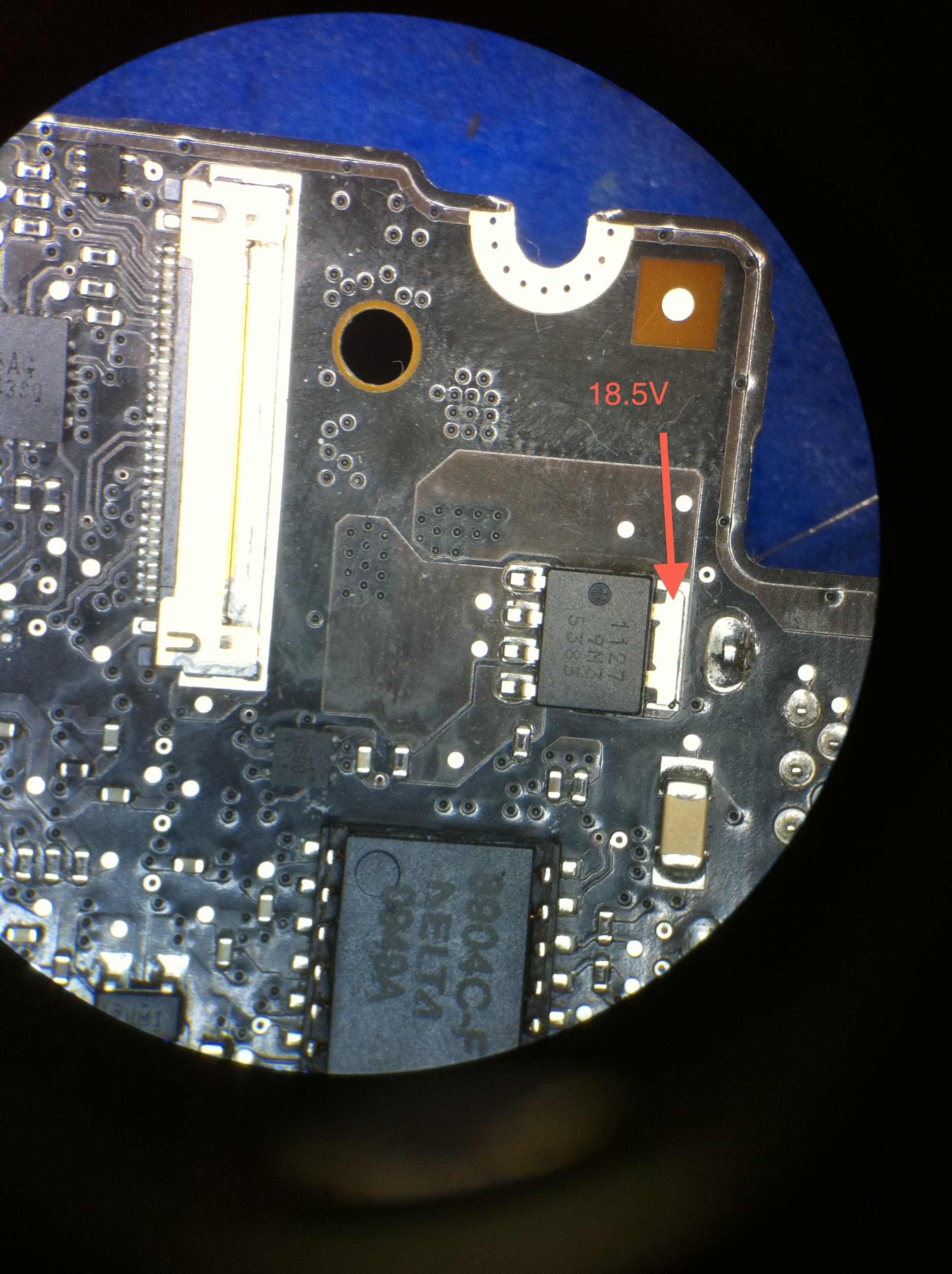

Here are a few quick checks.
Down near the battery connection there is a white bodied component that is the fuse that protects the main 12V supply to the board. If you (carefully) measure the voltage on both ends of the fuse then you should see a little over 12V. If not, check that fuse.
If you do not have power at the input to that fuse then the other fuse is on the underside of the board near the magsafe. That is the main fuse on the 18.5V input from the magsafe.
If that fuse doesn't have 18.5V at its input then you probably have a bad magsafe board. Give it a visual inspection for damage.

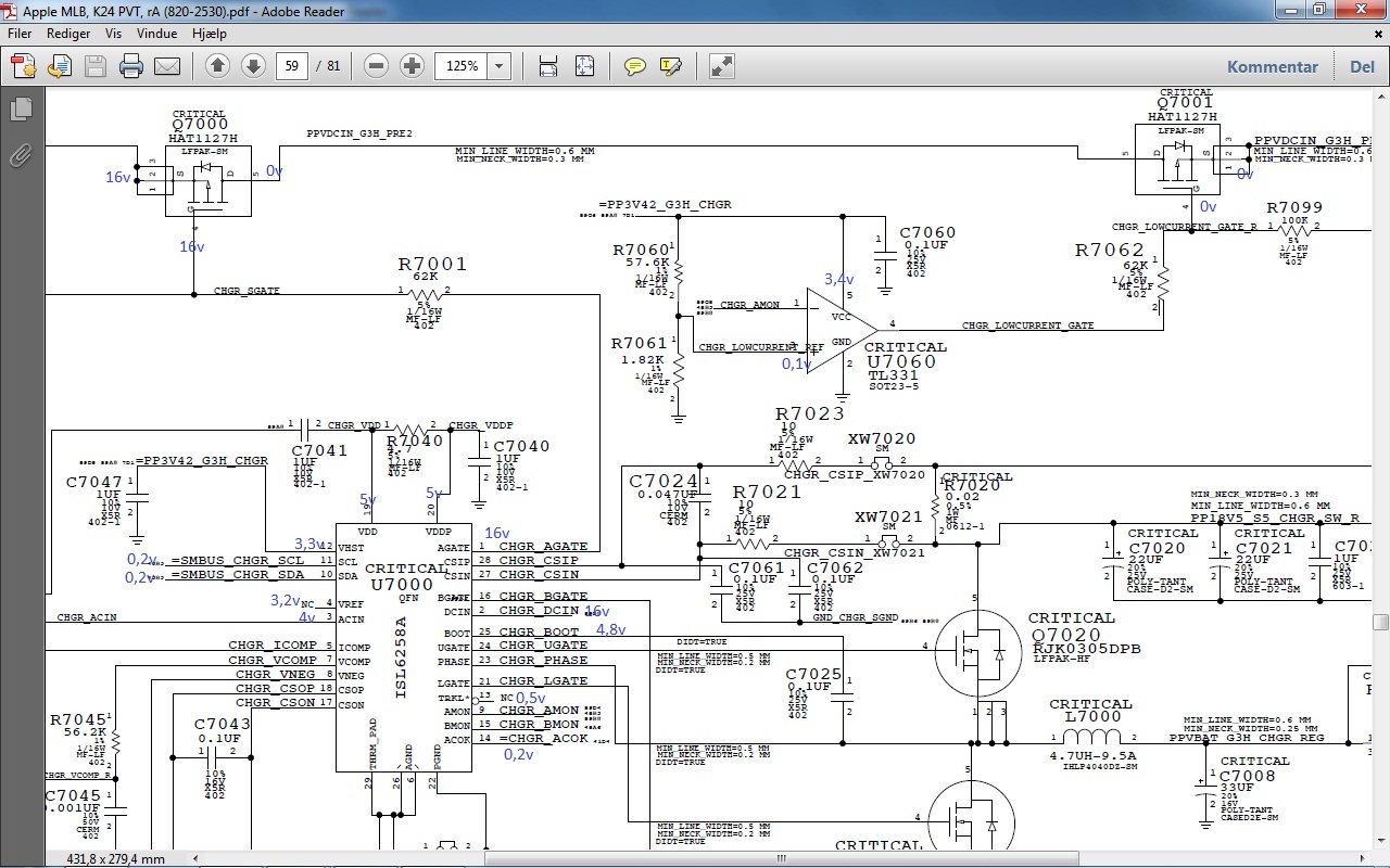

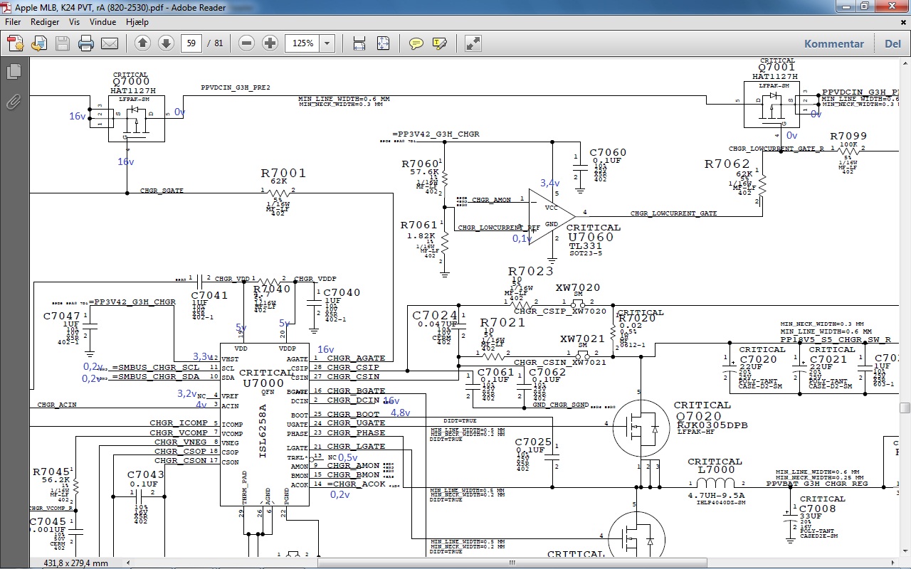

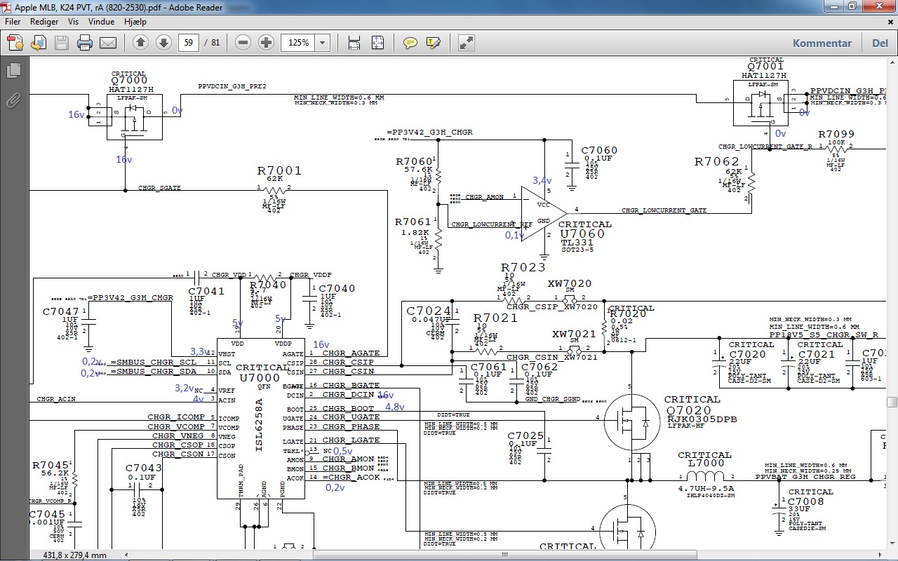

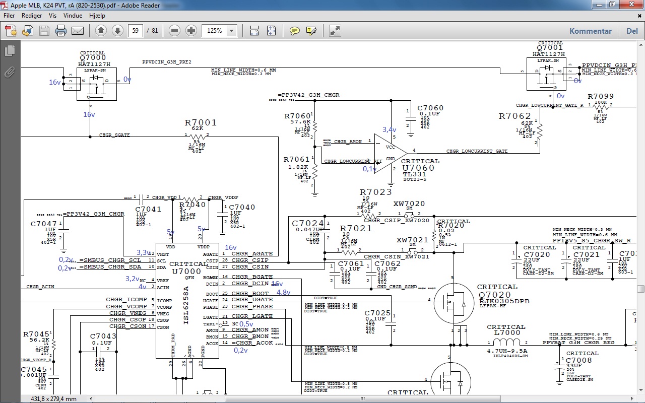

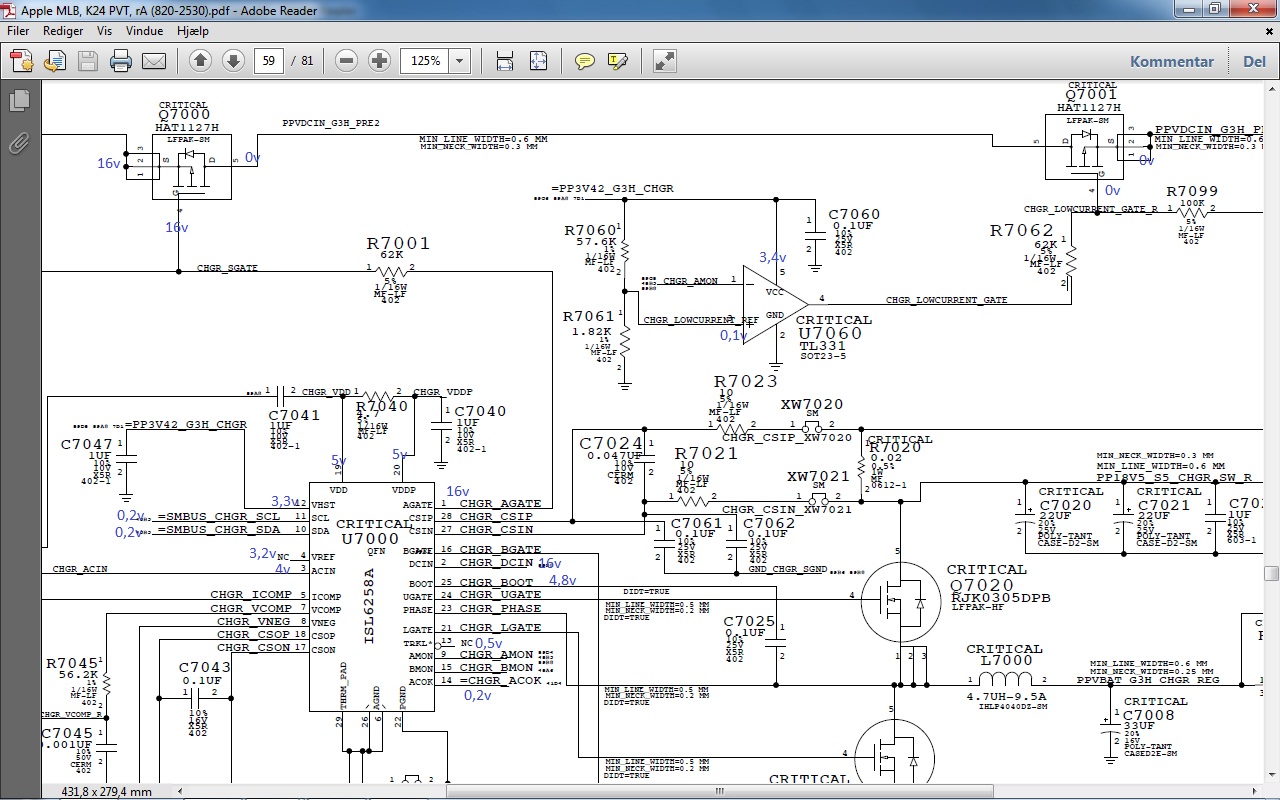

Hello,
I have a A1278, Unibody mbp 13" that will not power up. The problem seems to be in charging circuit - IC U7000. There is no 12,5V voltage output on PPBUS_G3H.
Please see the image attached.
I tried to isolate the problem but nothing seems to help. If someone have a good board please will you send a measurements of voltages.

1=16.7v 16=4.82v
2=16.7v 17-18=12.6v
3=4v 19-20=5v
4=3.2v 21=.62v
5=1.3v 23=12.6v
7=1v 24=13.4v
8=2.05v 25=16.97
10-12=3.4v 27-28=16.62v
14=3.2v
All other pins are ground
I could not find the U7060 if you tell me where it is I can give you those.
Q7000 pins 1-3 are 16.5v
pin 4 = 6.45v
pin 5 = 16.5-17v
Q7001 is the same as Q7000 except pin 4 = 16.5v
Thanks mac.
What do and other think the problem is? Could it be U7000? In some of mb and mbplogic boards I had it was mostly Phase and UGate that was shorted to ground but this one is ok. No short around IC.
Thanks mac.
My guess is the Q7000 since it feeds the Q7001 which would explain the 0v on that one. Plus your voltage seems pretty low at Q7000. Usually it is at least 16.5v-17.25v. i have never actually seen one with 18.5v like the schematic says.
Normally they get hit by liquid through the keyboard. I have the board view file, just can't find that U7060. Can you key in the part number somehow in the board viewer? Can you let me know where it is at?
