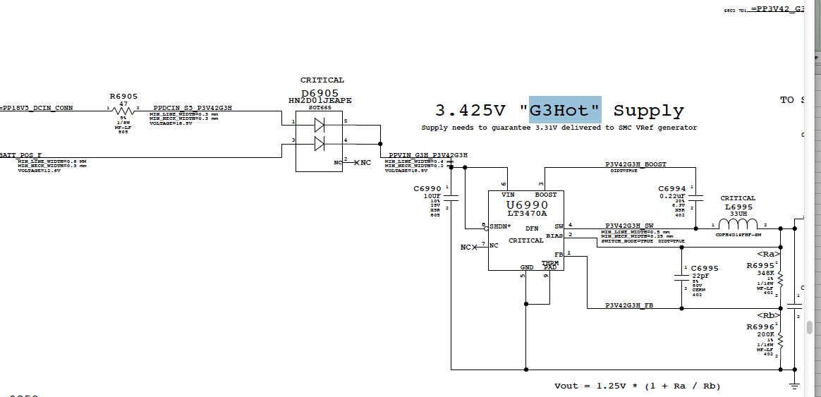

Short update:
1. G3HOT - 0.8 V
2. Battery connector: pins 1-4 and 1-6 - 0.8V; pins 1-7, 1-8, 1-9 - 11.8 V
I understand that "0.8 V" is the problem. What is next to check? I am a little confused with all these pieces

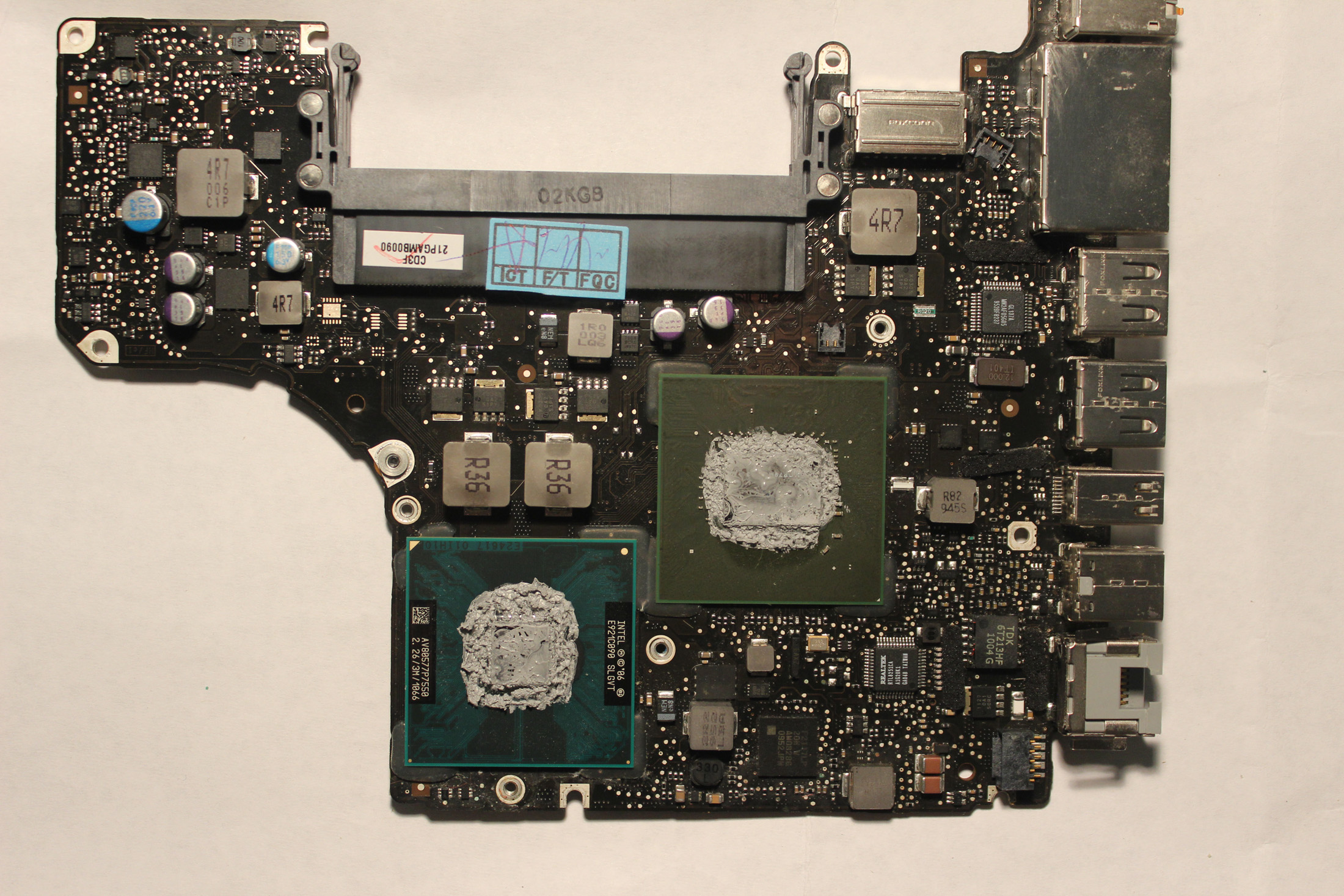

I attached bottom view of my LB (A1278 820-2530A). Top view is the same as on page #1 of this thread.

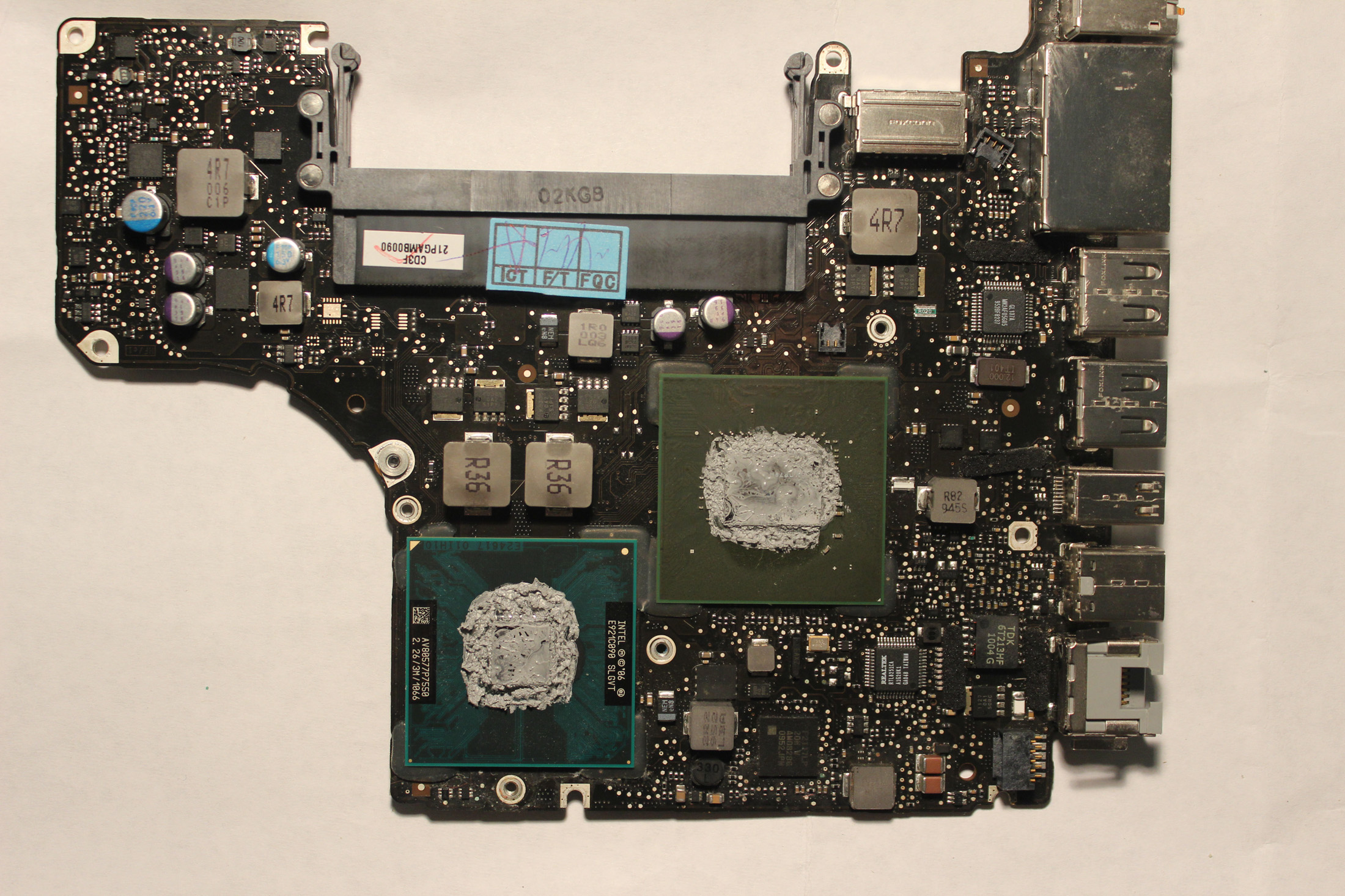

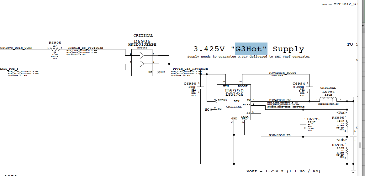

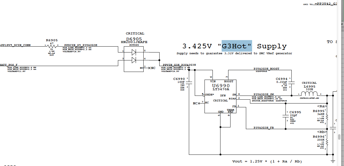

Attached is a typical G3HOT circuit for a 13" MBP. G3HOT is the initial power that MUST be up at 3.42v before the system can even begin to initiate system power up sequence. This is the main supply to the SMC and is ALWAYS present when a good battery or magsafe is connected, aka, it is always HOT. Thus if G3HOT is not up, the SMC can't even begin to determine if everything else is ok and can't even initiate a communication with the magsafe or battery.
As you can see on the upper left, the magsafe power OR the battery power is the source to G3HOT generator. This raw DC voltage (16.5v or 12v) is down regulated by LT3470 to generate the 3.42v. This chip generates 3.42v (G3HOT) when the feedback input from R6995-R6996 to pin 1 of the chip is 1.25v. Others in this group can point to you where these resistor and chips are located.

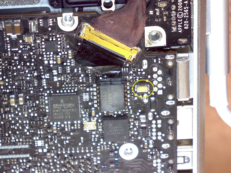

Need help on A1278
Hello,
I'm working on a water damaged A1278, and need some help from you guys.
This A1278 was originally water damaged, so i cleaned the board pretty good and got it to boot up. Then went back to test it again the next day, it didn't boot up at all.
Here's what happened:
- Laptop won't power on (fan won't spin) when MagSafe plugged in.
- Laptop CPU spins up (very high speed) after did the SMC reset (no display or chime or boot), and as long as the MagSafe still plugged in then i can shut down and turn it back on using the power button, but when i unplug the MagSafe then i can't get it to turn on (even with just the fan on) using the power button.
- Checked and got good voltage throughout the board (referenced to the previous threads on this site).

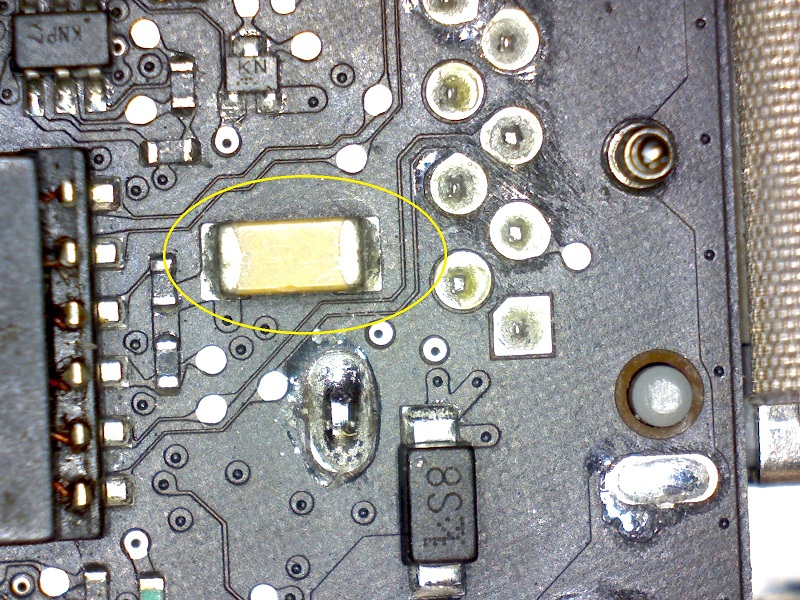

- But there's one little white component (not sure whether it's a resistor or capacitor?), i got no resistance or voltage on this at all (see pics).
My question is what is it, and should i get some kind of resistance or voltage from this component? Is there any way i can by pass to confirm that this caused the problem? Or if there's any where i can get a replacement if it was bad?

How about a macbook pro 13 "water damage. Achieve the wled change, with the help of this great forum, all successfully. Everything works fine, however I realize that the horizontal line of the letter keyboard xa the m does not work, and wipe the entire card with alcohol but I can not fix it, the keyboard is not poor because another. can you help me please to identify the components to replace or check if they are in good working order? Greetings to all from mexico. 🙂
Hello,
Close-up:
That is a capacitor on the ethernet magnetics and should be unrelated to anything but ethernet. It should measure open circuit with power off.
Then what you think i should check for in related to these issues:
Thanks in advance.🙂
Ok thanks Dadioh, proceed to check each of the pins of a good card, just finally, to check the pins with the card is plugged into the mains eliminator? regards
Whenever measuring resistance on a logic board the power should be removed. Disconnect the battery and magsafe.
Can somebody in this group point to me on a board 820-2530A where LT3470A and R6995-R6996 are located?

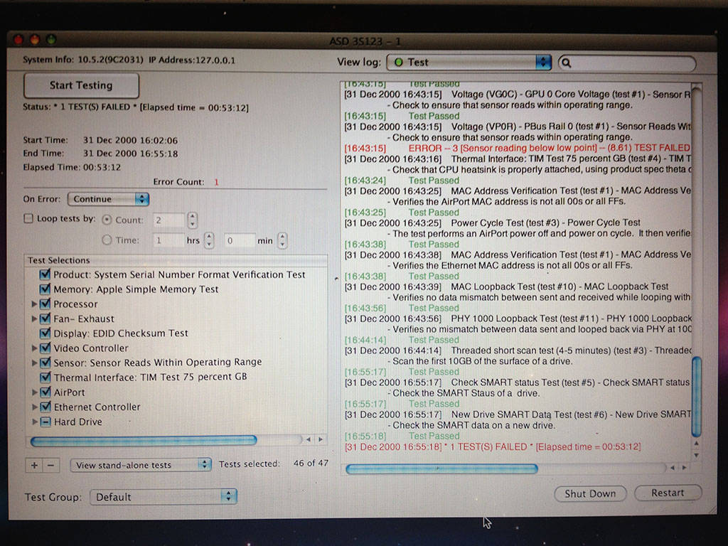

please could anyone offer any advice with troubleshooting a MB 13" 3,1 late-2007 (non-pro - i realise this is the pro forum, but this particular thread seems to have the most knowledgeable people in it!)...
it suffered a liquid spill, after cleaning thoroughly it now boots and functions 99%. the issues i have found are that:
- asd diagnostics failed one test (VP0R PBus Rail 0 sensor reading below low point - 8.61)
- occasionally when switching on the fan spins up and front led comes on, but no display or chime. if i hold power button to force it off, then power on again it boots normally the 2nd time.
- when switched on, if allowed it to go into sleep mode through inactivity it occasionally cannot be woken. have to force power off then switch it back on and it will recover from the sleep state. sleep mode which is activated through the magnet detector on the battery connector works and wakes fine every time.
i have another logic board from the same model (however that it also faulty - does not boot at all so i cannot trust that every component reads as it should) and have tried comparing the resistance and capacitance of the components around the battery connector and magsafe connector areas, but they all appear to match up.
one thing i am not certain of though is how to take voltage readings? i notice on page 37 another user was having PBus voltage issues on an MBP, but i have only taken multimeter readings of components with the power disconnected - is there a way to physically check and confirm the PBus voltage?
many thanks
