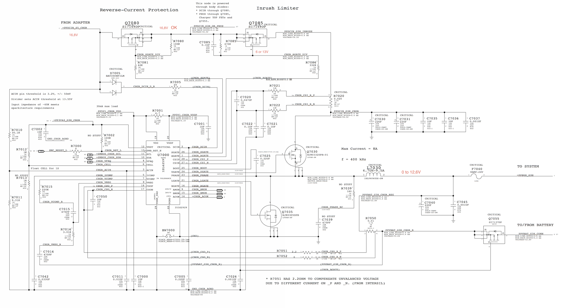

My MB13W schematic is quite different from yours so I can't tell you what your Q7030 is doing (not in my schematic). See the attached schematic, yours should be similar and the voltages should also be similar if magsafe is plugged in. If the lower FET GATE signal (LGATE) is not pulsing, then the FET or the ISL6259 maybe bad.
Yesterday I tested and measured the logic board. About five for ten times, when I contacted the magsafe adapter to the motherboard, the voltage of the PPBUS_G3H was right. The voltage was 12,6V, but about five for ten times it changed continuously. Therefore I think the ISL6259 and the FETs aren't bad, because sometimes the PPBUS_G3H works properly. But in this case the logic board doesn't turn on and doesn't work from the full charged battery.
I think the problem could be on a higher lever. Do you have any idea?
I attached my schematic.
Thank's!

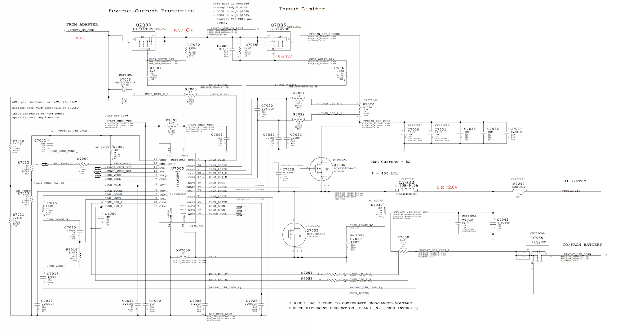

Thank's!

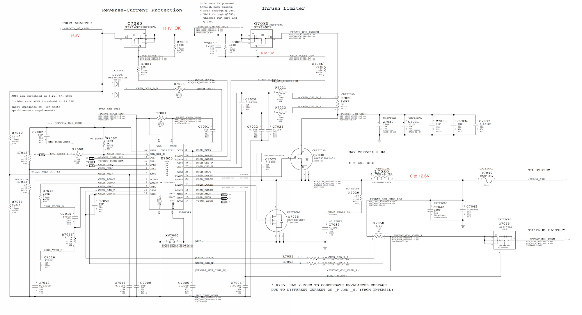

MBP13 mid 2010 A1278 K6 - no boot - no charge; bright green Macsave
hello to all from Frankfurt - Germany.
First of all - I hope for all guys at the eastcoast, Storm 'Sandy' didn't affected you and your families personally!
Follow the sentence "Don't ask what the MacRumors Forum can do for you - ask what you can do for the MacRumors Forum!" - I will document my MBP 13 mid 2010 errors.
The MBP13 has bright green light on the Magsave. No boot, no boot by pass over SMC Control, no battery charge, no 3.42_High start by bridging contacts left near the keyboard.
Voltages on G3Hot 3.42, DCIN_CONN 18.5V, 5V at pin 19 VDD_ 20 VDDF on U7000 (ISL6259(A));~3,3V on Pin 14 CHRG ACOK (U7000); 18,5 V at the Drain on Q7030 (RJK0332) 🙂 but 🙁 --- only 1.6V at Gate and effluent 1.6 V at the Source of the Q7030. So the Gate and the Source has the same voltages and no regulations will be effected.
The Source will be regulated from the U7000 PIN 24 UGATE and just have 12,5V (when other signals/voltages ok) to flow to the System PPBUS_G3H and to charge the Battery by PPVBAT_G3H_CHGR_REG by Q7055 (SI7137).
Next step was to measure the resistance between Gate/Source of the Q7030 (RJK0332). Short curcuit! So far - so bad! 😎 Two possible causes: 1st. - short of the Q7030 (Gate/Source) or --- 2nd. short between Pin 23 PHASE and 24_CHRG_UGATE.
Now I have to order the RJK0332 and the RJK0305 (only for security reasons) and the ISL6259. The Solder out of the Q7030 will be not dramatic, but to solder out/in the U7000 this will be a challange! 😱 So I start to pray that the Q7030 is the bad causes.
Has anybody in the Forum experiences about this error and/or tips to desolder the U7000 by a hotair soldering station? I sold a new one, but my experiences are like a rookie.

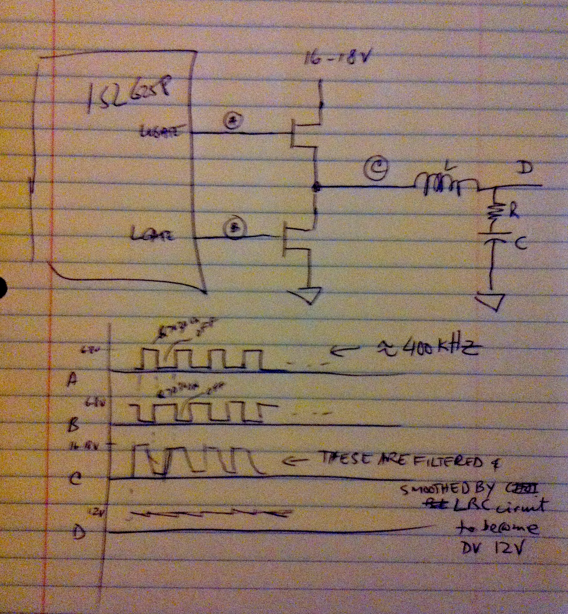

The issue of NOT getting PPBUS_G3H to generate 12v has been mentioned by many people here including U-234 who asked that question privately. I am responding here so others can benefit too. Here's a hand drawing of how it is SUPPOSED to work. So far, most Macs I saw in this forum have similar design, power wise. Basically, the raw DC from the magsafe (16-18v) is chopped by the two FET shown in the drawing so that they are alternately turning ON and OFF. If one looked at the junction of those two FET with the choke disconnected, it will looked like a square wave peaking at raw DCIN voltage (frequency at approx 400kHz), however, when the choke/resistor/capacitor is present, the square wave is then smoothed/filtered out to become DC voltage. The resultant voltage level is controlled by the ISL6258 or ISL6259 as it monitors the feedback signal and it then modifies the duty cycle (how long to turn the FETs on and off and thus you get 12v. If you are using just a voltmeter to measure the UGATE/LGATE signals you will not be able to see these pulses. If you are lucky enough to have an oscilloscope, you will be able to verify these pulses and its relationship to each other. Please note that if the system is operating on battery power only, the FETs are not even turned on since the ISL is not getting power from the magsafe. PPBUS-G3H is like the main artery in your body, it provides the main power to the system, but there are many smaller veins (other lower level voltages) that must also be present before the system can power up and boot. Oh, the sketch is a bit wrong the RC should be connected to the left of the choke, not the right side. Enjoy.

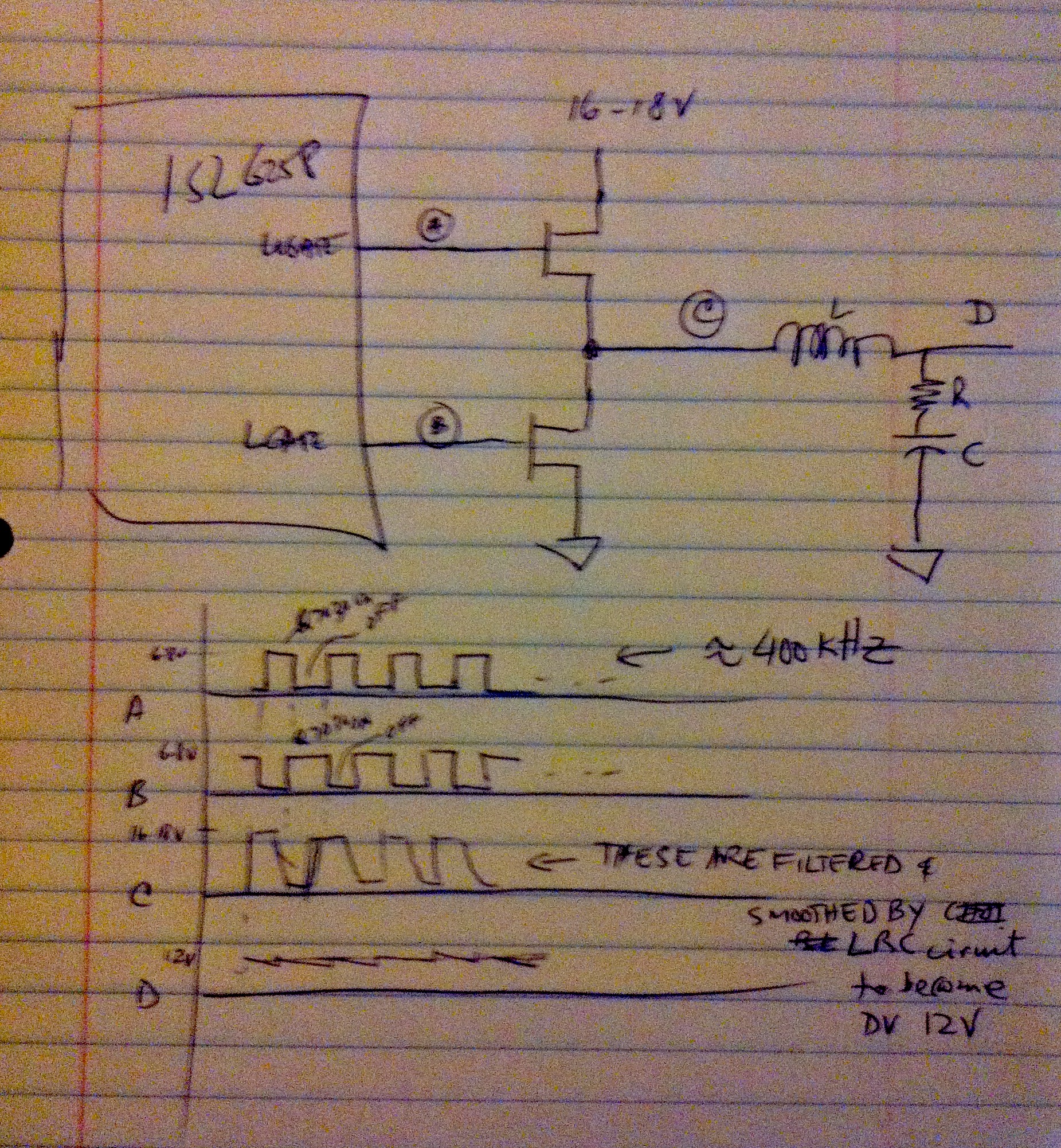

Thanks a lot for the detailed explanation! - My fault to saw these curcuit and the generation of the 12,5V to simple. I'm on the wrong path. I kind the regulation of the 12,5V PPBUS_G3H was regulated by the Voltage at the Gate of the FET's.
