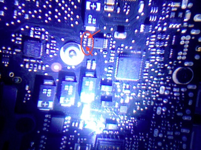

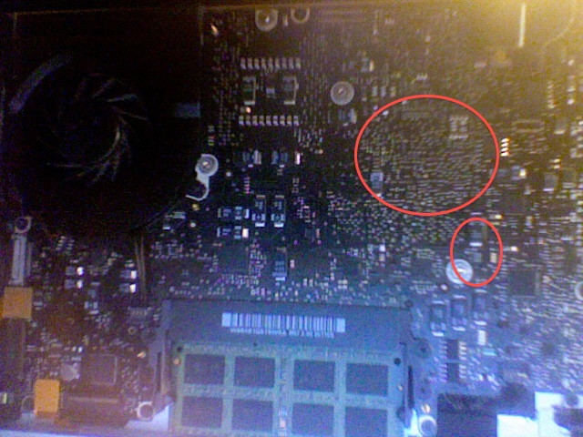

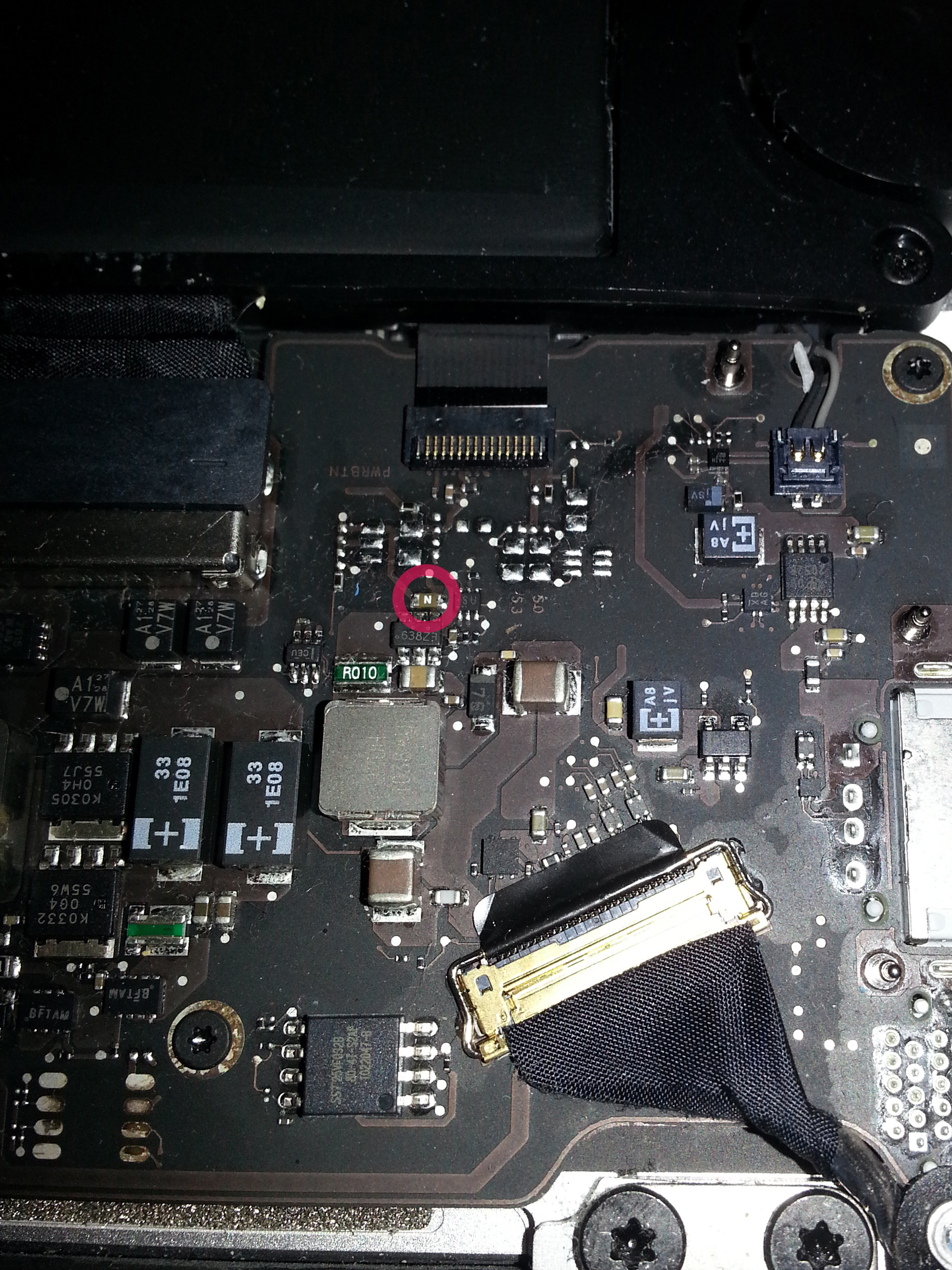

a1278 Non pro Macbook broke off components identification
Anyone have spare board might could measure these broke off resistors and capacitors or point me to page on schematic to find? Thankx
The laptop shows classic signs of nvidia gpu fault im not even shure if these components would stop from booting I shall reflow and return
i'm afraid the 13" is not known to have faulty GPUs. Doesn't mean it is impossible. I do have a 13" MBP (2009) here, which also shows symptoms like power on black screen, and sleepwake blackscreen. but it will run without a problem once booted.
Im also with you on that 2008 model nvidia I would thinkl still have this problem check this thread https://forums.macrumors.com/threads/1268755/ if anything the reflow should help other joints

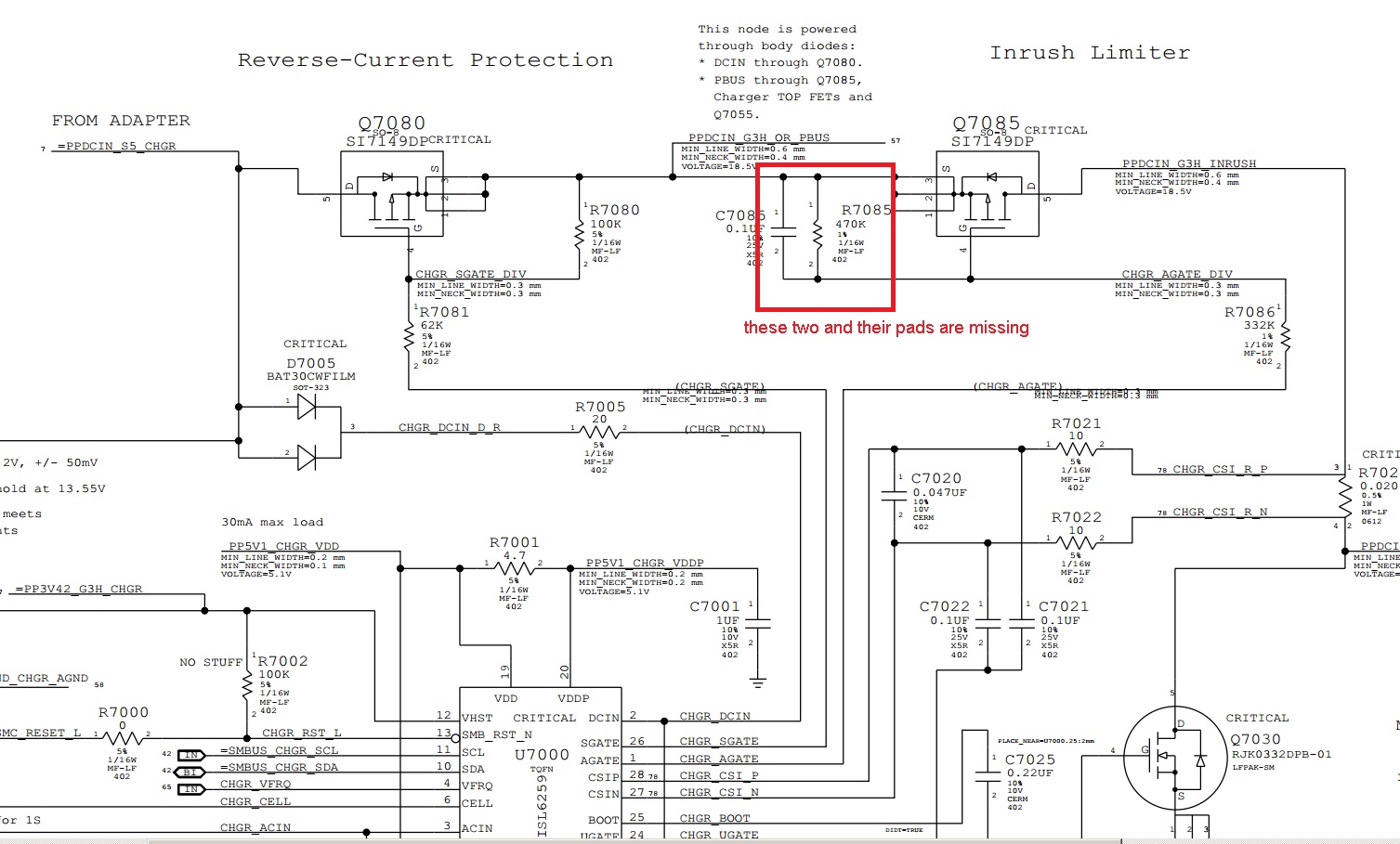

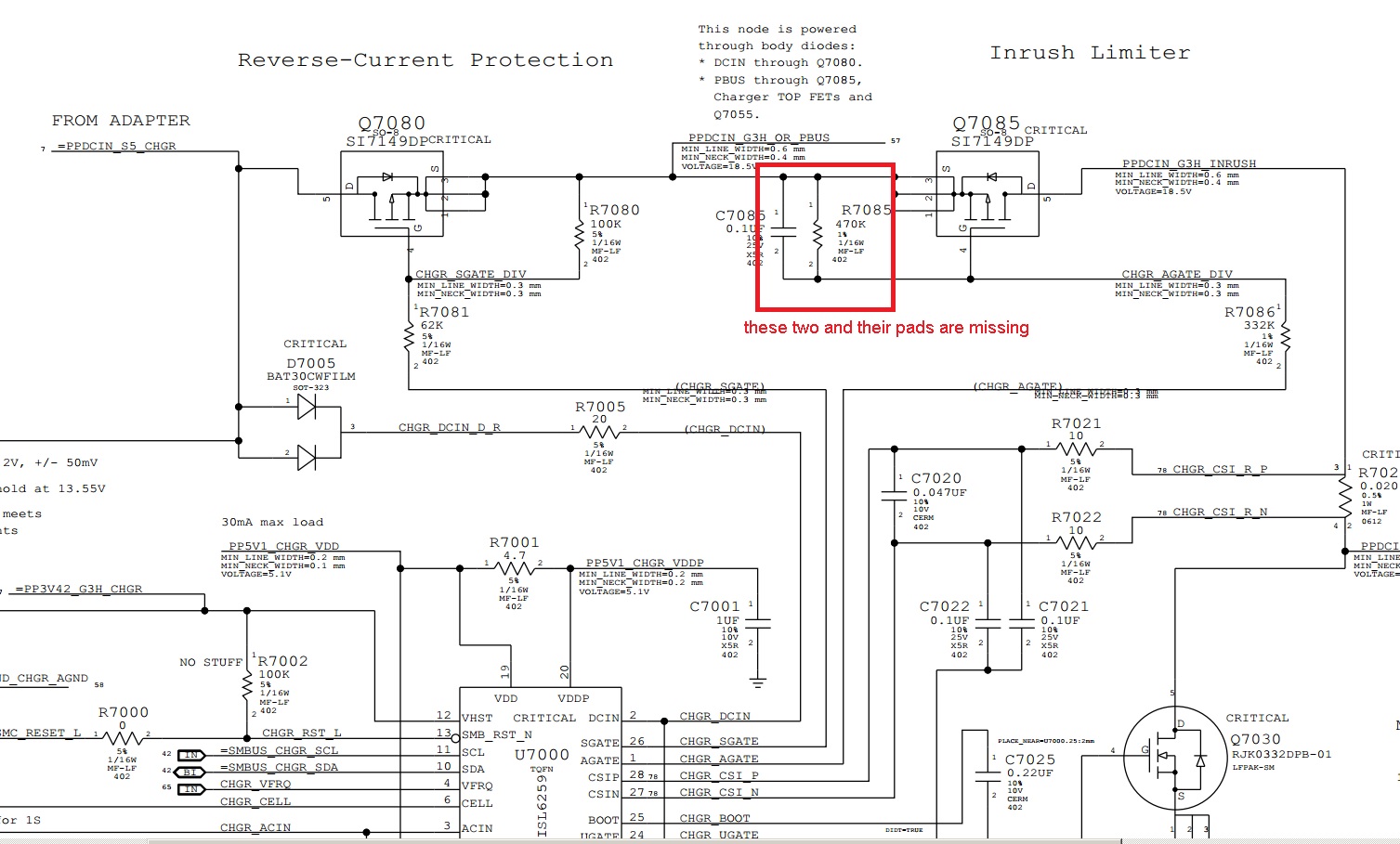

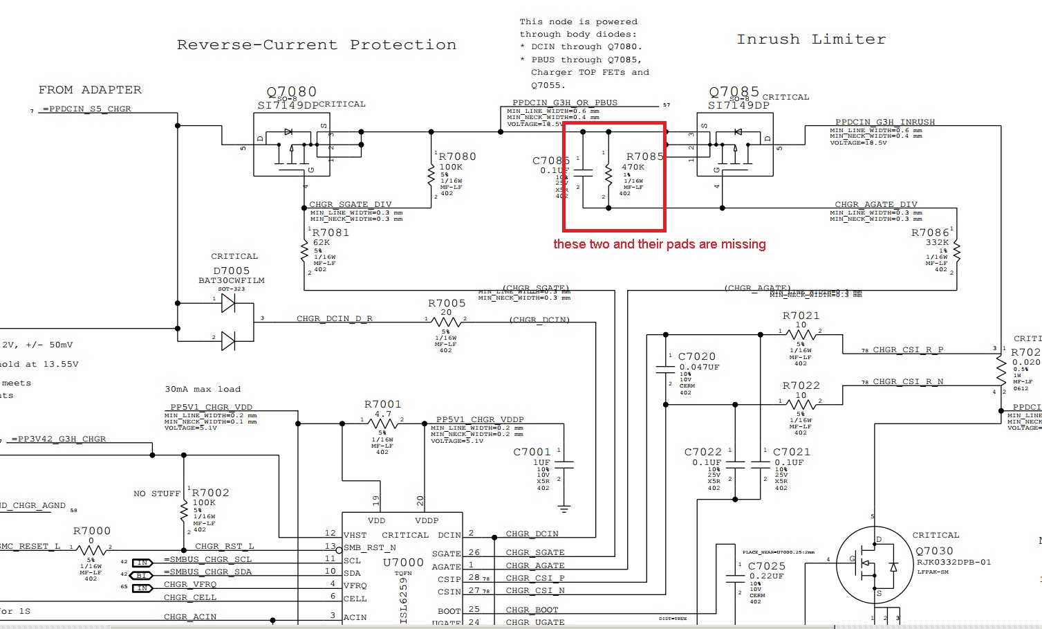

Enter the world's most annoying 820-2879. Very close to throwing this into a blender.
It works, but Q7085, SI7149DP runs BOILING hot. I replaced it, same nonsense.
I saw C7085 and R7085 are missing. The pads are missing, the component is missing, the traces going to the pads are missing. It's almost as if a comet landed on the board and little street cleaning robots cleaned up all remnants of it. Without looking at another 820-2879, I would have never seen this. There is no discoloration, no rip, no liquid remnants.
I get a 470k resistor and a 0.1 uF capacitor, and cortical coat them to what would be their original locations. Using some fine wire, one end of each goes to the source of Q7085, the other end of each goes to R7086. Since the pad & traces that connect R7086 to pin 4 of Q7085 are gone, I run a wire to make this connection as well.
At this point the board is back to the setup it had before it was beaten to a bloody pulp in its last life. Beautiful! It turns on, and Q7085 runs nice and cool. Alas, it's slow as hell. Really, badly, terribly slow.
I take the wire off of R7086 to go back to where I was. Nothing. Magsafe lights up but it wont turn the thing on. It'll even charge the battery – the magsafe adapter color will be green or orange, depending. However, it won't turn the computer on. Oy. Did I really make this worse by removing it? I try a battery on it, and now it works. It won't function unless the battery is plugged in.
I've solved no charging, I've solved not running off the battery, I've solved the machine not seeing the magsafe, and I've solved runs slow off battery/runs fast on AC adapter. This is just god damn confusing. The board has the ability to turn on and function with a power source. It has the ability to get power from the DC adapter to the battery... but it can't run off the DC adapter. This is driving me nuts. I know I am missing something silly and AC, as I usually am at 3 AM. If I figure something out, I'll post description and pictures.

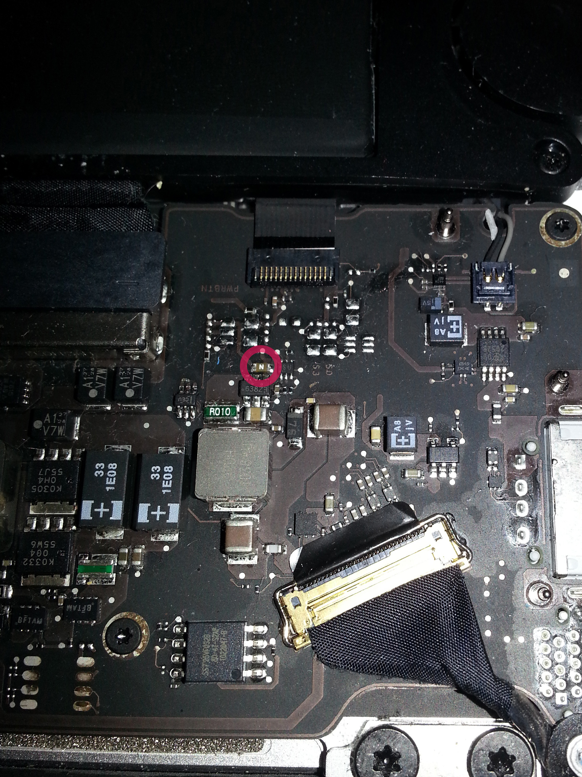

I bought the fuse in the link below for my mba A1370, it is about half the size of the one which I believe I should be replacing for my back light (see image). is this okay or have I bought the wrong fuse?
http://www.ebay.co.uk/itm/181091645524?ssPageName=STRK:MEWNX:IT&_trksid=p3984.m1497.l2649
Thanks a million
Yes. Looks like you bought an 0402 fuse which is what the 2008-2010 Macbook 13" used. However, the fuse in your photo looks like it is an 0603 or possibly an 0805 (but pretty sure it is 0603... check the schematic). If you can get the solder to bridge out far enough to the board pads then it would work. But otherwise order yourself an 0603 fuse.
edit: checked the schematic for a 2010 MBA and it is a 2A 0603 package. Should be the same for 2011.
