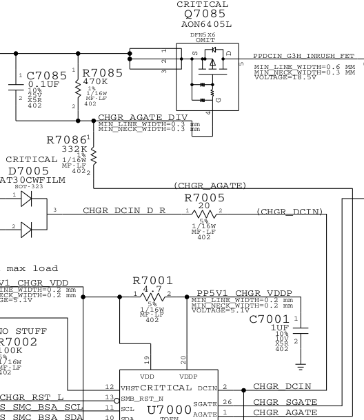

@cmdrdata
A while ago you mentioned a block diagram of U7000. Do you by chance know
which page in this thread it is located? I couldn't find it.

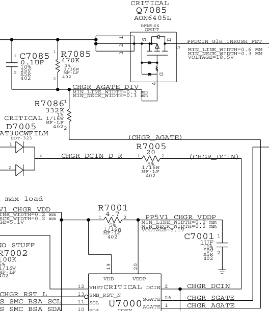

I'm currently facing the problem that the right side of R7086 on a k90i is
~15.5V instead of ~0V but CHGR_AGATE is at 0V. It might just be that pin 1
of U7000 is not soldered on correctly but I thought understanding the logic
could be beneficial.
My current understanding is that CHGR_AGATE will pull to zero when everything
is alright (U7000 has 5V at PP5V1_CHGR_VDD and reports SMC_BC_ACOK). Is that correct?

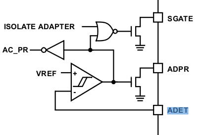

Attached is a pdf file for ISL9518. This is listed as an 'alternative" to ISL6258aka U7000 by Intersil, but it is NOT an exact replacement. ISL6258 is limited by Apple to persons they approve. If you can read and understand the concept of ISL9518, you should be able to see that ISL6258 is very similar to it, even some of the pinouts have the same name and functionality.
I am little bit confused where the d6905 is...
Beside the dc in connector is the main fuse, beside that is a component with eight legs, four and four. Nearest legs to the fuse are tied together.
I get continuity between the fuse, a resistor that is right next to fus and this component I mentioned (the four legs tied together) so they are tied together?
I have 16,5 volts on the fuse and on that component, measured from every leg.
The other component I think might be the d6905 is also near the dc in connector, but it is near the side of the logic board, two legs near the connector and three legs on the opposite side. I get 3,4v on the other of the two legs and 0v on the three.
I have this cheap magsafe and it gives 16,5 volts even if the dc in board is not connected to the logic board.
Is there a picture from logic board with components named?

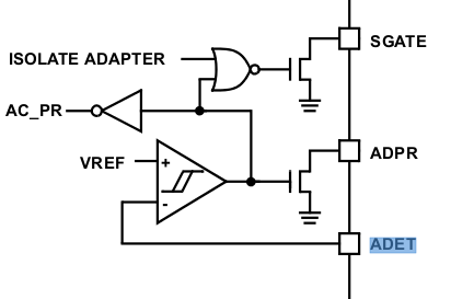

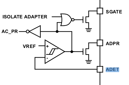

Ah, thank you. As far as I can tell SGATE corresponds to U7000's AGATE and ADET to CHGR_ACIN on U7000. If I understood the block diagram correctly, SGATE is pulled low in case SMC doesn't set the 'ISOLATE ADAPTER' bit and ACIN is greater than the reference voltage.
What I couldn't find is what corresponds to VREF in case of the U7000? Is it VDD-VDDP?
I also noticed that when measuring CHGR_AGATE to ground there is a period where I can measure 0V (good) followed by a period of time where I can measure 16V (bad). After that the smoothing caps (C7030, ...) carry the nominal voltage of ~12V. Is it just my meter bridging to ground or is U7000 switching pin 1 to ground periodically?
CHGR_AGATE is the signal that controls Q7000 (the first FET that allows magsafe power to flow through the charging system). This signal, if all is OK should be "low" or near 0 volt such that the junction voltage at the resistor divider R7098 and R7001 will generate a FET gate turn on voltage of around (62K/(100K+52K)) x 16.5v = 6v.
If the open collector FET inside the U7000-1 is off, then both resistors will float up to 16.5v when measured with a high impedance voltmeter.
Second function is that if battery is good and connected but magsafe is bad or not connected, it shuts of power to the charging circuit (all charging components after Q7000-5 by virtue of pin 1 NOT providing the correct voltage to turn Q7000-4 on.

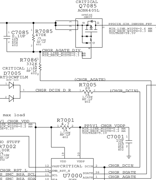

I'm trying to translate to the schematics of the k90i, please correct me if I'm wrong.
- Your Q7000 is my Q7085.
- R7098 and R7001 are R7085 and R7086 respectively
By pulling U7000-1 low, CHGR_AGATE_DIV will be low enough for Q7085 to activate.
The real question is, however, why this is not the case for me. As I said, judging from the (attached) block diagram of the similar loading chip the following logical expression determines whether U7000-1 is pulled to ground (again, please correct me if I'm wrong):
! (ISOLATE || (VREF > CHGR_ACIN))
This gives me the following options of what goes wrong:
1. SMC set ISOLATE_ADAPTER for some reason
2. SMC communication is broken and ISOLATE_ADAPTER could not be reset (assuming it is set by default)
3. U7000-1 is not soldered correctly
4. U7000 is broken
5. VREF > ACIN
While I can't completely rule out 4. I don't think this is the case as I get
~3.2V for SMC_BC_ACOK and 5V at U7000-VDD. The chip also doesn't get
hot or shows any signs of a defect. I think I can rule out 3 as I tested U7000-1 for continuity with ground, giving me the same result as with measuring from the board.
I'm not sure how I can test 5. as I don't know where U7000 gets its VREF from. Also I don't know how to test for ISOLATE_ADAPTER or the correctness of the SMBus lines. Any idea how to verify these?
EDIT: I should've mentioned that the carger LED (third party charger) is not green, not even dim green.

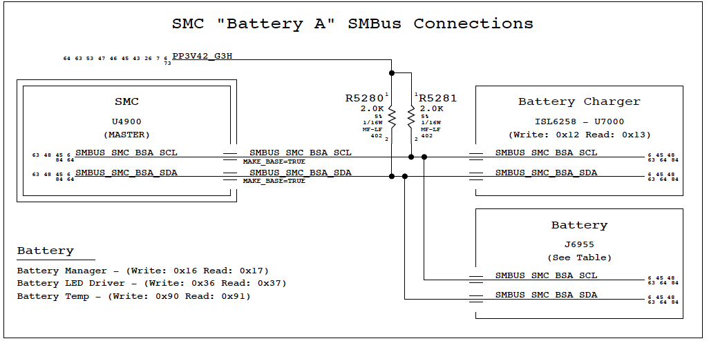

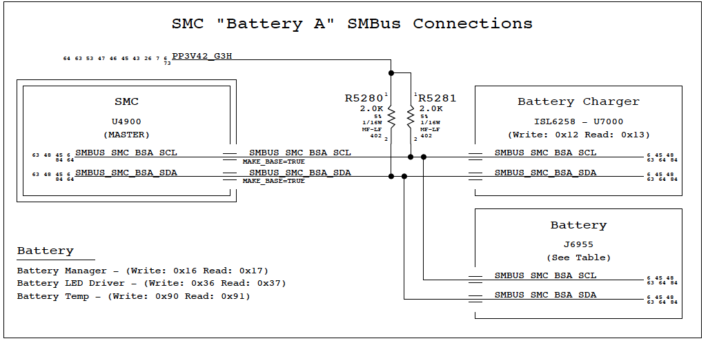

Could it be that the SMC does not sense the carger and, thus, disables U7000? SYS_ONEWIRE is at 3.4V.

I think your last statement is the clue. If SMC is not able to communicate with the adapter via pin3 of the magsafe or pin5 of the DCIN board to logic board connector (no green or yellow led), the SMC thinks there is no adapter, thus using the SMBus lines it sets the signal "isolate adapter" to prevent battery power to be wasted in powering the charger circuitry unnecessarily.
VREF is internally generated by the chip, about 3v nominal, I think sourced by battery power.

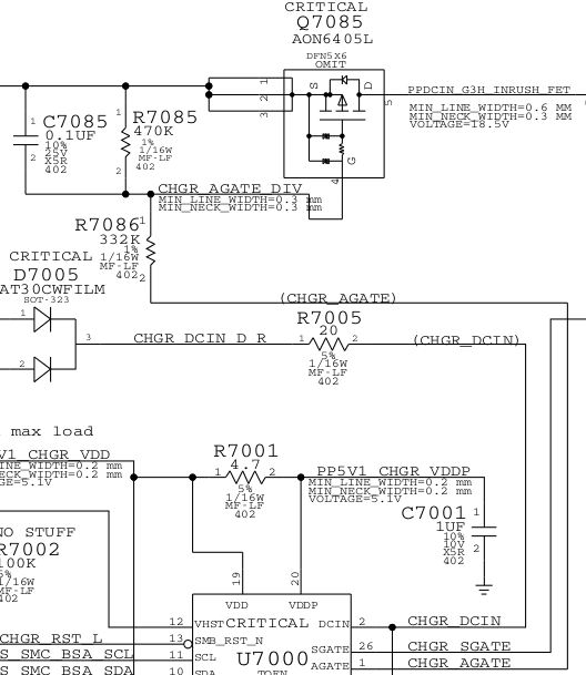

Well, as it turns out, U7000-1 was not connected properly. I measured on the chip, this time using a diode tester, and measured a drop of ~100mV. This indicates that U7000 indeed does pull pin 1 to ground. So after dragging a solder ball over the pins I get 16V at C7030.
While this is some progress, I'm still not getting a green light for the charger and only 3.4V at L7030 and F7040. IIRC this should be higher, shouldn't it? I suppose CHGR_UGATE is not working properly but I didn't take measurements so far.

The number of charge cycles for each Mac models is Apple's secret. I'd be interesting to know that myself. However, as shown in the attached picture, it seemed that the SMC communication addresses with a 2008 MacBook or later model MacBookPros have not changed. For example, when the SMC wants to write an update to the battery pack flash memory, it first sends an 8-bit serial address 0x16 (binary 0001 0110) to the BATT followed by another serial data value/code. This is how the battery charge count is incremented. If the SMC wants to know the charge cycle count, it sends a read address of 0x17 (0001 0111) and then waits for the battery to return a serial data transmission indicating count value. If the value is close to "end of life count", the SMC will show "Replace battery" message in the system report. If it doesn't get any serial data response at all, it will probably report "no battery". In models with BIL that are separate from the battery pack, the SMC is the one that turn on the LEDs to indicate battery charge level using address (0x36).
Negative current is the amount of amperage being used/sucked by the system from the power source at that time.
Thank you cmdrdata for information.
I ordered a good new battery. See what happens next.
