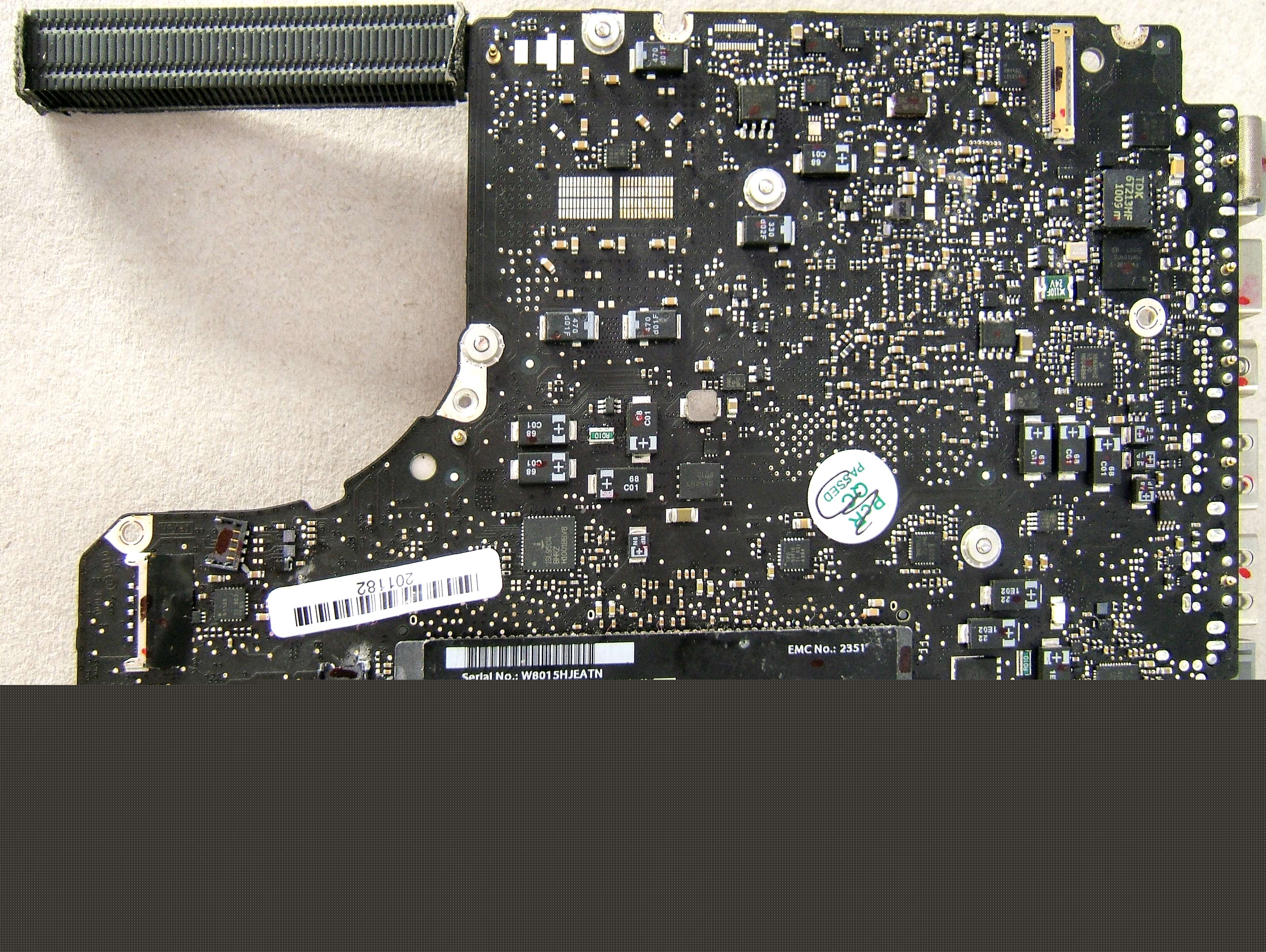

I have a problem with my bacbook a1278.
Problems encountered:
- Macsafe without connecting the battery the computer will not turn on but the light is green,
- Connecting a low battery, the computer does not turn on, the light is green,
- Connecting a charged battery turn on the computer regularly, green light, suddenly turns off after 2-3 minutes.
- The chip u7000 is very very hot.
here's the picture.
do you think replacing the chip u7000 (visibly damaged) I can solve my problem or the u7000 chip is damaged for other reasons?
I would not change the chip u7000 and the problem is another.
I ask for your help please
Hi vito1202,
That chip looks badly burnt, it will need replacing before you go any further. It certainly has been hot so it could be the cause of the board shutting down.
Regards,
Chigwelldave.

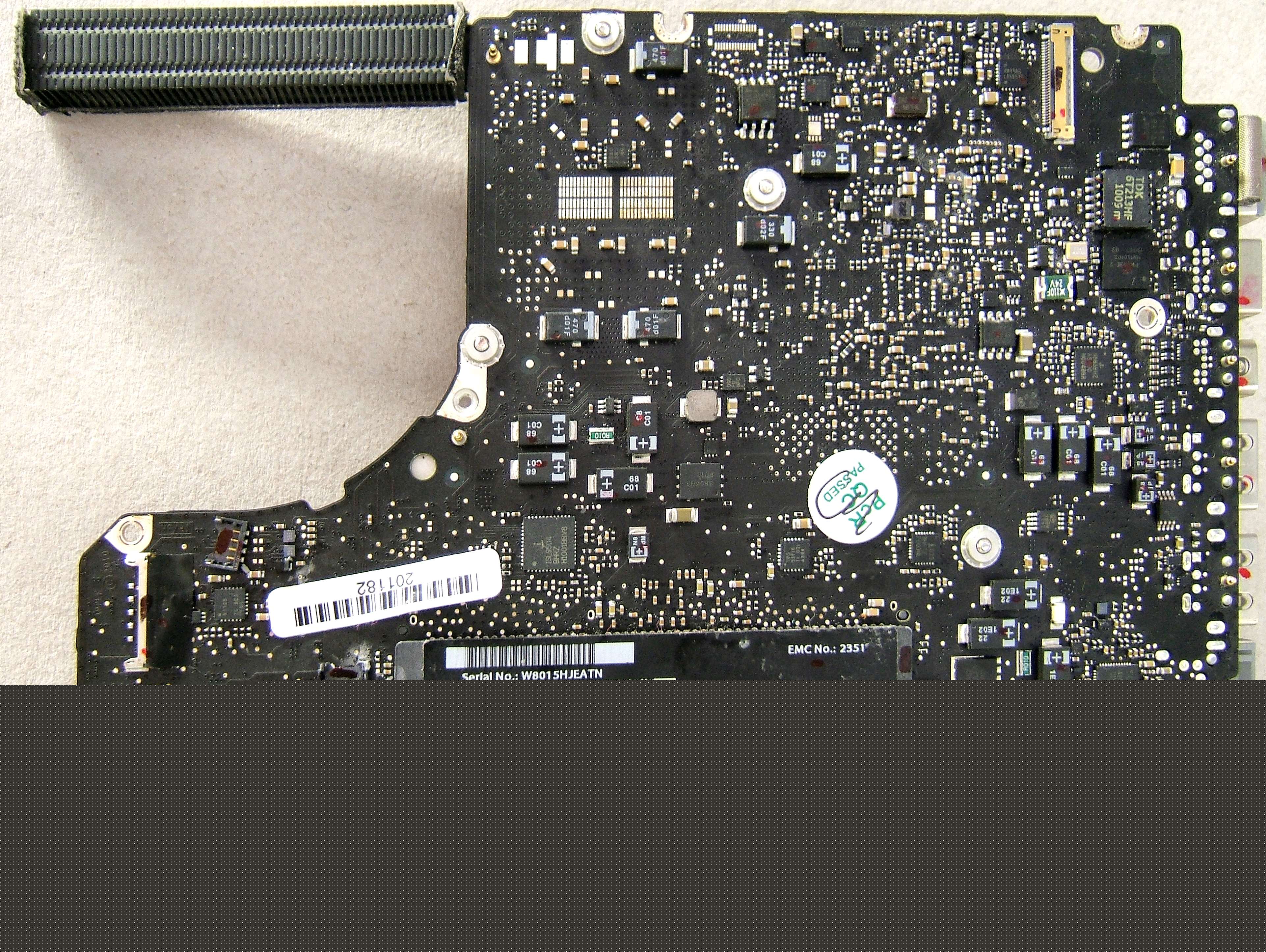

I bought a used A1278 2.66Mhz 2010 ,but after 40 days (30 days warranty) does not work anymore '.
All fuse ok
No LEDs light up on magsafe. (there are 16.8V on the fuse F6905 and 12.5 V on battery Fuse F7000 )
Reset .G3hot (short 2 pad near Keyboard connector) on brd (controlled voltage 1.7V)
Do not turn on the fan.
Can you help me?
I need to know where are 'diode D6905, u6990, etc. but I don’t have the device layout ( for the cpu side I have landrex file)
Hi.
What voltages are you getting on your U7000? Mine are here:
https://dl.dropboxusercontent.com/u/138757/U7000 15inch.PNG
And here is a what we should be getting on pin 4 and 6 of U7000.Taken from my working A1278:
https://dl.dropboxusercontent.com/u/138757/i2c.gif
I make test in the board, I put the multimeter in ohms and check pin 11 and 10 in u7000, pin11 to ground=3,3k and pin10 to ground=3,3k. In a good board the value of resistance are 290k more or less, I think that 2 lines are short to ground, when I remove U7000 and check again, and the result are the same, I remove R5280 and R5281, and the short disappear, I think PP3V42_G3H shorting to ground or internal short through U4900, is possible??
When I press the button to make test from battery, no light see any thing and when the computer it´s on, the OS says "NO BATTERY"
The rest of the functions of macbook work correctly
I check pin 4 and 6, the value is 3,46v in both pins
thank you for help me

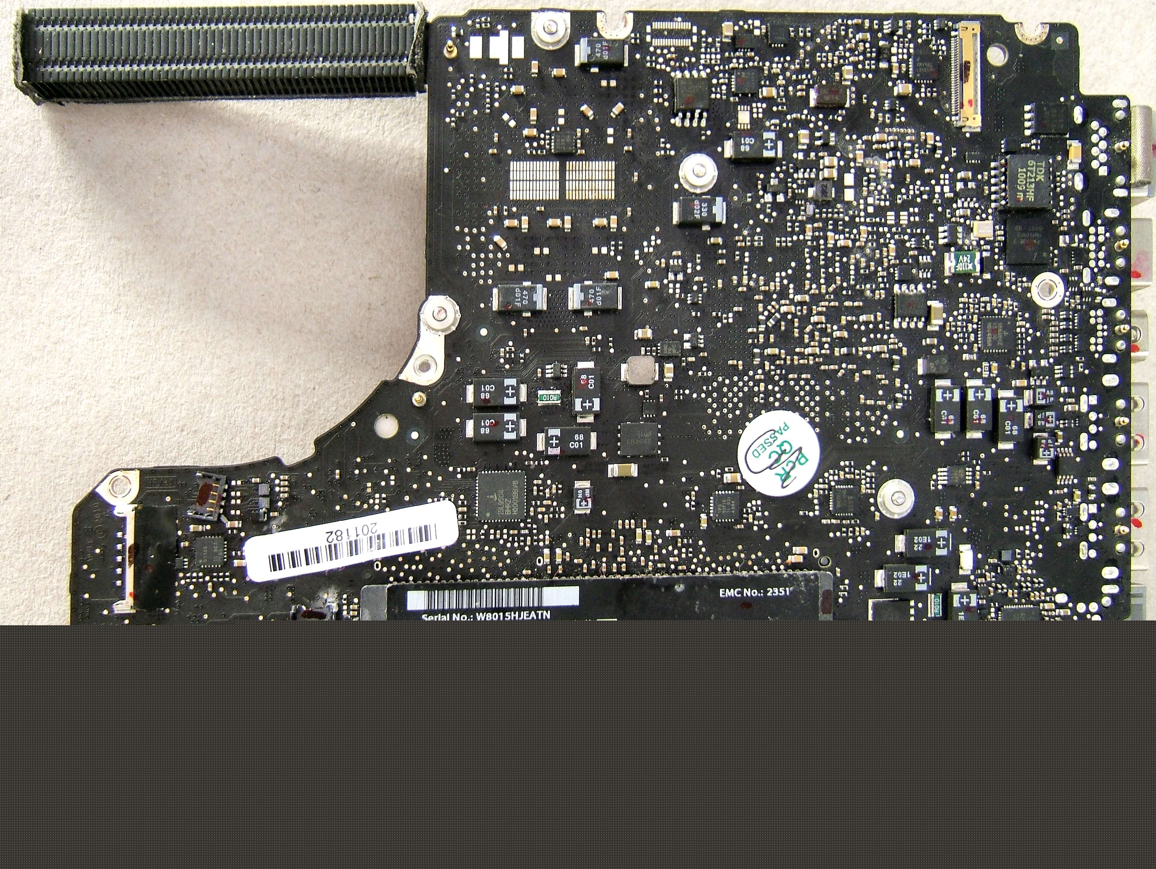

MBP 13 A1278 big problem
Hi to all! Sorry for my bad English.
After one month of reading all the post in this thread, i was able to fix a problem on my MBP A1278.
The problem was MBP turn on, but no charge.(Magsafe light was dim green)
The cause was no PP3V42_G3H on U6901, i retablished this and nothing happen, so after measure U6901 was not make his job; after replacement no light on the magsafe so I changed then R6929 and U6900.
And then all was ok.
The MBP has working 2 days.
And now the mac won't turn on after a sleeping mode. Have trying the smc bypass; keyboard bypass; g3hot bypass, nothing.
It's a K6 LB, I follow the power sequence and I don't have VIN in U7600 it stay on the Drain of Q7620 (12,46V) and don't have VIN in U7300 voltage stay on the Drain of Q9806 (12,46V). I have a doubt on the U7840 all the voltages seems correct but i have nothing for P3V3S5_EN_L.
It gives more idea in two brains that in one, thank you for your help.
