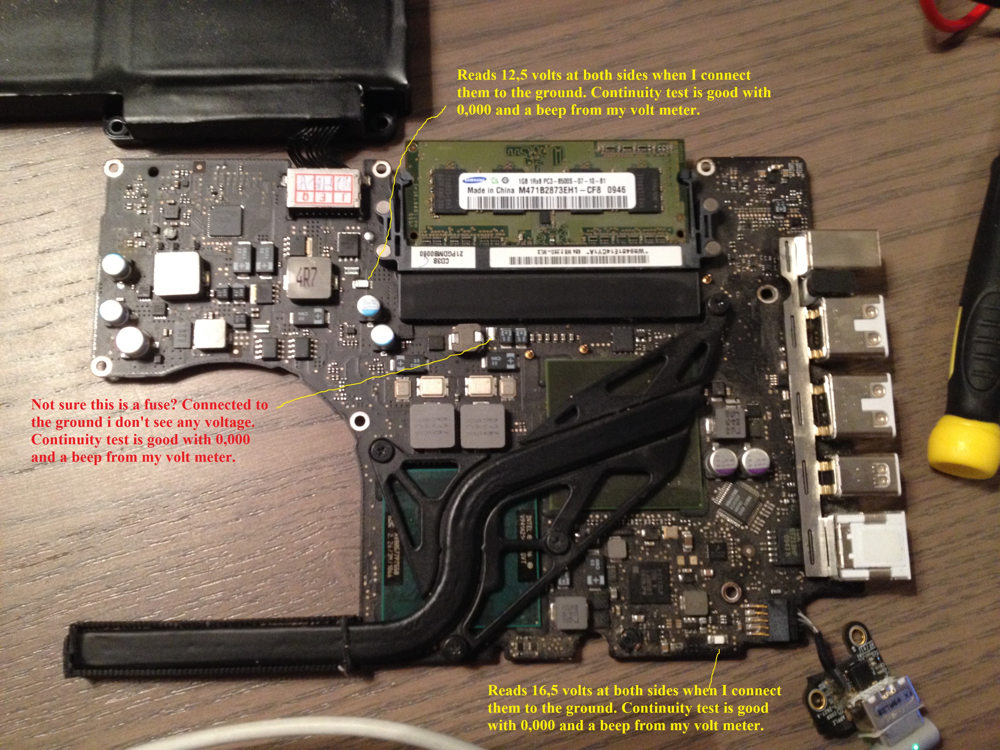

I've done some measuring as you can see in my picture with a original good working magsafe attached. Both fuses (or 3? the one near the memory slot?) have continuity and the 2 at the battery and magsafe location measure 12,5 volts and 16,5. Is the third white one also a fuse?

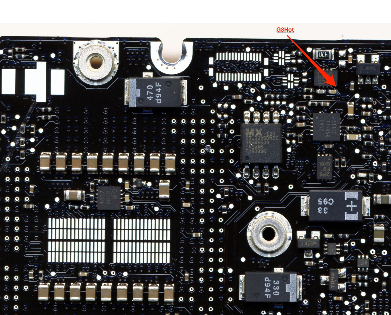

If I measure G3HOT at the reverse side next to the keyboard connector I get something like the 3,4 volts it is supposed to be.
Any tips on what i can do next? 🙂
Smc reset/bypass did not work btw.

Are you sure the battery is totally charged?, because when you put the magsafe and the battery is no charge the led is orange not green, often U7000 cause the macbook not power on, and the battery no charge
I measured again some voltages and noticed something. Sometimes, when magsafe is connected, voltages in the battery connector pins 7,8 and 9 are 0,5voltages (about). Then I connected magsafe again, and now there is pulsating voltage. It goes from 4volts to 9volts. My multimeter shows it like it is changing every half seconds. Like 4volts, 7v, 4,5v ,8v, 5,1v , 8,7v , 5,8v , 9v.... And then starts again from 4volts. Is it charging a little? Should the voltage be steady 12 volts?
My battery has a voltage of 12,5 volts, that seems to me to be the correct voltage for a charged battery. I did my best to find the U7000 chip you mentioned. I could not find anything with a writing similar to U7000 or ISL6259.

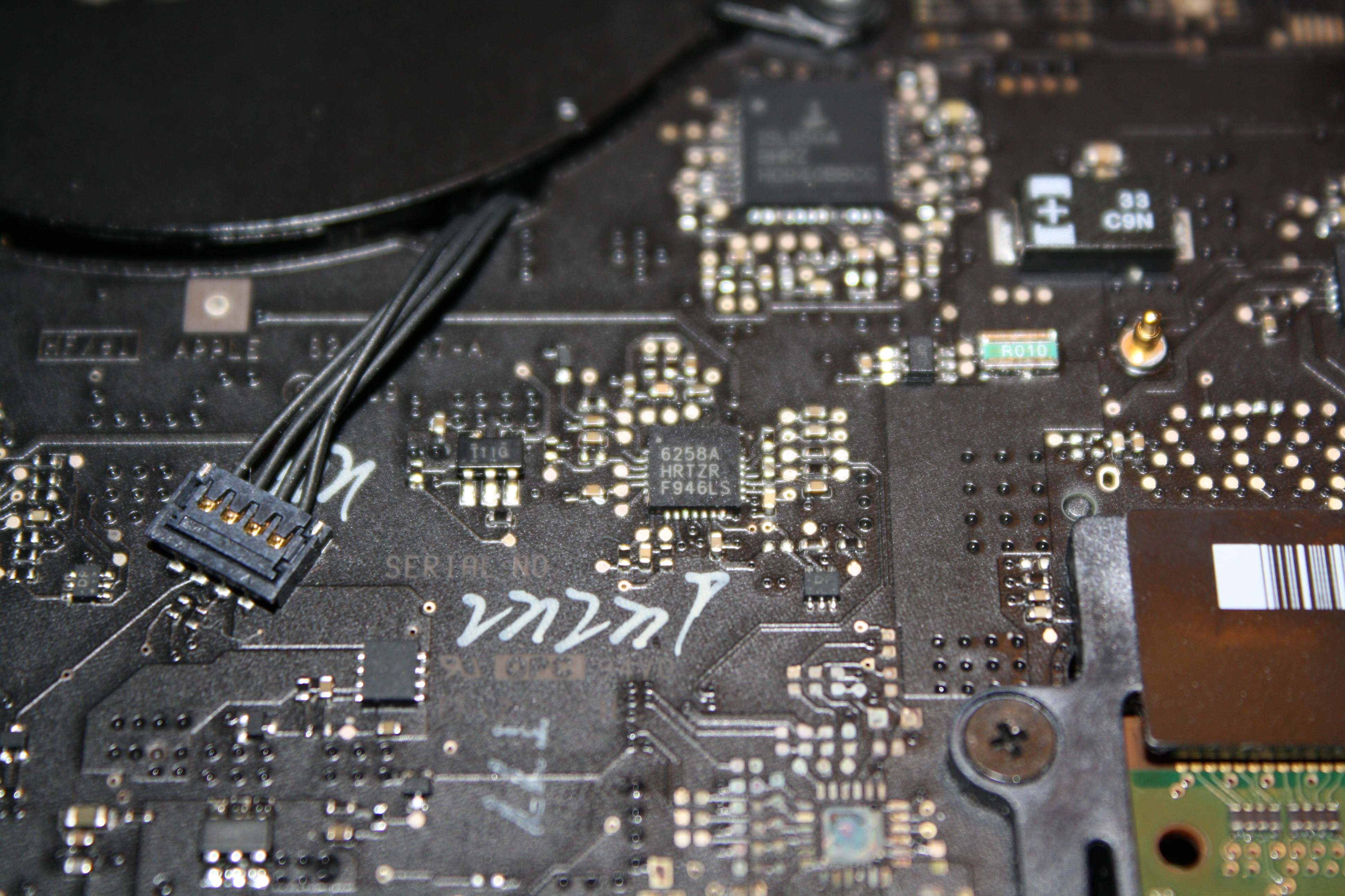

I did find the chip 6268A (In the center of my picture), is that the chip you mean?
yes, this chip is for charge the battery, it is the same chip but apple use ISL6258 in older MacBooks, it is not easy to change because when you buy new one the chip has not got solder paste. I repaired a lot of logicboards with this fault, if use a not original charger, sometimes cause faulty this chip and battery.
remove the battery and if you have 12,5v when you put magsafe, I think this chip is OK, so you check all the voltaje with the multimeter

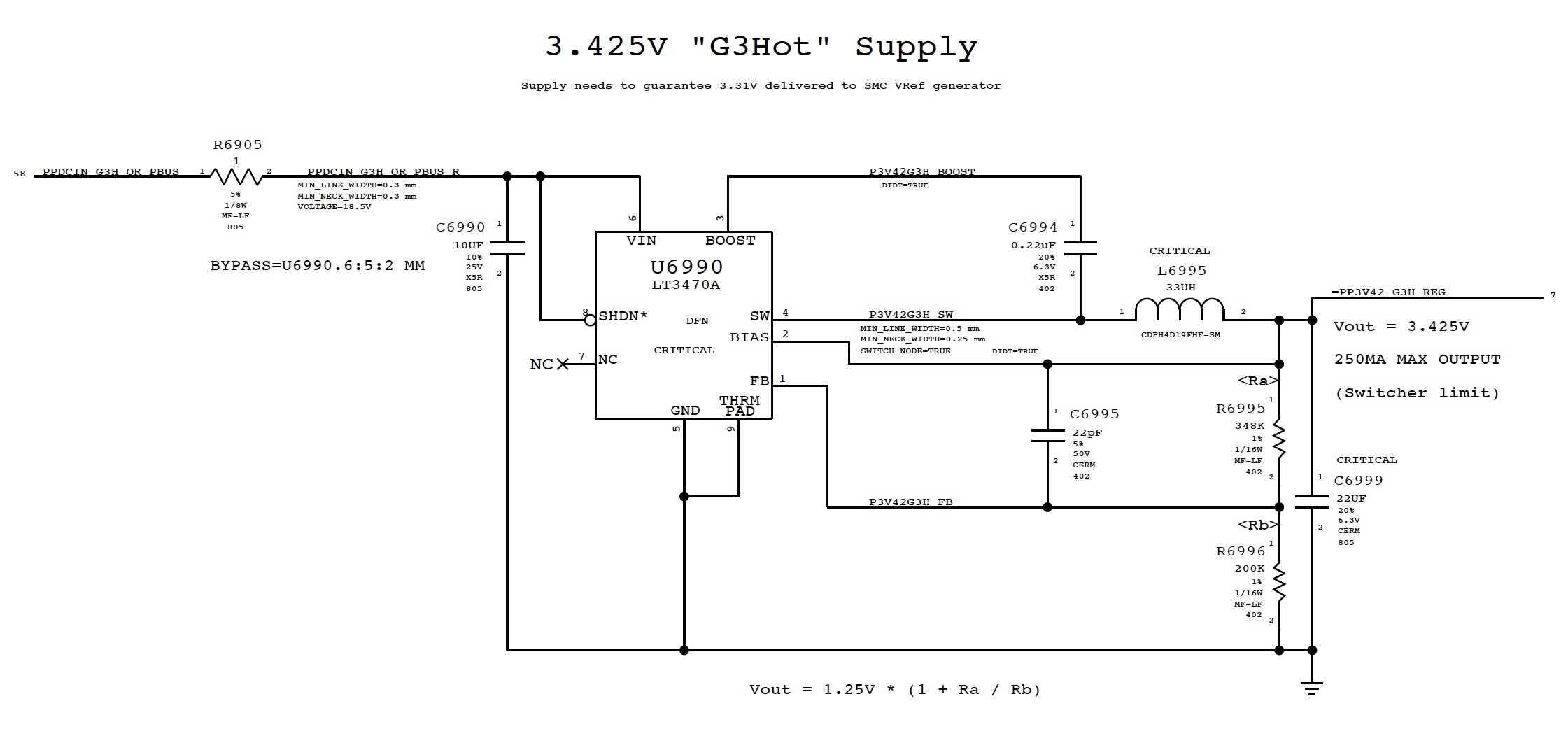

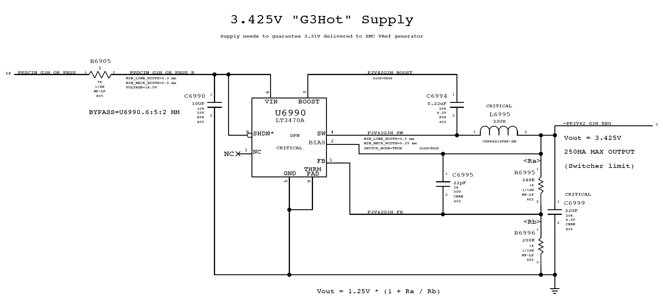

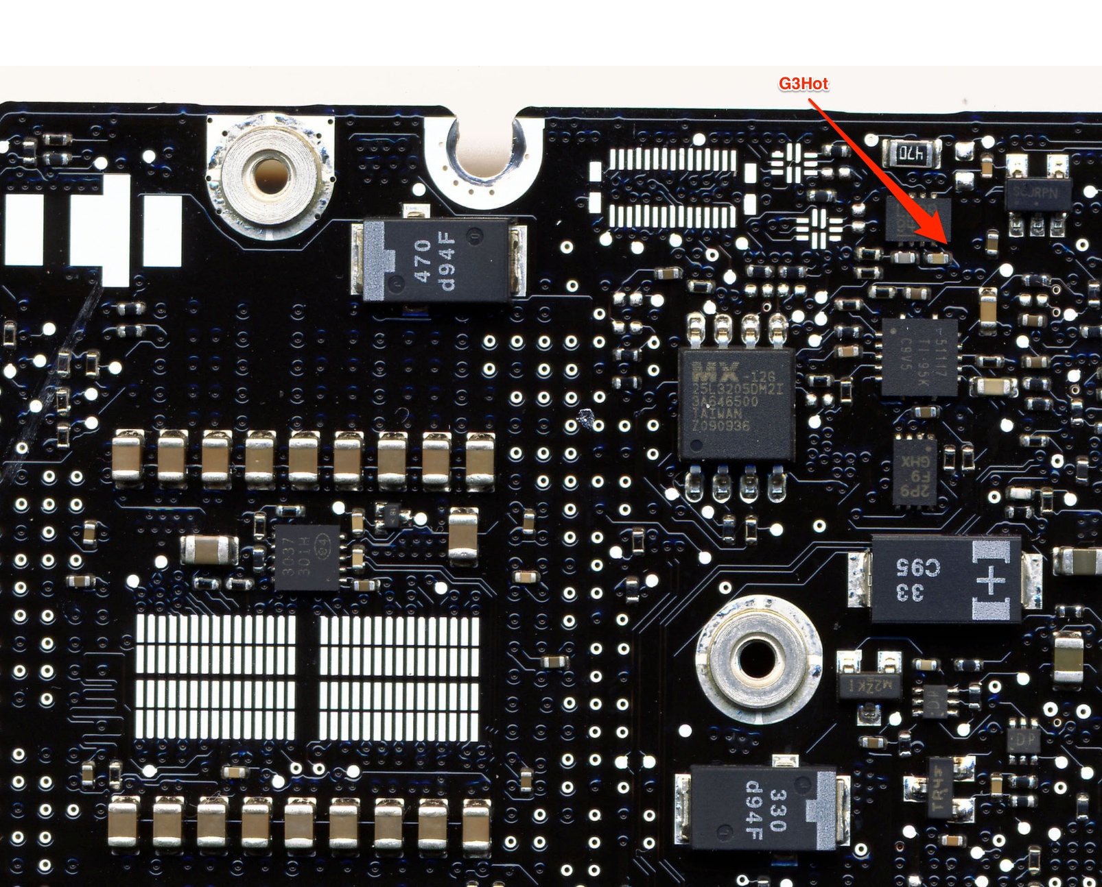

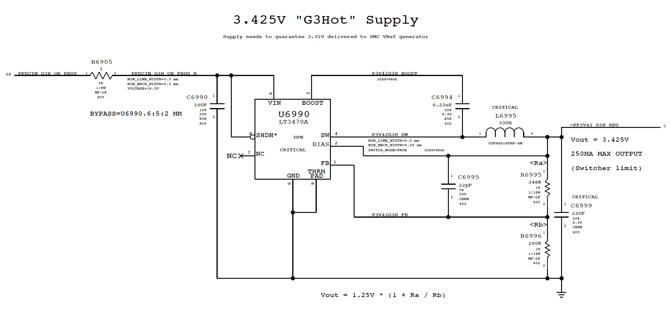

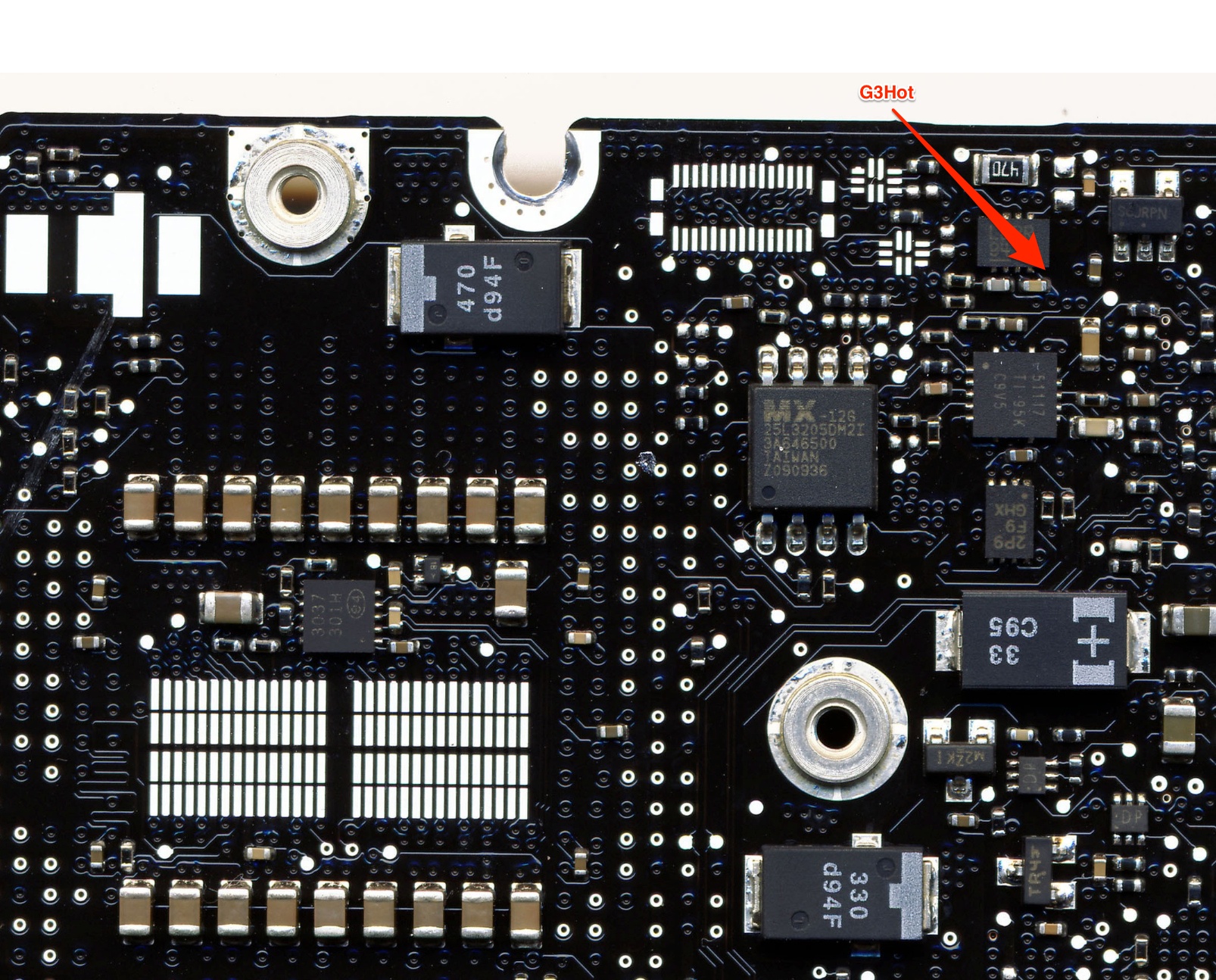

One of the power pads should be 3.4V. If not, then your G3Hot supply is dead and absolutely nothing will work.
The circuit diagram is attached. You will need to start by determining if pin 6 has 18V when Magsafe plugged in.
You didn't say which model of MBP so, assuming a 13" I also attached a photo of the device location from a 2009 MBP13". The 2010 MBP13" is in the same spot.

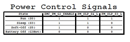

That indicates sleep mode. Try unplugging the battery indicator light cable and see what happens.

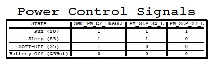

Not sure what you mean by "T29" power circuits but the system bus is 12V. The 18V coming from the magsafe goes to the ISL6258 (or 6259) charger chip which generates the 12V needed to charge the battery and run the system. The 12V then generates the other system voltages (3.3V, 5V, 1.5V, CPU, GPU, etc...). If the charge circuit is bad, "sometimes" you can get things to work with just a live battery and SMC bypass.
You mention 5V specifically. On a MBP13" that is on the top side near the wifi connector. It is a dual 3.3V / 5V supply. 3.3V should be present in S5 state. (System progresses from S5 to S3 to S0 power states). 5V comes on at S3. See power state diagram attached.

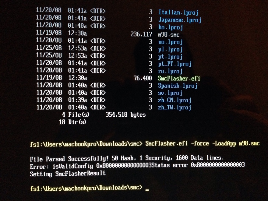

I have replaced the SMC chip on a Macbook Pro 15" late 2008 with an SMC chip i bought off eBay. The old chip had the latest SMC firmware which is: 1.33f8
The problem is: The new chip i have installed onto the logic board appears to have a Macbook Pro 13" 2010 SMC firmware (version 1.62f6)
Installing the chip has fixed the computer but because of the 13" SMC firmware on the 15" logic board, the left fan only works but at full speed. So i thought ok, i'll just flash over my new SMC with 1.33f8. Obviously because of the version number it is seeing it to be newer than the last Macbook pro 15" late 2008 and not allowing it to flash.
I looked up ways of trying to get around this and grabbed a copy of rEFIt that i burned to CD. I booted the CD, and went to shell. I got the following error in the image attached after trying to update the SMC. Any help would be highly appreciated, as i don't fancy the idea of having to re-ball the old chip 😱

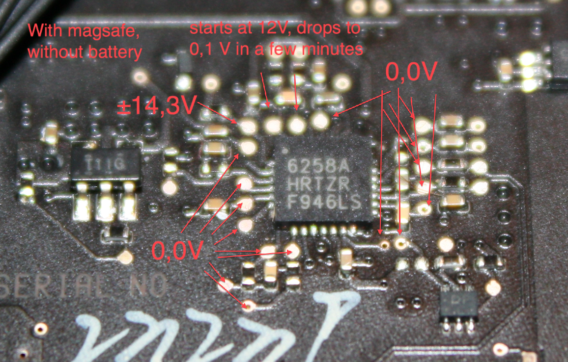

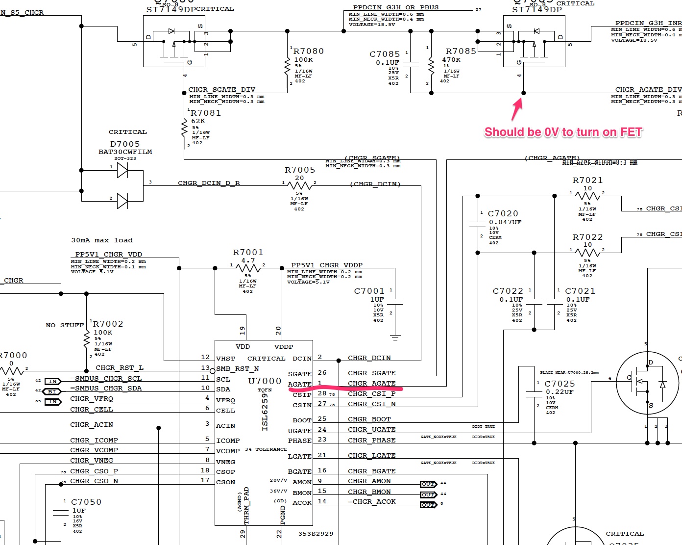

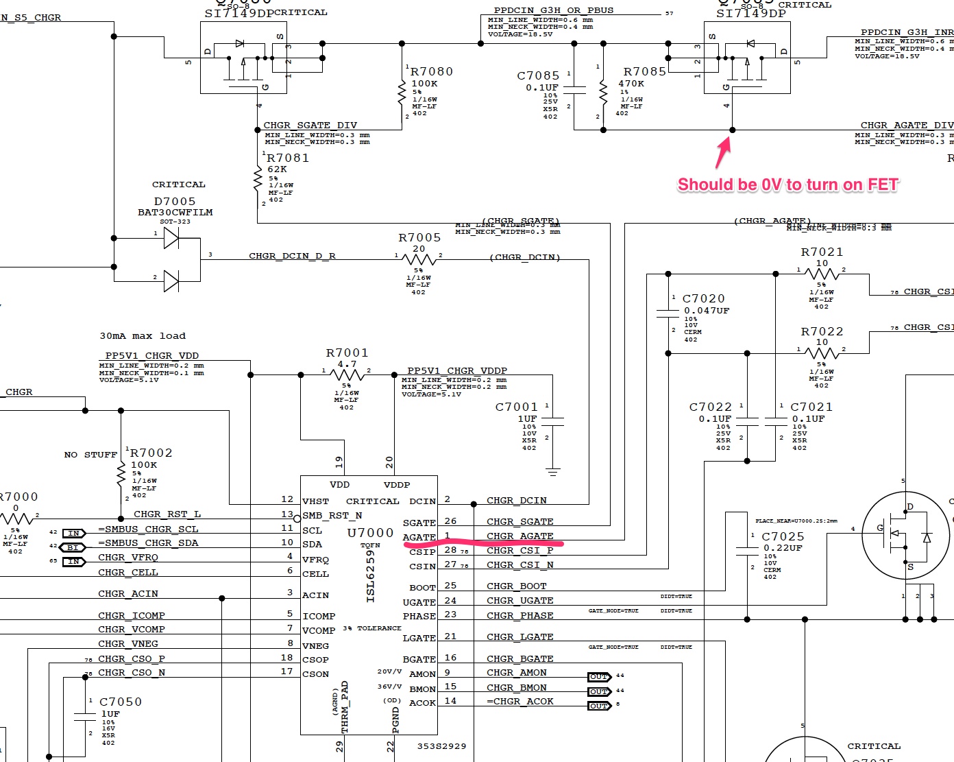

In my image i've written what i have measured. With the magsafe (but without the battery) I don't get any 12,5V. 1 leg at around 14,3V/14,4V and the next 2 legs start at 12V but drop gradually in a few minutes to 0,1V.
Seems to me this is not right? Thanks for your help so far. 🙂

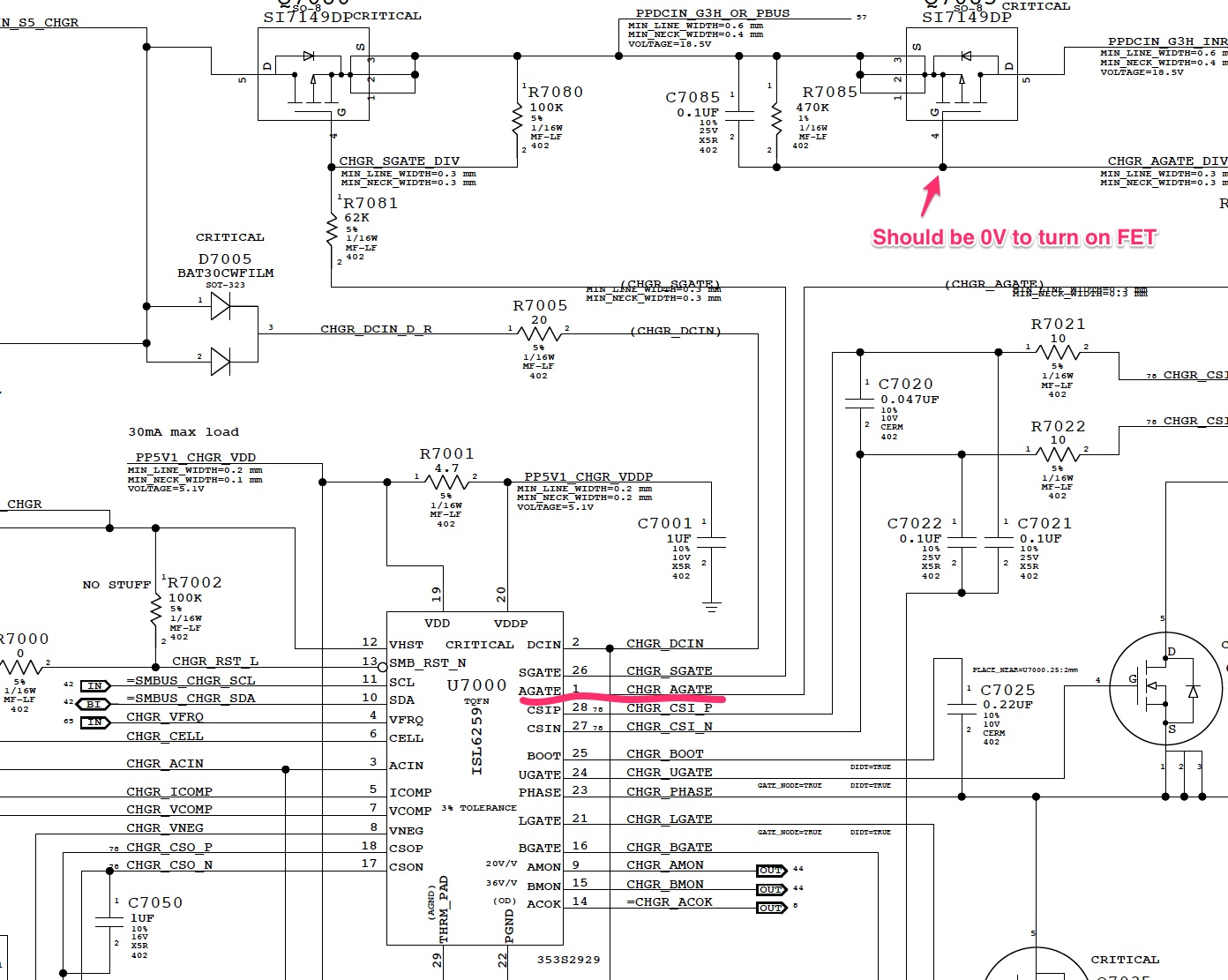

Pin 1 (upper left pin by the DOT on the package) must be Zero Volts to allow the FET to turn on. See attached. This is controlled by the charger. Since it is not pulling it low then there is something else wrong in the circuit.
Edit: And pin 2 is the 18V from the charger. It is Zero Volts so check upstream from there.
Ok, I think U7000 is dead. But you make more test to safe this chip is KO. please check with the mutimeter in Ohms. Put a probe in pin 11 of u7000 to GND, and check the value, then put a probe in pin 10 to GND and check again. If does inferior or 230kohms the problem is in the SMC chip, this two lines use for communication with the battery. Make a one simply test, push the button too test the battery, if the 5 leds no turn on, the SMC chip is dead.
I think with your values you have in your logicboard, the U7000 is totally dead.
PD: this values are for A1278 M97 logic board, but it have the same chip,
without battery only magsafe
Pin1-0V
Pin3-4v
Pin5-1,45v
Pin7-1,2v
Pin18-12,6v
Pin17-12.6v
Pin21-0,62v
Pin23-12,6v
Pin24-13,75v
Pin28-16,7v
Hi,
thanks a lot for your quick response. I will try that once I'm back in the office. I have no multimeter at home.
