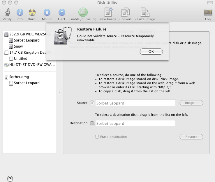

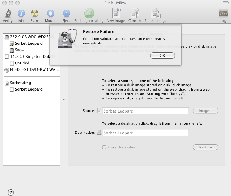

And if I try opening dmg in DU and using mounted image as source, then I get this error:
I give up, this just does not work.
I don’t think I’ve gotten the restore function to work in DU in probably 10 years.
I think it might work if you try restoring to something of the exact same size as the image.
These days if I can’t use CCC, I’ll use clonezilla.

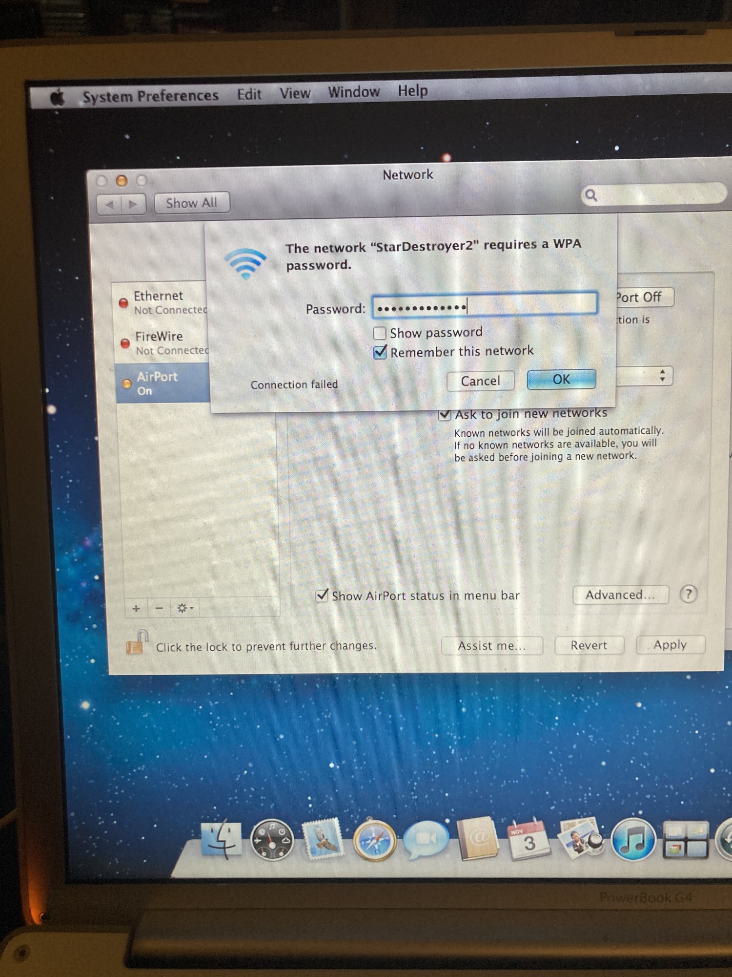

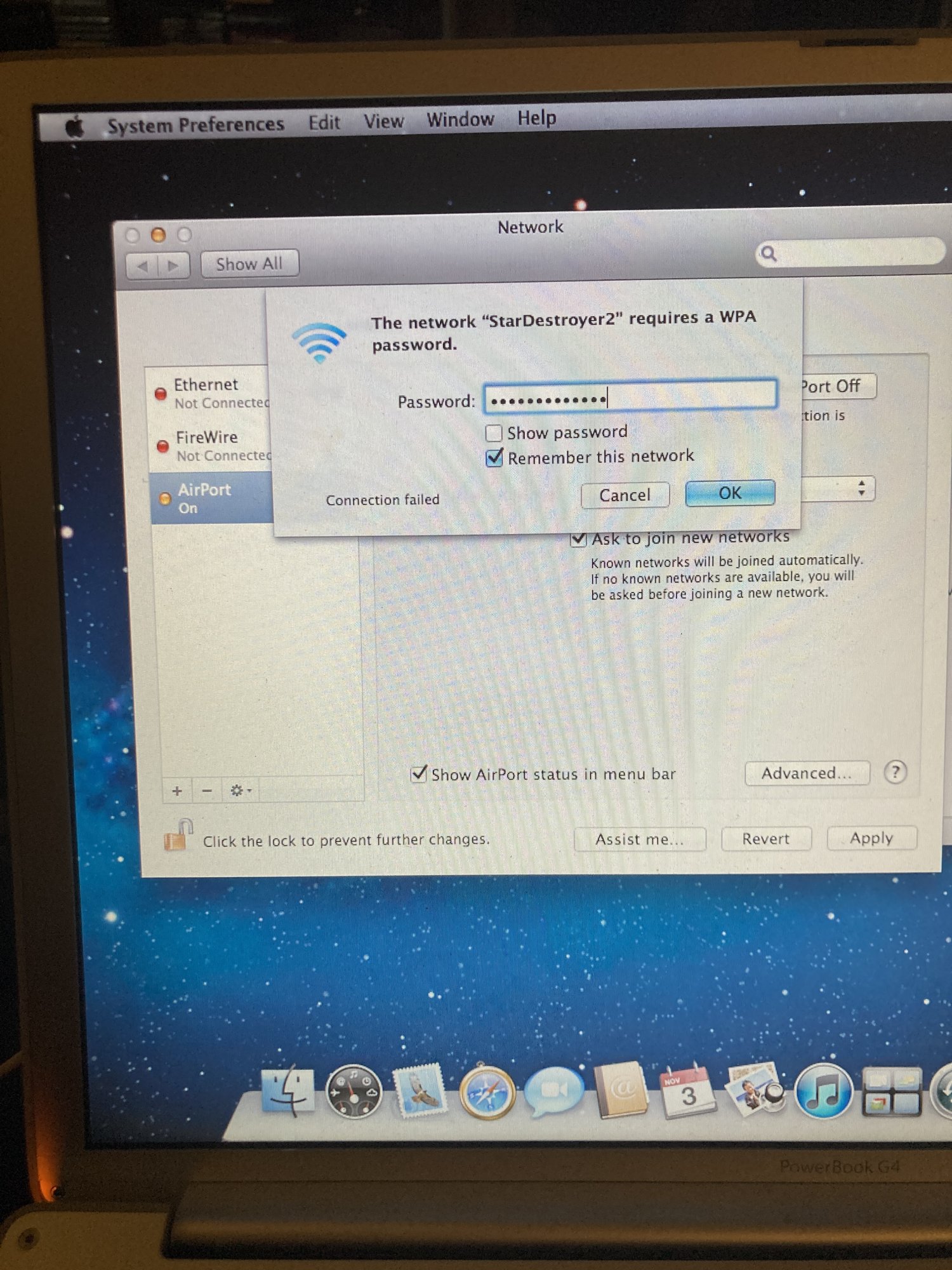

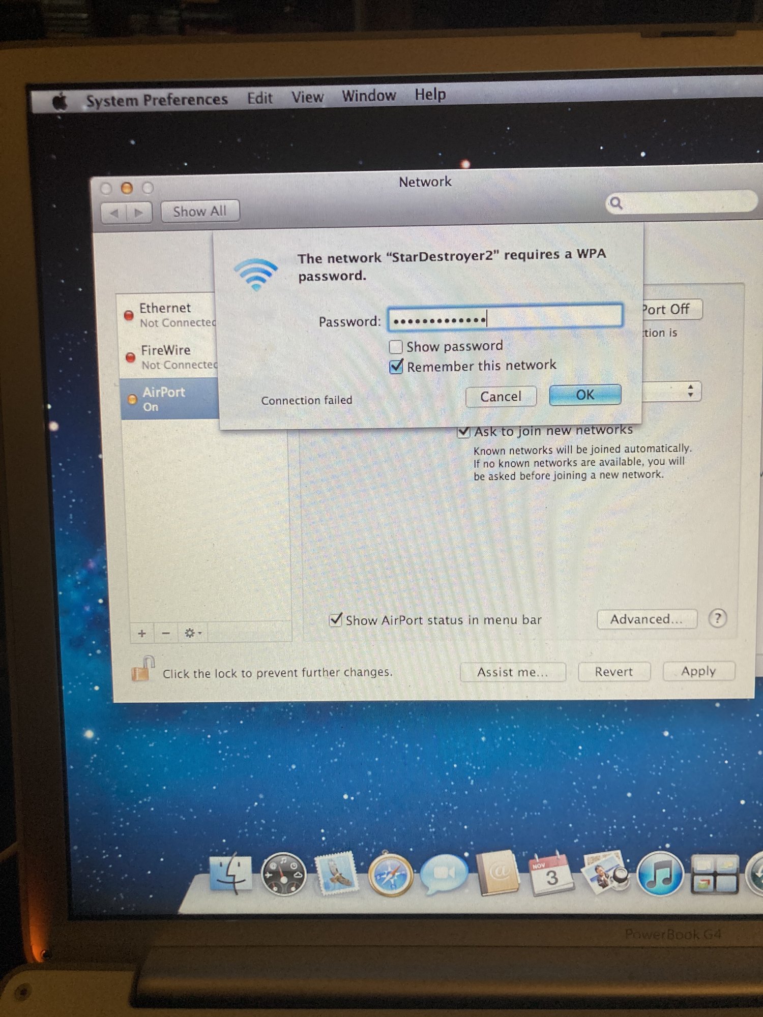

I am unable to connect to my wireless network on Sorbet.
It says connection failed, no matter how times I try. I verified the password is correct.

I realise that you’ve also tried disk utility under 10.5.8, so it’s probably an issue with the .dmg, however i thought i’d just make you aware that the 10A190 (Not 10A109 btw) version of disk utility shouldn’t be used as it still needs to be fixed and doesn’t function correctly. If CCC doesn’t work perhaps try SuperDuper, though if you’ve already attempted using the command line via Terminal without success then you’re probably better off waiting for another update, as i’m doing, before attempting to install @z970’s tweaked version of 10.5.8.
Yeah, my initial though was 10.6 DU is problematic, however dmg failed to be scanned for restore in clean 10.5.8 (in fact it failed to be scanned even on Big Sur, I tried that too).
I even tried unzipping the dmg on Quad itself instead of copying unzipped dmg from Intel Mac (Quad has slow internet connection, so I download huge stuff on laptop), and, as expected, with the same result.
Theoretically I can use CCC on other machine, connecting Quad in target mode, but it is unnecessarily painful. There must be a way to force OS to skip scanning part, but procedure I found failed.
