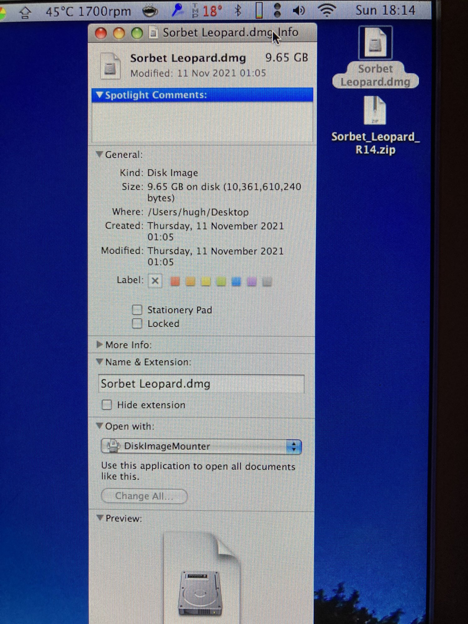

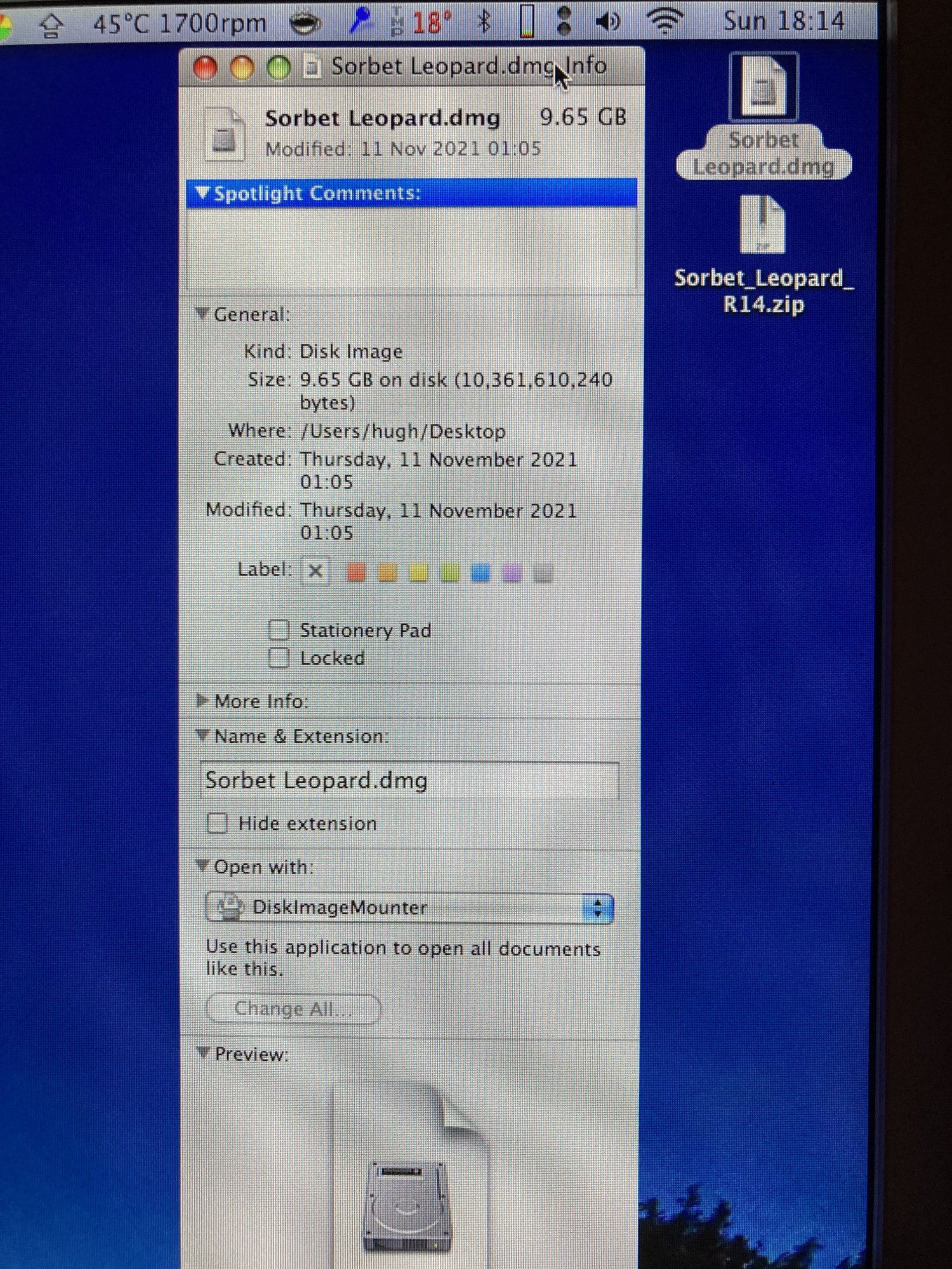

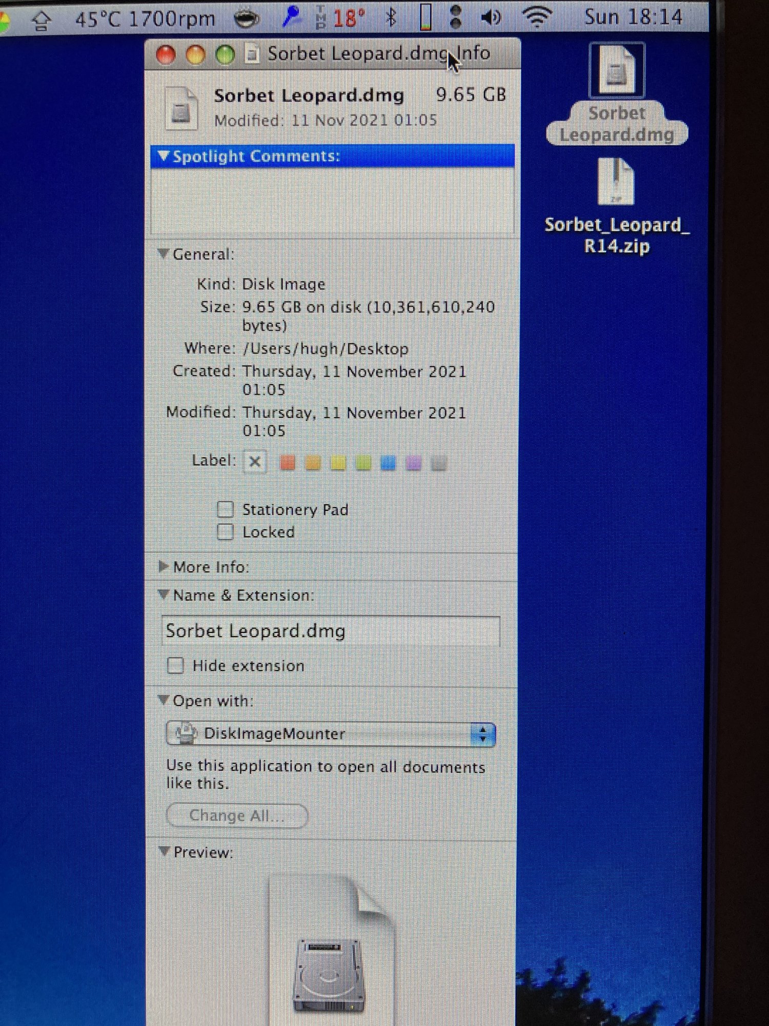

The extracted image size must be 10 GB, otherwise it's incomplete/corrupted. What's the md5sum output for the zip downloaded from the Garden and the Rep, respectively? Is the checksum alright?

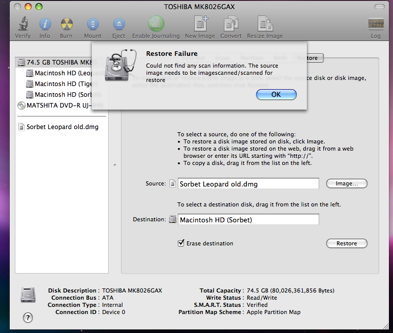

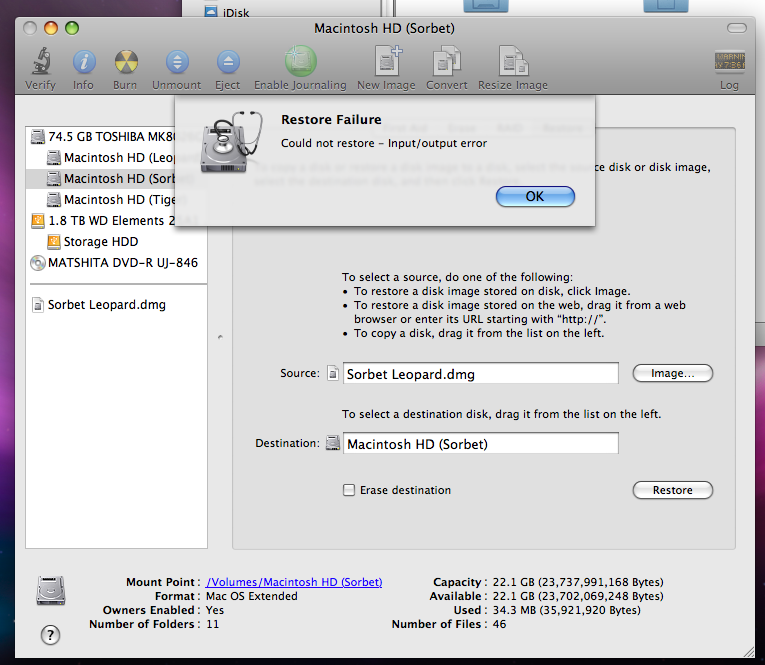

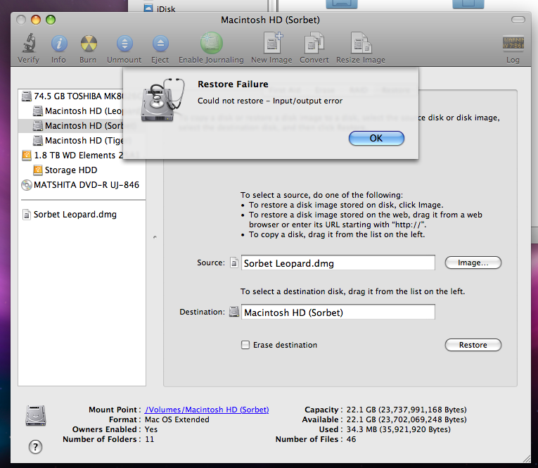

Now running into other issues of the extracted version from my Big Sur mac & modern unarchiver not restoring to the G4 machines partition, giving me this error.
Could it be the drive formatting i'm using to transfer it over/the server the dmg image is living on? Tried extracting the zip on my server from the G4 itself and it ends in an endless loop on unarchiver that looks like this. (Not enough disk space to store and extract locally, so I have to use a server to host the zip file/extracted image)

Sorry it took so long, but the download from the garden took 5 hours.
I downloaded Sorbet R14 onto my iMac G5 and expanded the zip, then (without mounting it) restored the .dmg in Disk Utility to a 16gb partition on an external firewire drive that was pre-formatted APM, HFS+.
The default Sorbet install then booted fine, no problems.

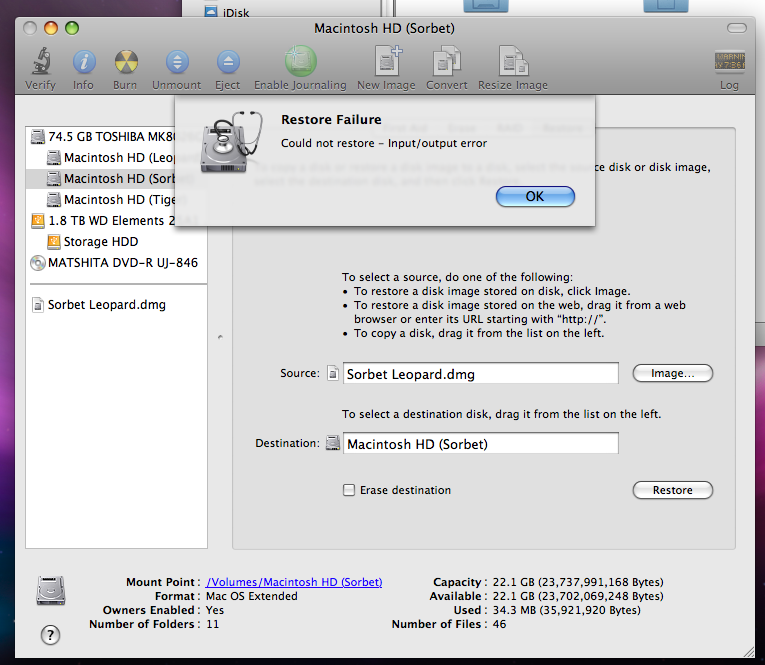

What Extraction method did you use, and did you have the image on your boot drive? I downloaded via media fire, unzipped via the built in apple archive utility (10.36gb) , and i'm getting this now upon restore.
When I try with 'erase destination' enabled, it wont even initiate the copy of files, and I cant figure out how to do it when mounted. It wont let me add the mounted DMG as the source in Disk utility.
I re-downloaded a fresh copy from Mac Garden to the desktop, double clicked it to expand, and did not mount the resulting dmg.
Then I selected the dmg file as source by browsing for it, and because I had already formatted the destination on my firewire drive, did not need to select 'erase'.
On my original installation of Sorbet to the iMac (which I am currently using as main OS) I used the same method from Leopard and restored to a pre-prepared 200GB partition on the internal hard drive.

Exactly the same method I had used before, in fact I did the same through Tiger on my G4 Pismo.
interesting, I followed very similar steps in my previous post and came up on that Restore failure error.
may I ask what the exact size of the extracted DMG is?

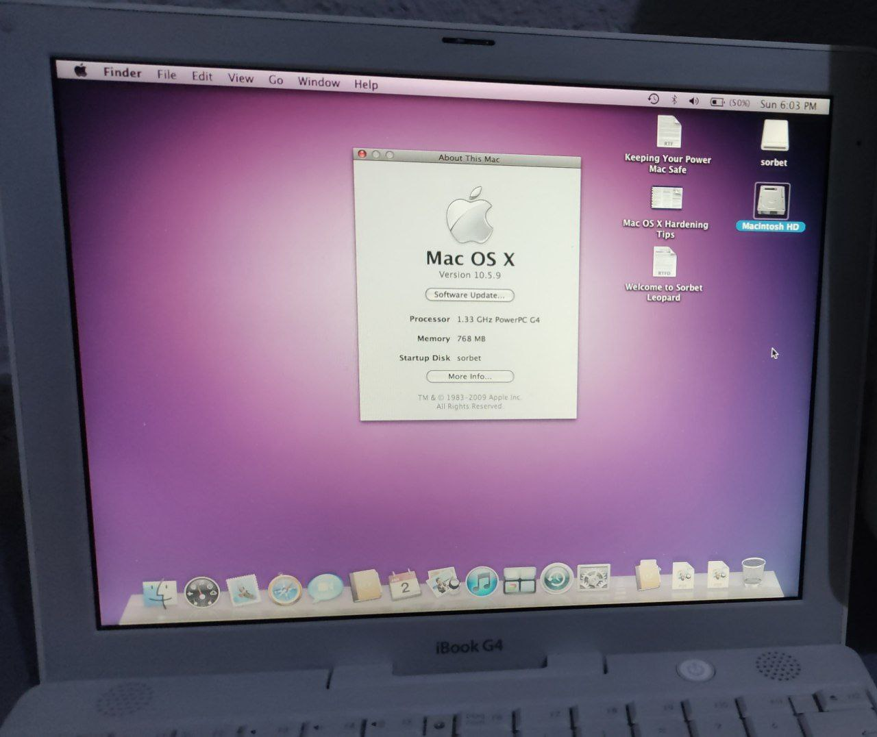

So, I finally got the iBook. I played around for a bit, and wow, this hard drive is slow. And even a bit noisy, but I'd say comes on the expected when using a 2005 laptop. Also, when I tried copying an application to an USB drive it seemed to go extremely slow... to the point it didn't progress anymore. I just ended up not copying. I wonder if I should be aware of a potentially dying HDD, but I need to do more tests.

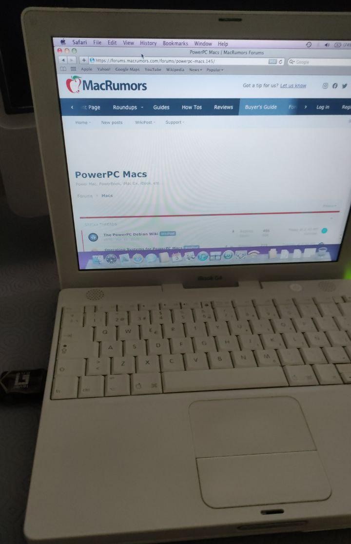

After that, I spent hours trying to get Sorbet on here. The original idea was to do everything from the laptop: decompressing, partitioning and then restoring to that partition and deleting the old one. But the HDD just refused to resize and complaining about no space. After considering my posibilities, I ended up restoring the image to a USB drive using CCC (Disk Utility didn't like the image) on another Mac.
Then some fiddling trying different commands to boot from USB and... Finally got it!
(yes, it also has a working battery!)
It took a very loooong time to boot from the USB thumb drive. I even thought it had frozen, but at second try it did indeed boot.
I guess all these slowness comes from booting from USB, which also gets carried to other apps. For references, Webkit took 26 seconds to open.
And then, it's when I realized there was something wrong with this laptop. Where's the Wifi? And yet I have Bluetooth? I can't remember if I checked this before booting Sorbet. Maybe something screwed up with Sorbet (very likely not the case), or something else is going on.
Is this normal? What can I do if it's not?

Well, today I finally installed it on the hard drive, restoring the image on the USB drive. Used Disk Utility on Leopard's installer for that and no problems.
Then added a USB wireless dongle that I have right at hand (I use it daily with my desktop, and there are drivers for it for Tiger and Leopard) and... here it is!
I still have to execute the tuneup script, but for now I need to spend my time on other things.
Also this Wifi solution won't be what I'll use, I have a better plan for it 😉
Lastly I wanted to take this chance to say thanks to everyone on the community for making such a great work on these old machines. It really amazes me and I hope I can collaborate in a near future too!
