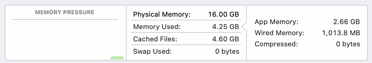

If I go to Activity Monitor, and chose the "memory" panel, I see this:
Now, some other processes MIGHT still have a way to "reach out and touch" the drive, bypassing VM. I don't know that.
But I DO know that any process that "hits the disk" via VM swapping is now OVER on my MacBook Pro. It can't happen.
There are no crashes, everything continues to run just fine.
Except -- no more disk swapping.... AT ALL.
Works for me.

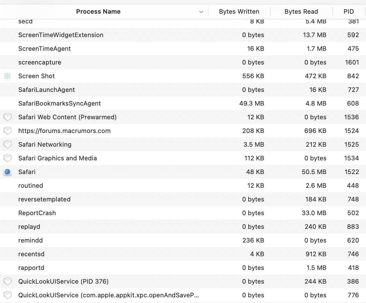

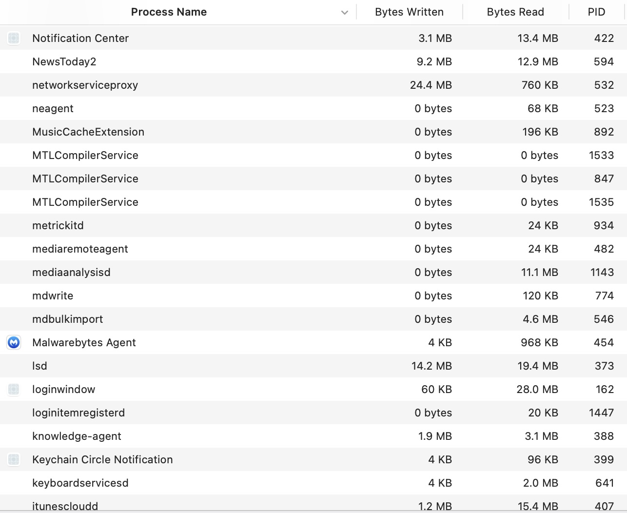

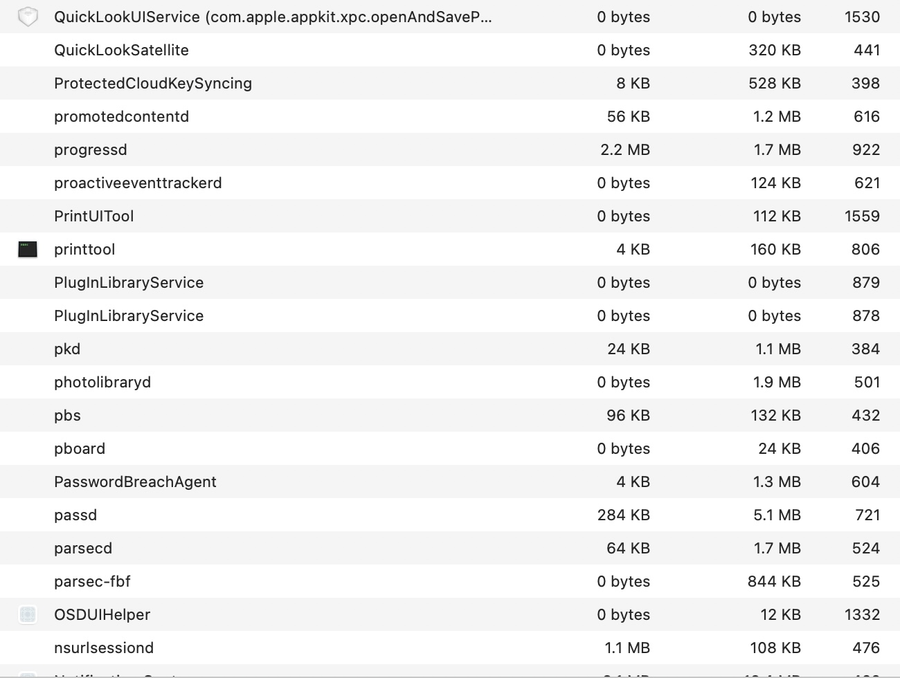

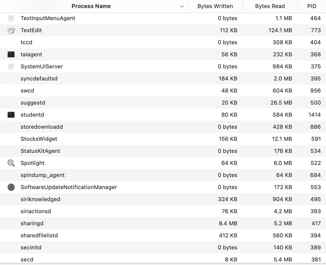

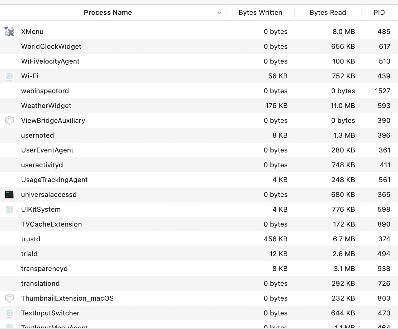

OK, here are some quick screenshots. I scrolled down about 2/3 of the way in the Activity Monitor "disk" pane.
How do these numbers look...?

How about sorting by Bytes written (as I did) so it is easier to compare? Side note My desktop mac has been running non stop for about a month so there is that to factor in.

Yes.
Turn off VM disk swapping:
sudo launchctl unload -w /System/Library/LaunchDaemons/com.apple.dynamic_pager.plist
Remove VM swap files:
sudo rm /private/var/vm/swapfile*
Check that VM is disabled:
sysctl vm.swapusage
If VM is off, report should be:
vm.swapusage: total = 0.00M used = 0.00M free = 0.00M
Disclaimer:
I only know how to turn VM OFF.
I'm not sure of what the command is to re-enable it once it has been disabled.
I don't think you can change "unload" to "load" (in the command above).
Something else is required.
Reactions: osplo and Isamilis

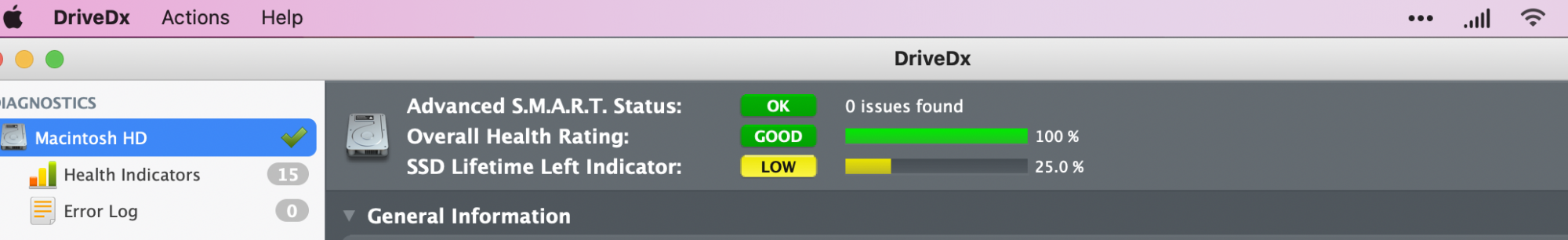

My 13inch M1 MBP Pro in a normal business setup has now used 75% SSD life, losing 4% since November with 293TB written in just over a year. Apple store Genius Bar Doncaster Australia refuses to acknowledge a problem "we don't do preventative maintenance" 'That's a 3rd party app reading your Smart Data" "You must let it fail and then we'll fix it if still in warranty"
That is interesting. Could you tell us a little bit more? is it 256GB? If yes, looks like drivedx reads it at 400TBW.

Not sure if the power on hours is correct but I'm at 57.5GiB/hour if SMART data is to be believed
SMART overall-health self-assessment test result: PASSED SMART/Health Information (NVMe Log 0x02) Critical Warning: 0x00 Temperature: 28 Celsius Available Spare: 100% Available Spare Threshold: 99% Percentage Used: 0% Data Units Read: 30,588,647 [15.6 TB] Data Units Written: 19,548,936 [10.0 TB] Host Read Commands: 460,803,752 Host Write Commands: 163,156,487 Controller Busy Time: 0 Power Cycles: 399 Power On Hours: 178 Unsafe Shutdowns: 9 Media and Data Integrity Errors: 0 Error Information Log Entries: 0
