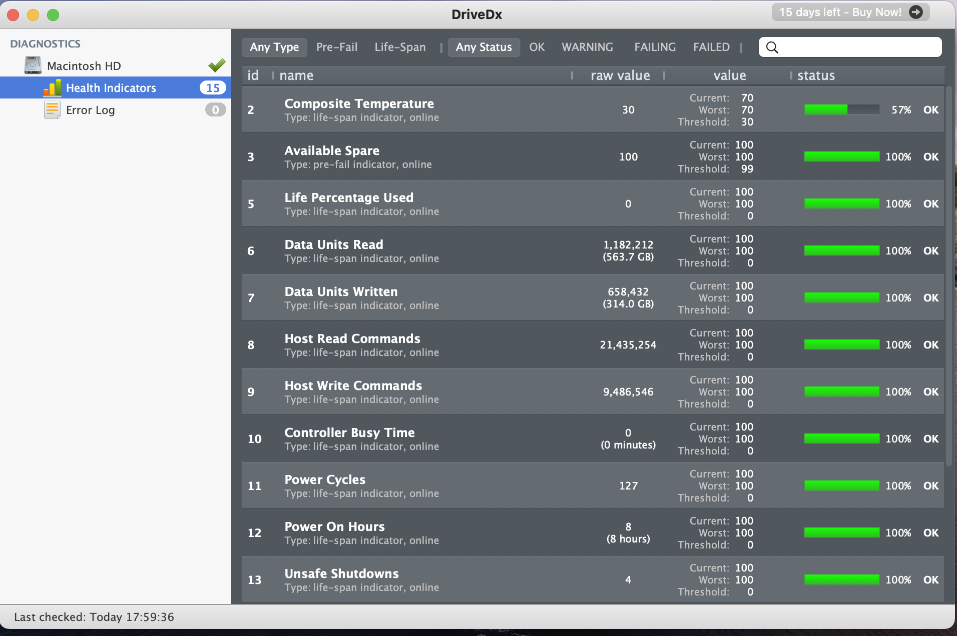

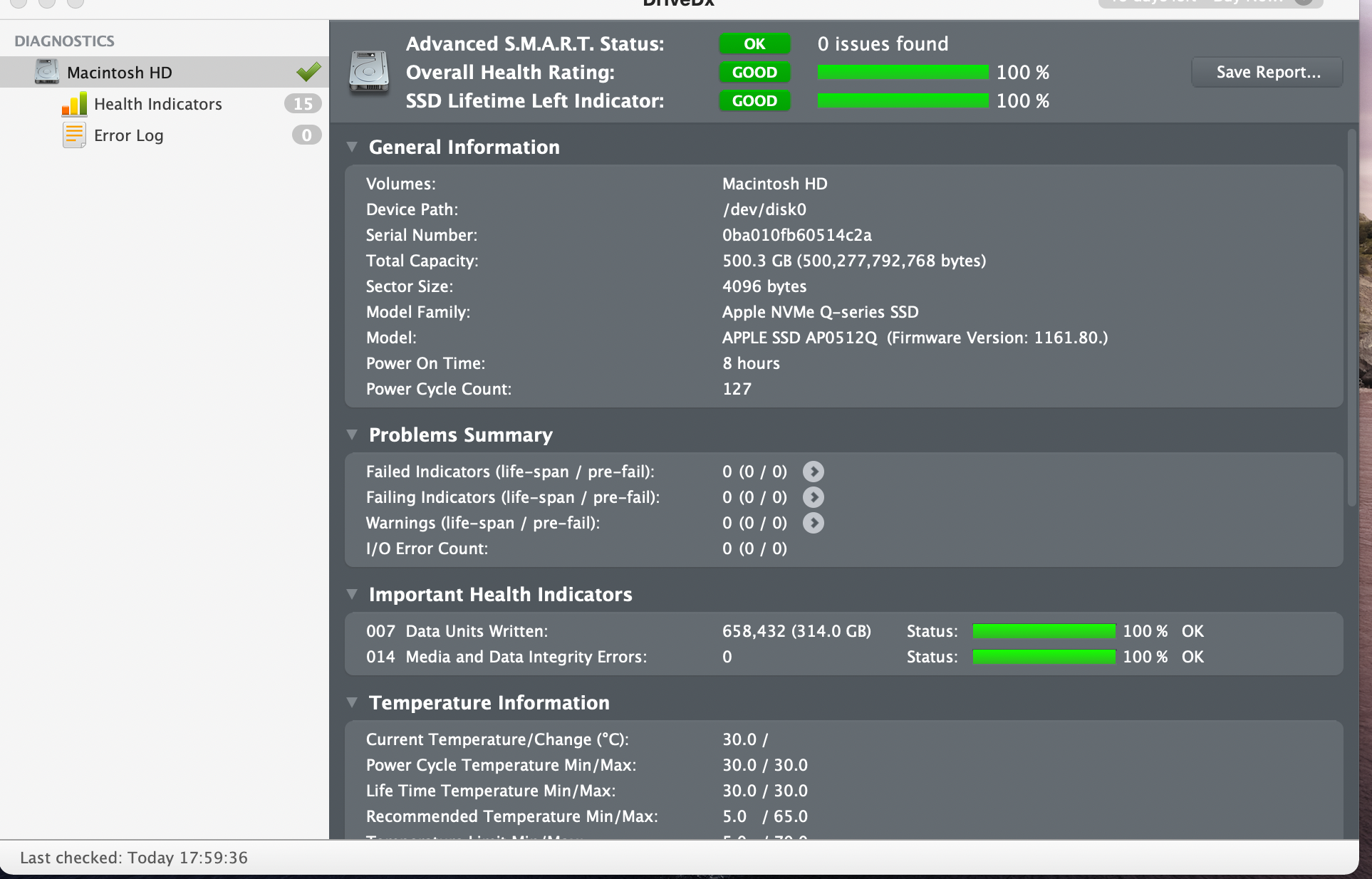

OK these are my stats! I am a very light use. I got the Mac on January 29th

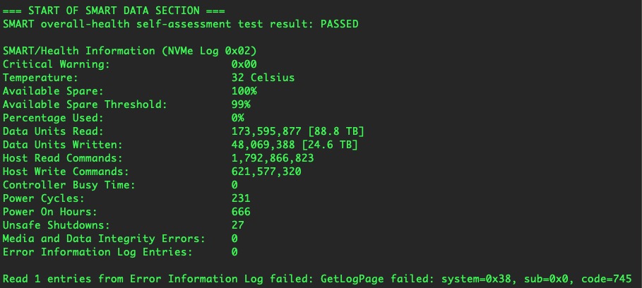

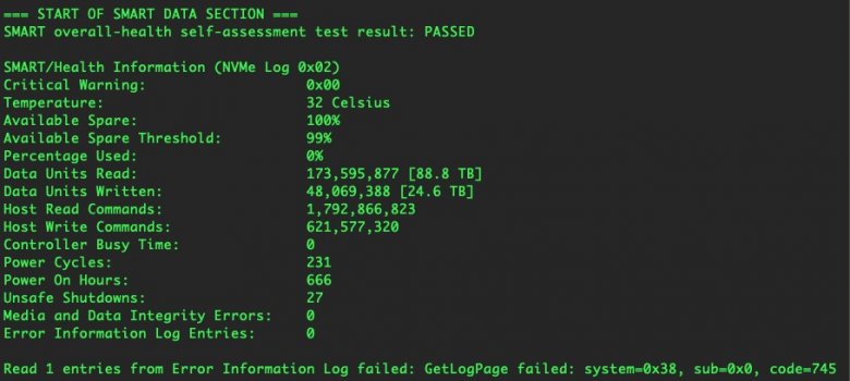

On March 1st I found my drive's TBW to be at 24.0, and now today I'm at 24.6 TBW after 666 Power On Hours. When I first saw this issue in the forums and checked on Feb 27 I was at 22.7 TBW (Received Nov 27, 2020). I'm honestly not sure what it could have been to slow that TBW process down some like this, but that's fine by me! I'm literally doing as much as I normally would (Recording a lot w/ LPX, some video work w/ FCPX, some downloading of random videos) and there seems to be no major increase in TBW overall for me. I have gone thru and cleared out some iOS apps I've side loaded and decided not to use. I do still have a few others, though. I do see a relatively high GB Written for kernel_task and backups processes (145.55 GB and 264.90 GB) after 2½ days of uptime. But even that's not too bad. I'm sure Time Machine's local snapshots have something to do with that...
EDIT: Also of important note here is that on Feb 27 it showed 25 Unsafe Shutdowns. Today it's showing 27. Progress!
Some people have said that 11.2.2 stopped the high SSD writing for them. Maybe that is when yours stopped? The timing looks right.
Yes, that timing looms to be on target For me. I’ve been holding off on reinstalling macOS until I can really confirm I’m no longer seeing that TBW number climb up there in a short amount of time. I’m REALLY curious to know what that number was at after I first turned the machine on out of the box! I’ve got the 2TB M1 MBP model with 16 GB of RAM, and am currently using 1.46 TB of that drive.

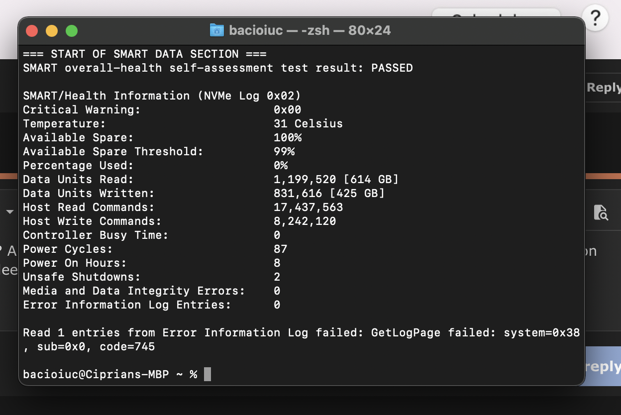

It's almost impossible. Would mean he writes 1.7 TB / day, give or take. On a 256 GB ssd. 1700 GB / day or 6 times the total capacity of the drive.
Curious @VitoBotta: did you migrate your data from another mac or did you set it up as a new mac?
Edit: Also, I keep seeing a pattern between people using SLEEP instead of turning off their computer AND the amount of TB written.

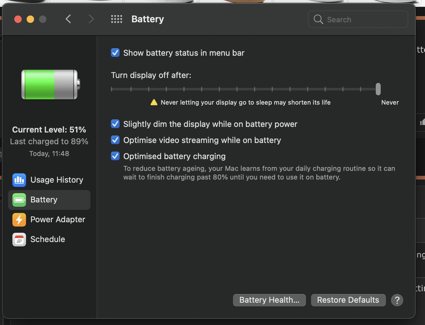

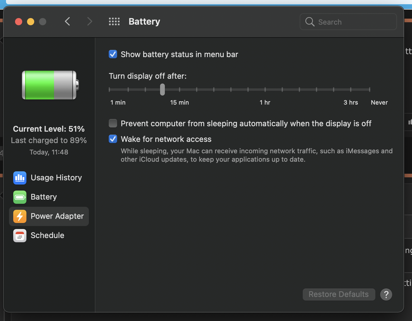

So sleep is the next part. One thing I didn't mention si that I sorta have my mac set to sleep never when on battery (I did this in the first day just so I can stress test to see how long the battery would last with videos running or idling). The screensaver kicks in after a while and goes to sleep when I have it plugged in, but I only keep it plugged in when turned off to charge.
Can you try my power settings, from the battery settings, to see if it still happens?
And here are my power settings:
Maybe something fishy is happening during sleep.
Edit: Apply the same battery settings, reboot the mac and check back after an hour, like you did before.

Right, can you set sleep to never? And maybe uncheck put hard disk to sleep when possible? I'll take some screens on my end and set my macbook to sleep and do the same.
Current status:

Thinking it might be a problem due to sleep. I already have my M1 sleeping at this point so I'll wait for 40-60m and see if any write activity happened. It's a quick way to figure out if this causes the problem.
It doesn't cost me anything to try so I will turn it off now and see.
