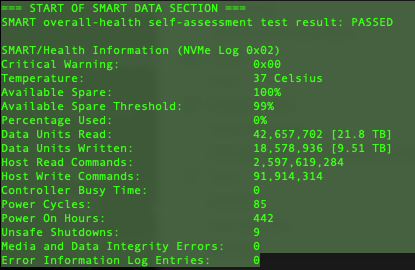

That seems low compared to mine (M1 Mini 16GB/512GB):
Code:
uptime
19:23  up 3 days,  5:41, 18 users, load averages: 2.97 3.53 3.51
iostat -Id disk0
              disk0
    KB/t xfrs   MB
  112.13 32127102 3518007.07
So that's 3.5TB (read & write?) in 3 days. It's gone up by about 1TB during today's work. That's twice my SSD capacity. Even with a fair bit of swap (I've got about 15GB swap at the moment), that seems to be a large number. I'm using the same apps during the day, so I wouldn't expect a lot of swaping, but numbers from vm_stat are also very high:
Here's my Disk use from ActivityMonitor:
....and here's the output from smartctl:

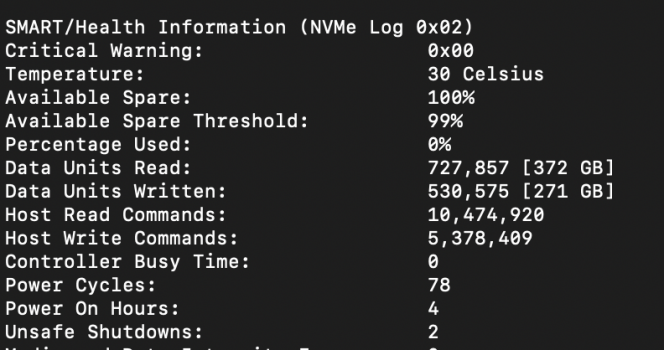

So your figures of 337/443GB read/write are much lower....but you only have 11 hours on power-on time. Is that correct? Presumably SMART data is total disk usage for the life of the machine, and not reset on reboot.
I'm now starting to get a bit worried. If I'm writing 500-1000GB to the SSD every day in "normal" OS usage (not copying huge files around) then how long would the SSD last? What is the TBW for these drives?

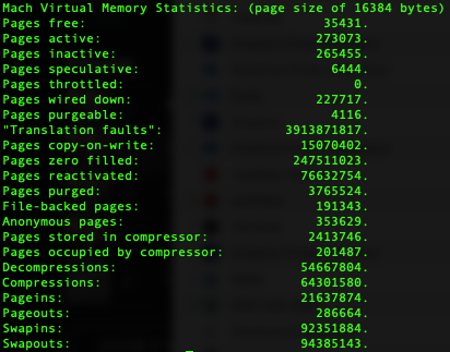

Your numbers are consistent with mine: if you multiply swapin page number to 16k page size you get bulk of write activity (ca 1.5Tb), i.e. most of writes are coming from constant swapping.

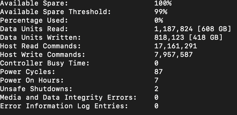

It's interesting that I seem to not be affected by this? I got my M1 MBPro 1 week ago today and have been using it consistently for 10-16 hours a day for work.
Doing game development and working on a project that's about 50GB in size. Thinking more data might be of help to you guys in tracing down what could cause this.
In the past week I installed the following things:
- Unity3D and Visual Studio (rosetta)
- Baldurs Gate 2: EE (iOS version)
- Discord, Pock (touchbar utility), LimeChat
- XCode
- CrossOver + Steam and Skyrim to test out how crossover behaves on M1 macs.
+ 50 GB project for Unity.
In total, my read/writes look like this:
In total 418 GB written and 608 read in the time span of 1 week with 10 hours of usage / day on average and only using the software mentioned above. I use Safari as my main browser on this machine. Unity and Visual Studio Code + Safari (Youtube, docs and 3-4 more additional tabs) and Baldurs Gate constantly opened at any point.
I'm also doing regular builds of the game and spitting it out once per day (about 2 GB in size).
The amount of Data Units written is consistent with what I'm doing. If I add up together the file sizes for what I downloaded + MacOS default install size + ~4GB / day the amount of units written it ads up.
So I'm not experiencing this issue myself on this M1. Question is why?
I'm going to go through the other posts and see if there's any specific app being mentioned (like chrome, or zoom or something) and do a test install to check and monitor the issue over the span of my work hours.
Edit: Also, I setup this Macbook as a new Mac, did not import anything from my other stuff. iCloud backing up is disabled.
P.s. I don't leave my mac in sleep mode. End of the day it gets powered off. I keep noticing people like to put it to sleep instead of shutting it down so thought I would mention this.

Let's do some quick rough math.
418 written right now.
- 53 GB unity project
365 GB written left.
7 days of builds exported that are 4 GB in size, written to the drive. About 1-2 builds per day, so let's say it's 10 builds (altough it's much more than that).
365 GB
- 40
325 GB written.
Baldurs Gate: 3.25 GB
Unity: 5 GB
Visual Studio: 2.5 GB
XCode: 45 GB
Skyrim (+ a lot of mods): 17 GB
72 GB.
325-72 = 253 GB.
Take away about 35 GB from the system install size and your left with about 200 GB of data that are unaccounted for. UNTIL you factor in about 80 GB of sound assets and music files for my game that I copied over to have access to when I'm on the road and about 40 GB of 2D/3D assets that I have backed up on this laptop. About 120 in total leaving us with about 100 GB unaccounted for.
And that's without factoring in all the shait I downloaded and removed over the course of the first 2 or 3 days of just fracking around with the M1 to stress test it out and benchmark it's compilation times. Seeing as people here mention 500 GB written daily and stuff like that, yeah, it ads up to my usage.
Edit: attached, how things were looking like on Day 3 (28th February). Had it archived on a discord chat, sent it to a friend.
I'm just saying, my written data is on par with what I did.
Edit: and I can account for the remaining unaccounted space written since I regenerated the vegetation storage data for my game quite a lot of times to apply the changes. It writes about 5.6 GB of space to store prefabs and vegetation data for a huge, open world. Since I was importing new vegetation types, tweaking and writing it I can safely say about 40-50 GB of writes were taken from that. I realised this now since I just started a new vegetation storage write.
Reactions: chouseworth
