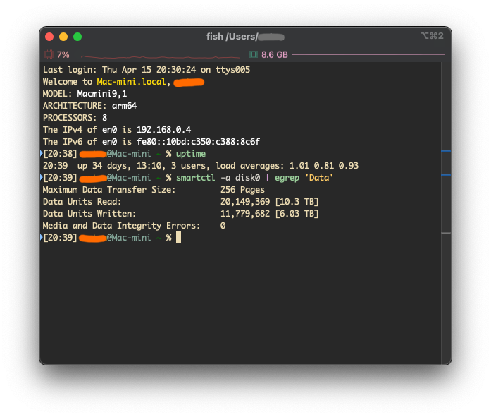

Just compared my Mac Pro 5,1 running Big Sur on Open Core. The system disk is a PCiE M2 that has been running about 10 months. Its TBW is now slightly less than my M1 at 5 months. With 70TB the M1 has averaged about 2x the writes of the Intel Mac Pro running the same OS version.
Both machines have a 2TB system drive. The Mac Pro has additional drives for media, repositories, games, and booting other OSs. It also has 48GB RAM vs 16TB on M1.
